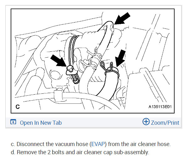

Will shut off when shifting from P to D or P to R unless giving a little bit of gas?
2007 LEXUS RX 350
203,000 MILES • V6 • 2WD • AUTOMATIC
TBRANNON

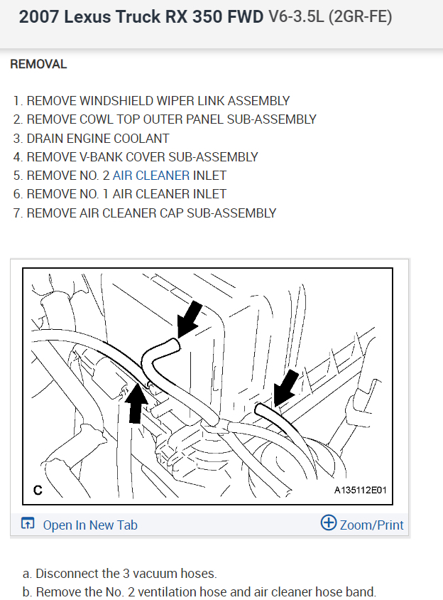

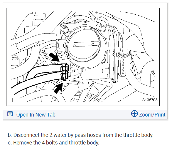

My vehicle listed above will shut off when shifting from P to D or P to R unless giving a little bit of gas first. At cold start when I shift into gear it doesn't shut off but after the first initial start of the day any time after engine warm up it will shut off when shifting into gear.

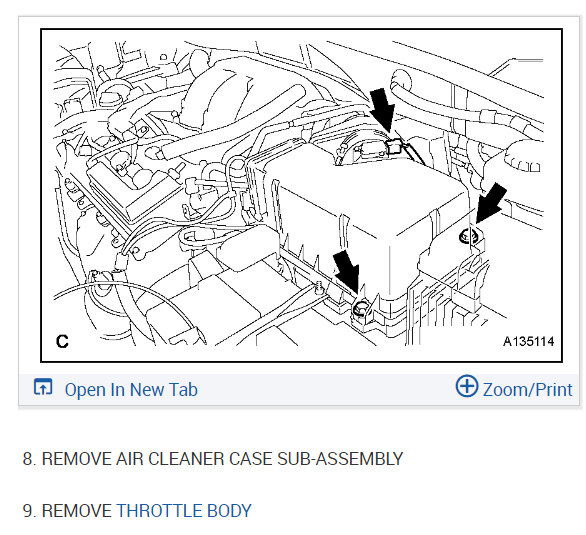

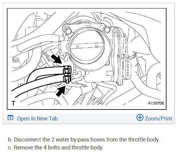

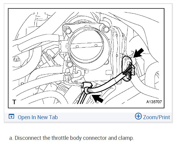

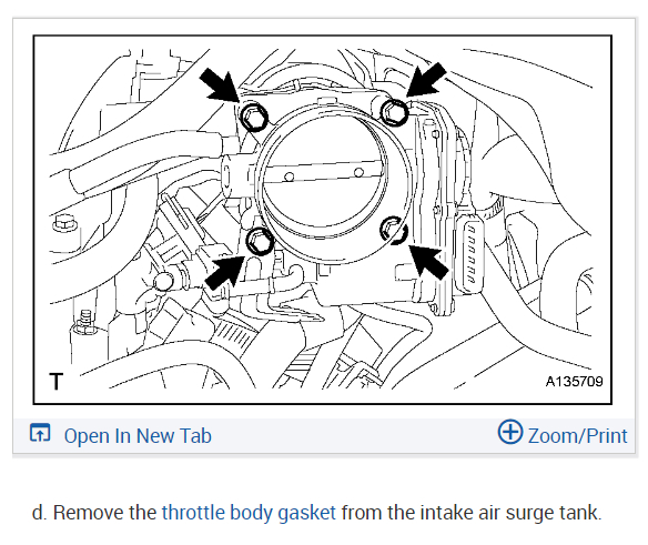

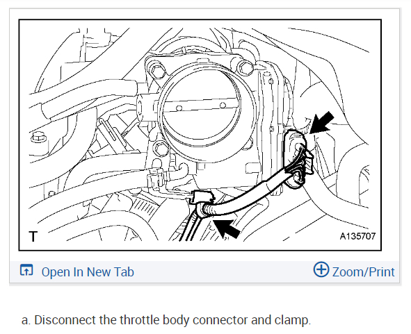

Stalling at idle is a common problem, most of the time it means the engine has a vacuum leak or the throttle bore needs to be serviced.
Here is a guide to help you understand what's going on:
Can I ask if you have a check engine light on? If so, you will need to run the codes to see which ones are stored, which can help us fix the problem.
Here is how to remove the throttle body so you can clean it. Please go over the guides and check out the images below.
