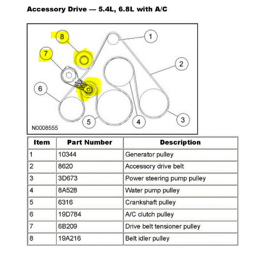

I changed the coil packs in my truck. The next day after driving 3 miles the engine started to squeal. At first it only did it when I let off the gas but within another 50 miles it was constant. The next day I popped the hood, the radiator was cracked. I replaced the water pump and the radiator. It still squealed. I replaced the fan clutch a few days later. It still squeals. I have not driven it since I replaced the pump, just let it warm up and the squeal kicks in. The truck is not running hot, the A/C still works and turning the A/C off or on makes no difference, turning the steering wheel makes no difference either and the alternator is charging the battery. I’m at my wits end trying to solve this issue. Any help is appreciated. Thanks for taking the time to read this.

Does it sound like a belt squeal? If so, try this: When it is making the noise, take a small cup of water and pour it on the belt to see if the sound changes. You may have a weak belt tensioner and it's allowing the belt to slip. Also, check to make sure the belt tensioner pulley and the belt idler pulley are not locking up. That can happen as well and cause noise. Since this is happening when it warms up, something could be slowly locking up.
I attached a picture of the belt routing and highlighted the two pulleys I'm referring to. Check them. If you are not sure if it is the belt, then when the engine is warm, remove the belt and start the engine for a couple seconds to see if the sound is gone.

Thanks, but I considered the belt as well and since I had the motor apart I installed a new belt and tensioner as well. It still squealed. I also noticed that before it gets to operating temperature the rpm's bottom out like it’s going to stall, it picks back up to normal within a few seconds but this is when the squeal starts to kick in.

Does it make the noise when the belt is off?

That I don’t know, I didn’t test that scenario but I will tomorrow.

Let me know what you find. Something is locking up when it gets warm I have a feeling it may be the idler pulley.

Thanks Joe. I tried It with the belt off, still same noise but upon further inspection and a lot of time crawling around the truck, I found the problem. There is a crack in the exhaust manifold. Obviously the catalytic converter(s) are clogged and forces the exhaust to go somewhere else hence the squeal from the motor after it warms up. Thank you for your in trying to help me solve this problem.
