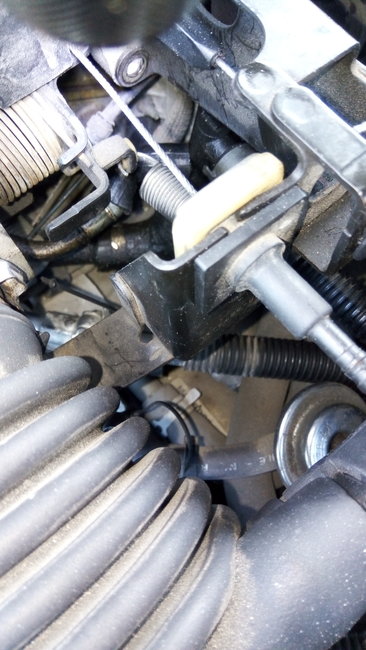

I have not had time to check the pressure yet but while I was cleaning up the engine bay with some towels I notice a short hose (not sure what it goes to) is not all the way on and I could hear air coming from it while the engine was running. It is near the top only about an inch and a half long. Could it be related. Hear is a picture. I do not know if you can tell what it is. It is right at the end of that spring.

it is probably a vacuum leak. replace the hose or reconnect it and the sputtering should go away.
