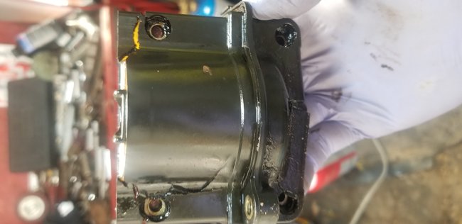

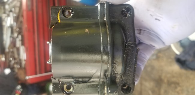

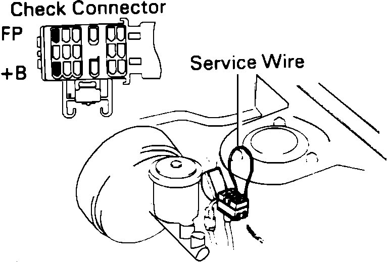

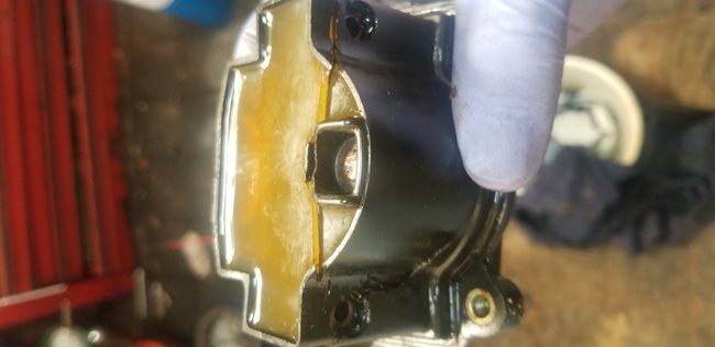

Started engine and let it warm up from cold. Drove approximately 3 miles to the local gas station and shut off. Ran fine. Came back out few minutes later, started car which started fine. Accelerate to get on highway and engine is sputtering like not enough fuel or running on 2 or 3 cylinders. New fuel filter changed, drained gas from tank with new gas put in. Engine codes were #24 and #31 obd1. Air meter sensors cleaned with MAF spray then codes cleared and haven't returned. What can this be?

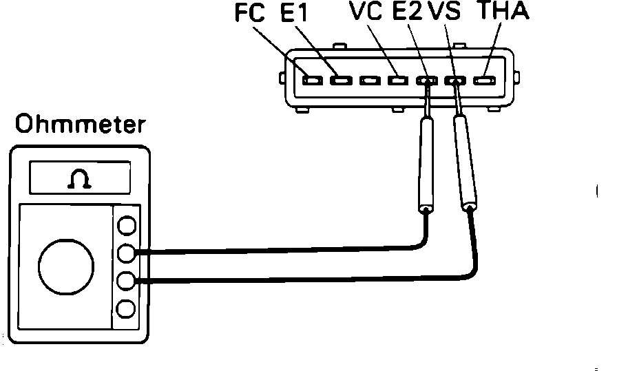

The air flow meter could be going bad or you could just have a poor connection. Here is a test for checking the sensor. You will need a digital multi meter to do this, but it really isn't hard. Here are a couple links you may find helpful:
Here are the directions for checking the sensor. The attached pics correlate with these directions and provide the needed specs for testing.
____________________________________
1991 Toyota Camry Sedan 2WD L4-2.0L (3S-FE)
Component Test
Vehicle ALL Diagnostic Trouble Codes ( DTC ) Testing and Inspection Manufacturer Code Charts Engine Control System DTC 31 Component Test
COMPONENT TEST

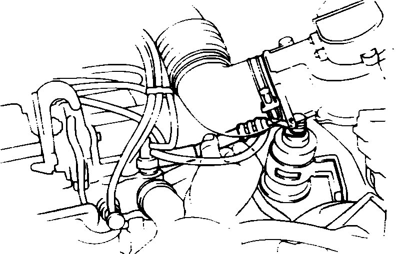

1. Disconnect Air Flow Meter connector.

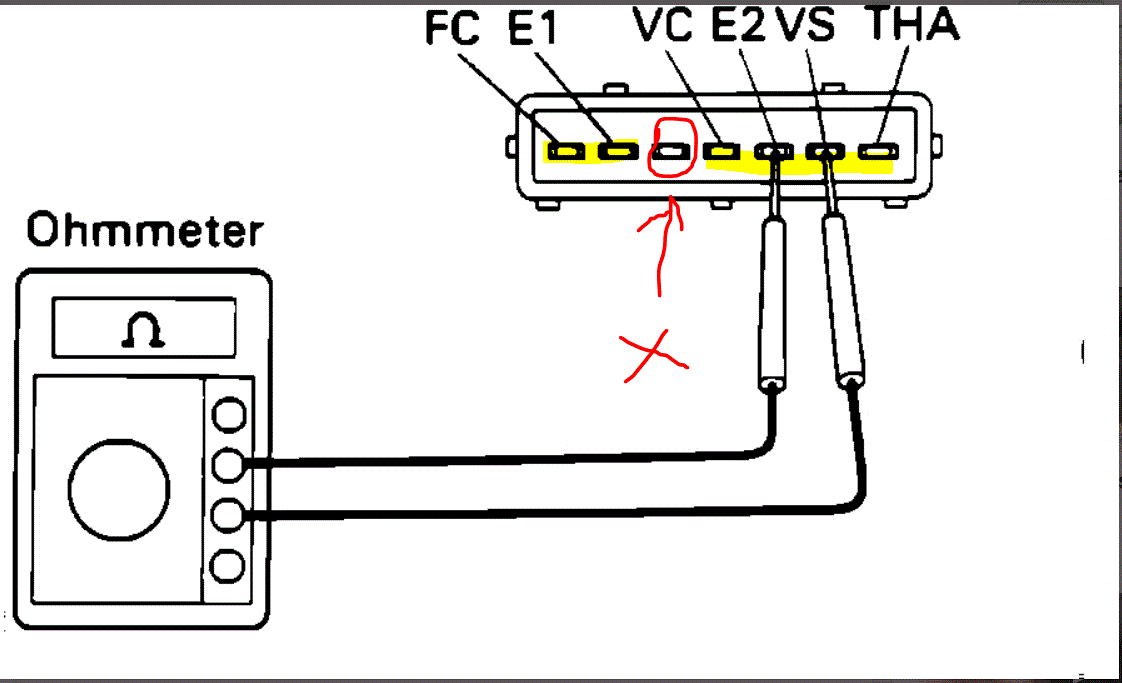

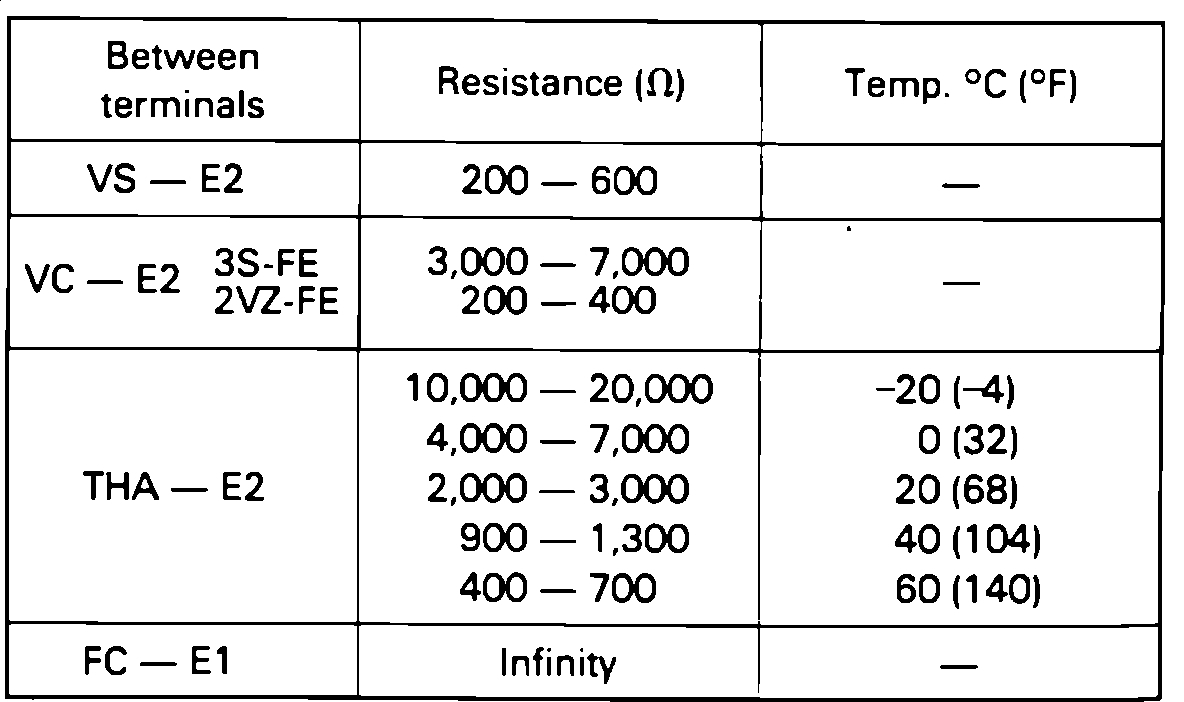

2. Using an Ohmmeter, measure the resistance between each terminal. (Refer to chart)
Testing Air Flow Meter
pic 1

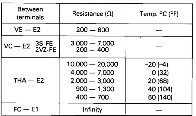

Air Flow Meter Flap Resistance Chart
pic 2
3. If the readings are not as specified, replace the Air Flow Meter.

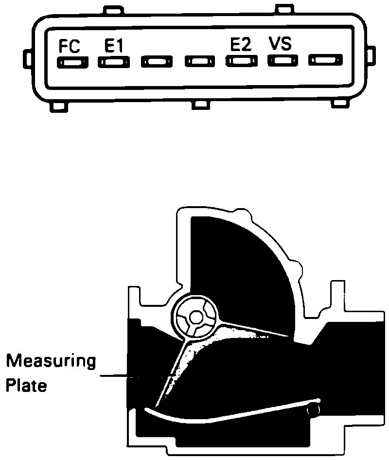

4. If readings are normal, remove the Air Flow Meter.
Removing Air Flow Meter
pic 3

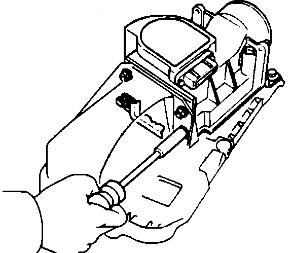

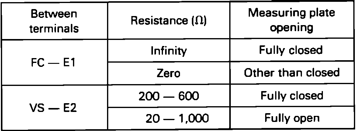

5. Using an Ohmmeter, measure the resistance between the terminals while moving the flap (measuring plate).
Air Flow Meter Flap
pic 4
6. Refer to resistance chart for correct readings.
pic 5
7. If readings are not as specified, replace the Air Flow Meter.
8. Check that flap does not bind and moves smoothly in its travel.

FUEL PUMP QUICK CHECK:
1. Check that battery voltage is at least 12 volts.
2. Turn on the ignition switch.

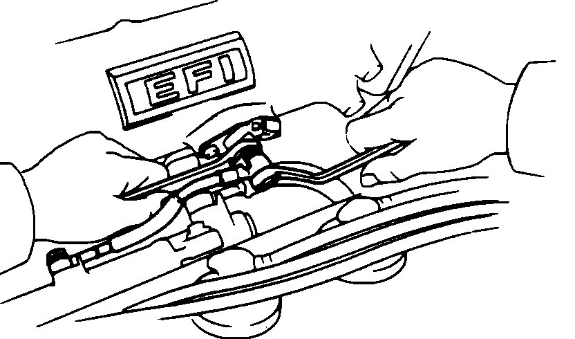

3. Using a service wire, short terminals +B and FP on the engine check connector. The fuel pump should operate.
Shorting Fuel Pump Test Terminals
pic6
4. Feel the fuel hose coming from the fuel filter to the fuel rail. The fuel flow should be felt, if the fuel pump is operating.
EFI Fuel Filter
pic 7
5. If not, perform pressure test below.
6. If fuel flow is felt, fuel pump operation is indicated, although fuel pressure may not be correct. For an accurate diagnosis, perform pressure test.

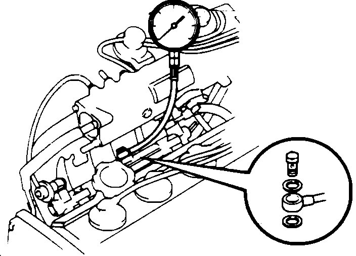

4. Connect a suitable fuel pressure gauge to the fuel rail using the union bolt and gaskets to provide a tight seal.
Connecting Fuel Pressure Gauge
pic 9

6. Using a service wire, short terminals +B and FP on the engine check connector. The fuel pump should operate and cause the pressure gauge to deflect.
pic 10
Fuel Pressure: 38 - 44 PSI (265 - 304 kPa)
7. If pressure is low, check fuel pump output and/or fuel filter for restrictions. If pressure is high, refer to FUEL PRESSURE REGULATOR/FUEL RAIL and test components.

When I drained gas, I used the jumper wire on the diagnostic port. When gas was finished draining the gauge was setting on empty. Pump is working but I will check pressure next.
Feb 19, 2020 at 3:08 AM
RICH BOYER

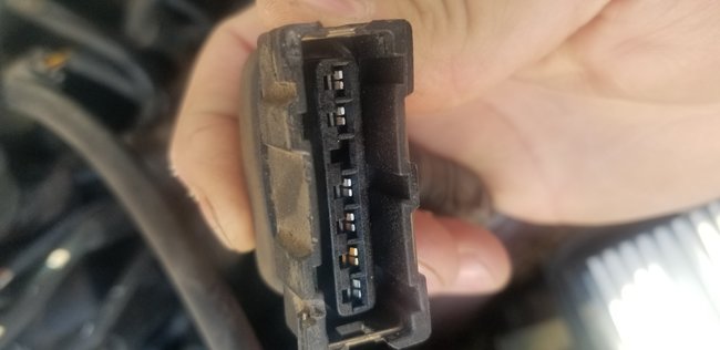

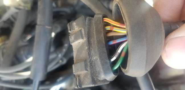

Looks like 6 wires but 7 slots.
Feb 19, 2020 at 3:11 AM
  • 110,240 POSTS
Yes, that is correct. The plug is designed to hold up to seven wires but only six of the terminals are used. If you look at the first picture I attached above, it shows it. I attached the picture again below, highlighted the connector locations and circled the empty slot.
Let me know what you find.
Feb 19, 2020 at 11:45 AM

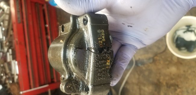

RICH BOYER
Had a car run this way a long time ago and remembering what the problem was, i went past the fuel issue and started looking in the distributor and low and behold; coil. I really don't know how it ran whatsoever.
Feb 20, 2020 at 4:50 AM
  • 110,240 POSTS
Wow! I can't even say how that happened. Is it running better now?
