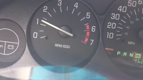

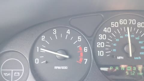

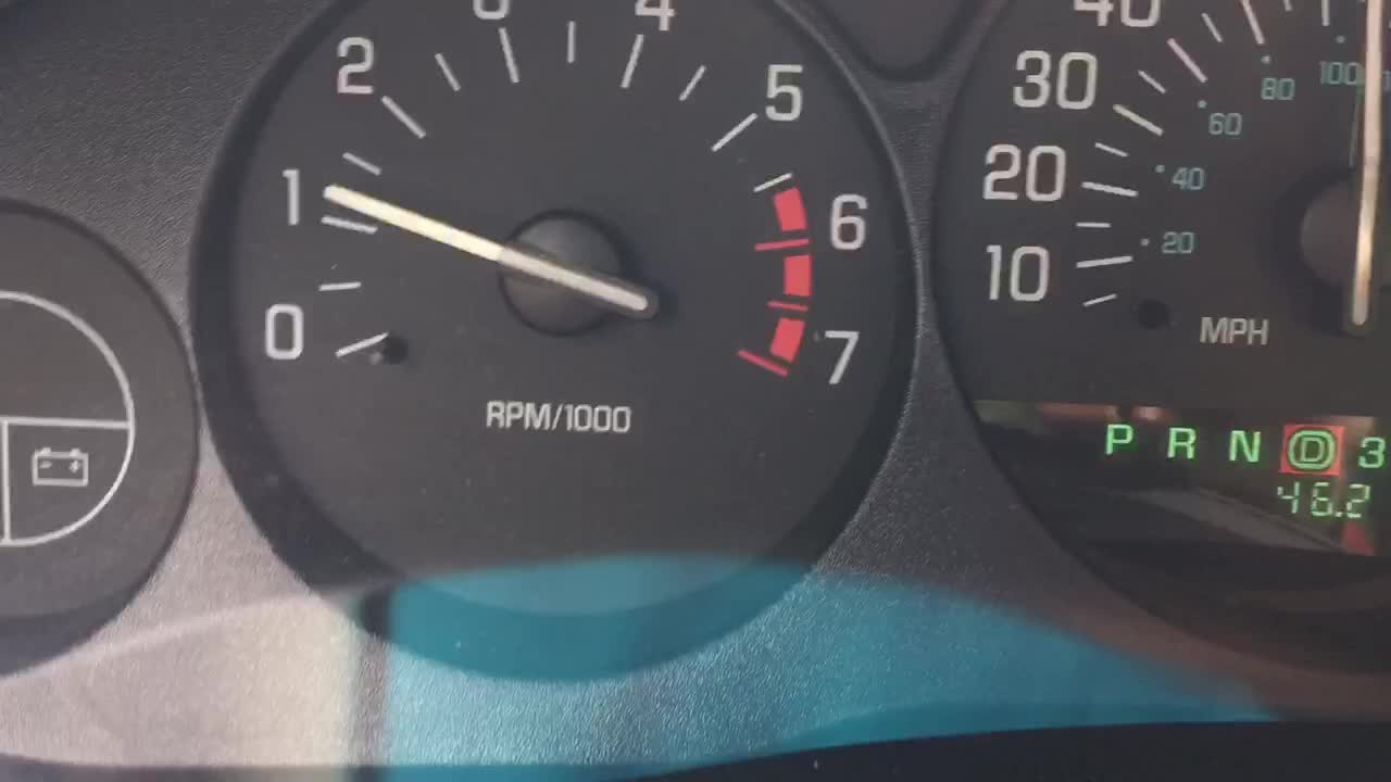

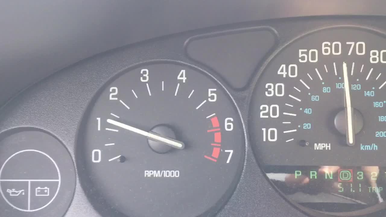

I have noticed when going down a long and steep hill, throttle closed, that the engine speed hunts up and down from about 1,000 or 1,100 RPM's, to about 1,400 RPM's.
Vehicle speed is remaining basically constant.
I have never noticed this before, with any other car.
Iam not sure if this is even a problem.
Does anyone have thoughts on this?

Do you feel the transmission shifting up and down? At that speed, it looks like the torque converter clutch may be engaging and disengaging.
Are there any codes in the system?

No, I do not notice any transmission activity at all.
No codes.
I thought at first, it was only with the cruise engaged, but now notice that it happens with cruise on or off.
