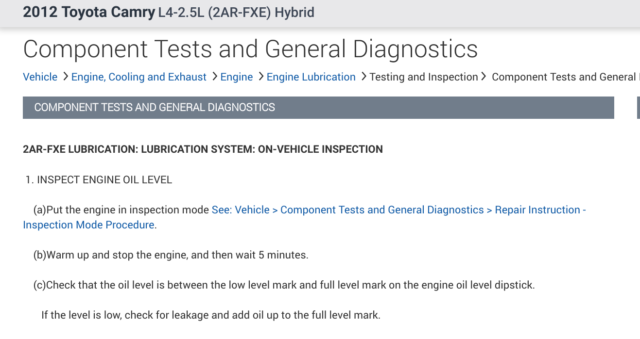

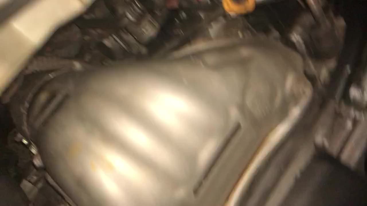

Hi, my friend told me that the engine sound is rough and knocking. i am not convinced with his opinion.
Please if you can tell if is it normal or not. i will upload 2 videos.
Thanks

SCGRANTURISMO
  • 4,897 POSTS

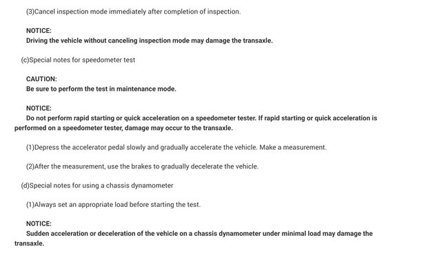

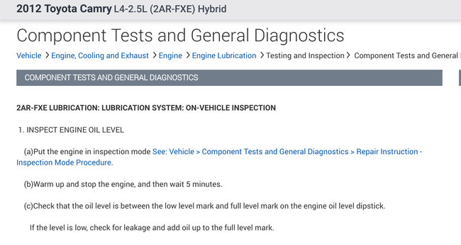

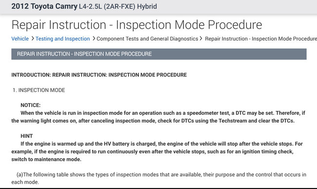

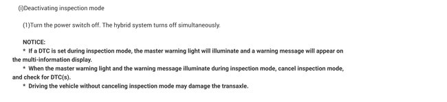

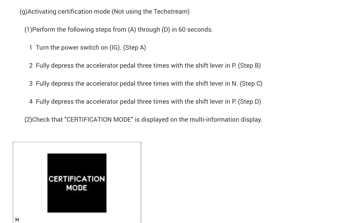

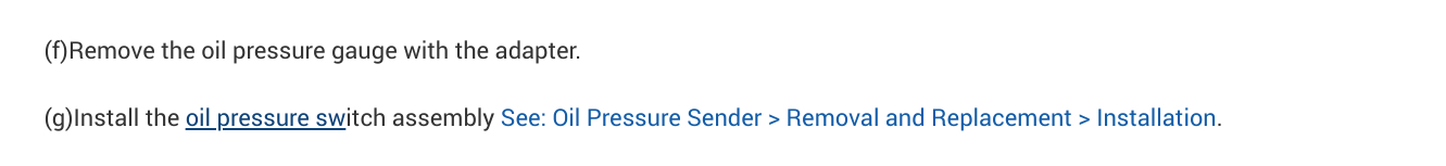

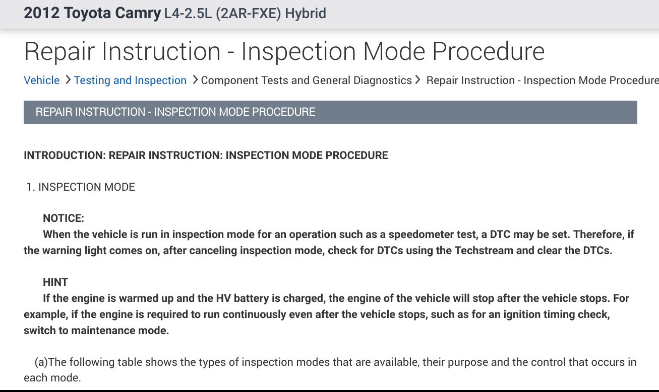

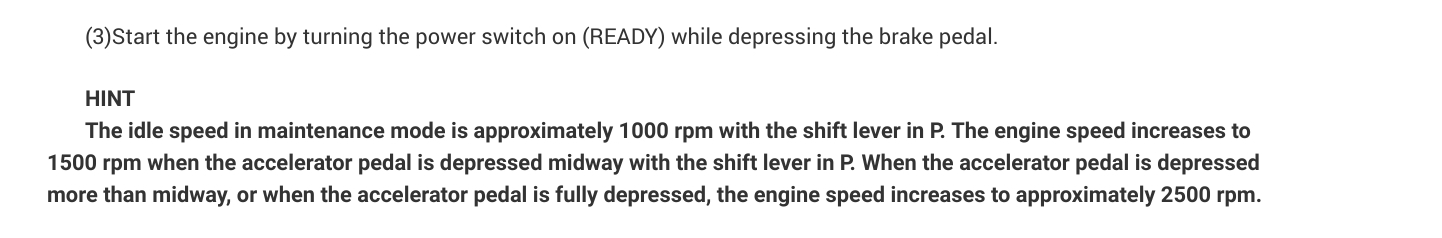

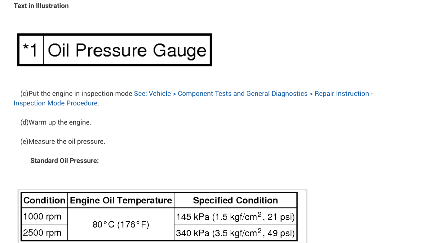

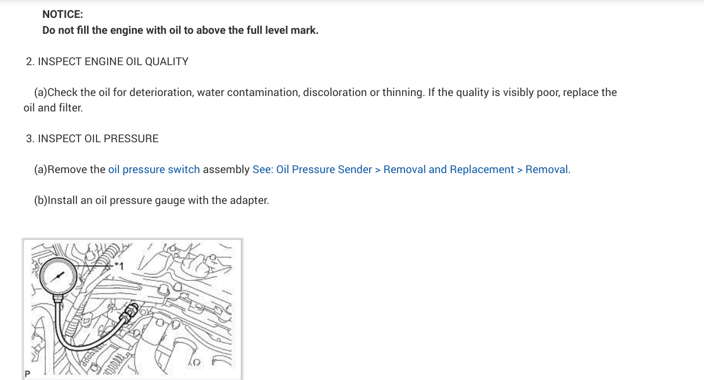

This does sound like an engine that is low on engine oil and has a noisy valve train from lack of lubrication. In the diagrams down below I have included instructions from the vehicle manufacturer on how to properly check the engine oil in your vehicle. Please go through this guide and get back to us with what you are able to find out.

I checked the oil , it is okay.
I also changed the oil with new one Valvoline 0w20.
But still same sound.
Do you advise to change lifters of engine?

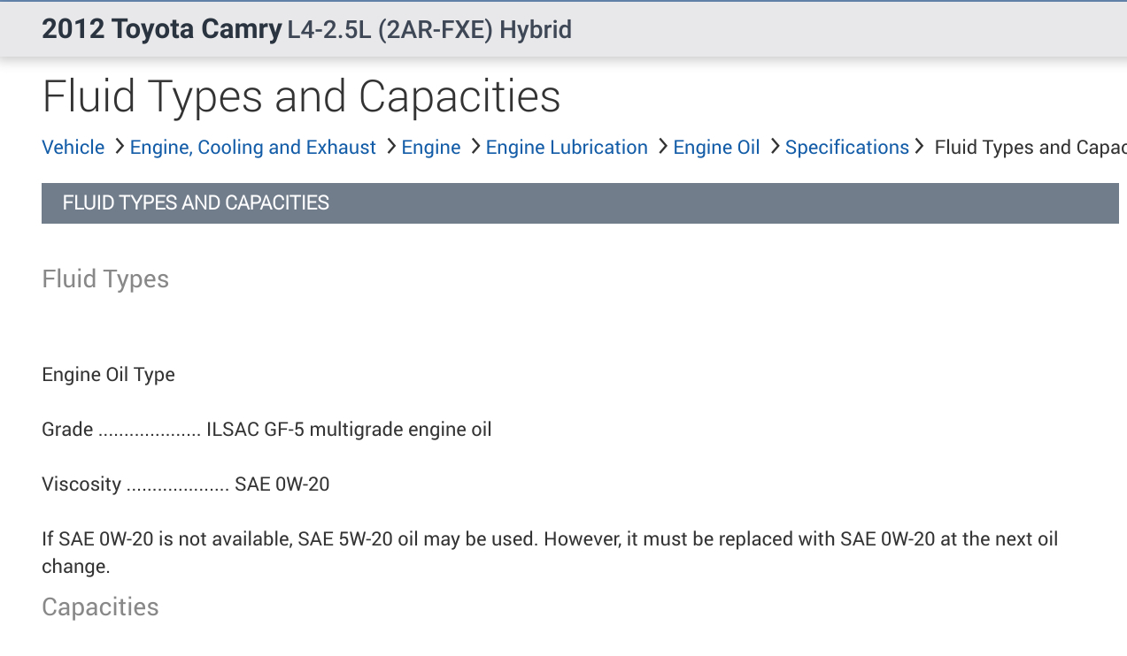

SCGRANTURISMO
  • 4,897 POSTS
Hello again,

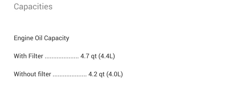

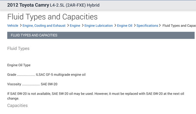

The recommended oil weight for your vehicle is 0W 20. I have included the recommended oil type and capacity in the diagrams down below. I hope that this helps.
Thanks,
Alex
2CarPros

SCGRANTURISMO
  • 4,897 POSTS
Hello again,
Our reference, which comes from the vehicle manufacturer, recommends 0W 20 oil. It does say that you can use 5W 20, but you must switch it back to 0W 20 at the next service. I have no idea why the oil types are different in different countries. That does seem strange to me, but I can only recommend what the vehicle manufacturer recommends here.
Thanks,
Alex
