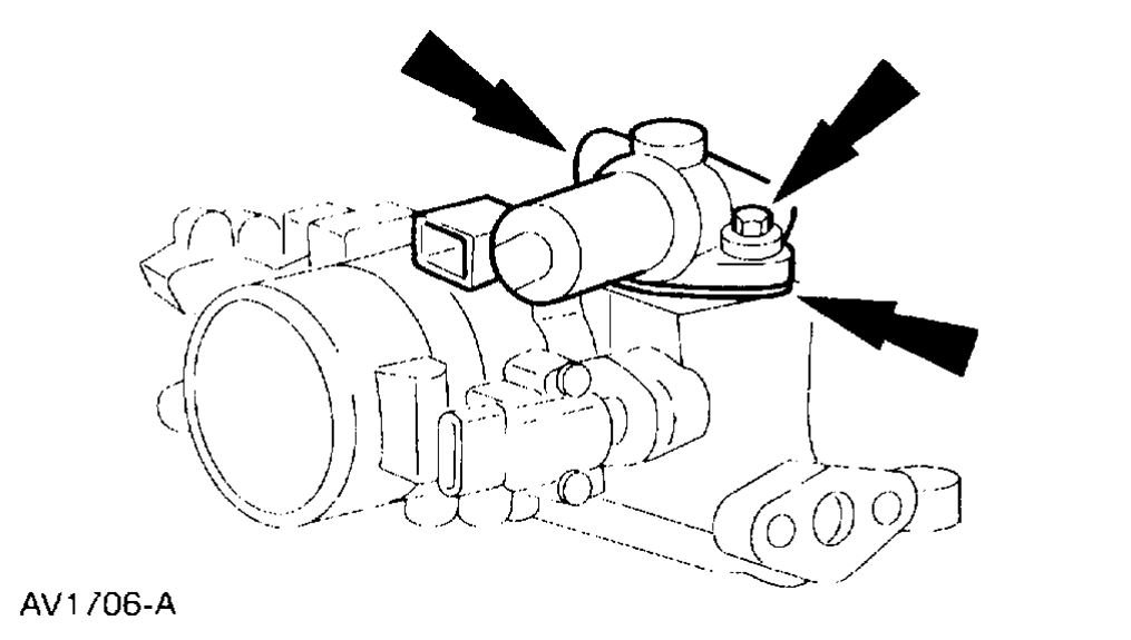

When I am at idle it sounds like the engine is revving.
Oct 14, 2018 at 5:47 PM
Experienced Mechanic
52,796 POSTS
Good morning.
I would start by cleaning the throttle body as the plate may be carboned up from blow by.
Beyond that, there is an idle air control motor that may be bad. That is a common failure but will result in a high idle condition.
