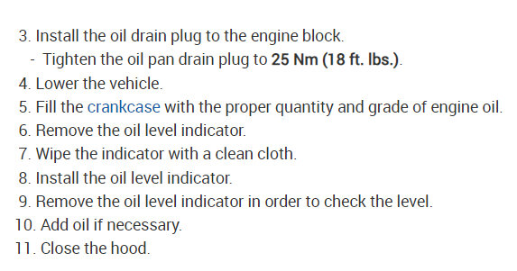

Engine has a knock when first starting it up after sitting overnight. Knock goes away after 30-45 seconds. Knock does not happen after driving and shutting off and restarting.
Jun 23, 2024 at 9:44 PM
  • 55,402 POSTS

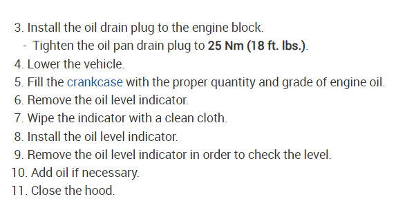

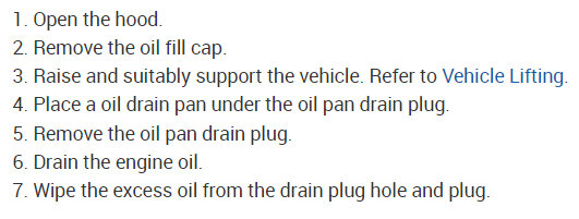

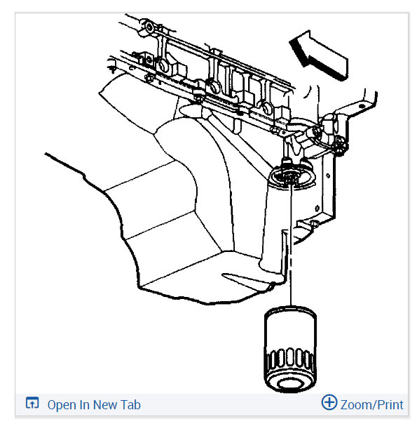

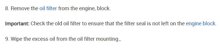

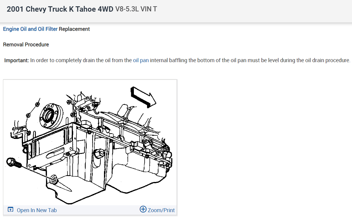

Yep, this is common on high mileage engines because of extended clearances in the rod and main bearings. I would change the oil and filter and use 20/50 weight and add lucas oil stabilizer. Here is a generic guide to help you step by step with instructions in the diagrams below to show you how on your car.
