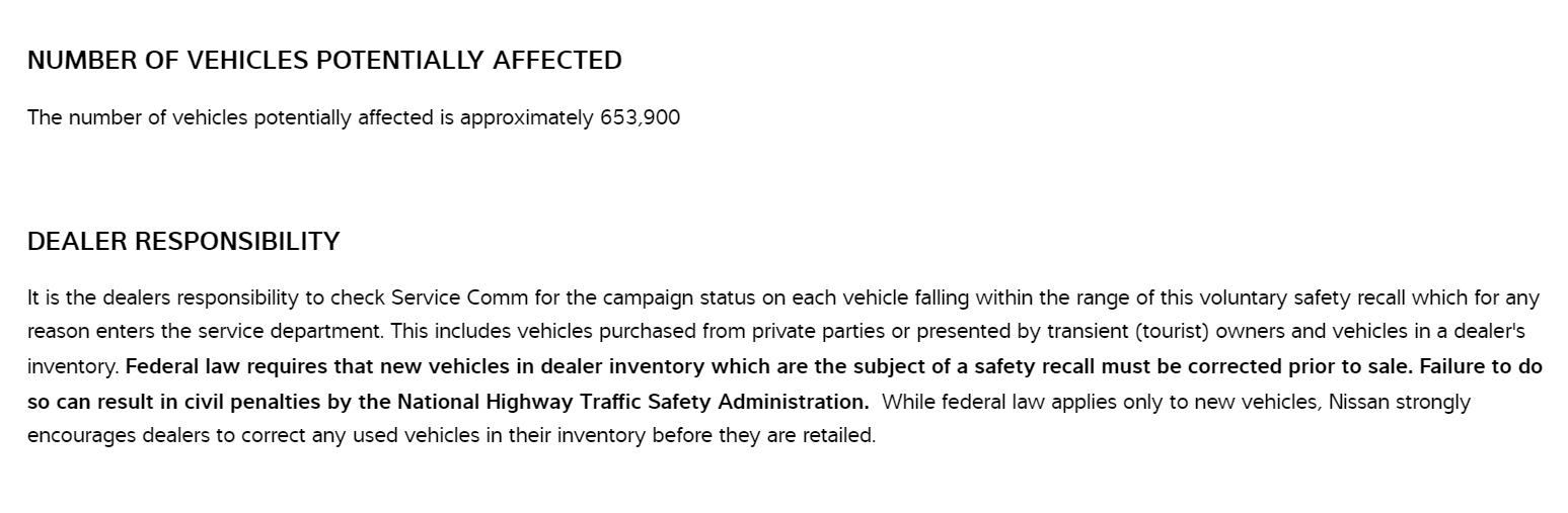

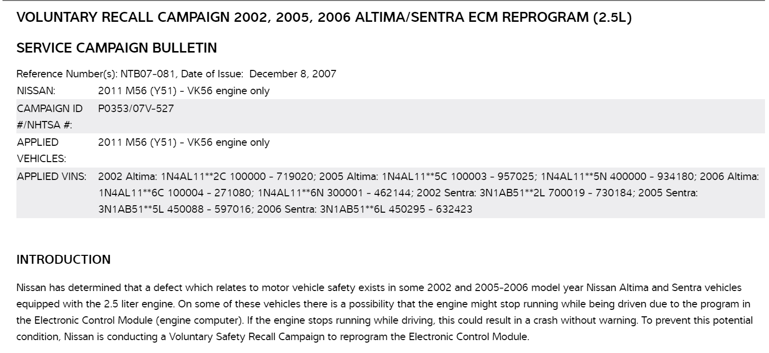

Added below, there is a Technical Service Bulletin (TSB) Related to an ECM Reprogramming. This TSB may or may not be related, but it applies to this vehicle. It has to do with the car just shutting down due to a Programming Error from the factory. So, this is something you may want to have checked, the dealership should reprogram the Engine computer for free.
https://www.2carpros.com/articles/engine-stalls
