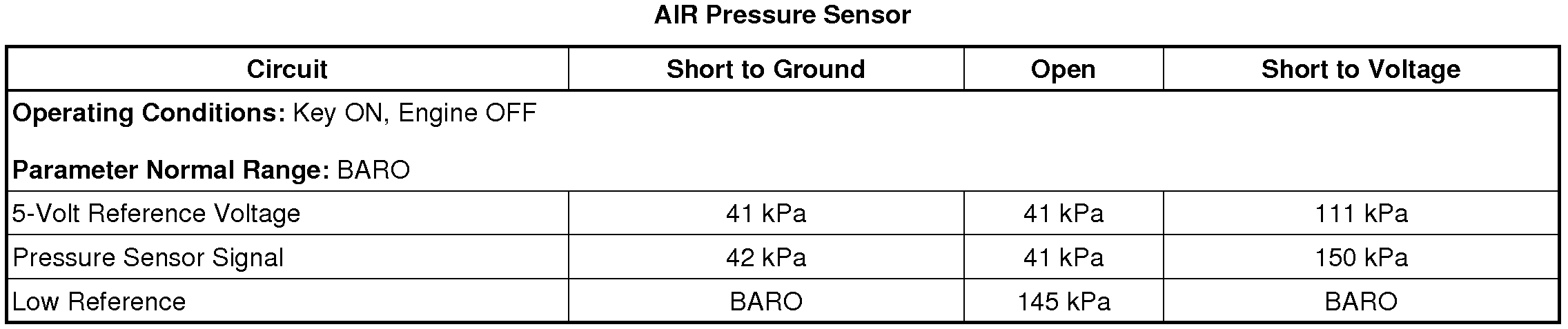

Diagnostic Fault Information
pic 1

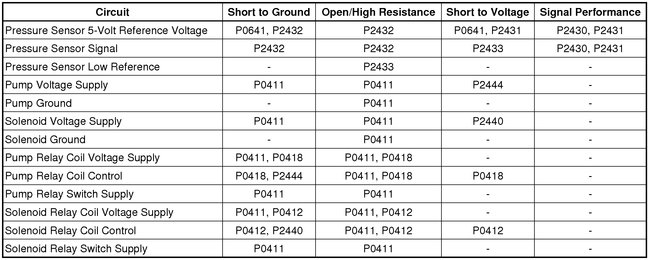

Typical Scan Tool Data
pic 2

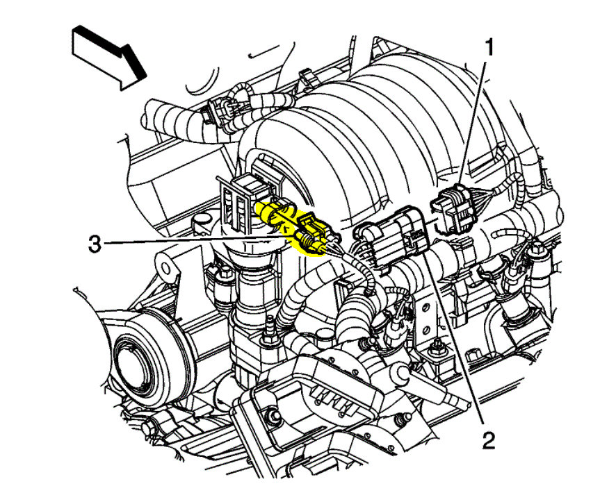

Also, pic 3 shows the pump location. Make sure the connectors I highlighted are tight and undamaged. That could be where the noise is coming from.
Just to reconfirm. This is the only code, correct?
