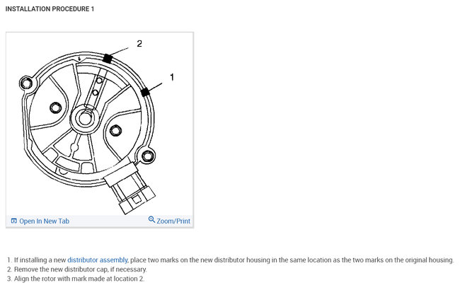

When it gets warm the engine misses. Spark advance runs -2 up to 30 when it gets warm. Motor has 4k sunk original one trying to set time It has p1345 correlation code. New distributor, crank sensor. AC Delco ICM everything but ECM. Get a non communication also. Any answers out there? Truck listed above is a k2500.

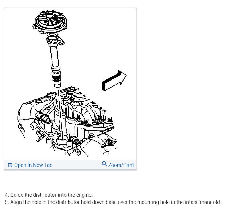

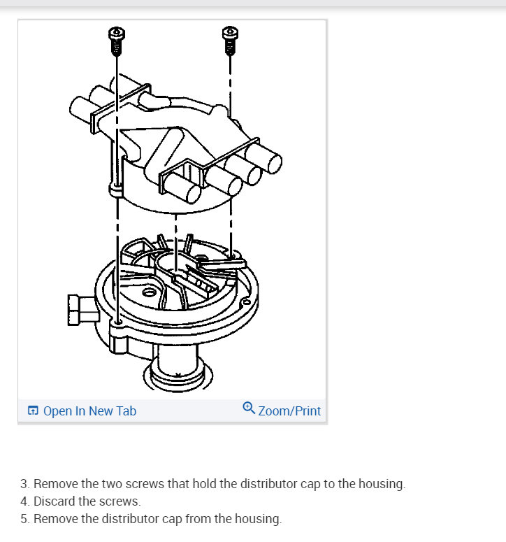

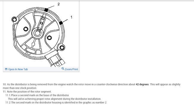

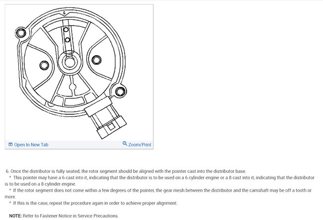

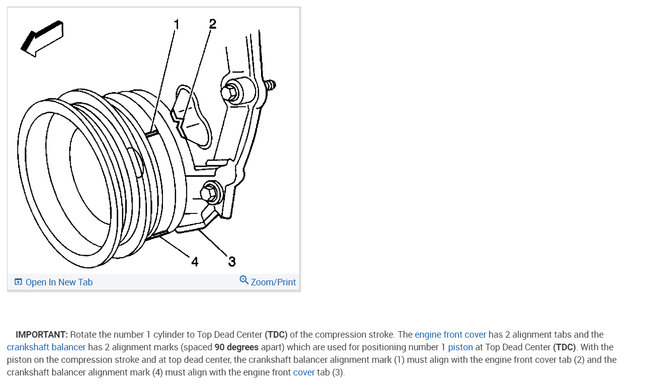

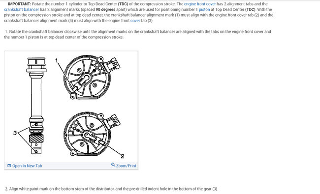

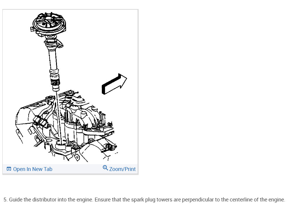

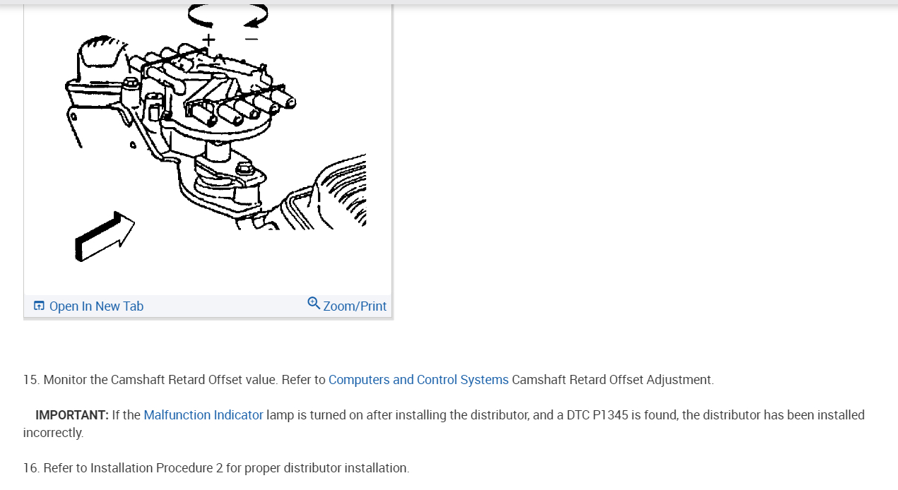

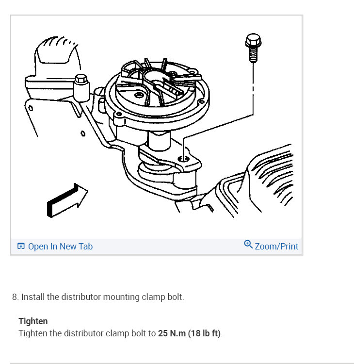

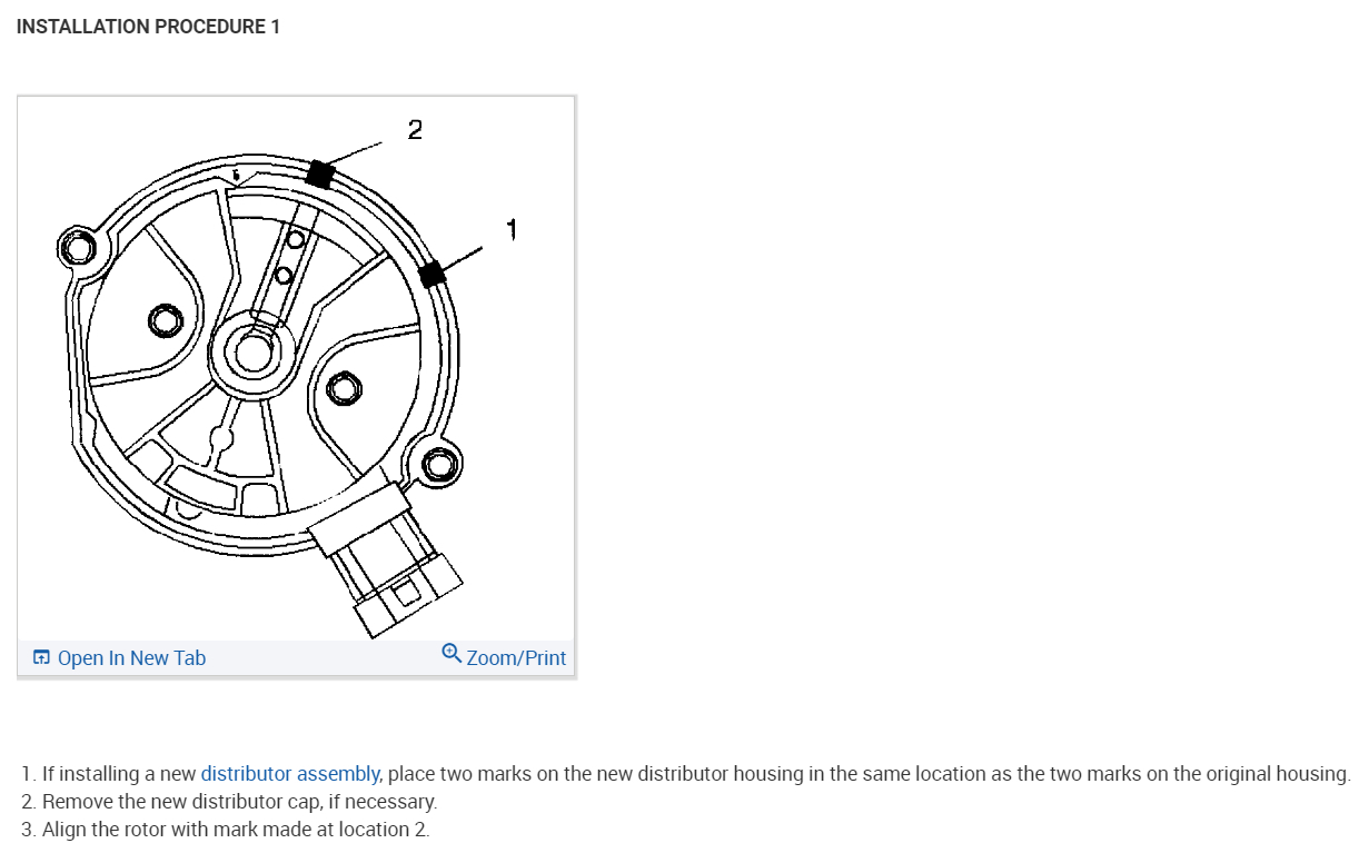

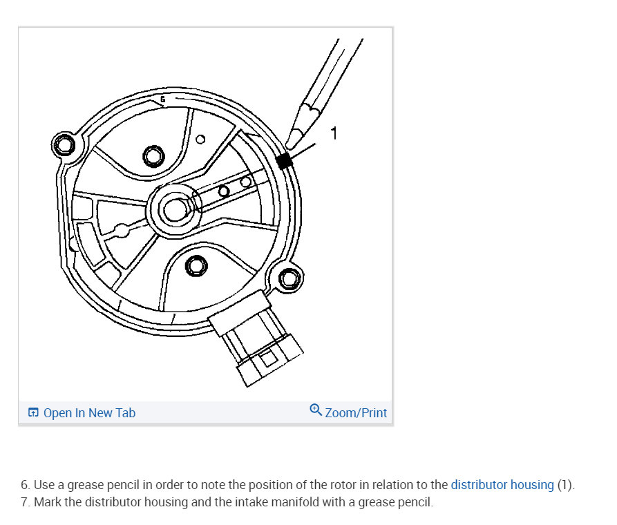

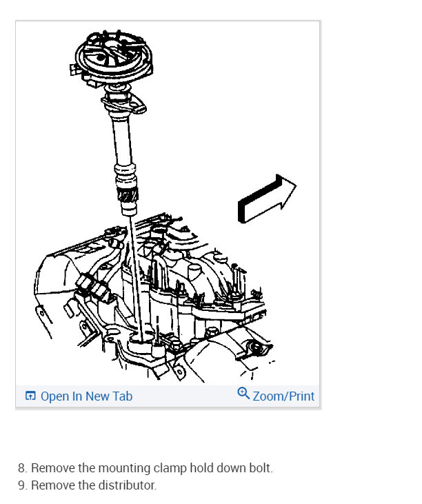

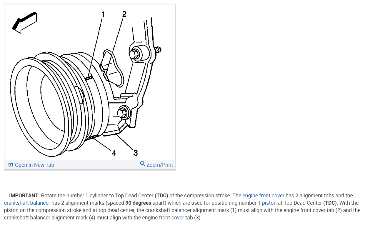

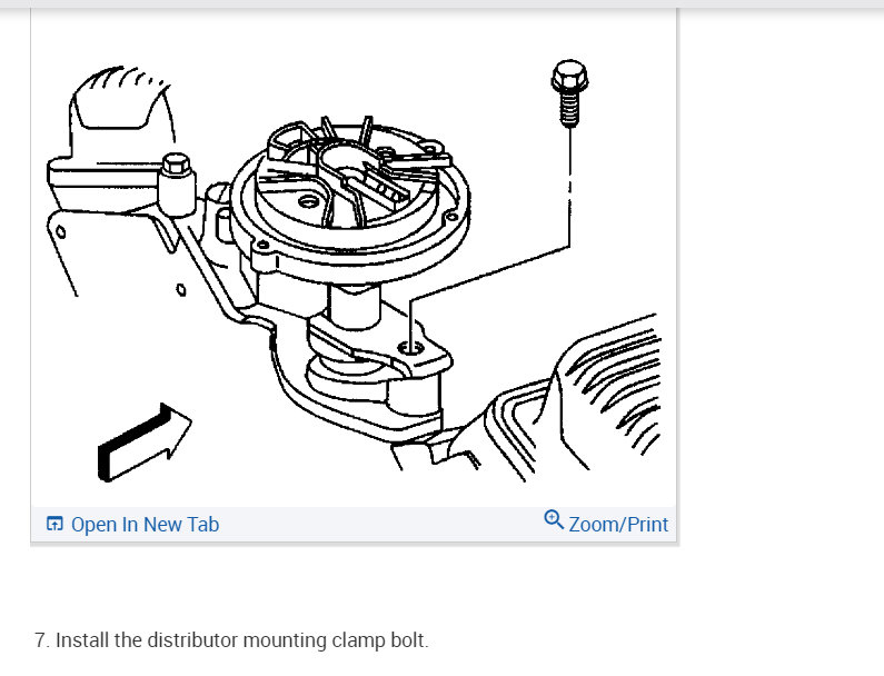

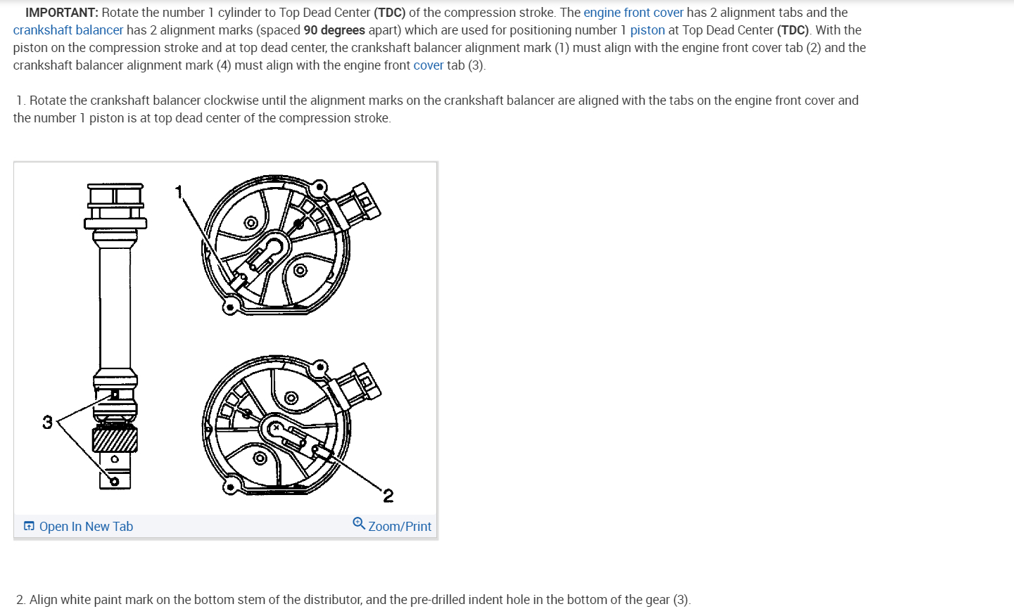

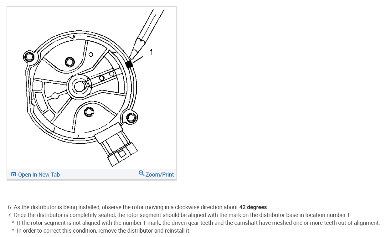

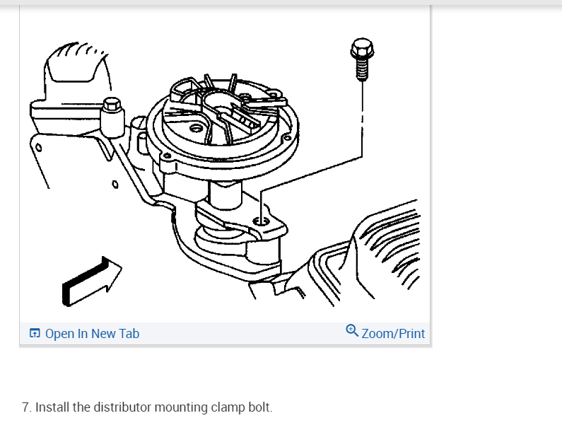

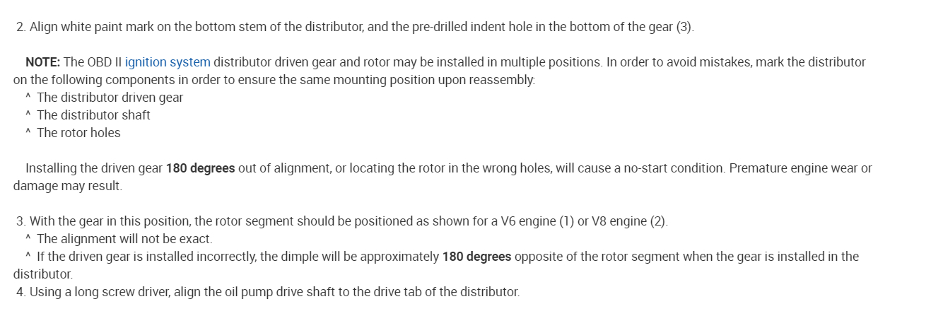

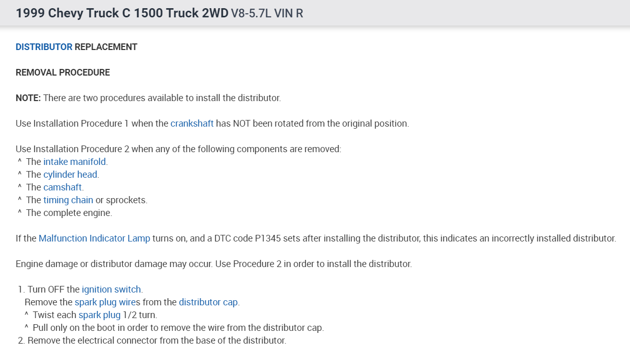

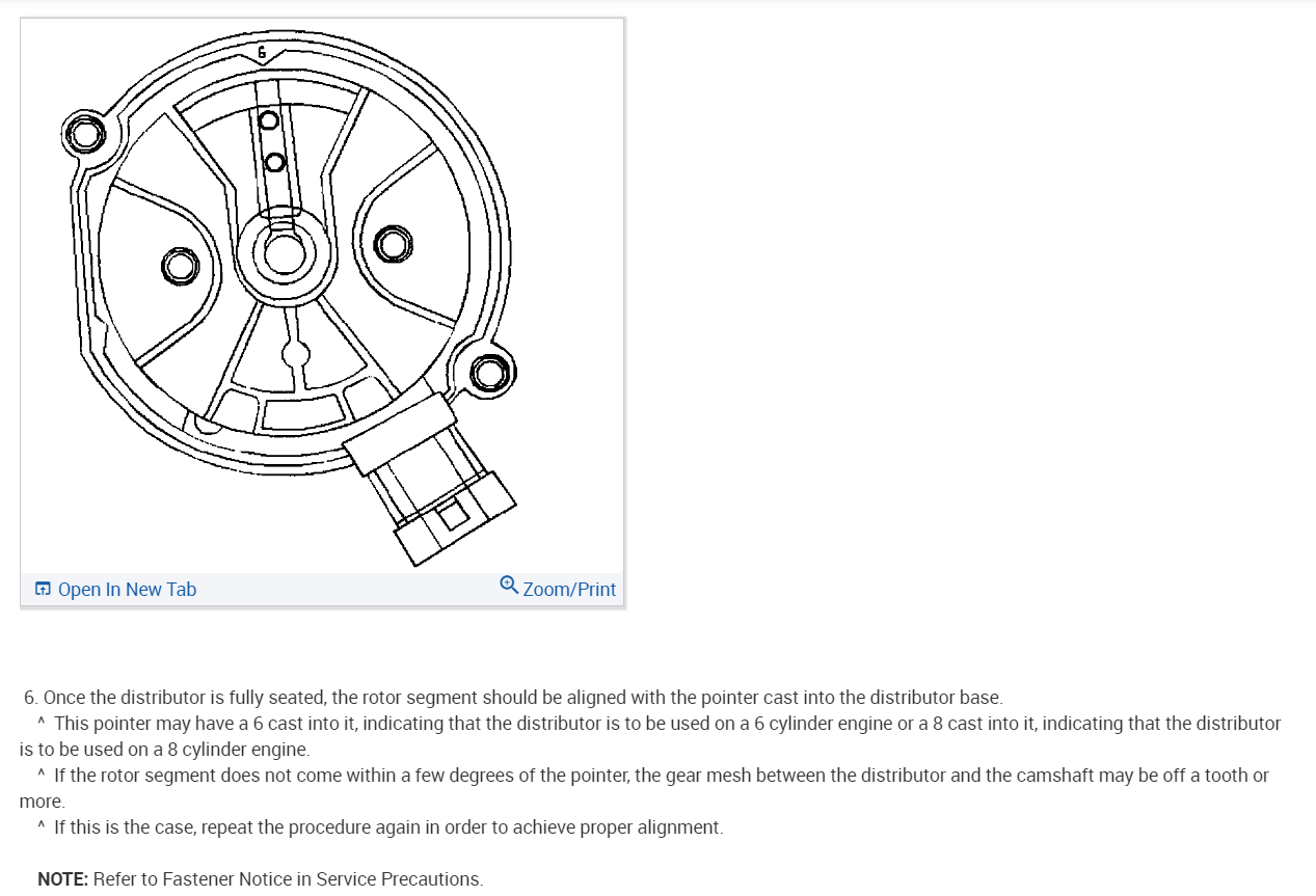

So, the correlation code is because the distributor is a tooth off, I would put the engine on top dead center and then remove the distributor and turn it one tooth to properly align the rotor to the cap. Check out the diagrams (below). Please let us know if you need anything else to get the problem fixed. The no communication problem you will need to start a new question for because we only handle one problem per thread.

Have it TDC.
Aug 18, 2022 at 3:38 AM
  • 55,399 POSTS
Okay, does the distributor line up with the images above. It even says if the distributor is off it will cause this code.
Aug 18, 2022 at 11:51 AM
HBMG
  • 6 POSTS
So, I did what you said matched up diagrams connected scanner to it. Still bucked and burnt com and came up?

Were they off before? Also do you have spark plugs wires cap and rotor? and if so are they AC Delco?

Is the correlation code still present?
Nov 1, 2022 at 4:35 AM
HBMG
  • 6 POSTS
No.
