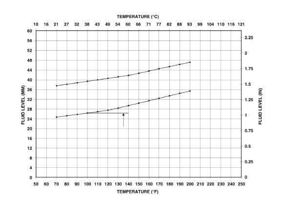

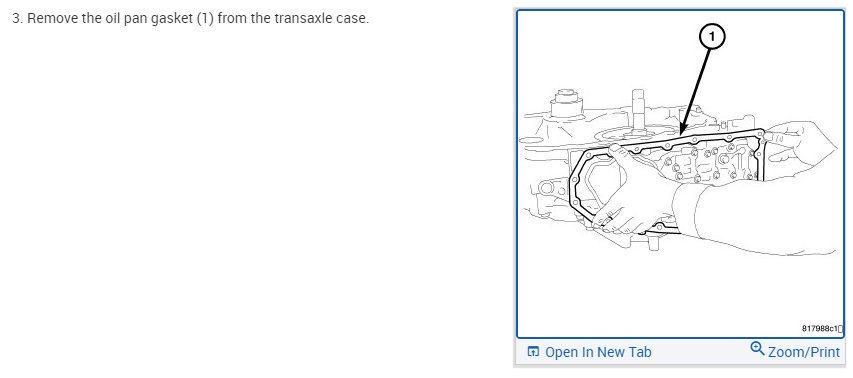

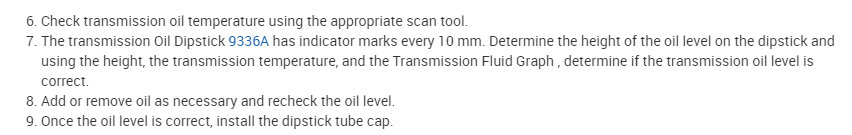

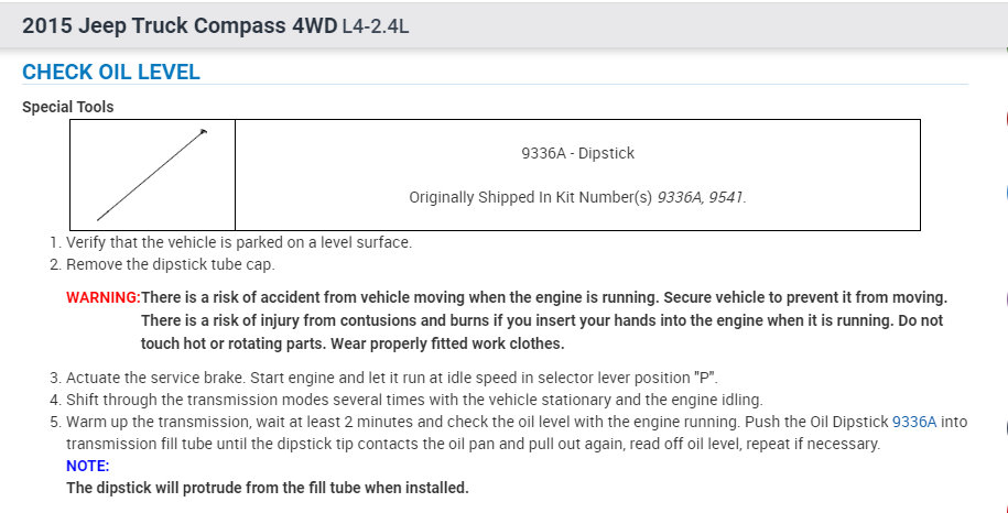

My first concern with this vehicle is the transmission. Have you ever had the transmission fluid serviced? The vehicle has what is called a CVT transmission. (Continuously variable transmission) If you haven't ever serviced it, that is where I would start. If nothing else, I would check the fluid level and condition.
Checking the fluid requires a dipstick. At the top of the dipstick tube will be a plastic plug that is removable. That needs to be removed and then the dipstick can be used. And yes, the dipstick needs to be purchased.

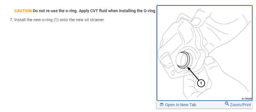

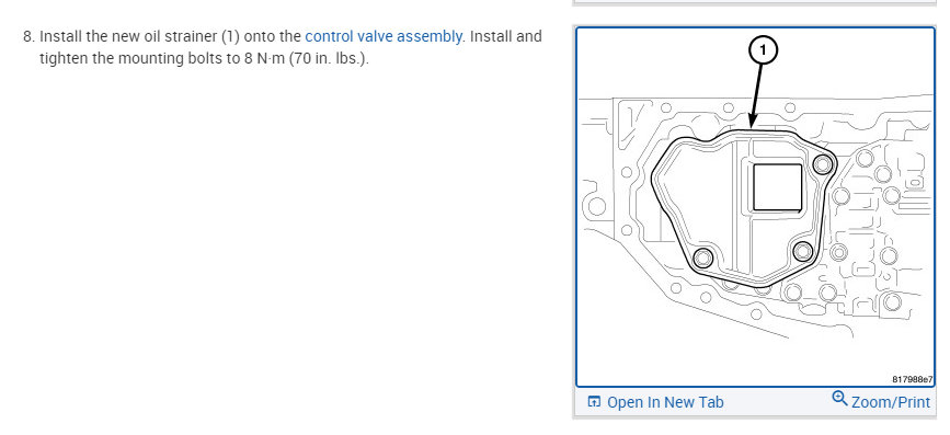

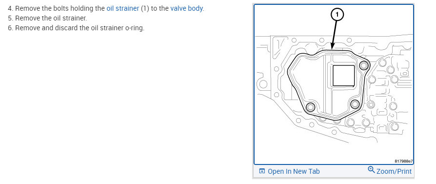

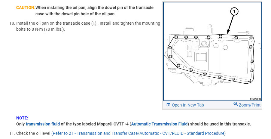

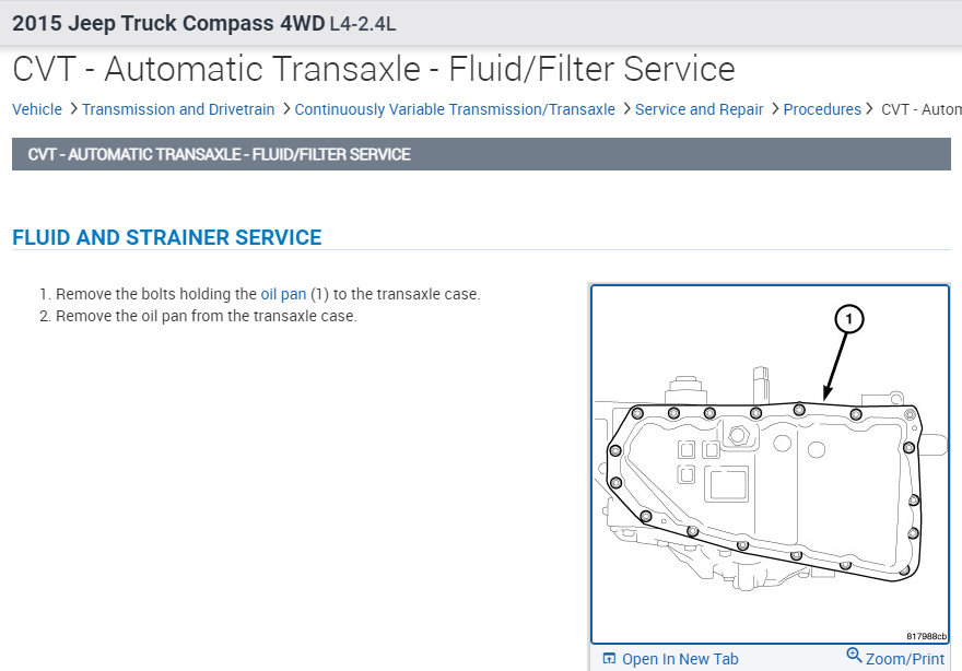

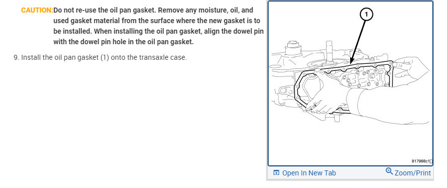

I attached the directions below for checking fluid level. The remaining pics are the directions for servicing the transmission fluid and filter. Please note that you must use the correct fluid in this transmission.
Pics 1-3 are checking the fluid level. Pic 4 provides the fluid type specific to this vehicle. The remaining pics are the directions for servicing the transmission and filter.
