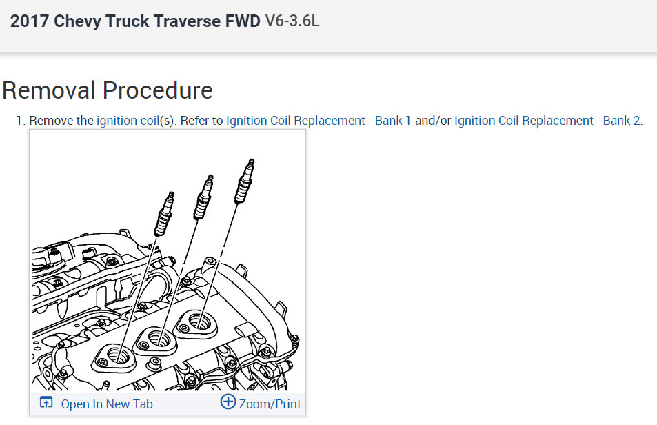

Hello! I have the vehicle listed above; I just got it on Tuesday. When accelerating from low speeds, around 15-20 MPH, it seems like the whole engine shakes for a few seconds and then stops. After that everything is fine, and it drives smoothly until deceleration around the exact speed and it shakes for a second or two again. It has no problems shifting gears.

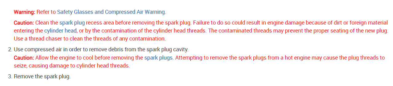

Yep, this is a typical misfire, can I ask you if the check engine light is on or when the last time you had a tune up done? Here is a guide that can tell us which cylinder is misfiring and if any other codes can be affecting the engine.
Can you please shoot a quick video with your phone so I can hear the noise? that way I can tell for sure what's going on.

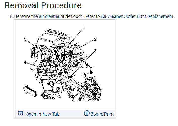

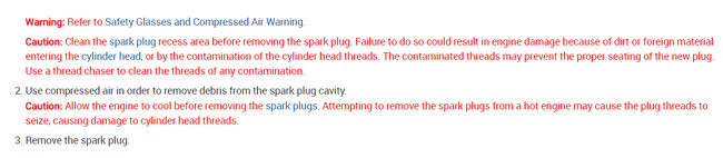

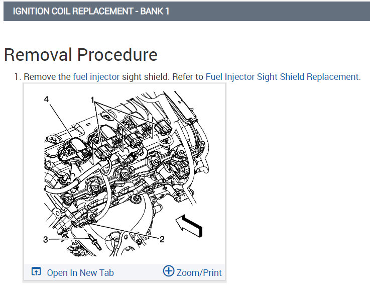

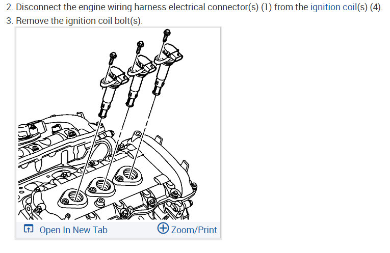

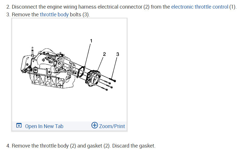

Here is how to change the spark plugs and coils out which I would do. I would also service the throttle body which needs to be done at the time of the tune up.
The spark plug is typically an ACDelco 41-114 or ACDelco 41-162.
