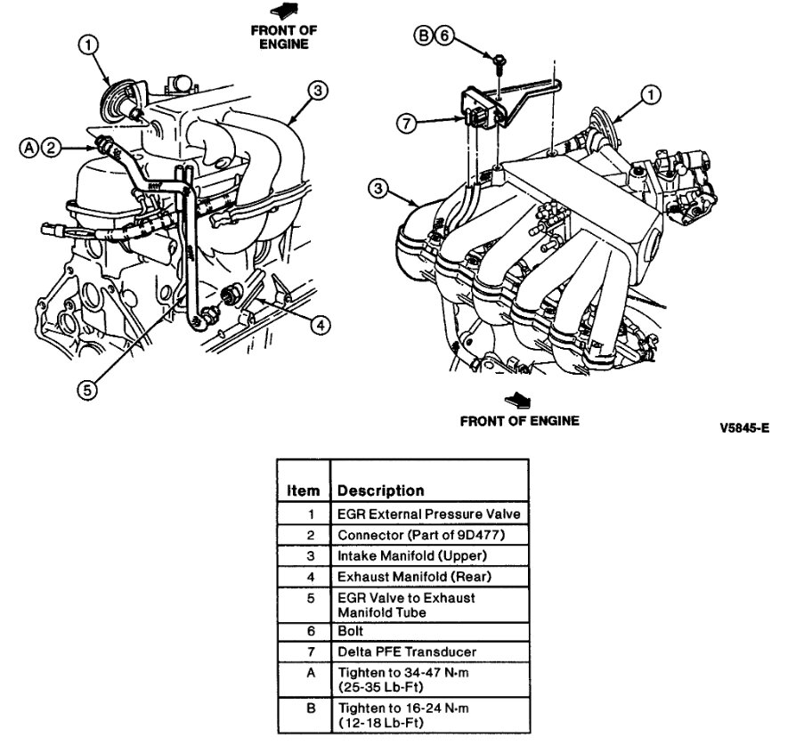

Thanks for the video, it helps. here is a guide to help with the compression test because it looks like you may have a burnt exhaust valve which the test will show.
Also, I would check the EGR valve to make sure it is not leaking or getting held open by vacuum which you can check by simply removing the vacuum line at idle. Here is an additional guide to help and I have included a video on how to check the EGR valve for internal leakage.
https://www.2carpros.com/articles/repairing-engine-rough-idle-issues
And the EGR valve test.
https://www.youtube.com/watch?v=DqUCbbKdWf4&t=12s
Here is the location of the EGR valve for your truck, check out the images (below). Please let us know what happens.

the EGR is brand new, and all the valves are lapd and polished all clean and i tested them for leaks no leaks is it possible that the EGR could just be faulty in general even if new? or maybe other issues? that motor is different than mine i have a 96 ford f150 5.0 v8 302.
