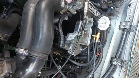

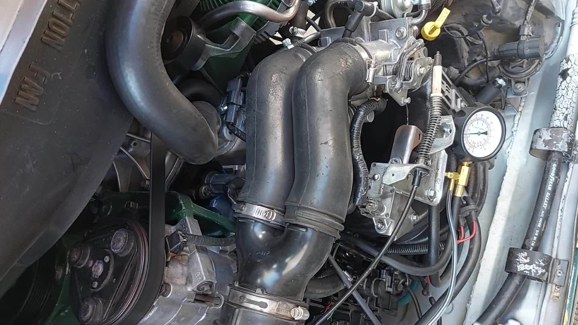

when i rev the motor the engine shakes badly i don't know what's going on.
Things I've changed/fixed.
Fuel pump : New
Fuel injectors : cleand not new
O2 Sensors : OLD
Engine mounts : New and Torqd
Vacuum Hoses : All checked no cracks or leaks that i can see
Fuel : New NOT old
Fuel Regulator : New
Fuel Pressure : 35 psi was 15 replaced fuel pump with New one
Gaskets : all new intake/lower intake/heads/exhaust so on
i did Lap the valves and check for leaks with water and a oil test No Leaks i have NOT checked compression yet after new fuel pump i could check that any help would be amazing thank you. also here is a video to show.

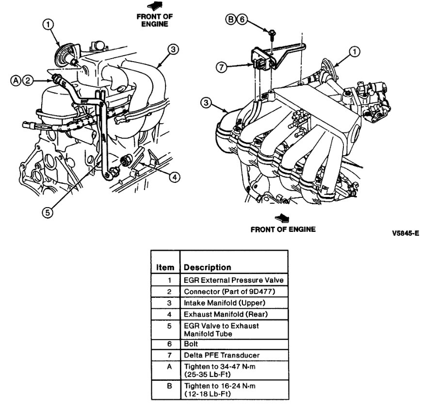

Also, I would check the EGR valve to make sure it is not leaking or getting held open by vacuum which you can check by simply removing the vacuum line at idle. Here is an additional guide to help and I have included a video on how to check the EGR valve for internal leakage.
https://www.2carpros.com/articles/repairing-engine-rough-idle-issues
And the EGR valve test.
https://www.youtube.com/watch?v=DqUCbbKdWf4&t=12s
Here is the location of the EGR valve for your truck, check out the images (below). Please let us know what happens.

the EGR is brand new, and all the valves are lapd and polished all clean and i tested them for leaks no leaks is it possible that the EGR could just be faulty in general even if new? or maybe other issues? that motor is different than mine i have a 96 ford f150 5.0 v8 302.
