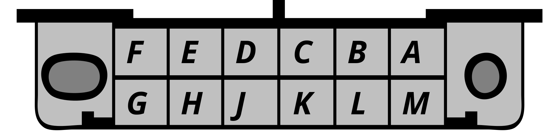

Lumière "engine service soon" allume en ralentissant à l'entrée d'un village

Being an 88 that has OBD 1 on it and you can read the codes on those with a piece of wire. The code would tell you what system the computer sees an issue with. The codes however are limited in terms of what they really tell you.
https://2carpros.com/articles/buick-cadillac-chevy-gmc-oldsmobile-pontiac-gm-1983-1995-obd1-code-definitions-and-retrieval-method/
Tells you how to read them yourself. The connector looks like the attached image. It is commonly under the dash on the drivers side of the vehicle. To read the codes you just turn off the key, install a jumper wire (any conductive item works. I commonly used a paper clip) between the A and B terminals at the top right. Then turn on the key and count the flashes of the light. The code will repeat 3 times so a code 35 would be three flashes, then 5 flashes, then 3 - 5 and then it pauses for a couple seconds and moves to the next code. Normally you will see a code 12 first telling you the system is in diagnostic mode, then 12 at the end to tell you that you have seen all codes, then it will start over. Once you have the code(s) you look at the chart and see where to start.
Hope that gives you a start.

J'ai code 24
Comment faire communiquer innova 3123 OBD1 avec innova 3100j+ OBD2
Nov 7, 2026 at 10:47 PM
STEVE W.
  • 15,421 POSTS
It cannot. All the 3123 has internally is a switch with wires to three terminals. In the ECM position it shorts between pins A and B and in ABS position it shorts pins A and H. No other circuitry inside. It just jumpers the pins like the paperclip would and flashes the light. The 3100 does not have any OBDI abilities and cannot communicate with the correct protocol. For that you need either a vintage scan tool like the Snap-on MT2500 or an OTC Genisys unit with the OBD1 cable and correct software Or one of the newer higher end scan tools with the software and adapters, but the newer ones sometimes don't actually work with OBDI even when they claim they do.
Code 24 - Is a vehicle speed sensor signal fault. That sensor is a simple on-off switch that switches as the vehicle moves. It generates a simple pulse train (2000 pulses per mile) and the speed of the pulses tells the ECM the speed. Testing isn't hard. There is a Brown wire on the sensor that has 12 volts on it when the key is on and the transmission is in gear. Then when the vehicle is moving it grounds the wire to generate the pulse. To test if it is the wiring or a bad sensor you can use a voltmeter. Connect the negative to ground and back probe the Brown wire. Turn on the key and take the shifter out of park, do you have 12 volts? Yes, drive the vehicle. The voltage should vary with the speeds. If instead it doesn't vary, and just stays at below five volts or at battery voltage the speed sensor is bad. If you have a fuel injected engine the sensor is located in the back of the speedometer cluster and has the VSS buffer attached to it. Part number is 25007463
