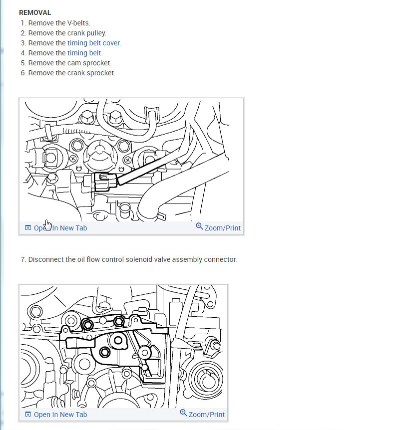

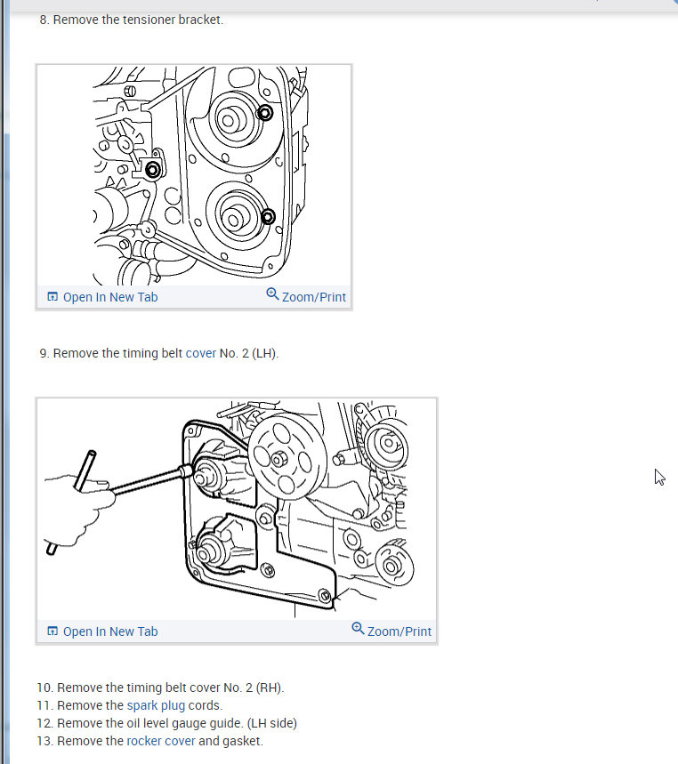

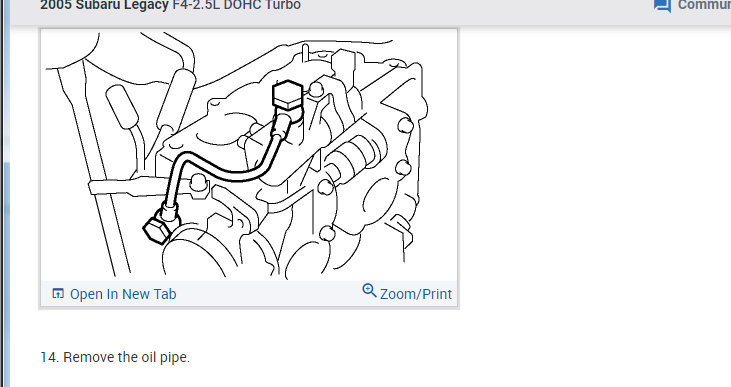

Normally a seized engine is due to lack or oil lubrication either due to a failed oil pump or not enough oil changes. When is the last oil change that you had?
Also, we can pull the rocker cover and see if there is sludge in the engine.
Below is the process for removing this. There would be sludge in the engine if there was not enough oil changes done and this would just explain what happened. Either way, if the engine is locked it is due to the crank bearings having metal to metal and it slowed the engine down and finally seized.
Let's run through this and go from there. Thanks
