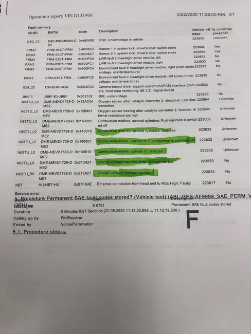

I did take the coincidence under consideration. That's the main reason I didn't flip out when they told me the tech took it for a ride and had to tow it back because the engine locked up. I just need peace of mind. Plus they offered a new engine for $13,000.00 all in the same phone call and every time I ask for the ECM download they send me nonaense print out. I did tell them if they can't give me the reason why it died then let me pull it out for a second opinion. I contacted their major competition and the service manager told me he would have a cooperate BMW tech come and download the codes if any that dealerships can't see.

Sounds like you have the situation covered. The ECM will likely have codes in it, the trick then is which came first, the code caused a failure or the failure set the code, freeze frame data could help there. Could you take a picture of the printout and post it? Maybe I can translate some of it.

BEEMER70
  • 5 POSTS
This is one of the several pages they sent me. Other pages have technical data that doesn't make sense. It's like pulling stubborn teeth getting any info from them.

Well that page has a lot of fault codes which is typical of BMW's, never seen one that didn't have a page of misc. codes stored, but the cylinder 8 misfire could be an indication of a bad injector or coil. Or it may be the cylinder that failed and locked it up. Injector faults are an issue with this engine though so it's possible an injector failed and dumped extra fuel into the cylinder and it misfired. Then it shut off the injection system. Nothing on that page other than the misfire to indicate a problem though. Look over them and see if you can find any mention of rpm or engine load. That would be from freeze frame data.
