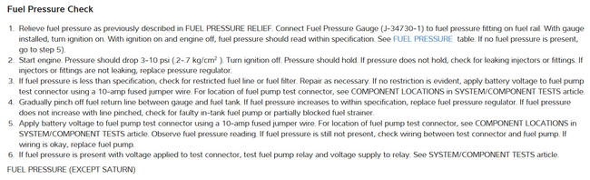

Re-tested Fuel pressure at the fuel rail connector , when switch first turned on, 39 lbs, quickly leaks down to 30 or less, is this normal? Maintains 38 lbs when idling. Thanks

Is the leak down normal, not the pressure, according to service manual, it is too low.

you need another pump and filter, it should be 41-47 psi key on only and not drop more than 5 psi in 5-10 minutes

Put a on a new fuel pump with new pump seal, and 2 new filters, I now have 47 lbs pressure when the ignition switch is turned on, but leaks down to about 38 lbs as before, also only maintains approx 38 lbs when idling, and the rough idle is still there only when cold, for a few couple minutes. I am at a loss for a cause. It acts like a bad coolant temp sensor, but I just replaced that a month ago. What does the fuel pressure regulator do? Thanks

it should only leak down about 2-10 psi also check for a vacuum leak. it may be a vacuum leak like a hose off becaue the computer picks I tup as lean and richens the mixture to stop running rough so check for that and then do check in pic except for pump
Jun 3, 2015 at 6:45 AM
