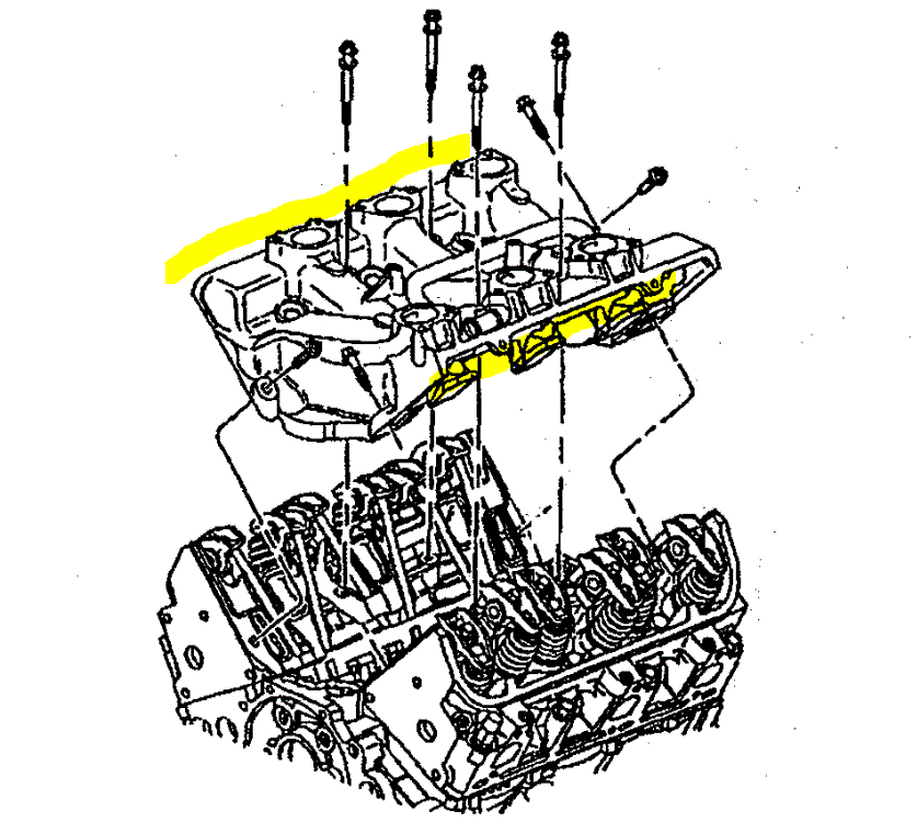

engine feels like it is missing when idling.

If the check engine light is staying on or flashing, you should start by having the computer scanned for diagnostic trouble codes. Most parts stores will do it free of charge.
If the light isn't on, start by checking for engine vacuum leaks. Here is a link that explains how that is done:
Let me know if you have already checked for codes. Also, let me know if you have other questions.

Have not found vacuum leak yet, still looking. Thanks, Tom
Sep 14, 2020 at 5:52 AM
  • 110,240 POSTS
Tom,
When you check for the leak, pay special attention around the intake manifold gasket. They are known to leak. Note there is an upper and a lower intake. The only pic I could find was the intake being removed. I highlighted the areas to check.
