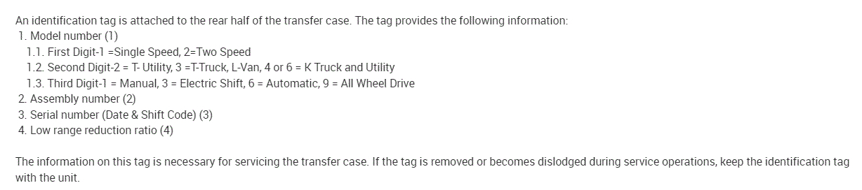

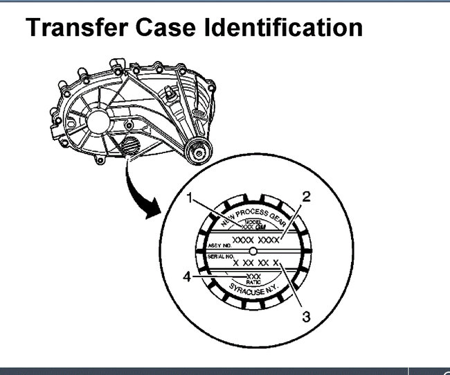

It sounds like the encoder motor may have failed or you may simply have lost ground. I need to know which transfer case you have. It will either be an NVG 246-NP8 or an
NVG 263-NP1 Transfer Case.
If you look at the pics below, they explain how to identify the transfer case in your vehicle.
If you haven't, I would scan the can-bus. I have a feeling you will find code C0306 is stored, but I can't be sure.
Here is a link that explains how to scan the can-bus. This type of scan will retrieve codes regardless of the module storing them.
Let me know what you find. Also, if you could record the sound, it makes and upload it for me to hear, it may help.
