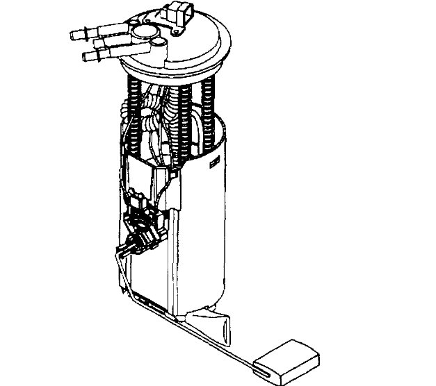

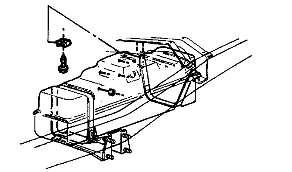

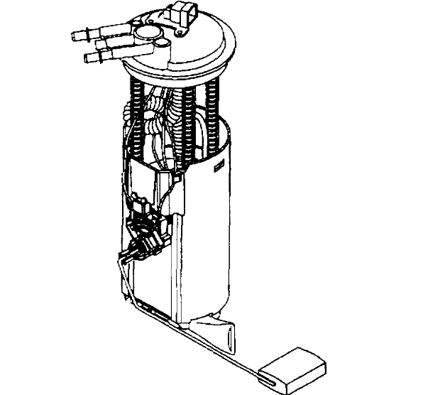

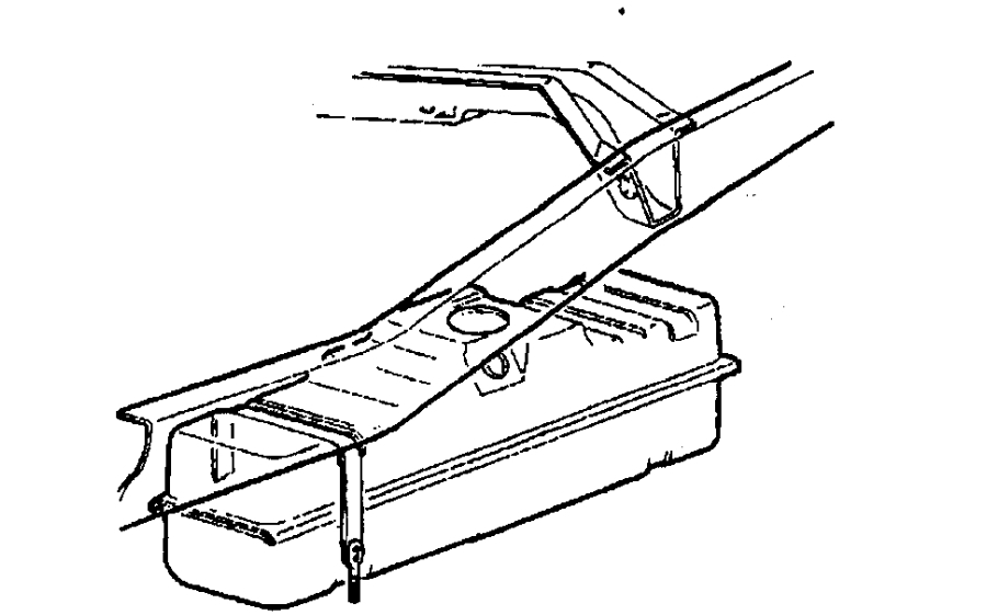

The first thing I would do since it has sat for so long is to drain the fuel tank, have it flushed out, replace the fuel pump and change the filter.
The old fuel is most likely the issue that will not allow it to work.

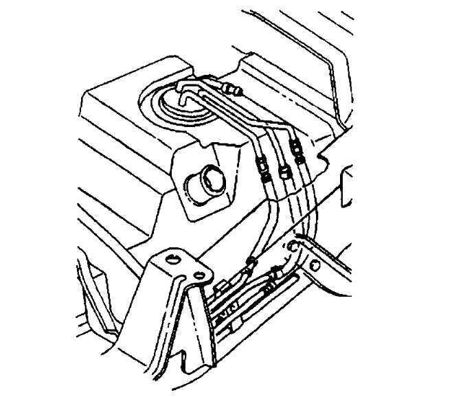

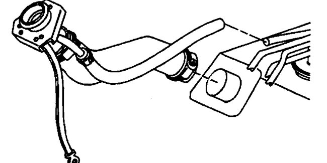

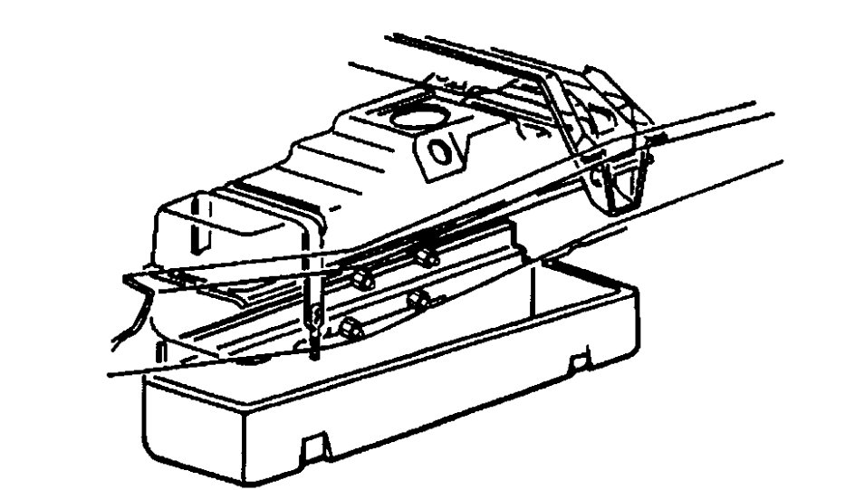

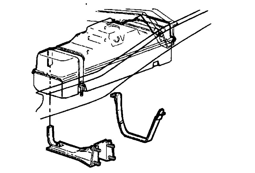

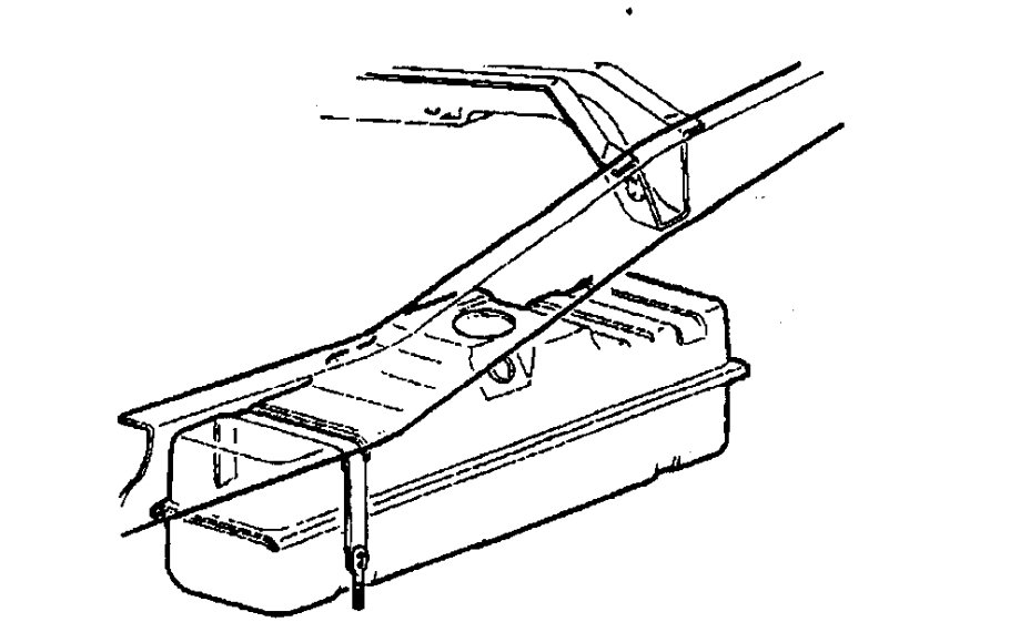

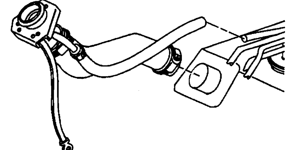

REMOVAL PROCEDURE
1. Drain the fuel from the tank. Refer to Draining Fuel Tank.
2. Raise the vehicle.
Diagram
3. Loosen the filler neck hose clamp at the fuel tank and disconnect the fuel tank filler neck from the fuel tank.
Diagram
4. Support the fuel tank and remove the tank straps and insulator strips, it equipped.
Diagram
5. Remove the frame mounted bracket.
Diagram
6. Lower the fuel tank shield.
Diagram
7. Lower the fuel tank.
Diagram
8. Disconnect the fuel feed and vapor hoses. Disconnect the electrical connections at the sender.
Fuel Sender Assembly
9. Remove the fuel sender assembly and seal ring, using tool J 39785. Discard the old seal ring. Purge the tank, if the tank is being repaired.
