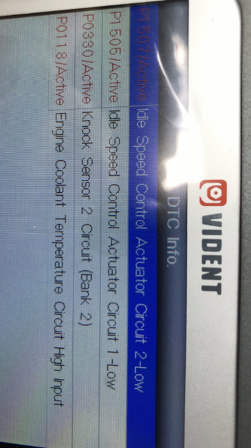

Hi there again, I did check the purge valve and pipes no vacuum leaks. I had the ECU scanned again and in the history it came up with 4 logs. will send you the photo of the history okay. hope this can help. thank you

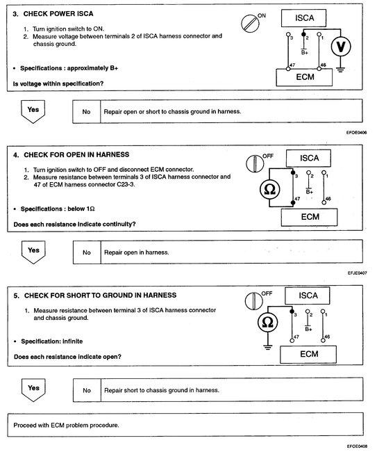

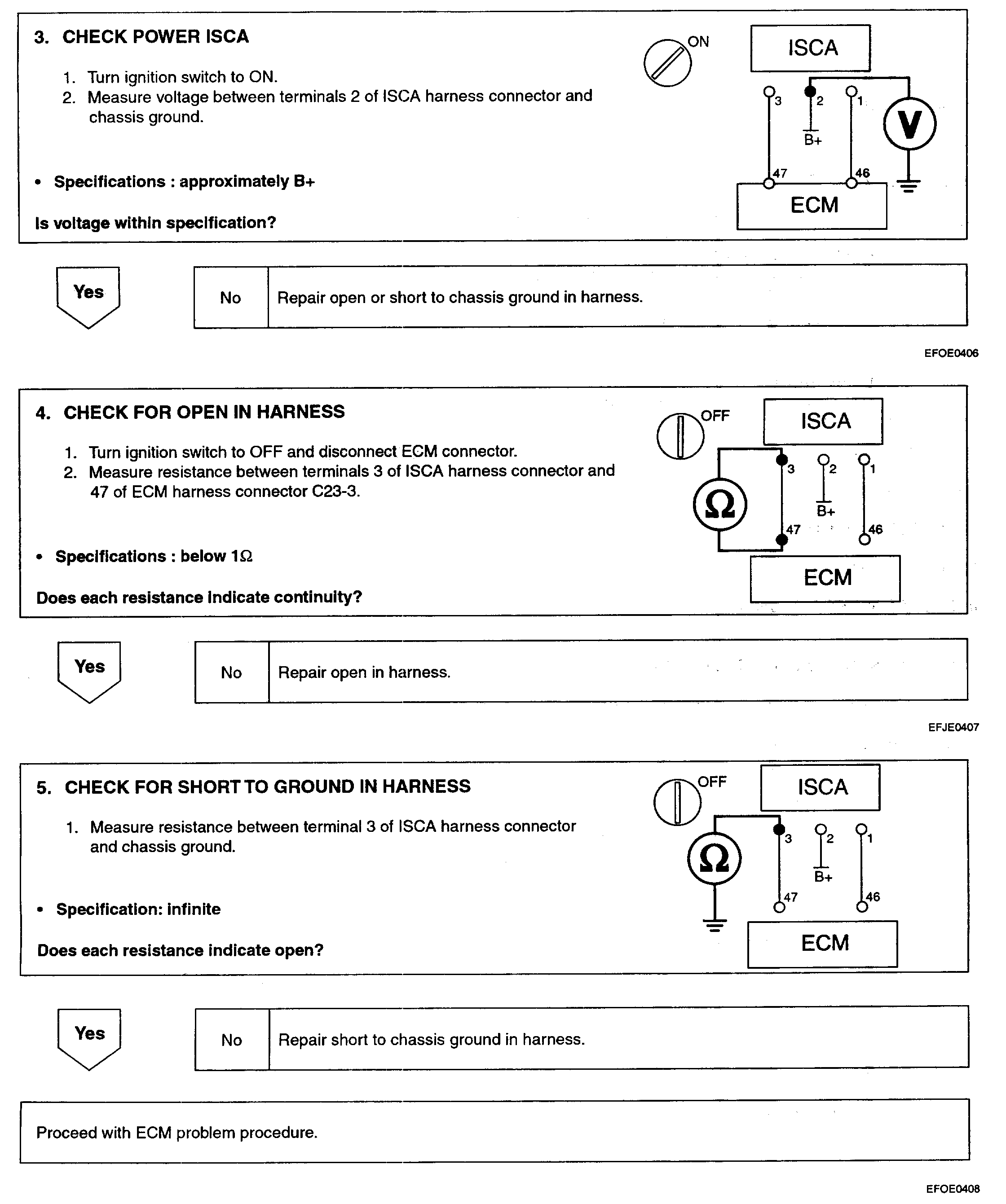

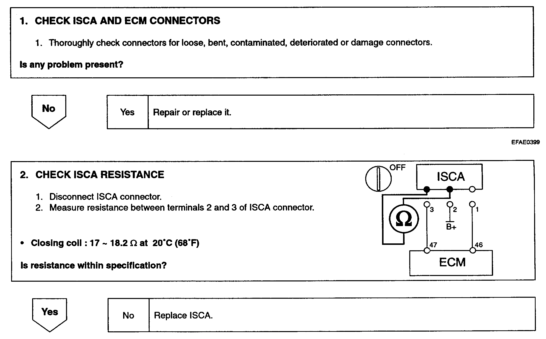

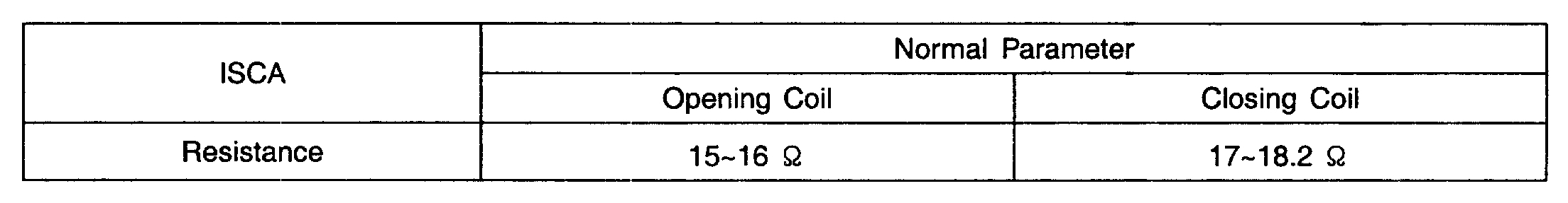

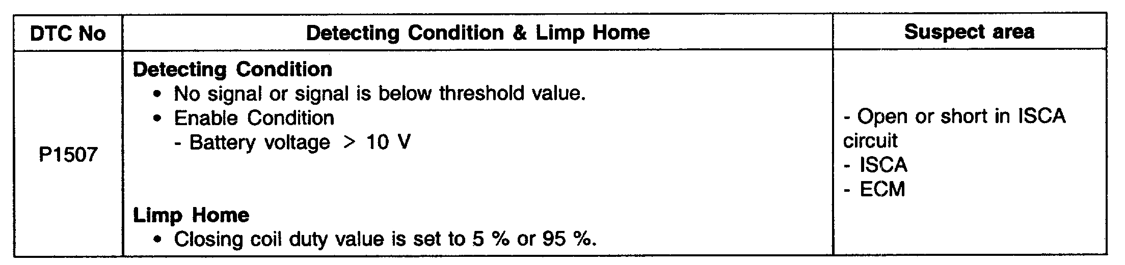

You have a bunch of things happening. First, the IAC is an issue. Also, the coolant temperature sensor and the knock sensor can cause issues.
I attached the directions for testing the IAC below in the pictures.

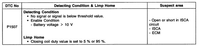

DTC P1507 Idle Speed Control Actuator Signal Low of Coil #2
DESCRIPTION
The idle speed control actuator (ISCA) is installed on the throttle body and controls the intake airflow that is bypassed around the throttle plate. The function of ISCA is to maintain idle speed according to various engine loads and conditions, and also to provide additional air during starting. Moreover, it performs electronic dashpot during deceleration. The ISCA consists of opening coil, closing coil, and permanent magnet. Based on information from various sensors, the ECM controls both coils by grounding their control circuit. According to the control signals from the ECM, the valve rotor rotates to control the by pass air flow into engine.
Let me know if this helps.

I have fitted a new idle air speed control actuator about 3 weeks ago.

The car started fine today but still had very high revs 2,500-3,000 rpm's and the idle air speed actuator sounded like the air was gushing through it , when I unplugged it the idle went back down to normal plugged it back in and the revs were high again , for some reason the air speed actuator is opening too much and idling up the motet to high in rpm. did the checks on the actuator and power input which was 11 volts.

No adjustment on the IAC. I checked it with meter is with in specs you sent me. I have checked a the earth points and cleaned them up under bonnet and under dash. checked the ECU plugs to make sure no bent or broke pins. pulled fuse box apart checked all plugs under side of box all good no hot spots on connectors.
