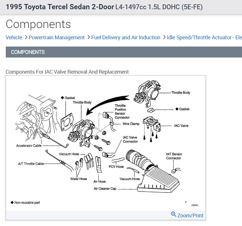

When I start my car the idle is high like it is warming up but it stays high when driving then all of a sudden it will rev really high it will come back down after I keep giving it throttle. Also, it is hard to shift.
Aug 19, 2018 at 4:27 AM
  • 55,710 POSTS
This sounds like the IAC motor has carbon in it and it gets stuck. Here are two guides to help us find the problem and fix it:
https://www.2carpros.com/articles/engine-idles-too-high
and
https://www.2carpros.com/articles/how-to-replace-an-idle-speed-control-motor-iac
