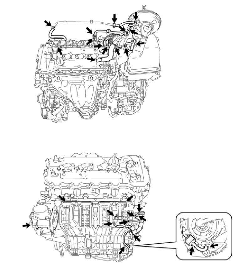

Recently bought the vehicle listed above with 70,000 kms on the clock. Did a full service which includes, engine oil and filter change, CVT fluid change, brake fluid change , coolant change, engine tune up and replacement of spark plugs. After this was done I noticed that the engine revs hang around 1,500 rpm's when slowing down or braking at slow moving traffic speeds. If I accelerate again there is a slight jerk and the engine suddenly revs up to 2,000 rpm's. It’s a bit like when you don’t fully release the clutch when driving a manual vehicle and the engine revs up when shifting through low gears. A bit worried as the car was fine when I bought it. Transmission oil was last changed in 2015. What should I get checked?

Was it Toyota CVT fluid you used in the CVT? Those can be touchy about the fluid used in them. Next I would check that everything was reconnected after it was done. A loose vacuum line could cause the higher rpm. What was done for the tune up? Was the throttle body cleaned as part of it?

With the throttle body cleaned did you do a reset on the learned idle? To do that you remove the EFI fuse and ETCS fuse at the same time. Wait at least 60 seconds and reconnect the fuses. When you start it the system may take a bit to re-learn the idle speed.
For vacuum leaks you can use the image as a guide, the easy way is to use a can of carb cleaner and spray it at the various lines and connectors and listen for the engine to rev up indicating there is a leak. You shouldn't need to bother with the CVT fluid.
