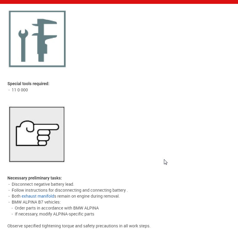

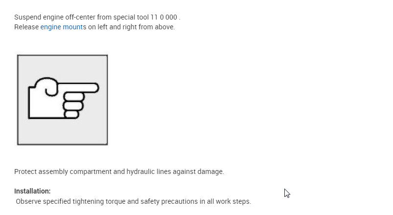

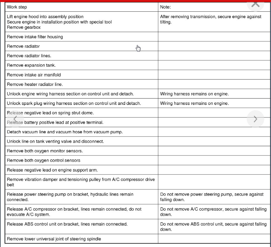

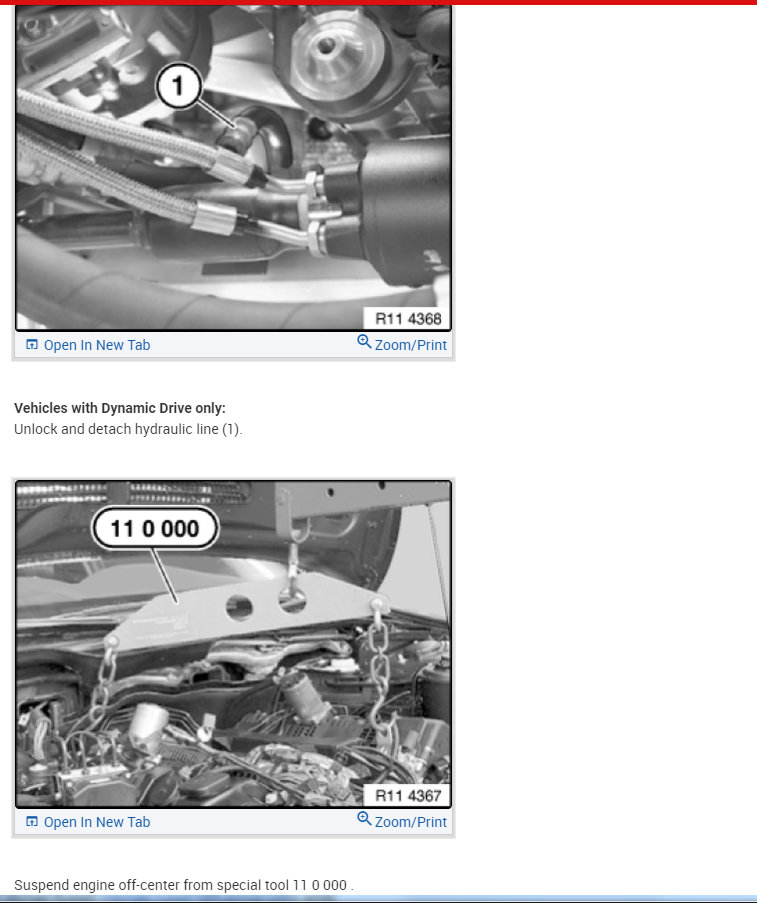

Yes. Clearly you will want to keep everything organized on these. Lay everything out and bag and tag what you are not sure what it is. However, if the engine going in coming out of a running vehicle? If it is running then you should not have to set timing.
I included the basics procedure on what to remove to try and cut down on unneeded steps.
