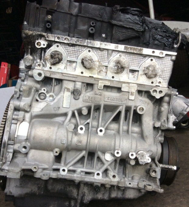

A used bare engine is an engine without any accessories such as; manifolds, alternator and turbo. You would need to strip your existing engine and transfer all components. This would require you to purchase new engine gaskets and new nuts/bolts as required. .

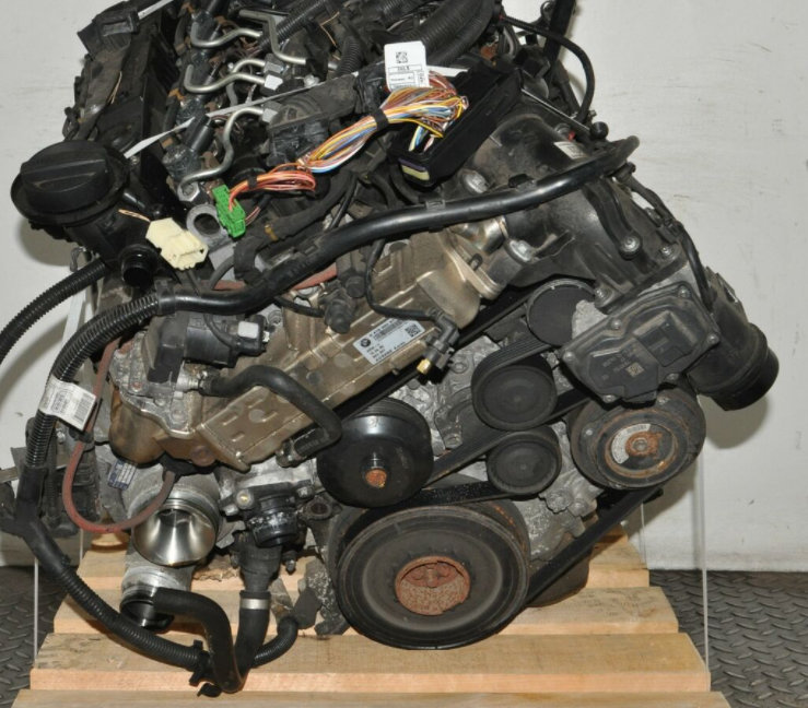

A complete engine would have everything fitted so only minimal or no parts swapping would be required.
Please see pictures at the bottom.
