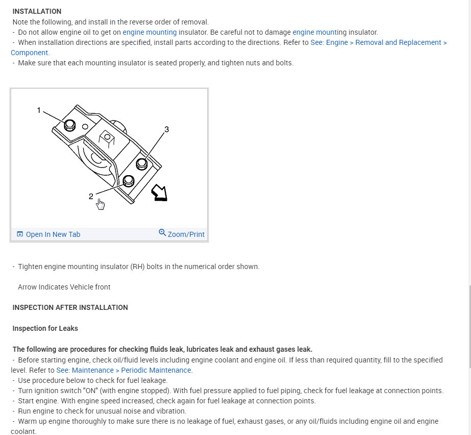

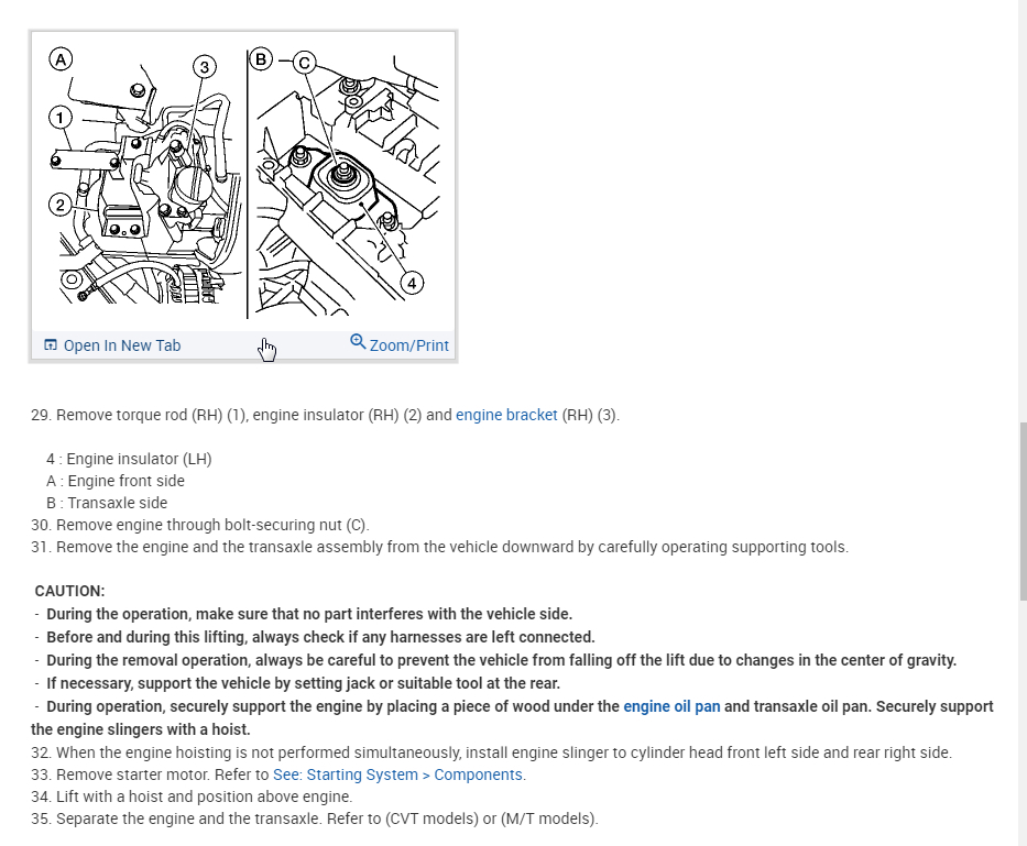

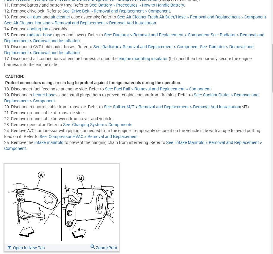

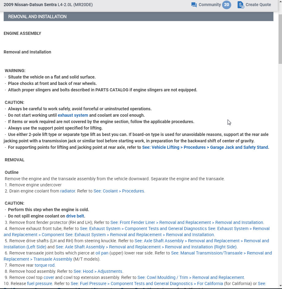

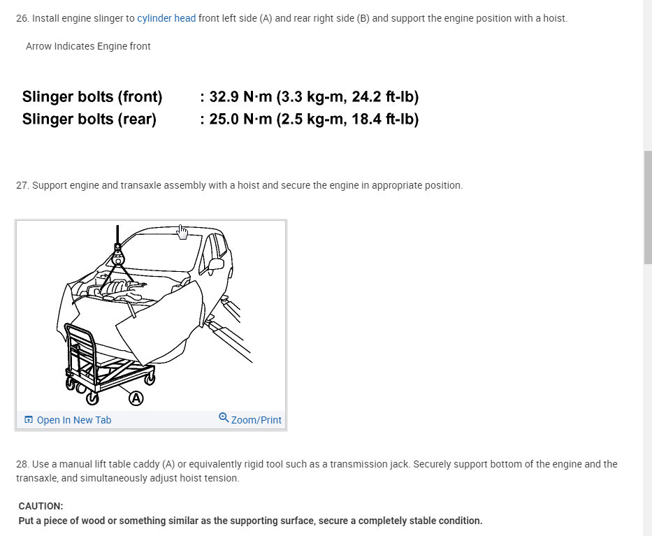

Here is the procedure for the engine. Let me know if you need any information on some of the sub systems that it tells you to remove.
Thanks for using 2CarPros.
Thursday, September 5th, 2019 AT 6:59 PM

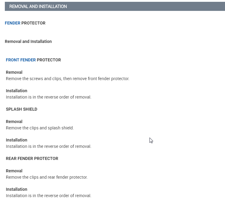

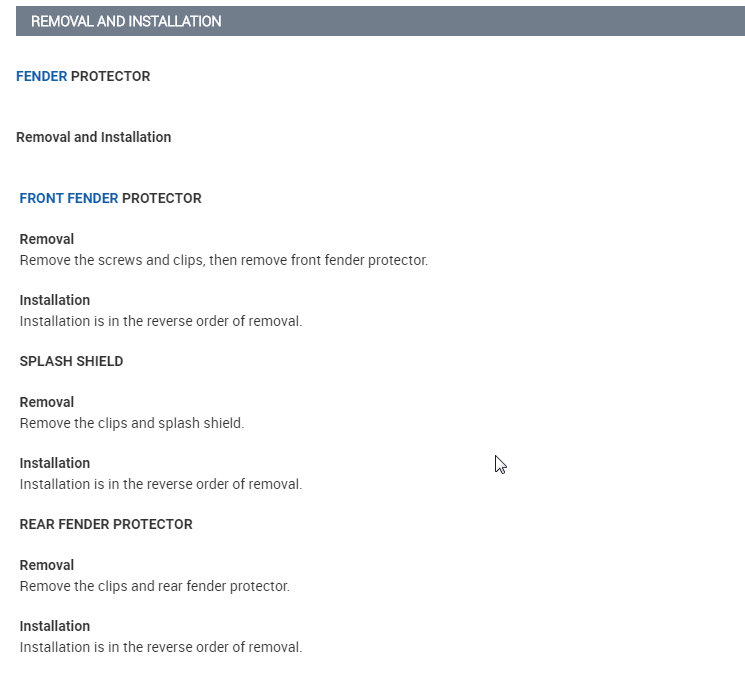

What is a "front fender protector"?
Saturday, September 7th, 2019 AT 11:19 AM
I included the detail about that but unfortunately it is not very detailed. It is the inner fender liner. They are usually black but it is in behind the wheel and made of plastic that protects the fender and engine compartment from getting all the road debris whipped up into it while you are driving.
Saturday, September 7th, 2019 AT 11:55 AM

Are you sure that there is no way the engine can come out from the top?
Saturday, September 7th, 2019 AT 3:16 PM
Anything is possible however, with this being a trans-axle and not a rear wheel drive transmission, there is no easy way to separate the transmission from the engine while in the vehicle, which is why they have you remove them together then separate them.
If you are going to remove it from the top then you will need to separate them and then get a transmission sling in order to support the transmission while you remove the engine or it will fall out. Plus I doubt they will both fit out of the top if you try to take them out of the top together.
From my experience, it is far easier to remove these from underneath. If fact, I have never tried to remove it from the top.
Saturday, September 7th, 2019 AT 8:35 PM

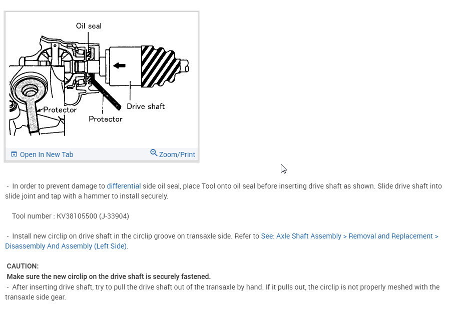

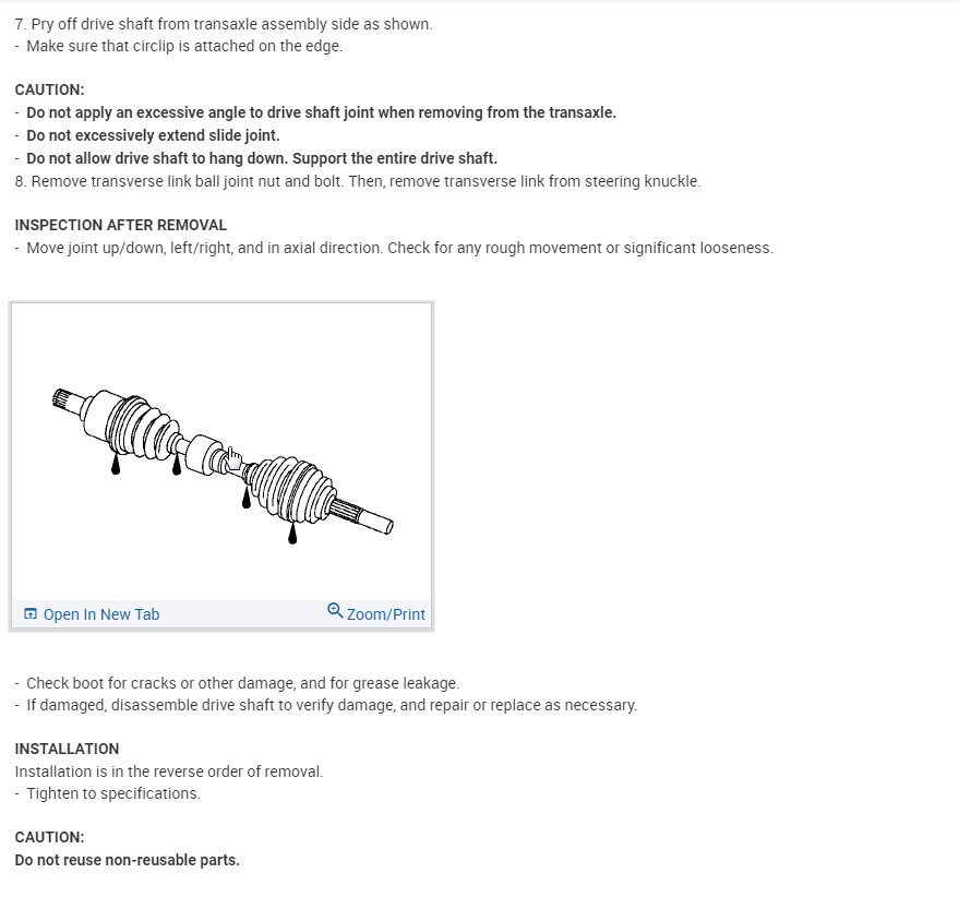

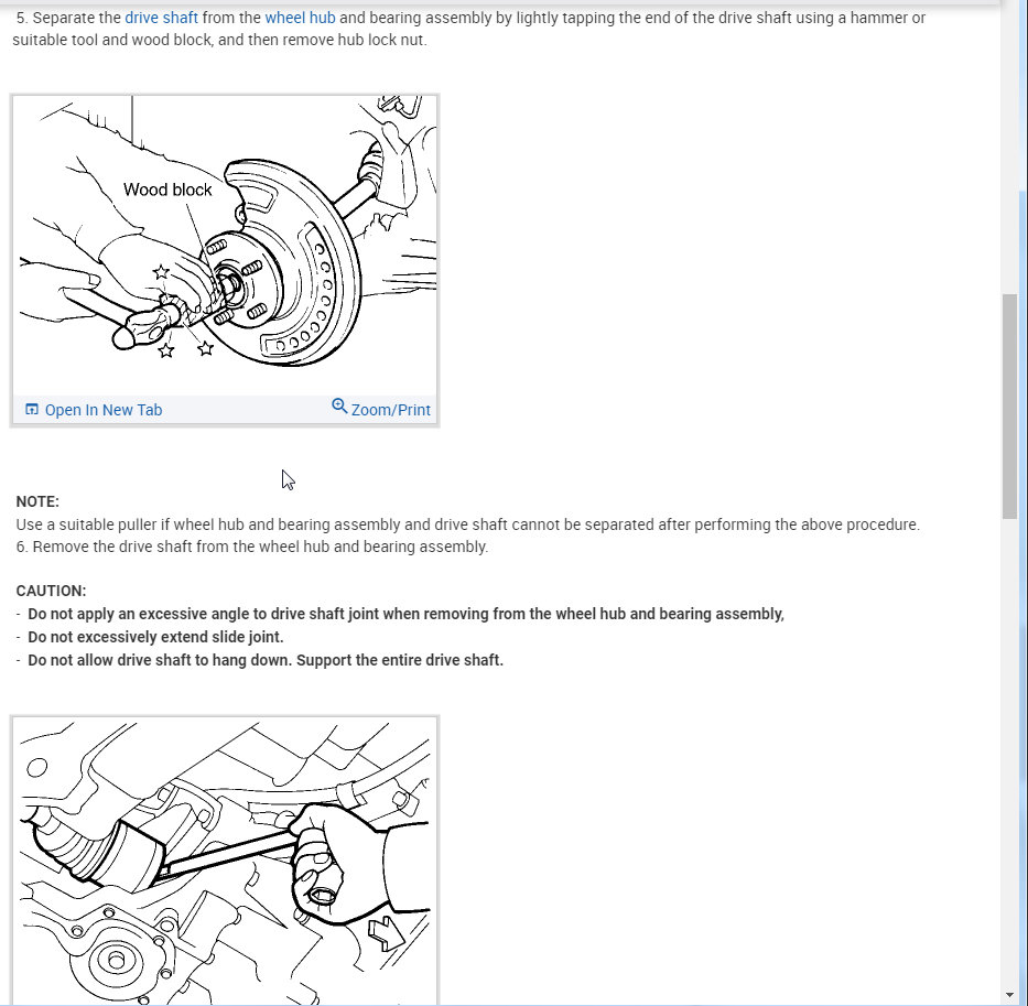

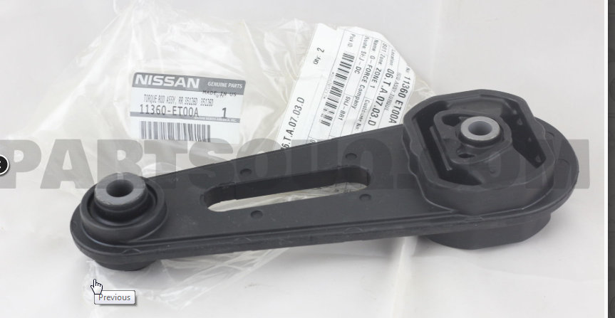

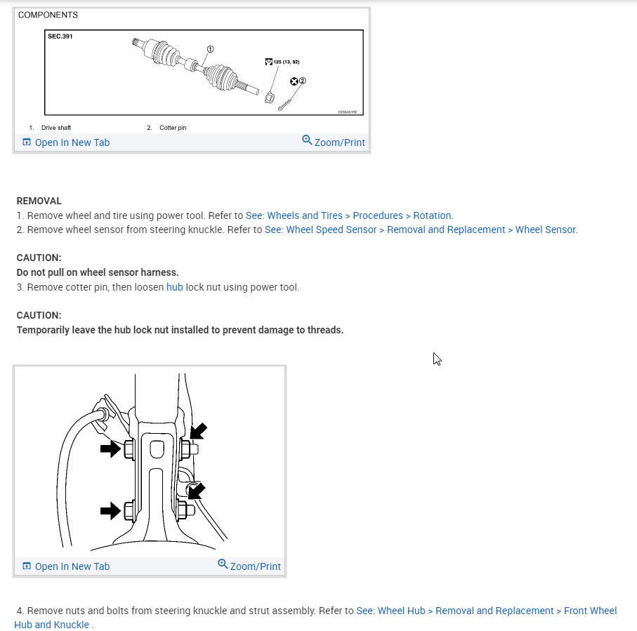

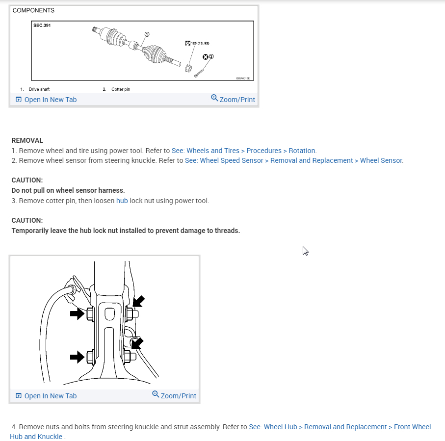

Also, do the axles come out of the steering knuckle or does the entire knuckle have to come off? And, what is a torque rod?
Lastly, this is an automatic transmission so I don't think there are bolts piercing the oil pan.
Sunday, September 8th, 2019 AT 5:16 PM
Here is the process for the axles. You don't need the knuckle and everything. Just the axle shaft because it will hang up in the transmission when you try to drop it out. I attached a picture of the strut rod. It is the mount.
You are correct. The bolts through the pan are for manual only.
Sunday, September 8th, 2019 AT 7:39 PM
