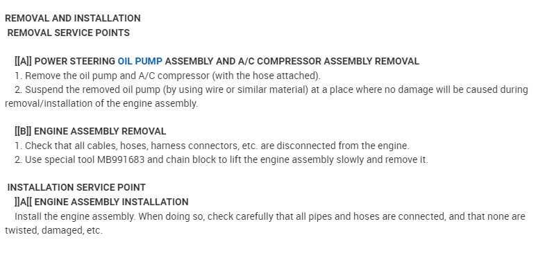

can a 2002 Mitsubishi Montero 3.5l engine replace a 2001 XLS model?
Jul 27, 2022 at 10:41 AM
SQM
  • 6,383 POSTS

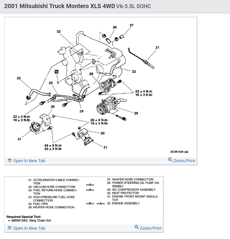

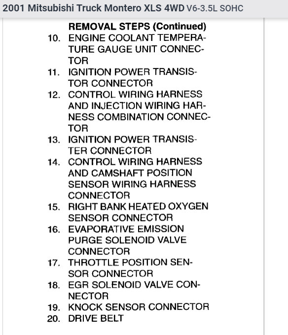

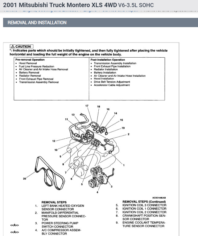

Both the 2001 and 2002 Montero uses the same 3.5L V6.
So as long as both of the vehicles have the 3.5L (not the 3.0 Montero Sport), it will work.
I have attached the engine replacement steps below for your reference.
Let me know of any questions.
