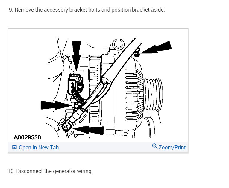

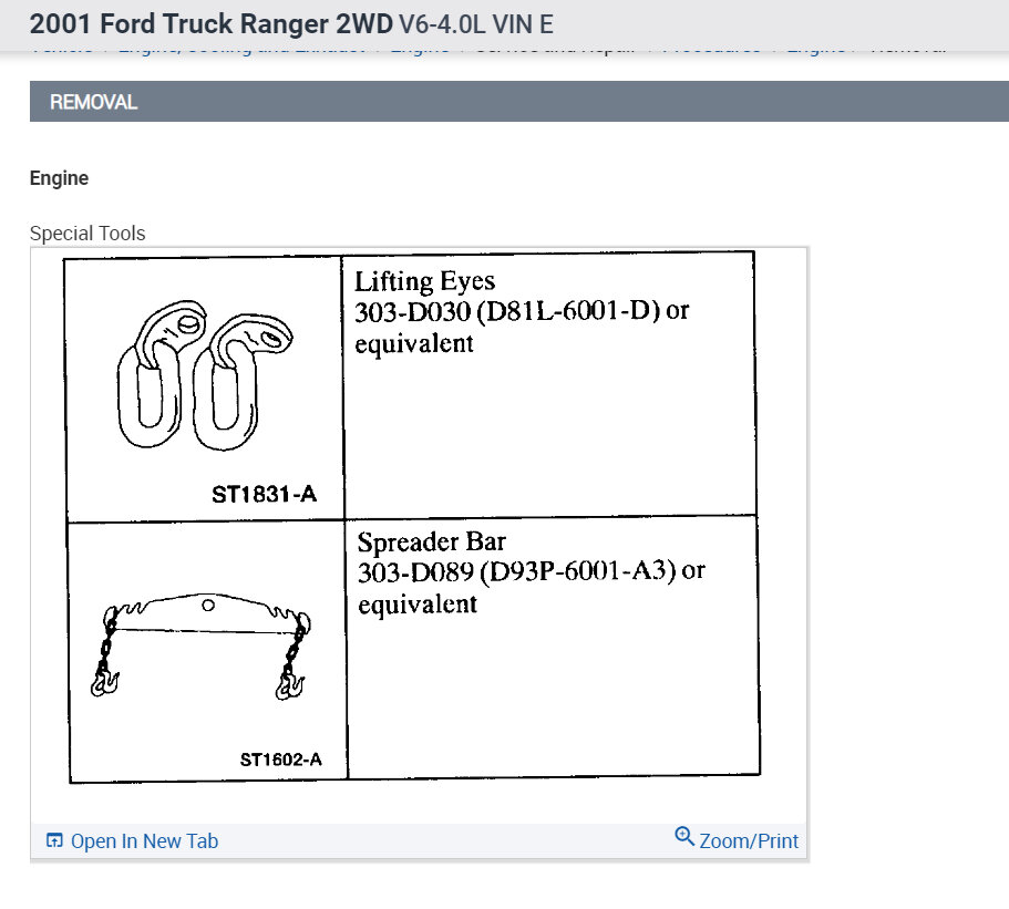

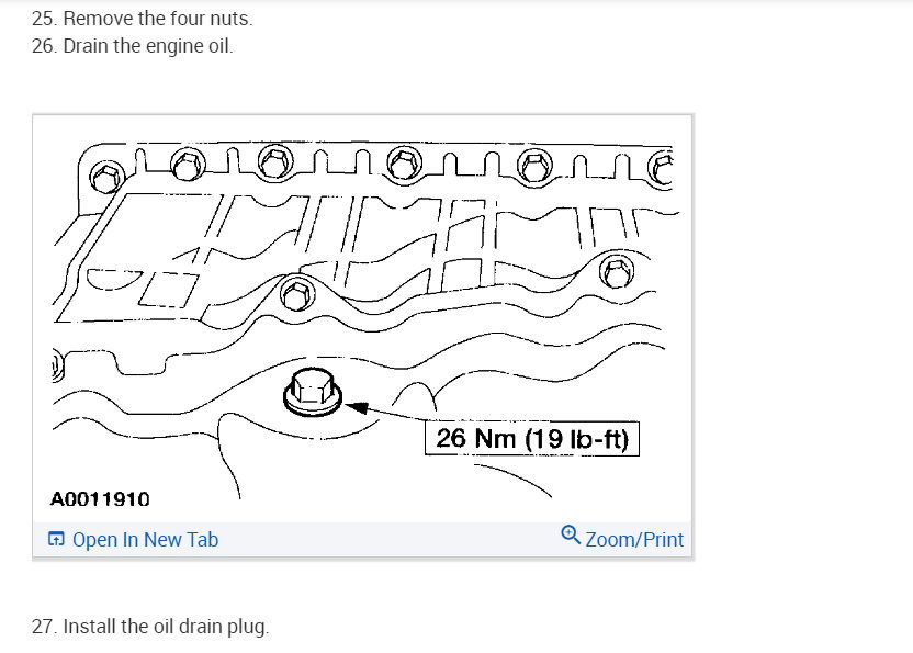

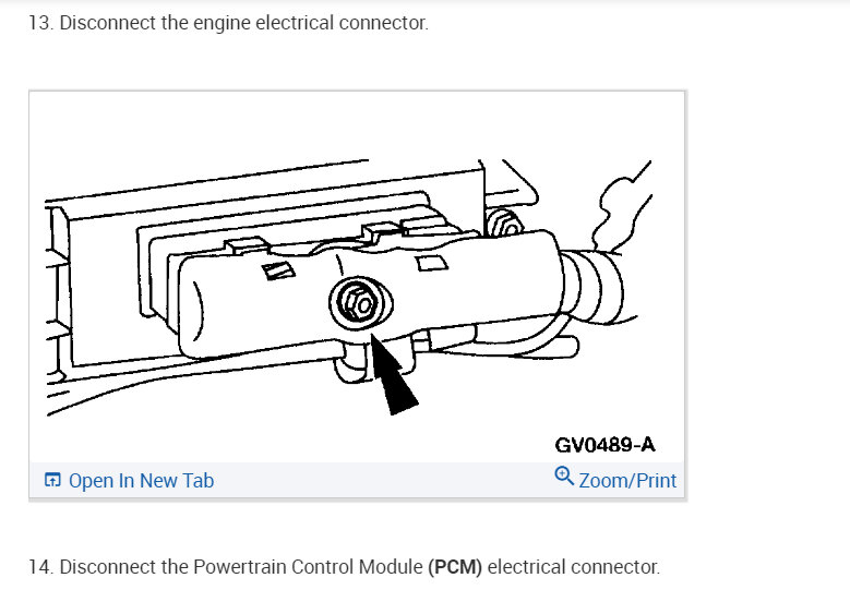

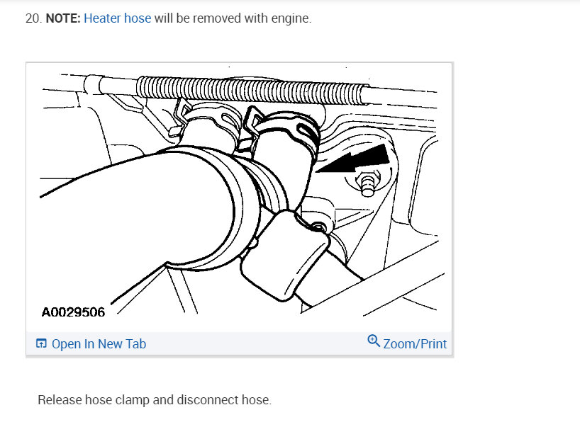

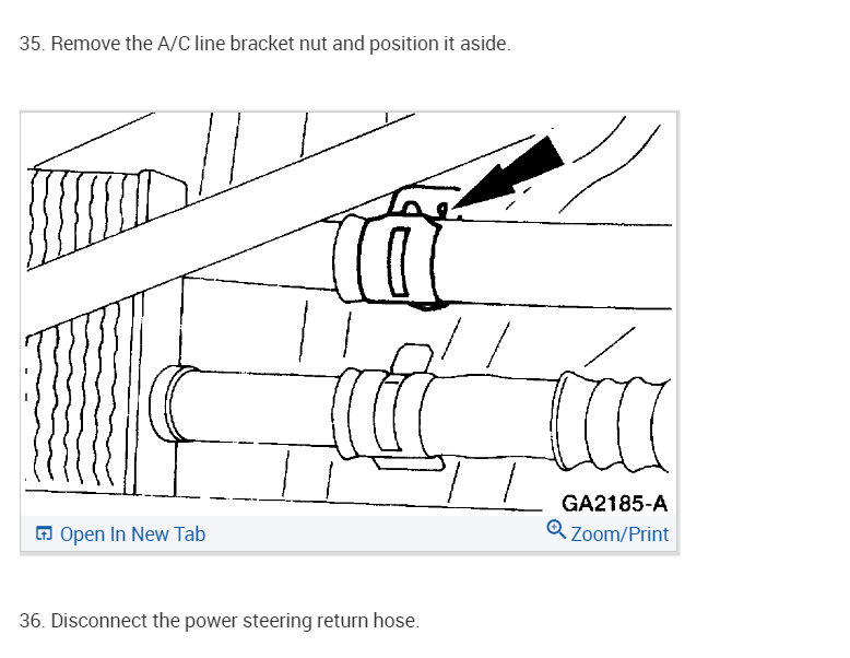

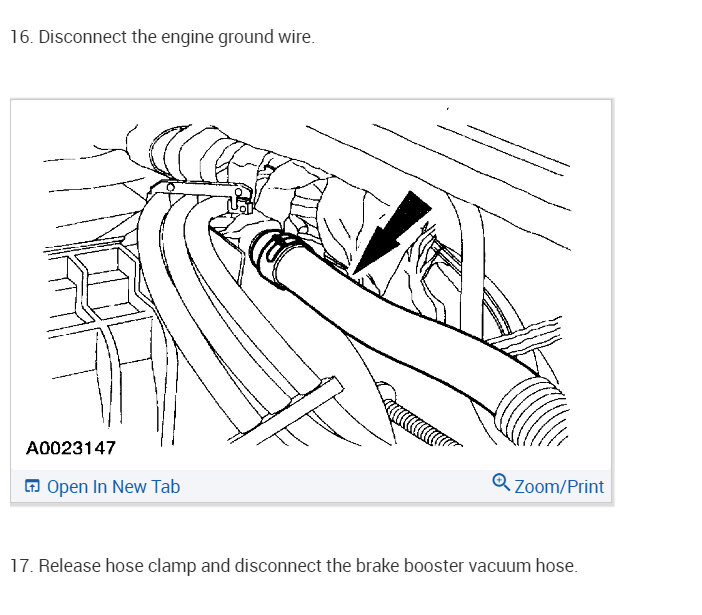

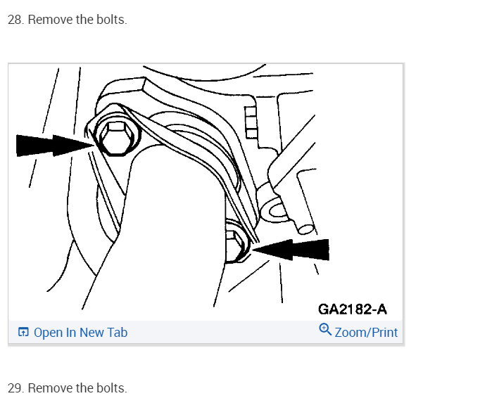

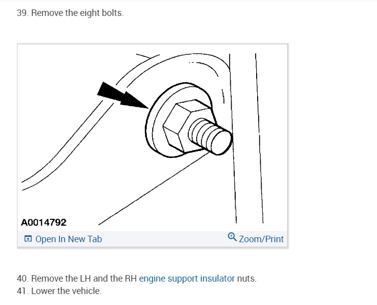

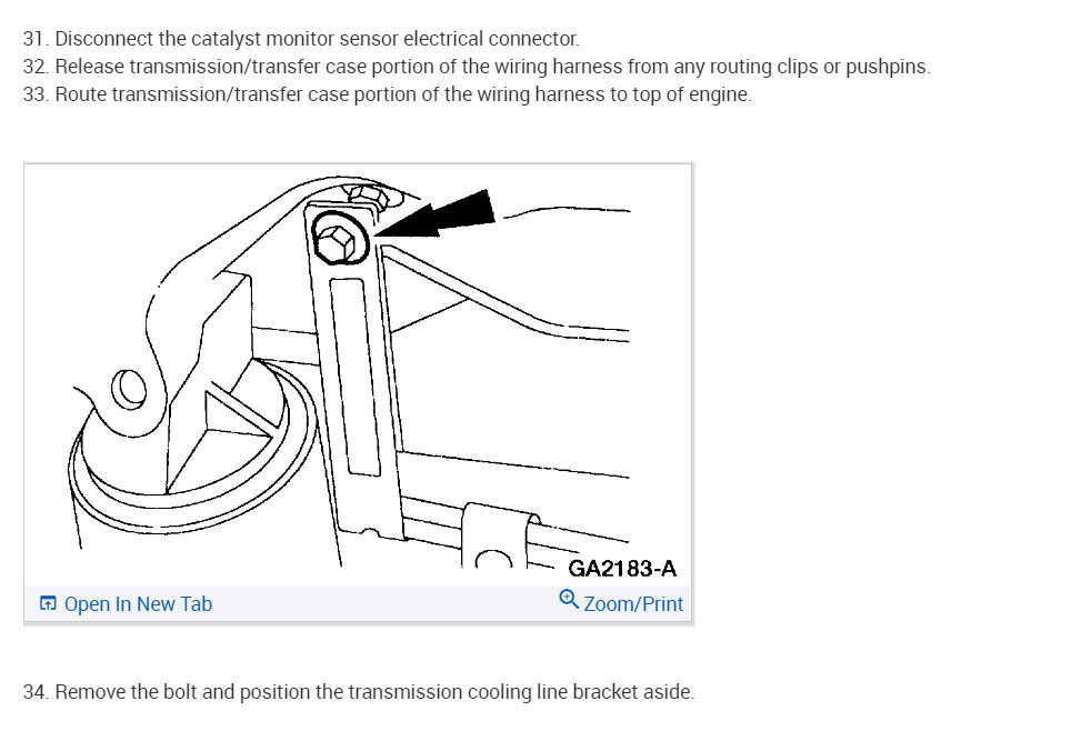

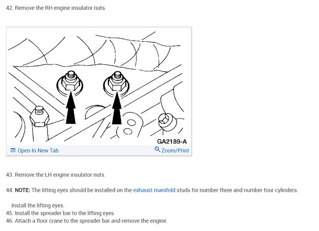

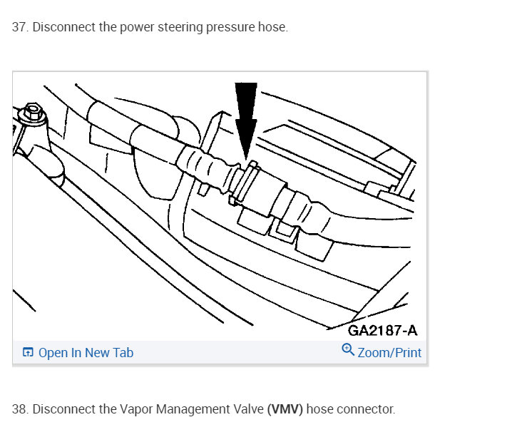

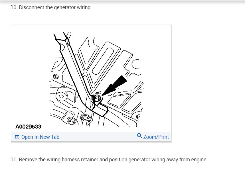

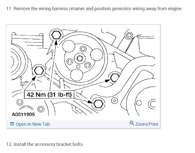

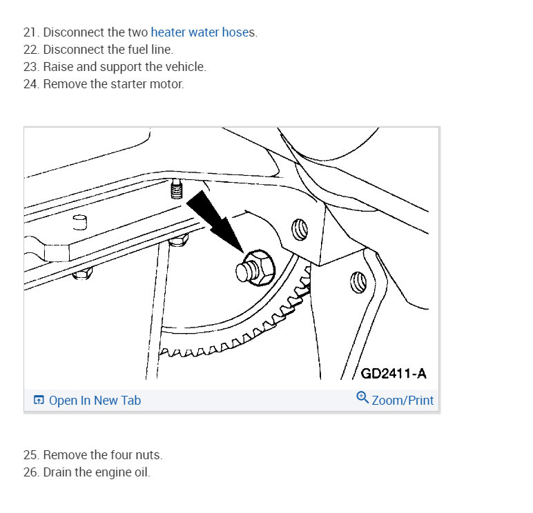

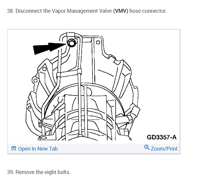

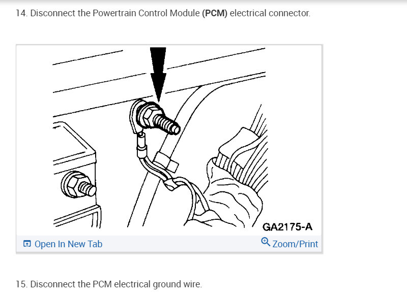

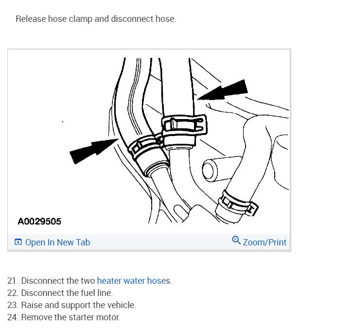

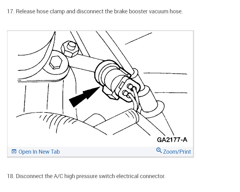

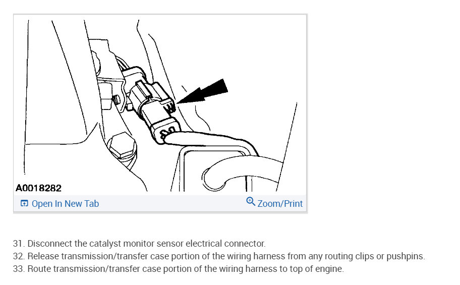

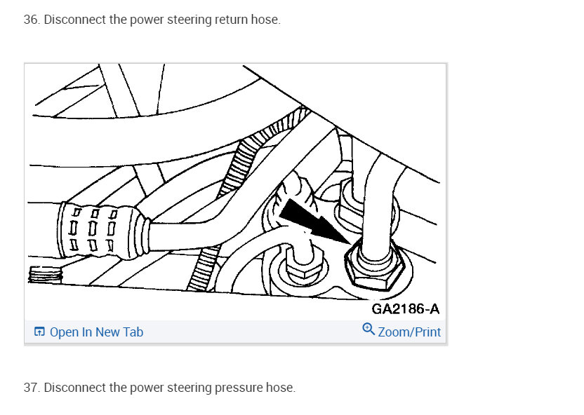

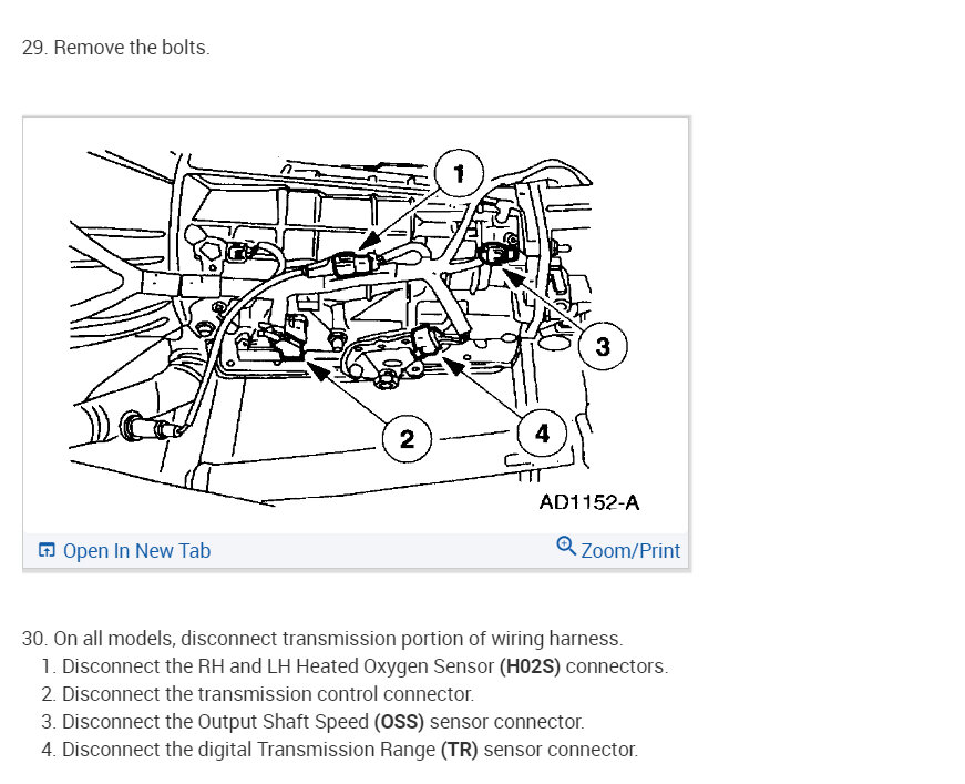

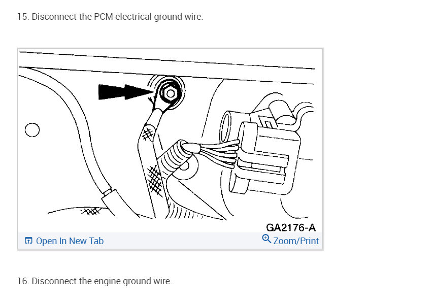

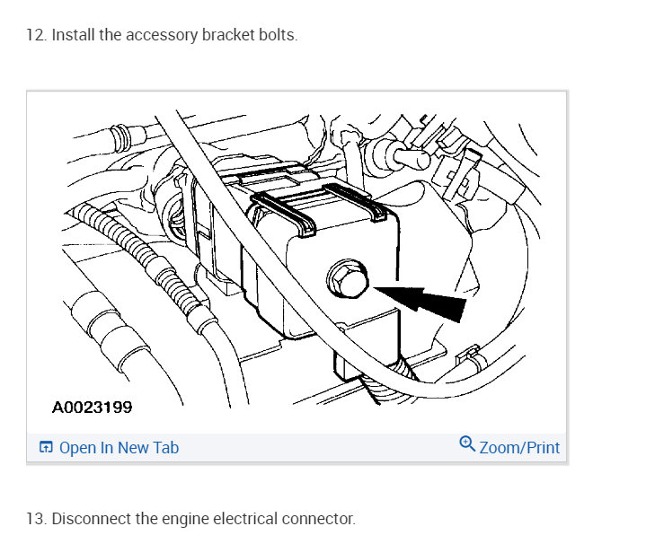

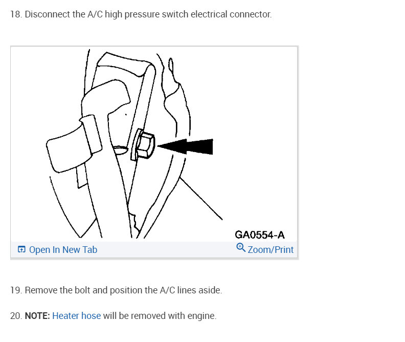

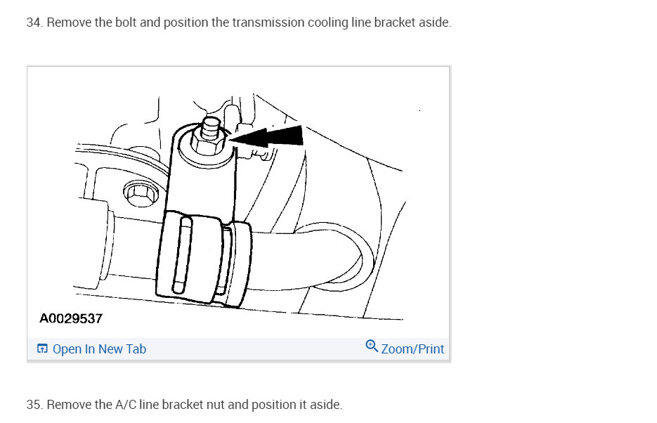

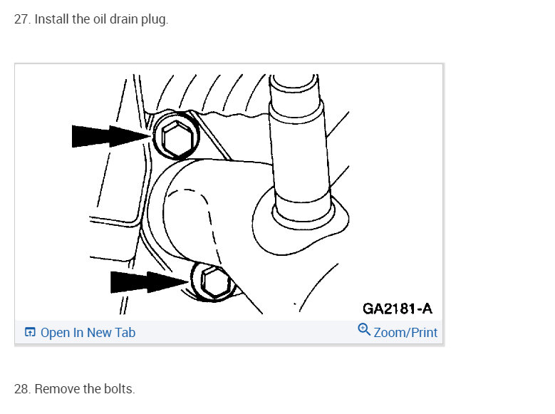

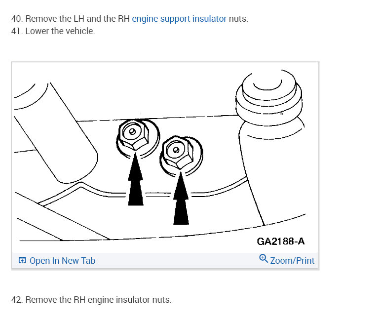

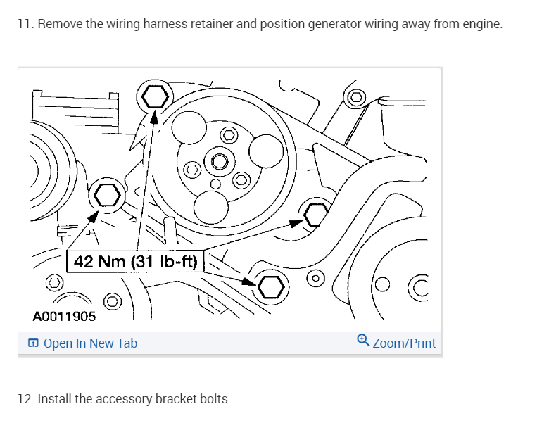

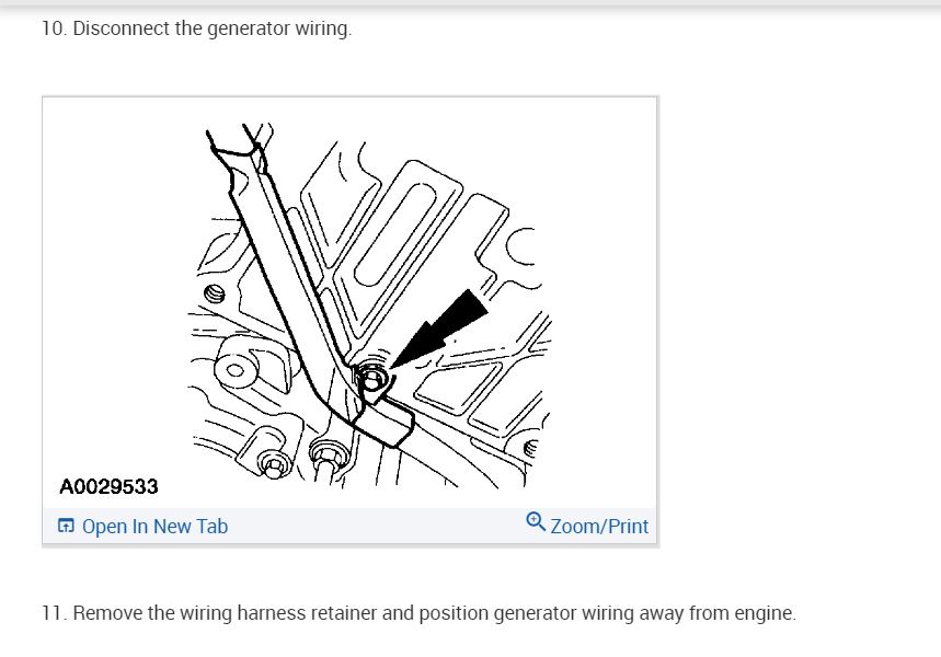

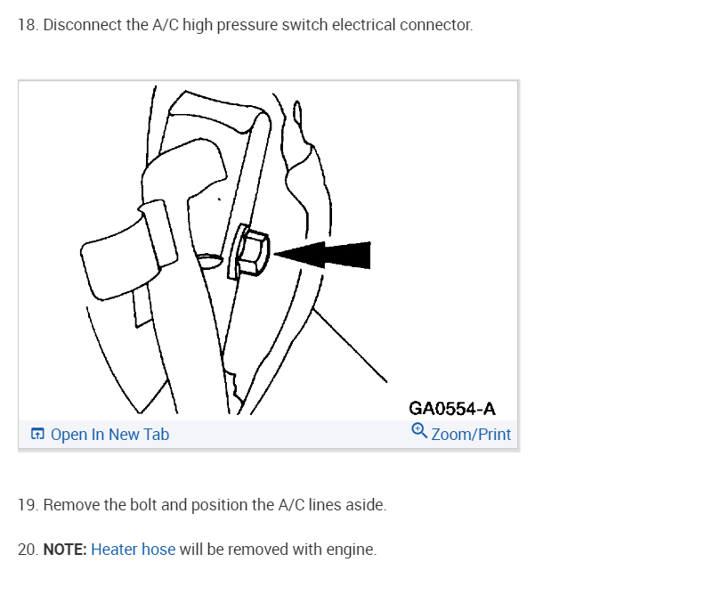

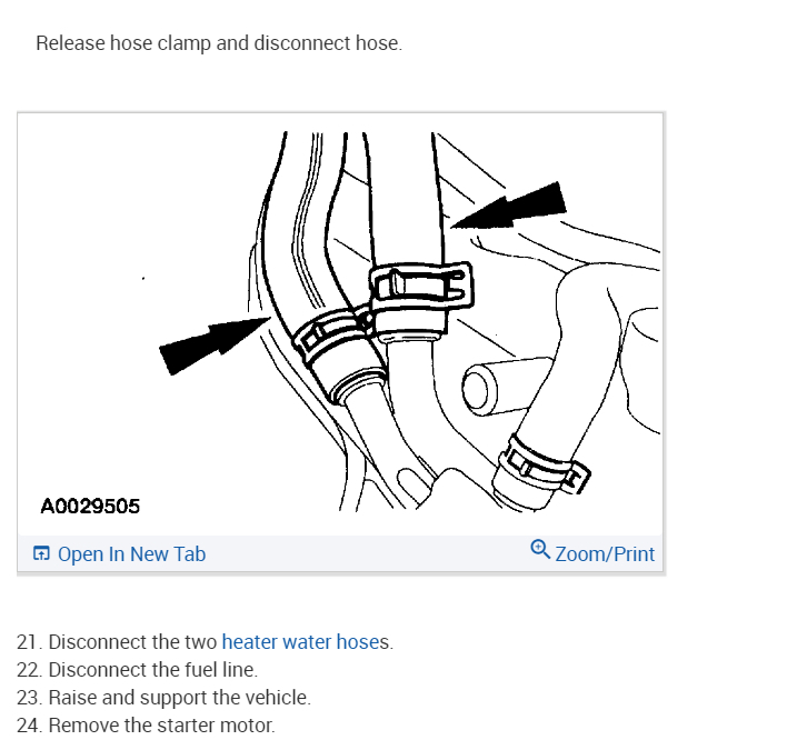

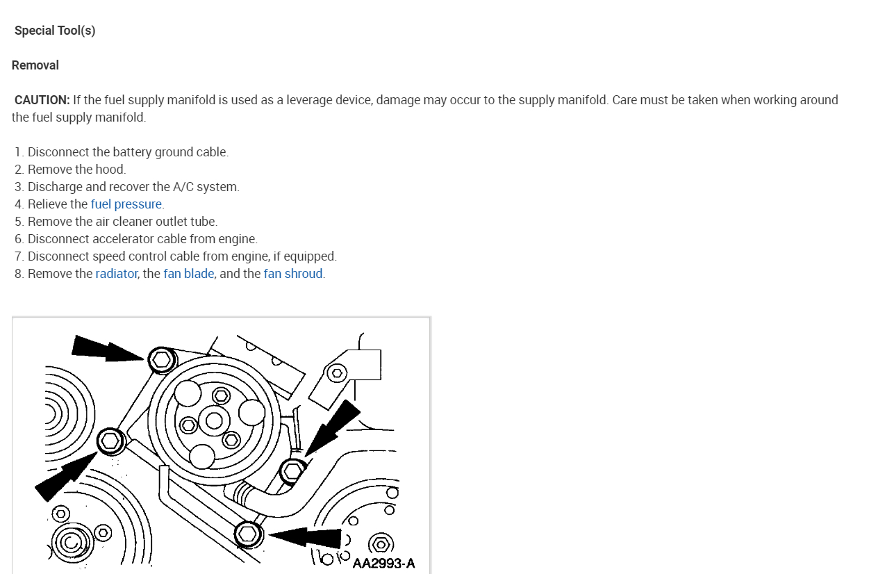

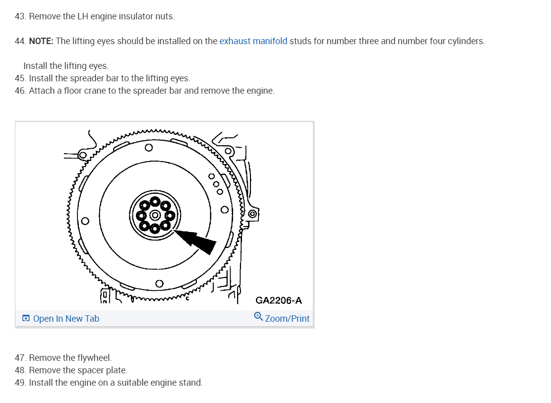

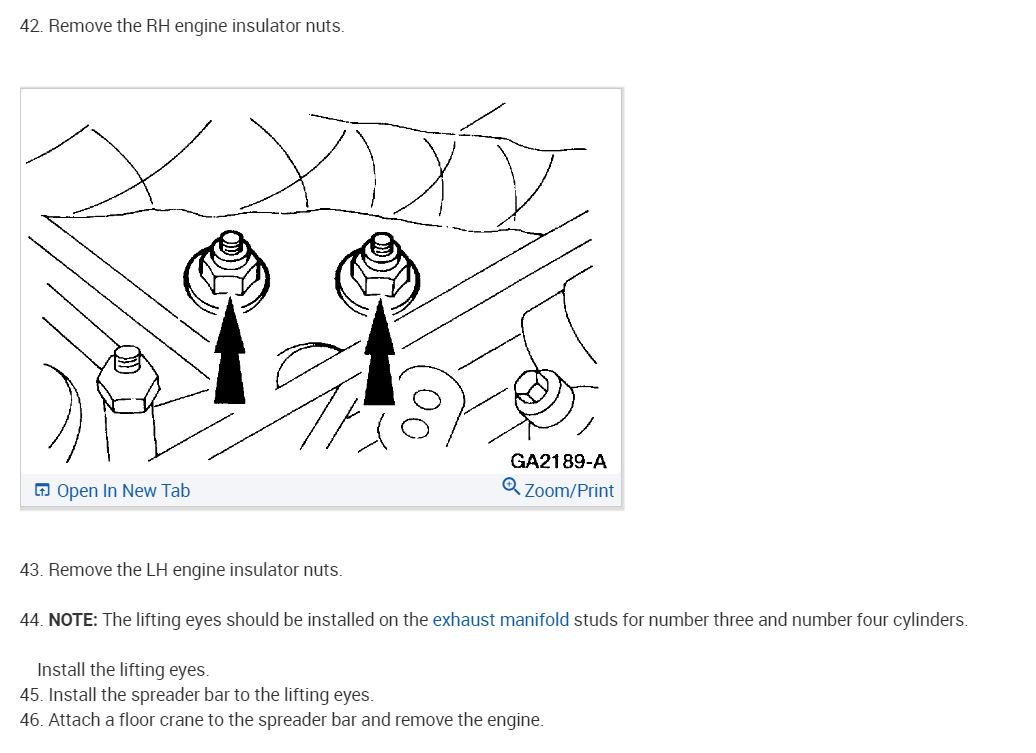

Do not know if i must remove transmission and transfer case to remove the engine.
Dec 27, 2022 at 2:54 AM
  • 55,721 POSTS
No, you don't, in fact it is easier to remove the engine separately. Here are the instructions with diagrams in the images below to help show you how, and I have included a video that shows the job being done on a similar vehicle.
https://youtu.be/zy1CozLgWUQ
Start by disconnecting the battery, drain the engine oil and coolant, also vacuum down the AC system, this video will help:
https://youtu.be/4EqdrBVb0sY
Also, once the engine is out, please do not allow the torque converter to move forward out of the transmission, if so what this video to show you how to make sure it is correctly installed.
https://youtu.be/ZC7xHVMKLRw
Check out the images (below). Let us know what happens and please upload pictures or videos of the problem so I can help walk you thought he repair.
