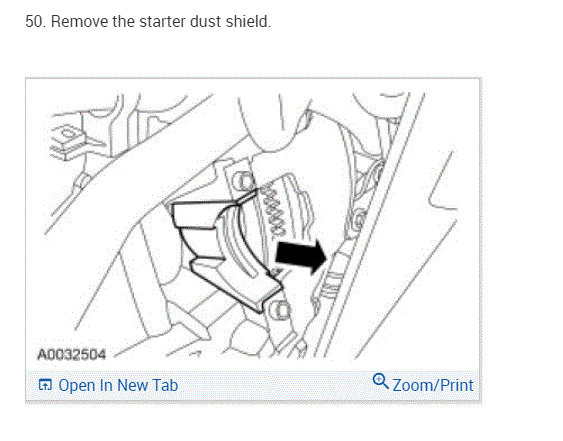

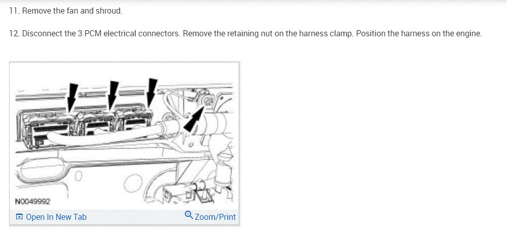

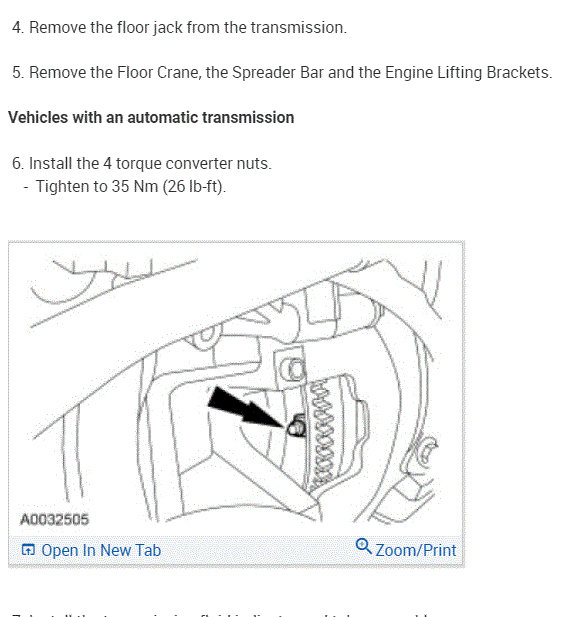

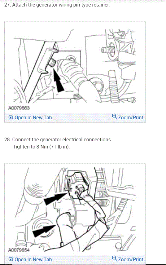

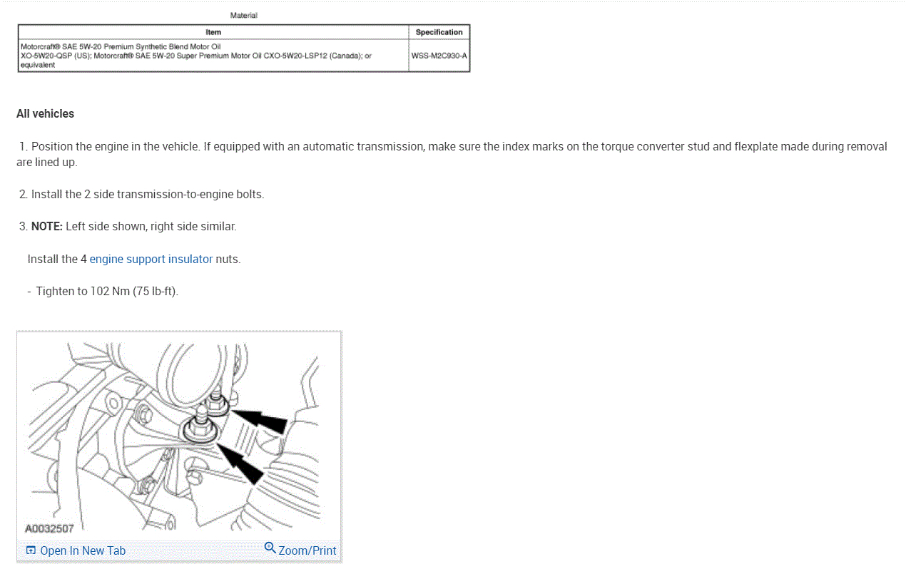

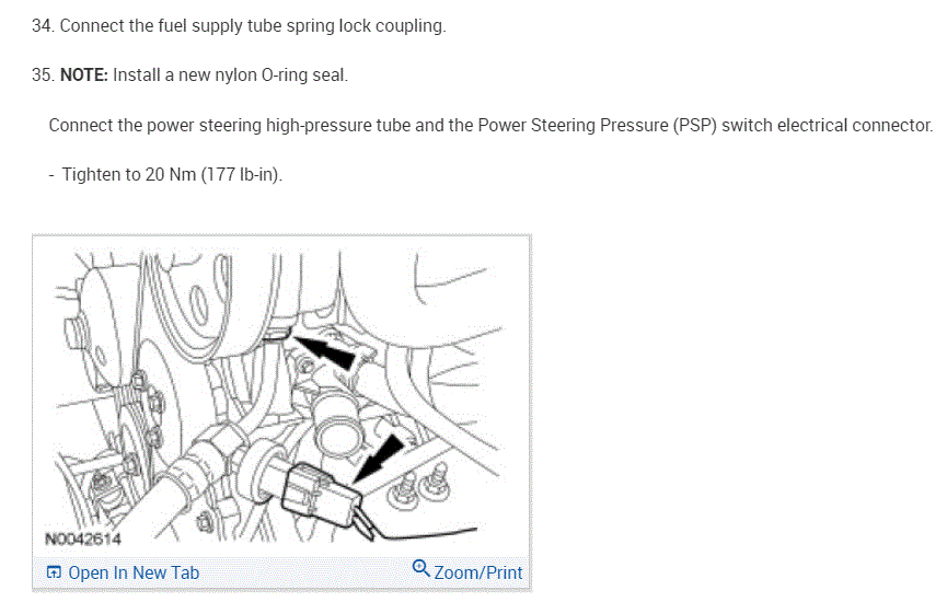

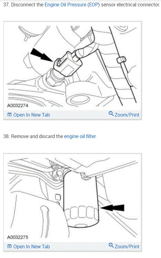

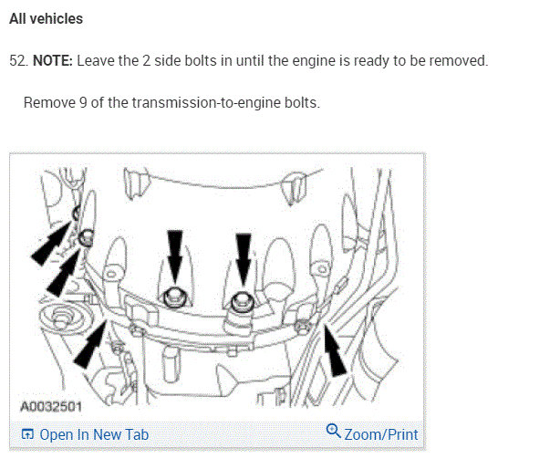

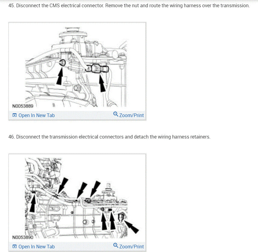

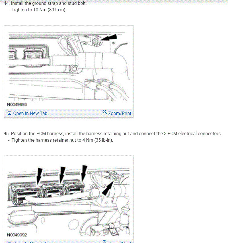

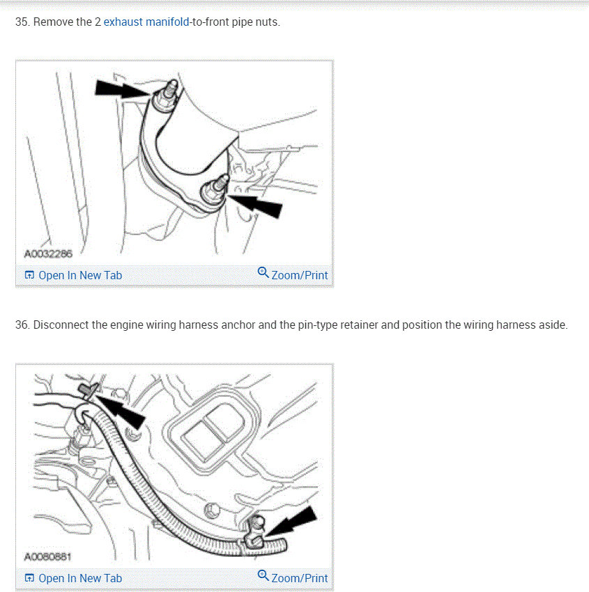

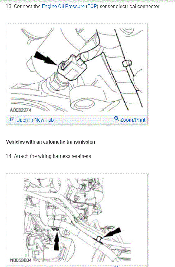

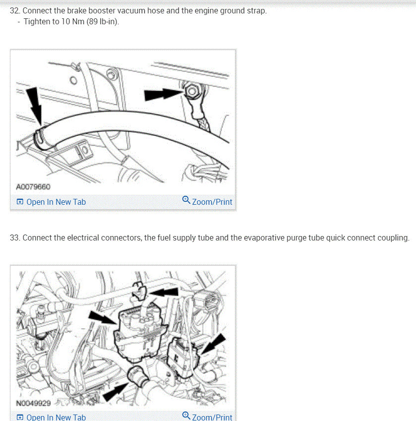

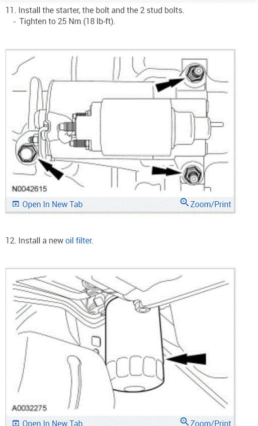

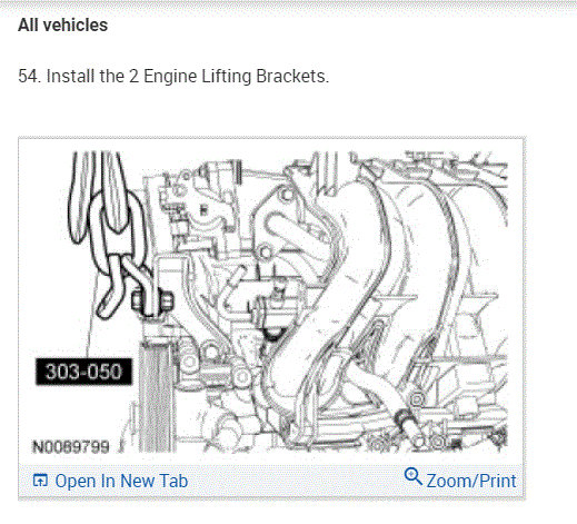

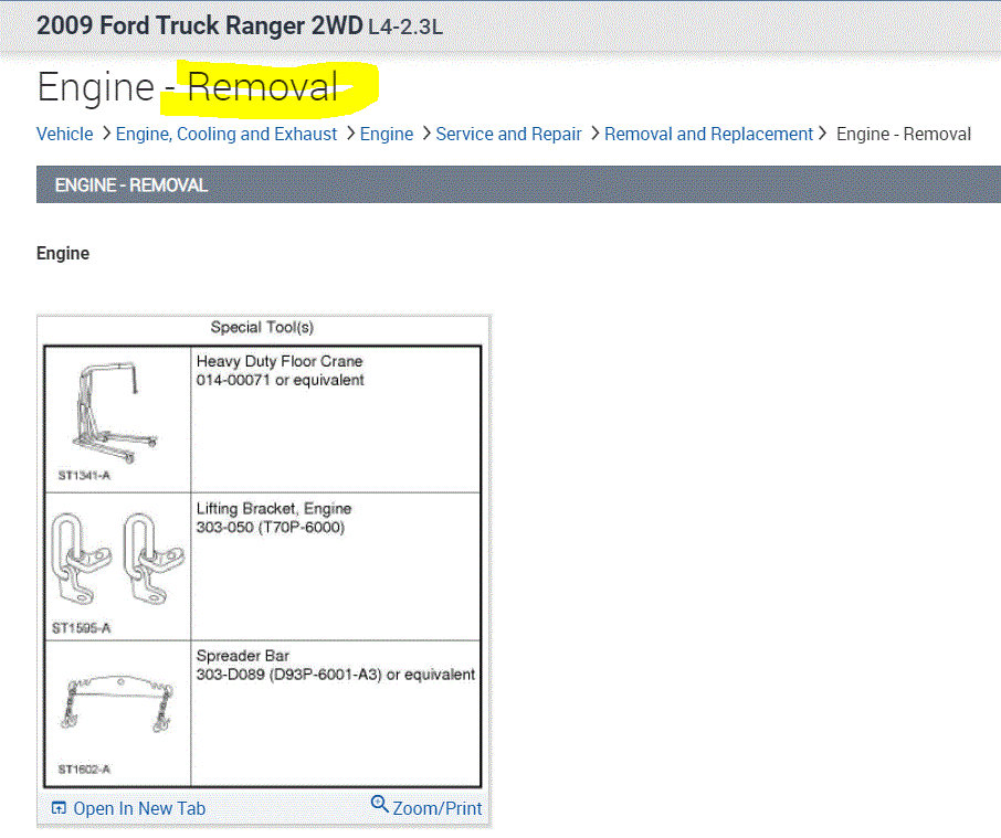

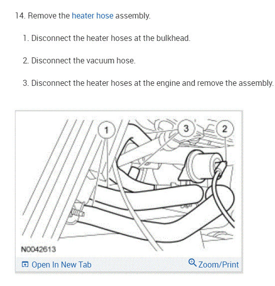

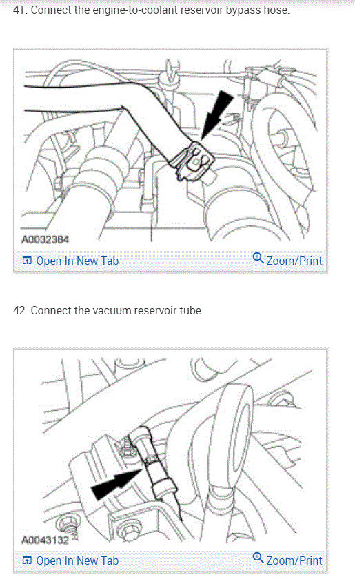

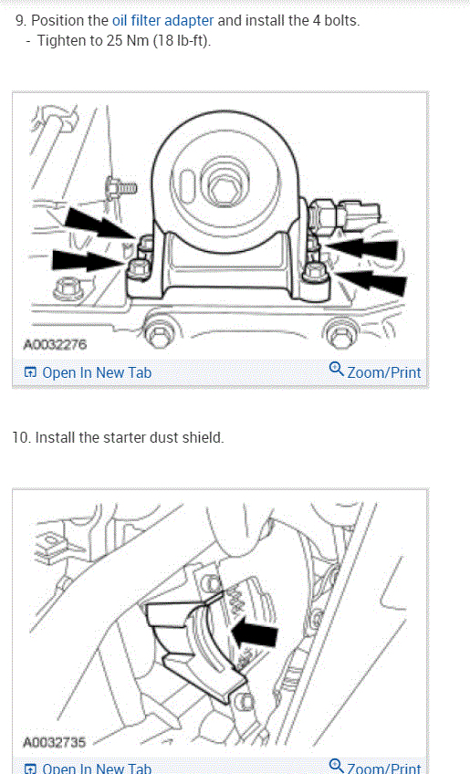

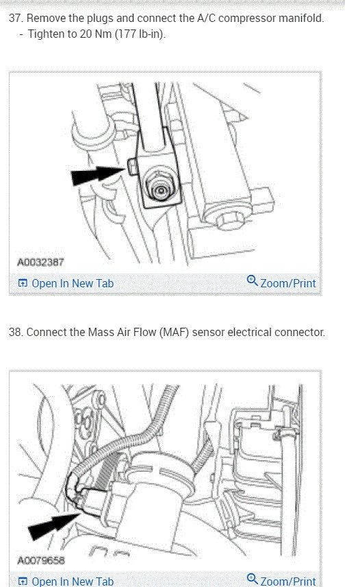

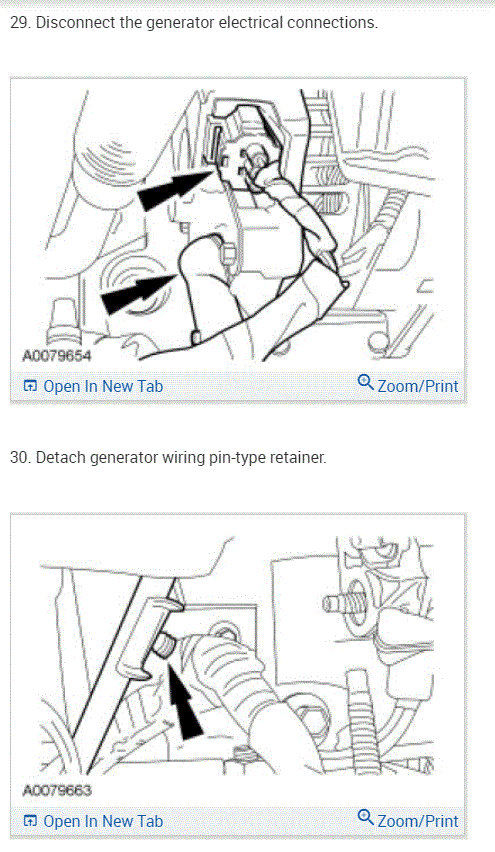

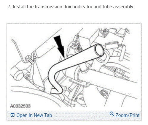

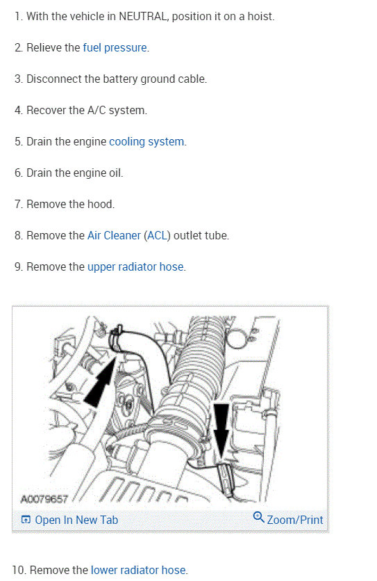

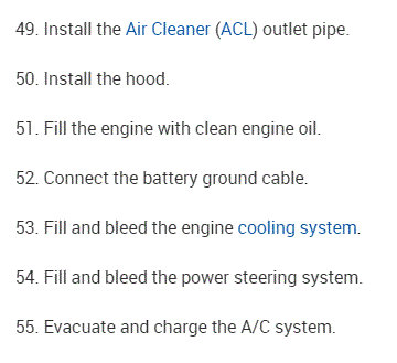

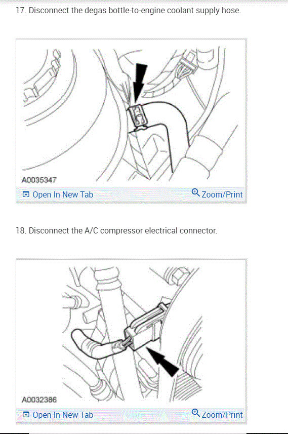

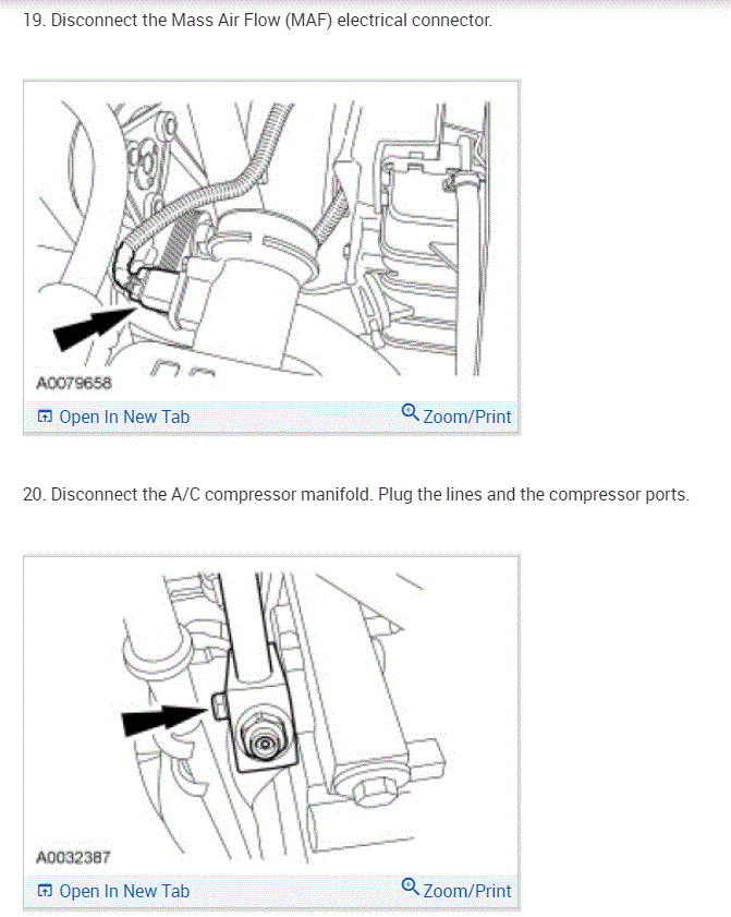

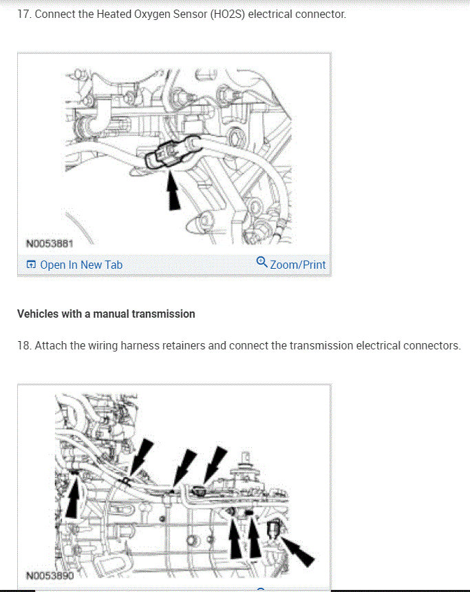

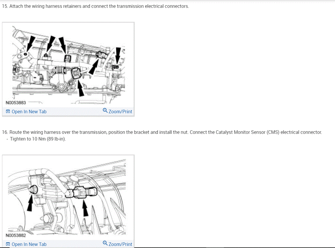

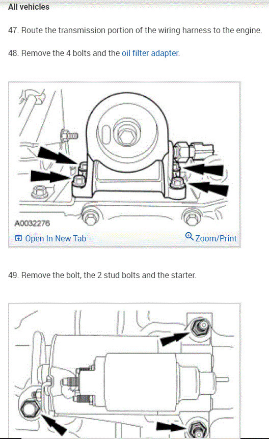

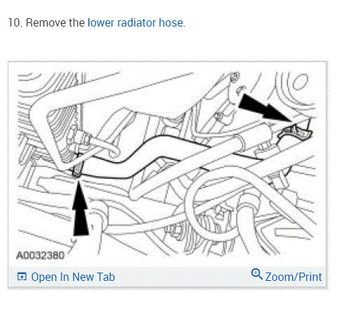

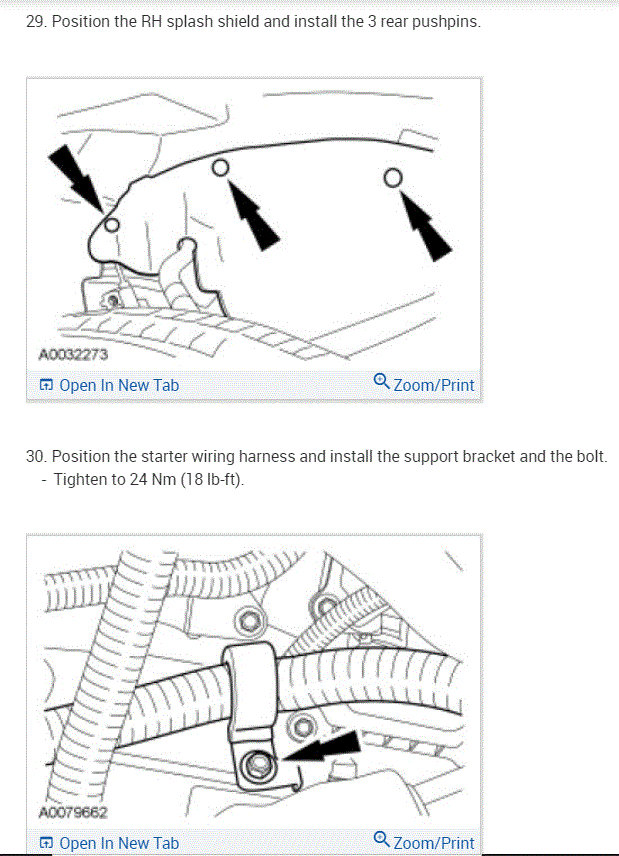

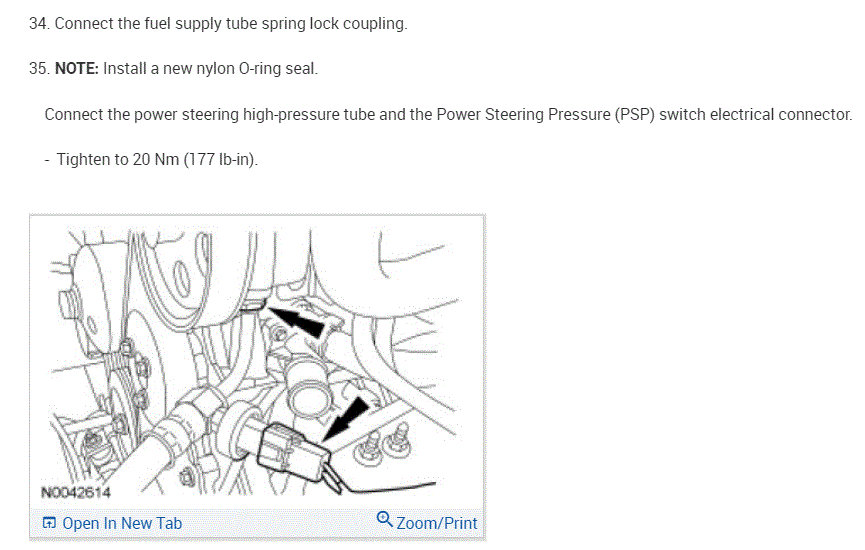

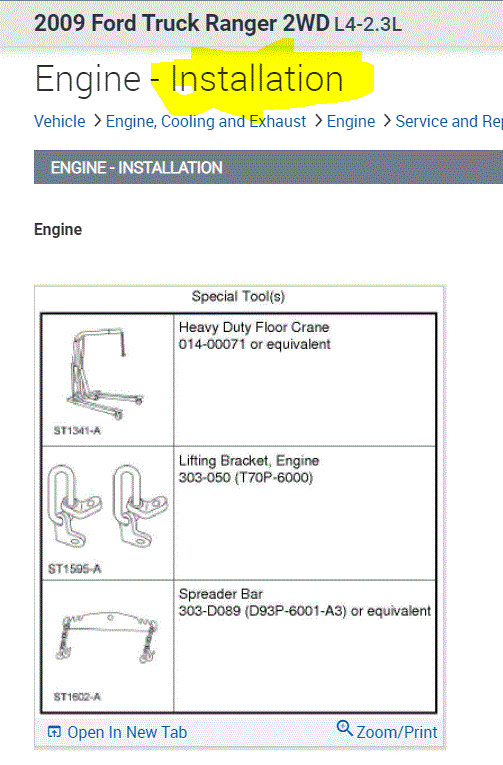

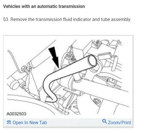

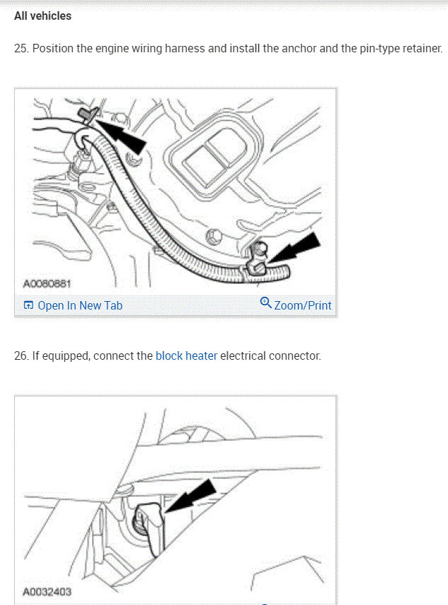

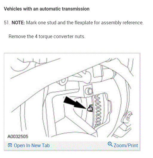

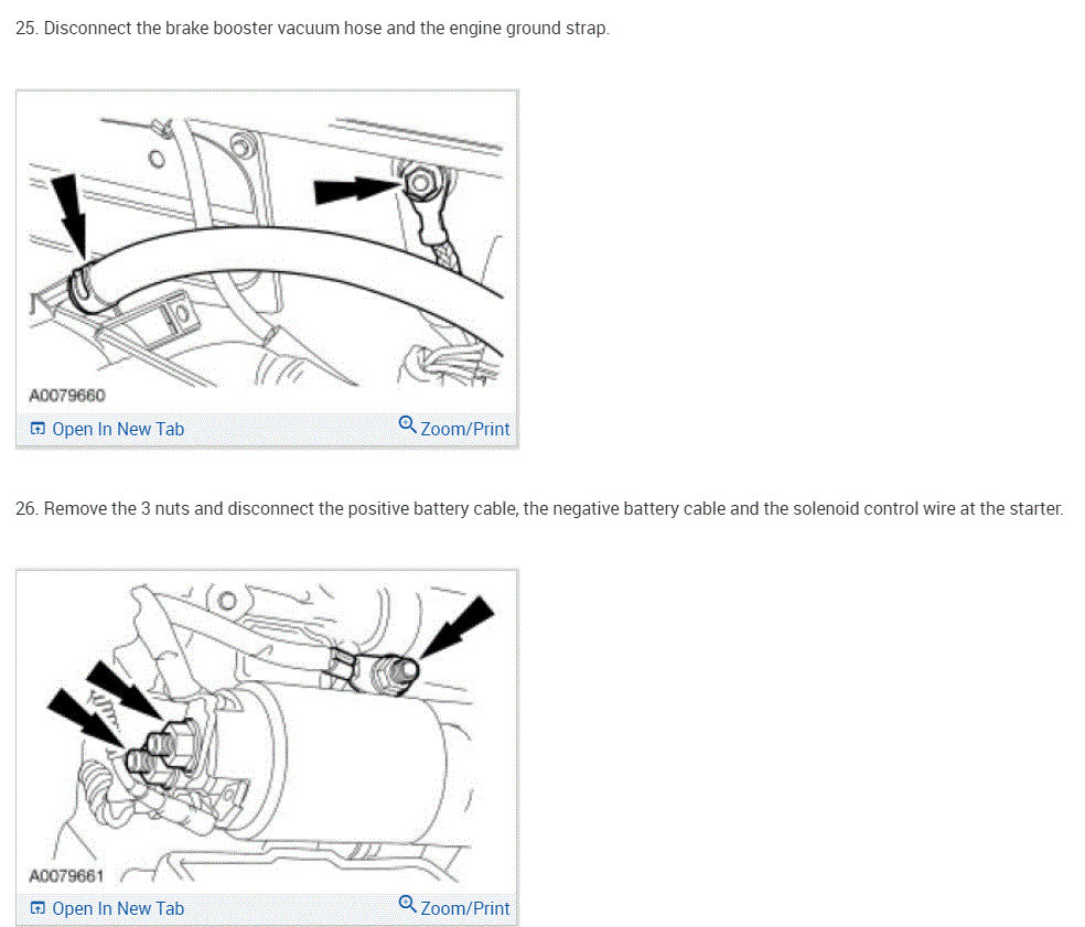

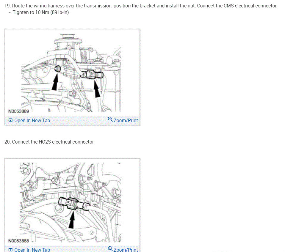

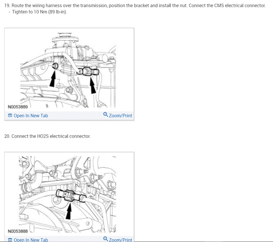

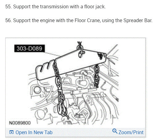

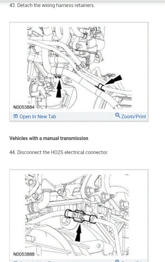

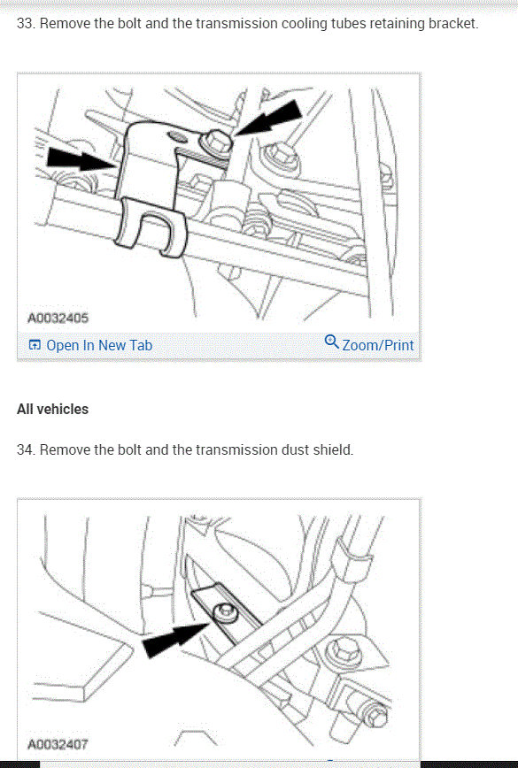

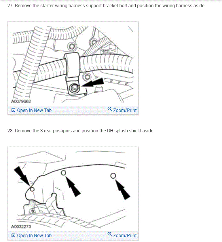

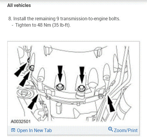

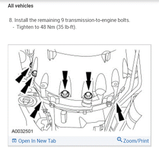

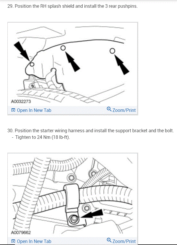

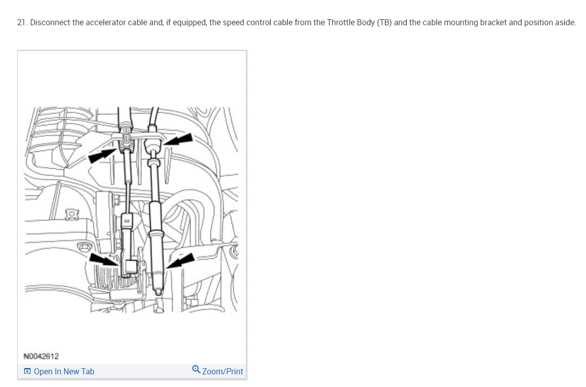

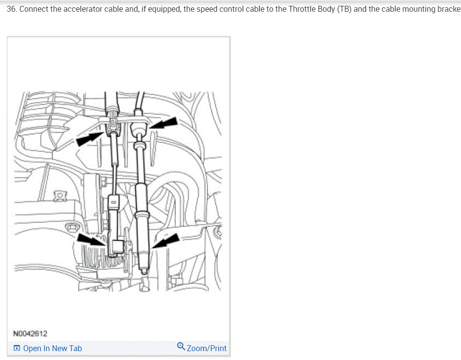

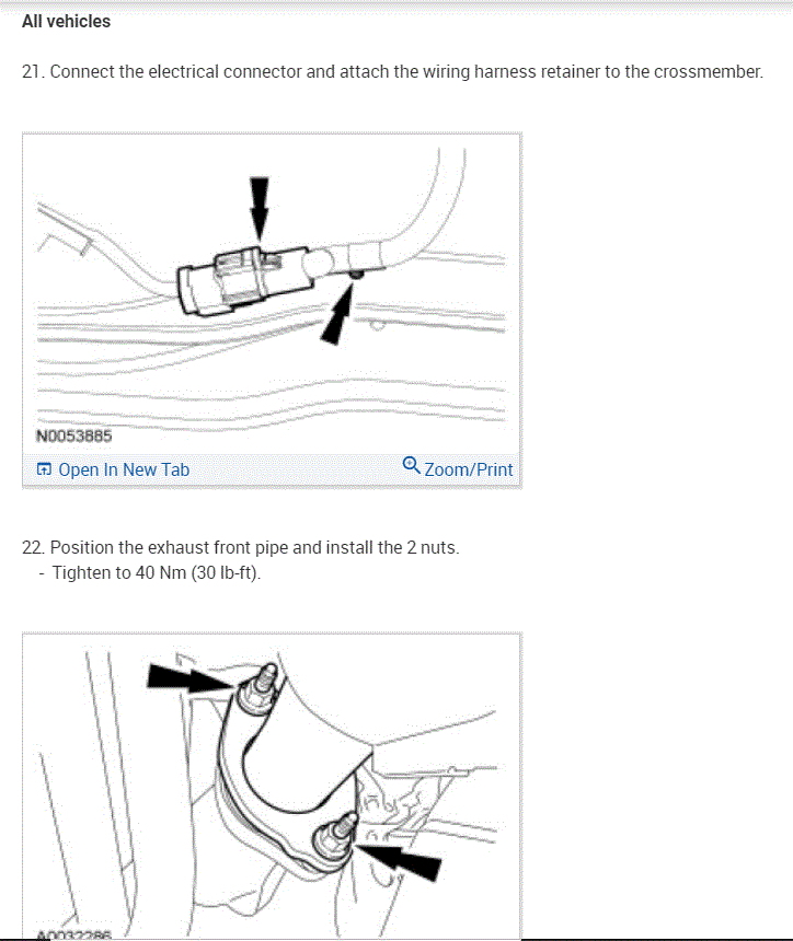

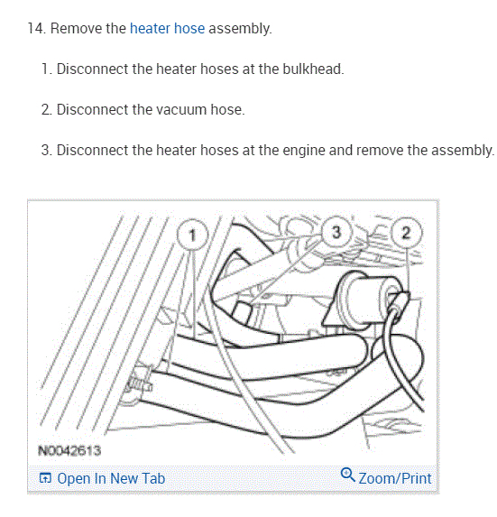

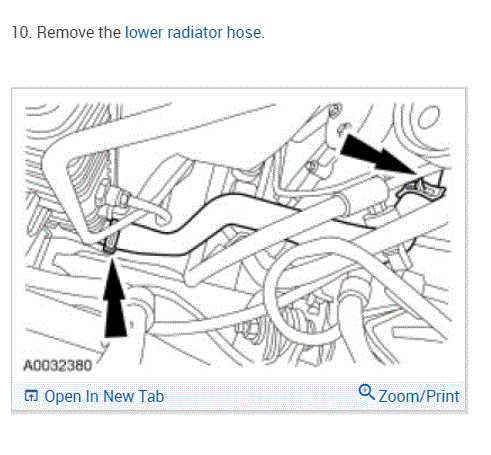

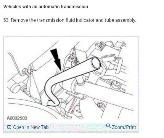

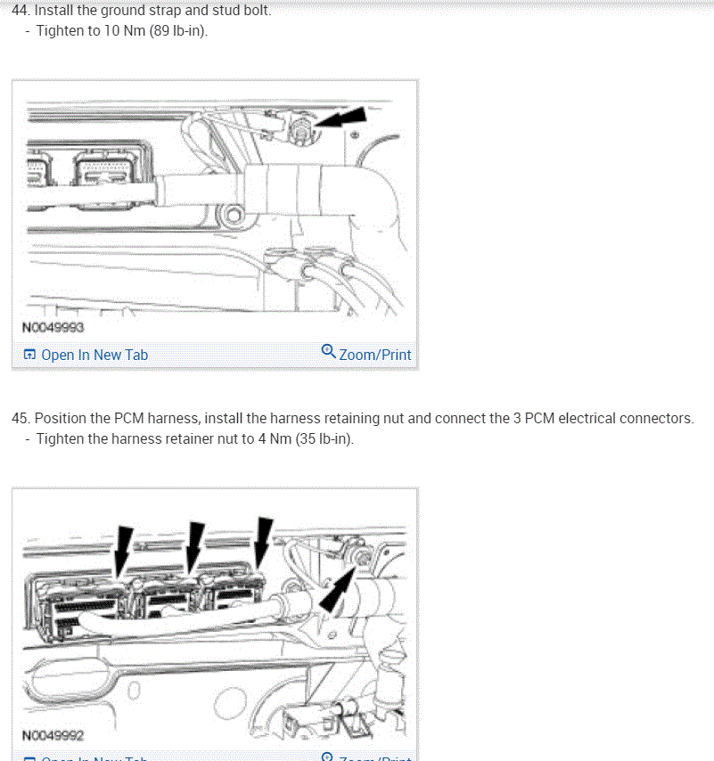

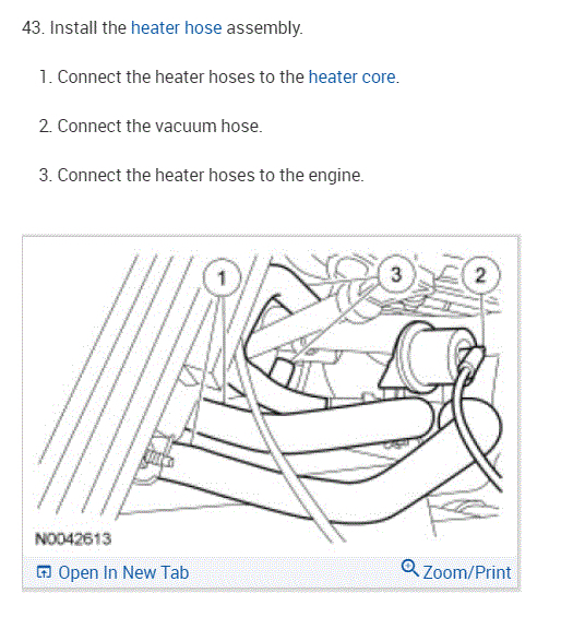

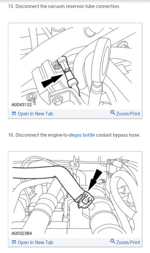

Do you have a step-by-step video of the removal and installation of a 2.3 litter VIN code D for my 2009 Ranger?
May 28, 2022 at 5:46 AM
  • 110,240 POSTS

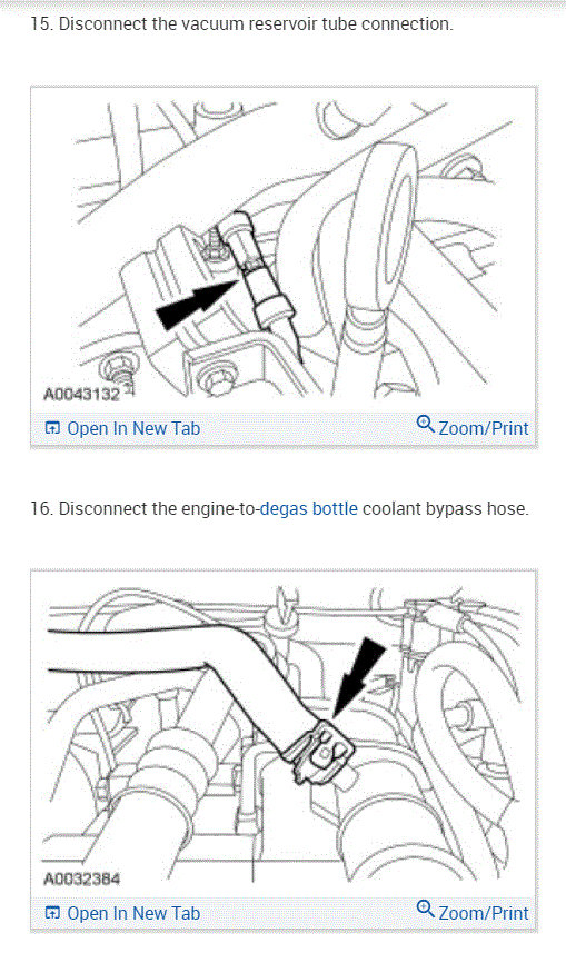

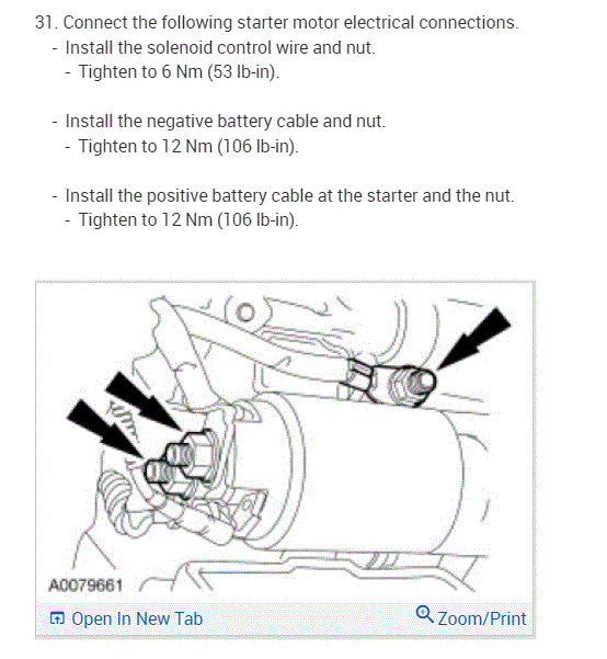

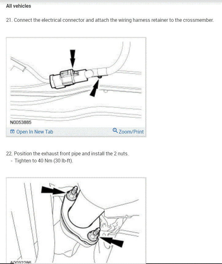

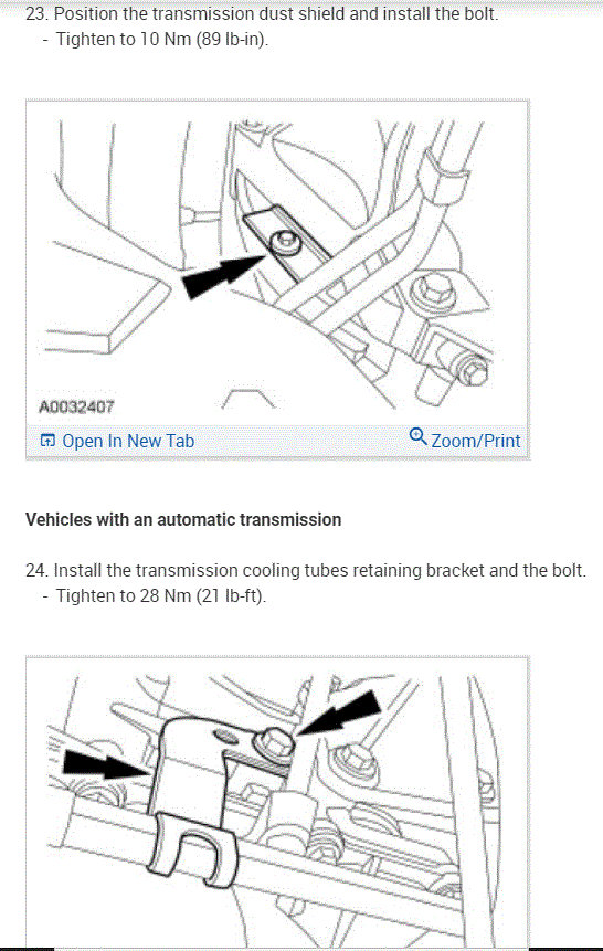

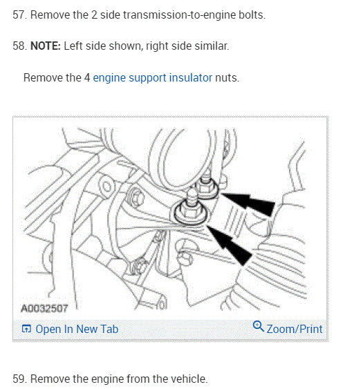

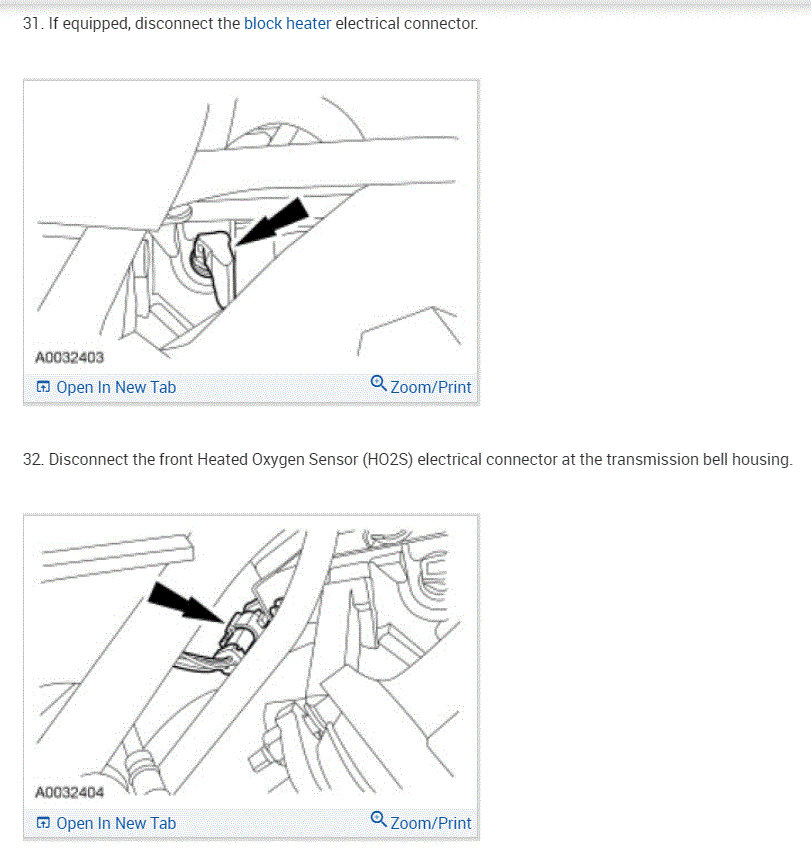

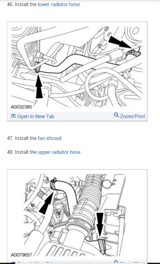

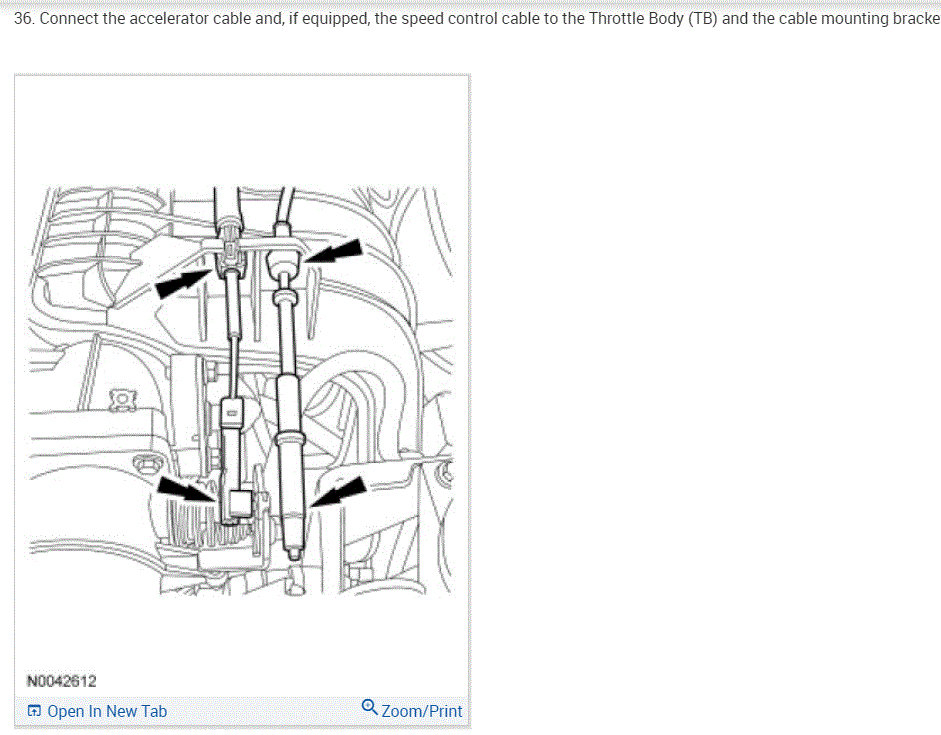

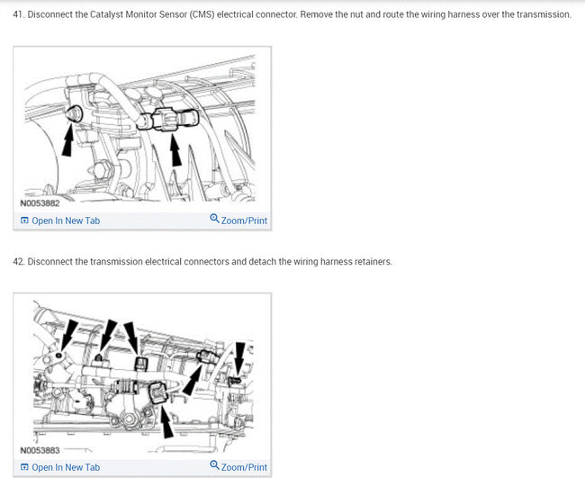

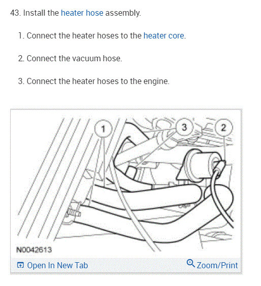

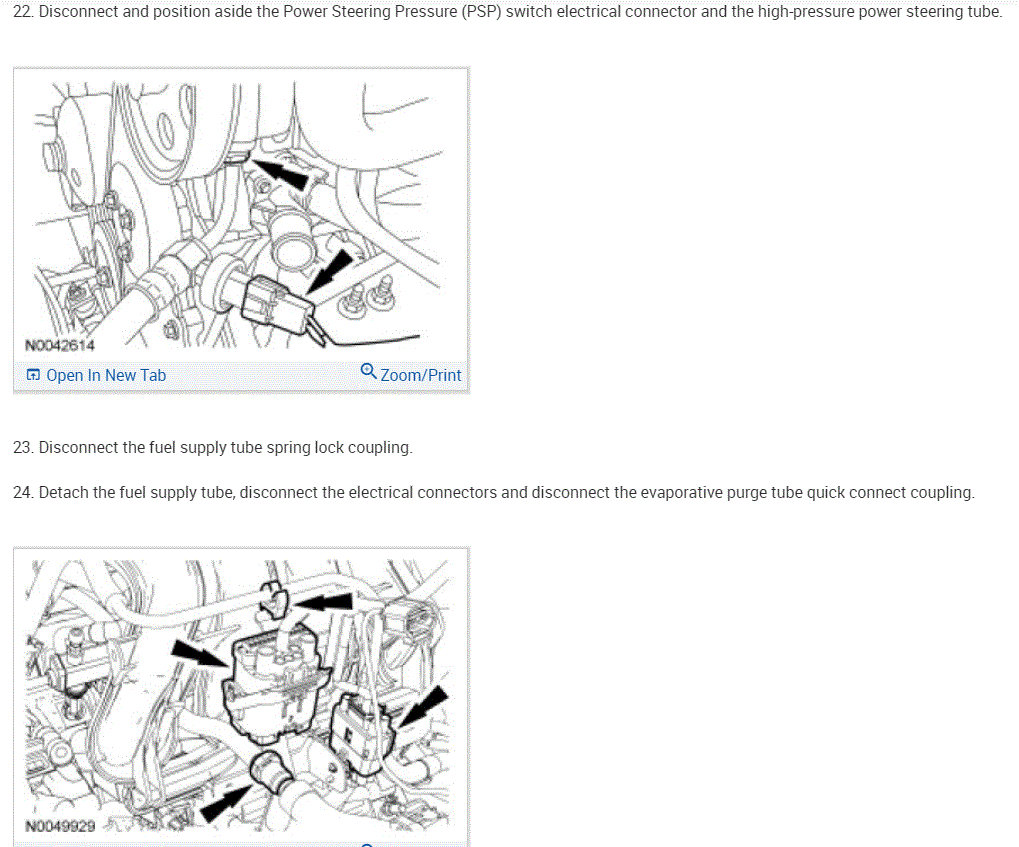

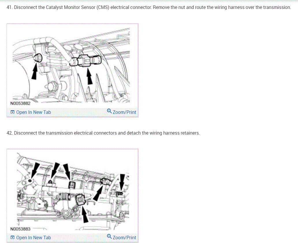

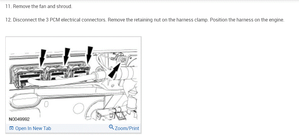

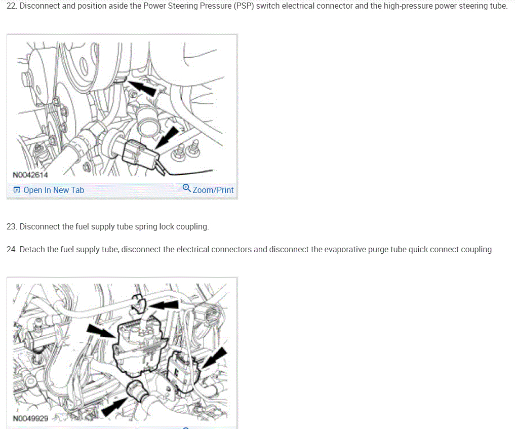

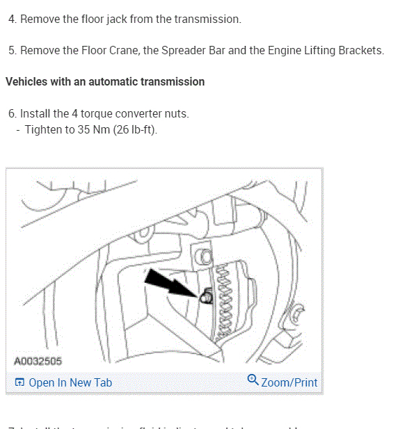

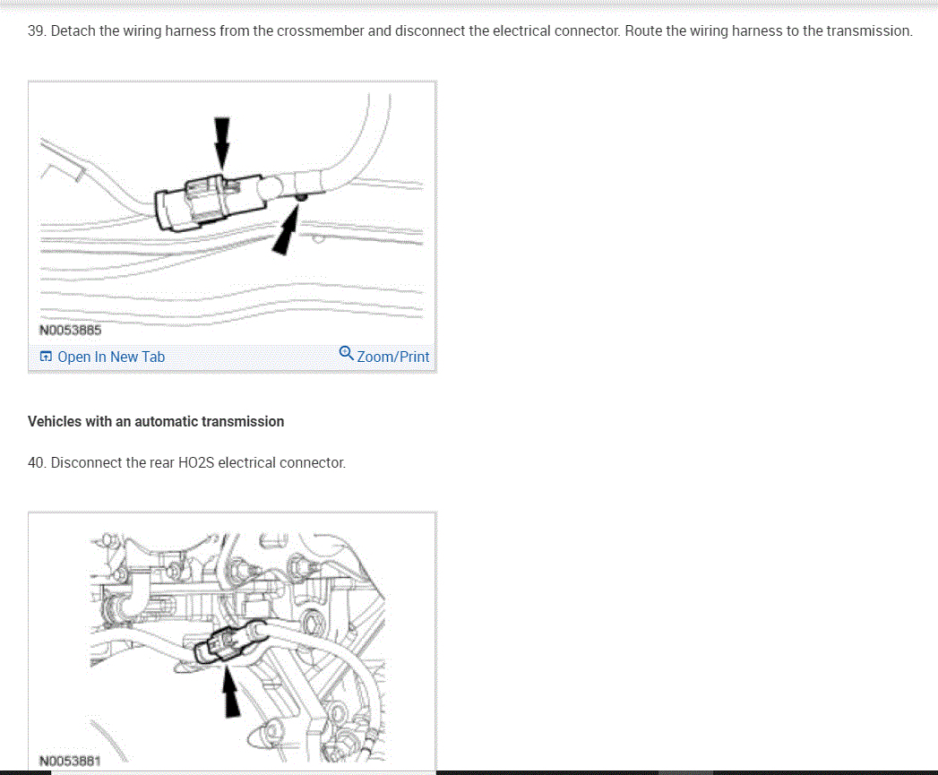

I attached the directions below. Don't be overwhelmed. This really isn't a difficult one to do. If you run into issues, let me know and I'll direct you.
Suggestion: You will be removing parts one at a time. Get yourself some good plastic sandwich bags. For each component that is removed, place the bolts/nuts in a bag and label it with a sharpie for the component that was removed. This will save a lot of time and confusion when you reinstall the engine
Let me know if this helps or if you have questions. Also, let me know how things turn out for you.
