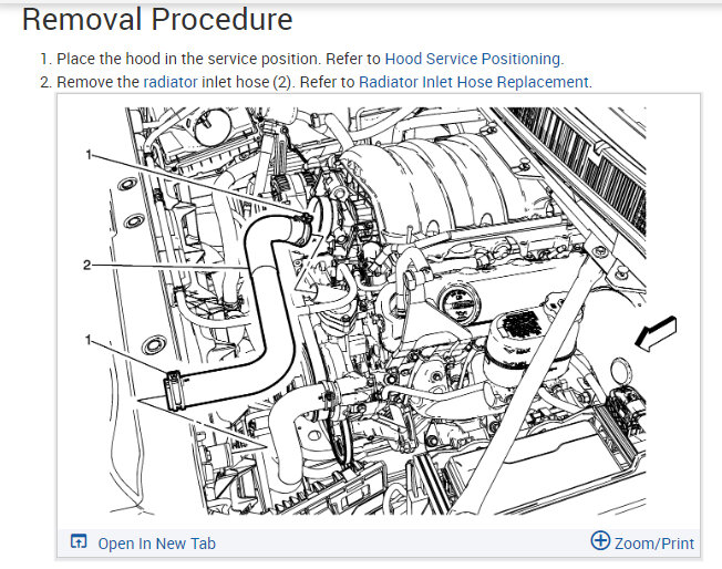

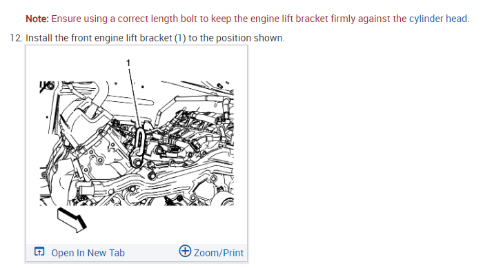

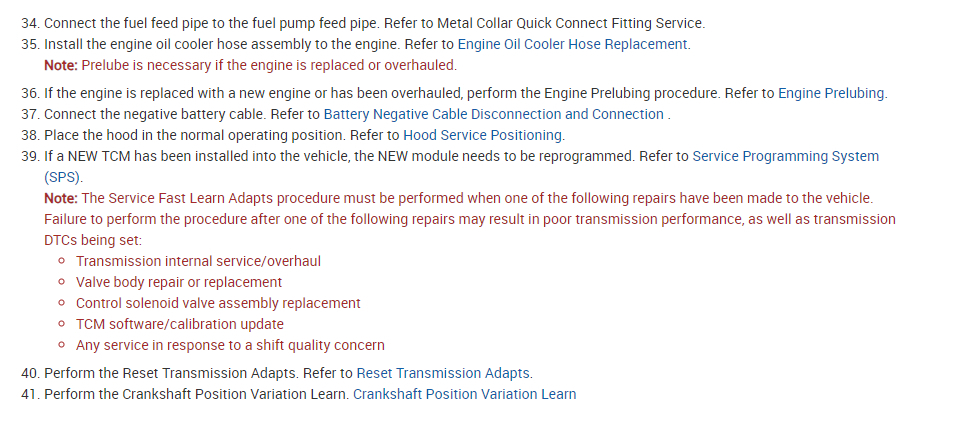

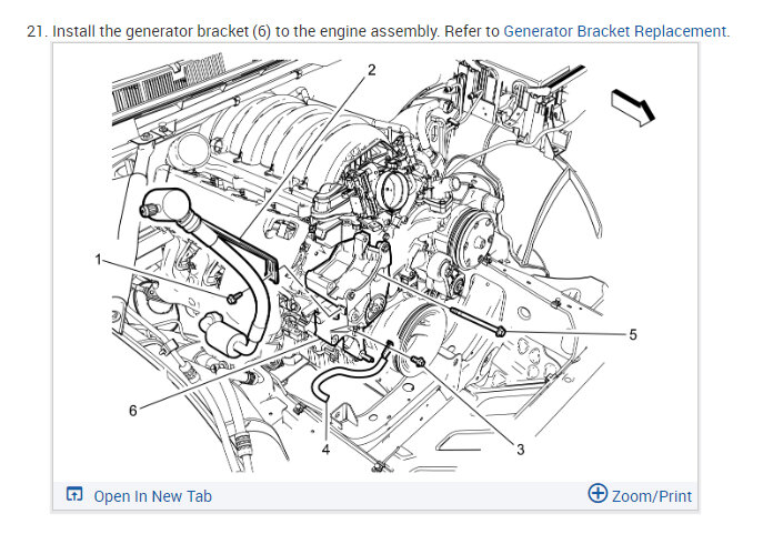

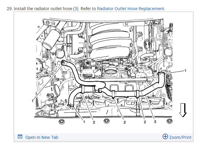

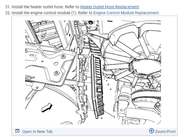

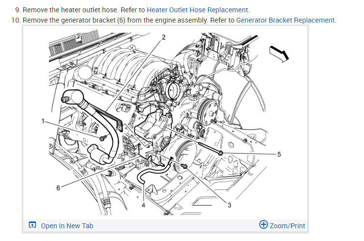

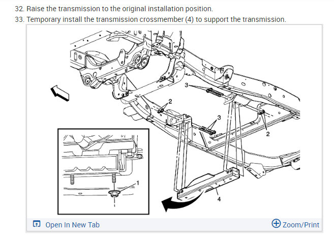

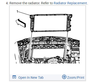

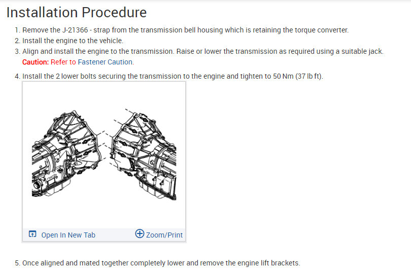

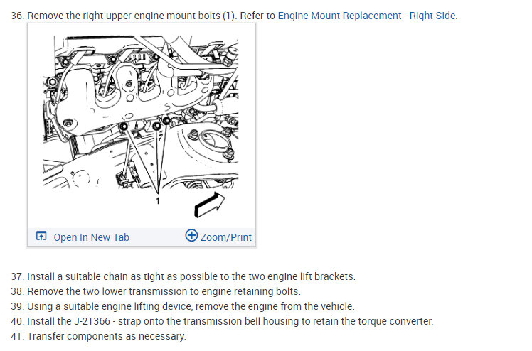

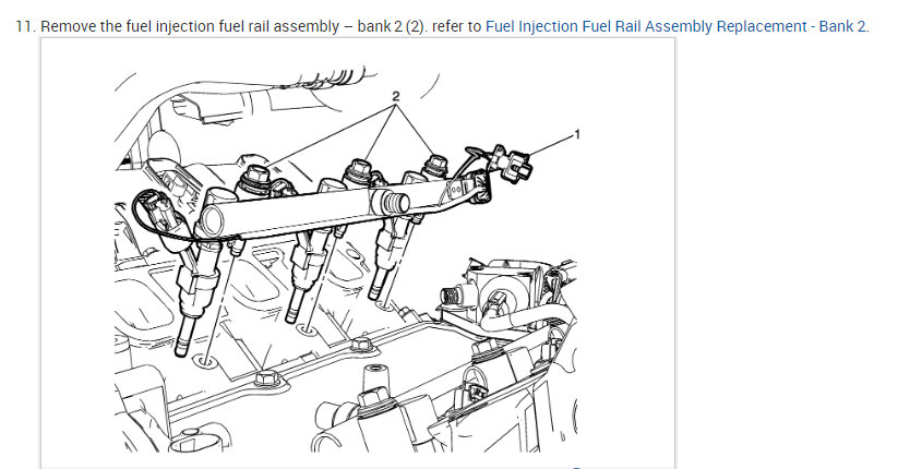

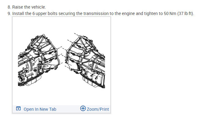

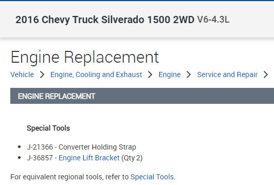

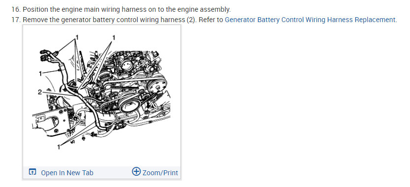

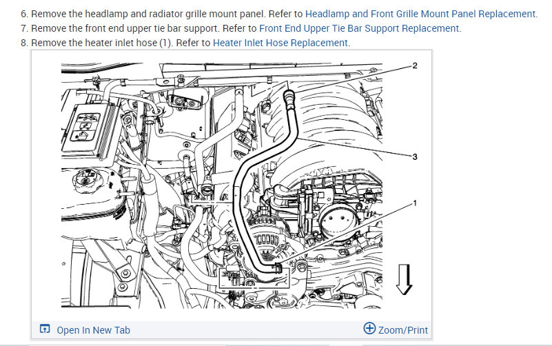

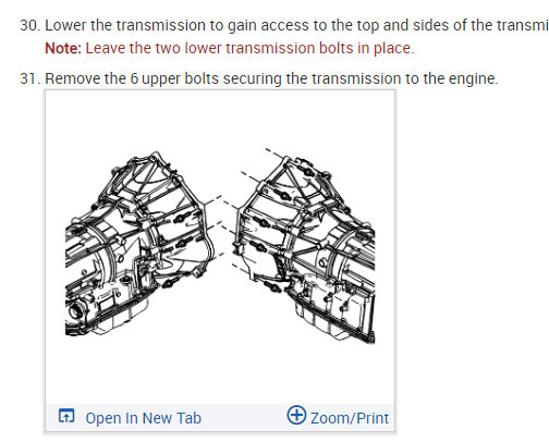

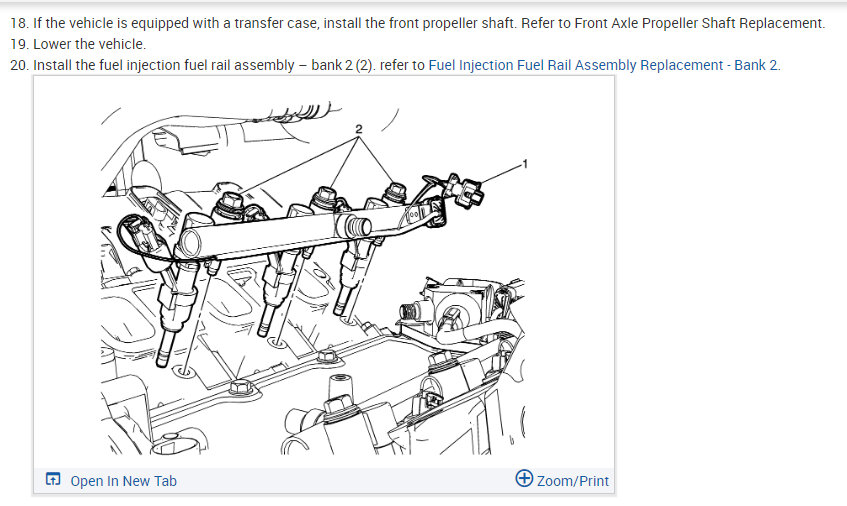

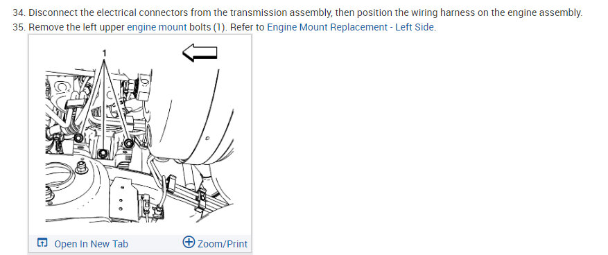

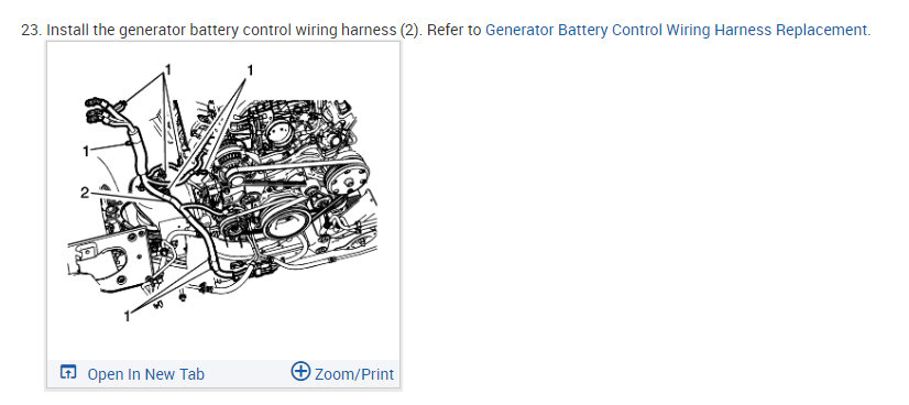

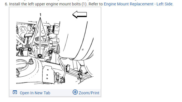

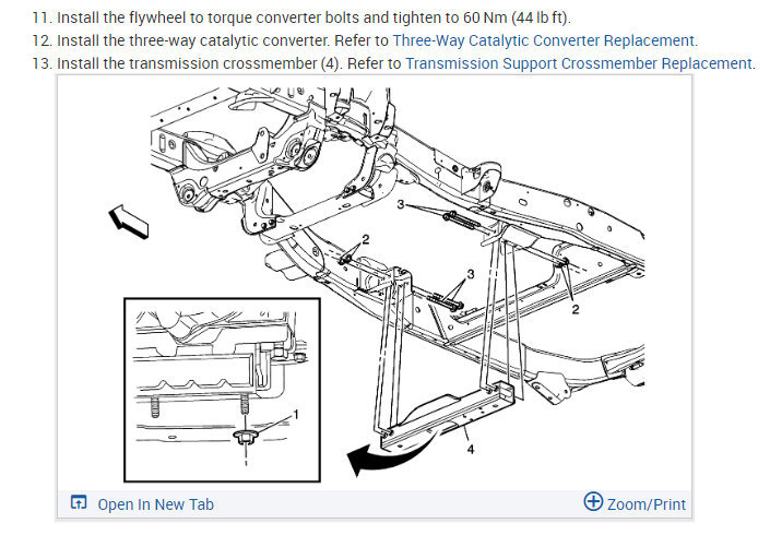

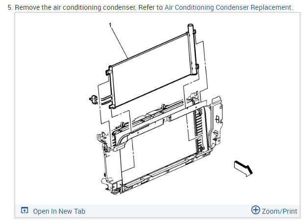

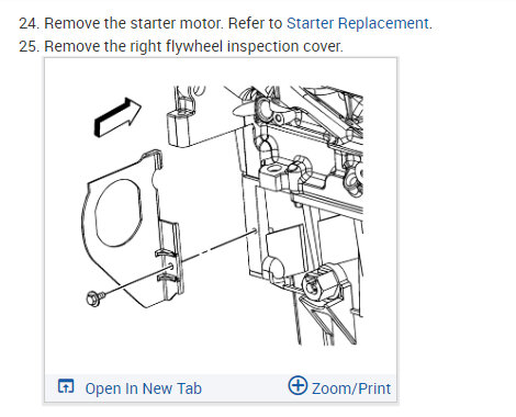

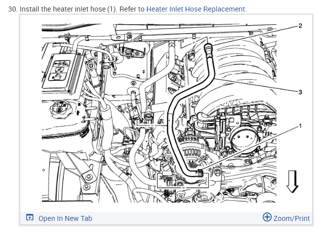

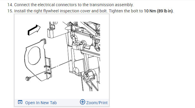

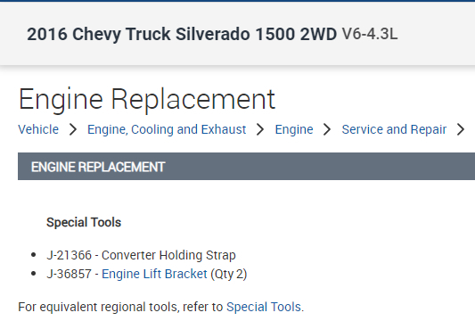

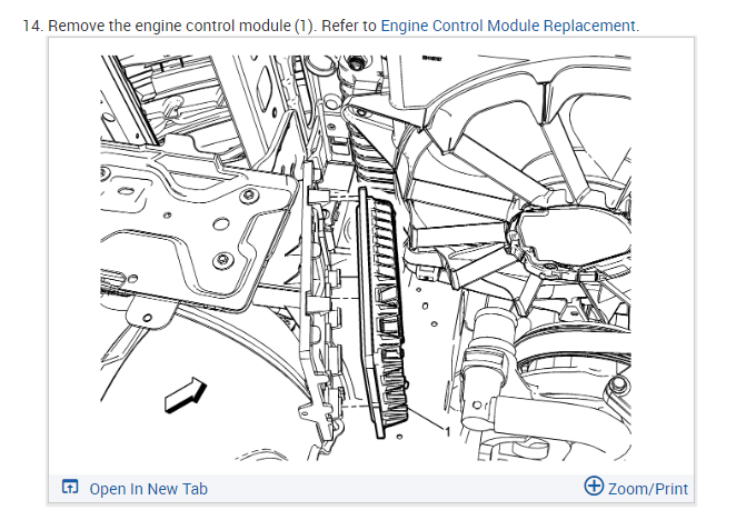

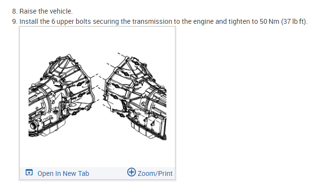

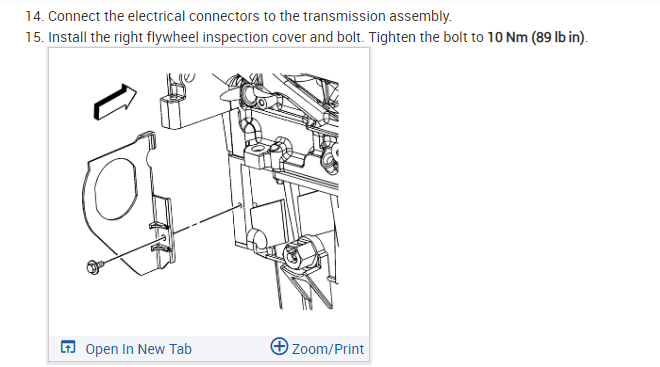

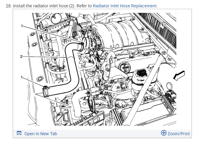

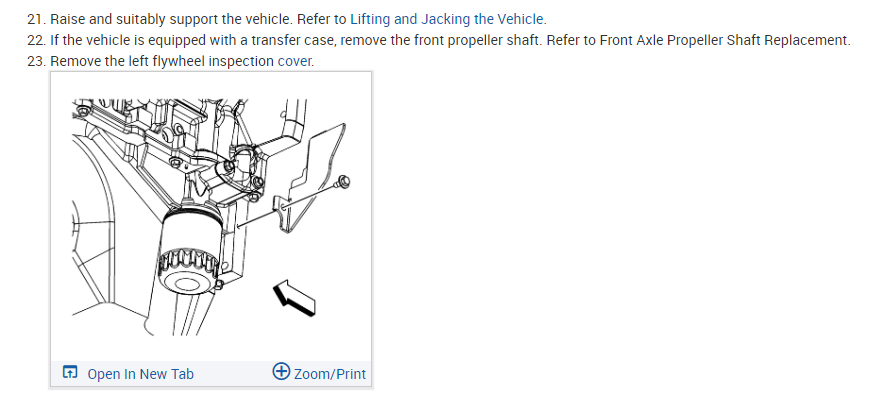

I got a new 62,000 salvaged engine and I'm getting ready to remove the bad motor. I'm looking for a complete mechanics guide on how to do this on my specific engine but I'm having trouble finding anything. Can you provide me with any diagrams or step by step procedures?
Aug 14, 2024 at 2:08 PM
  • 110,241 POSTS

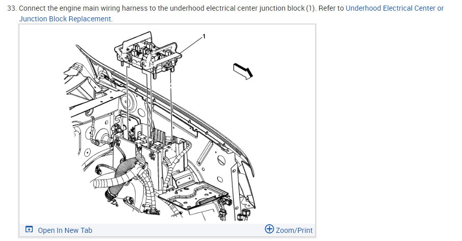

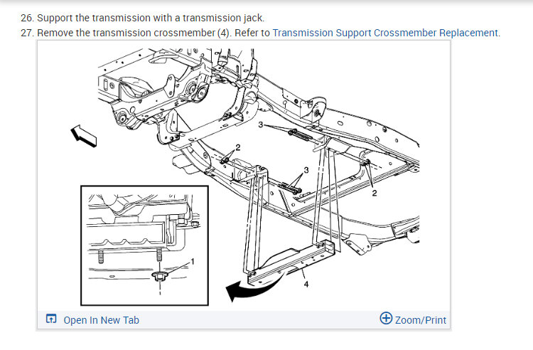

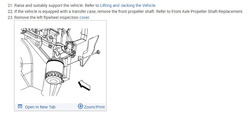

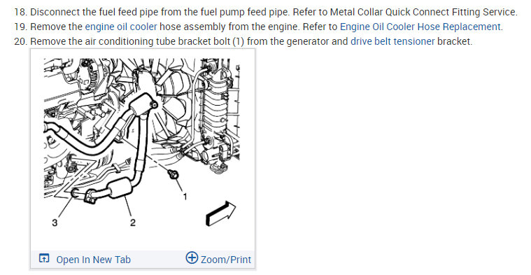

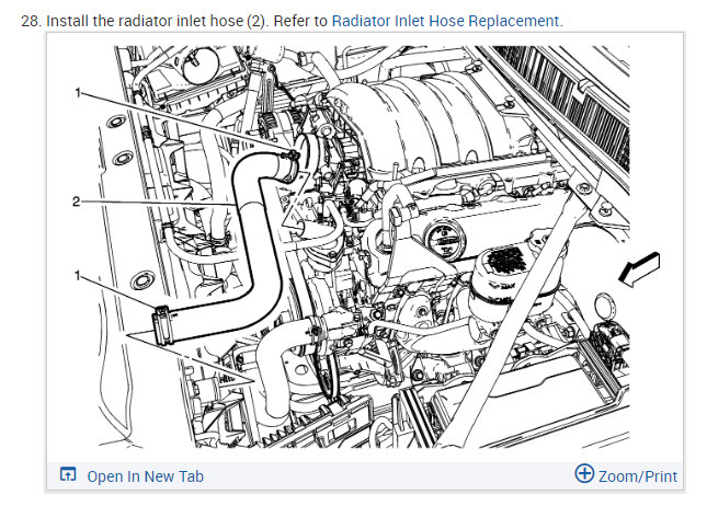

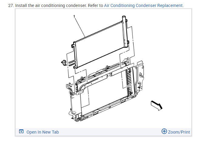

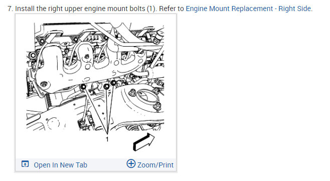

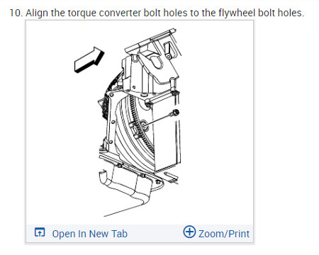

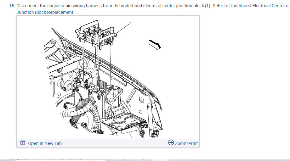

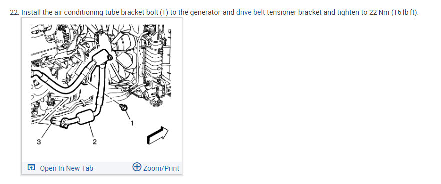

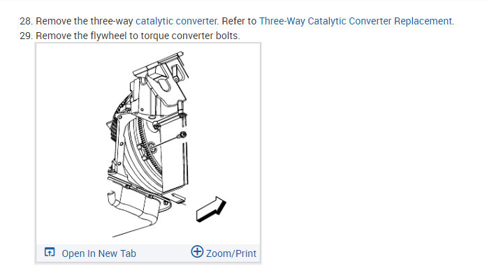

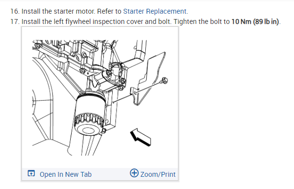

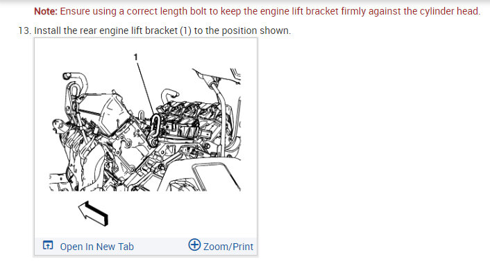

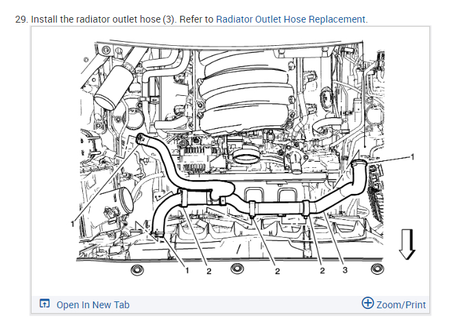

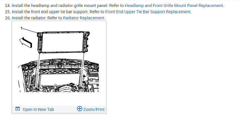

I attached the directions below for the removal and installation of the engine. There is a lot there. LOL
The one thing I noticed is they never indicated to disconnect the battery first. I strongly recommend that.
Take a look through the directions and let me know if they help.
