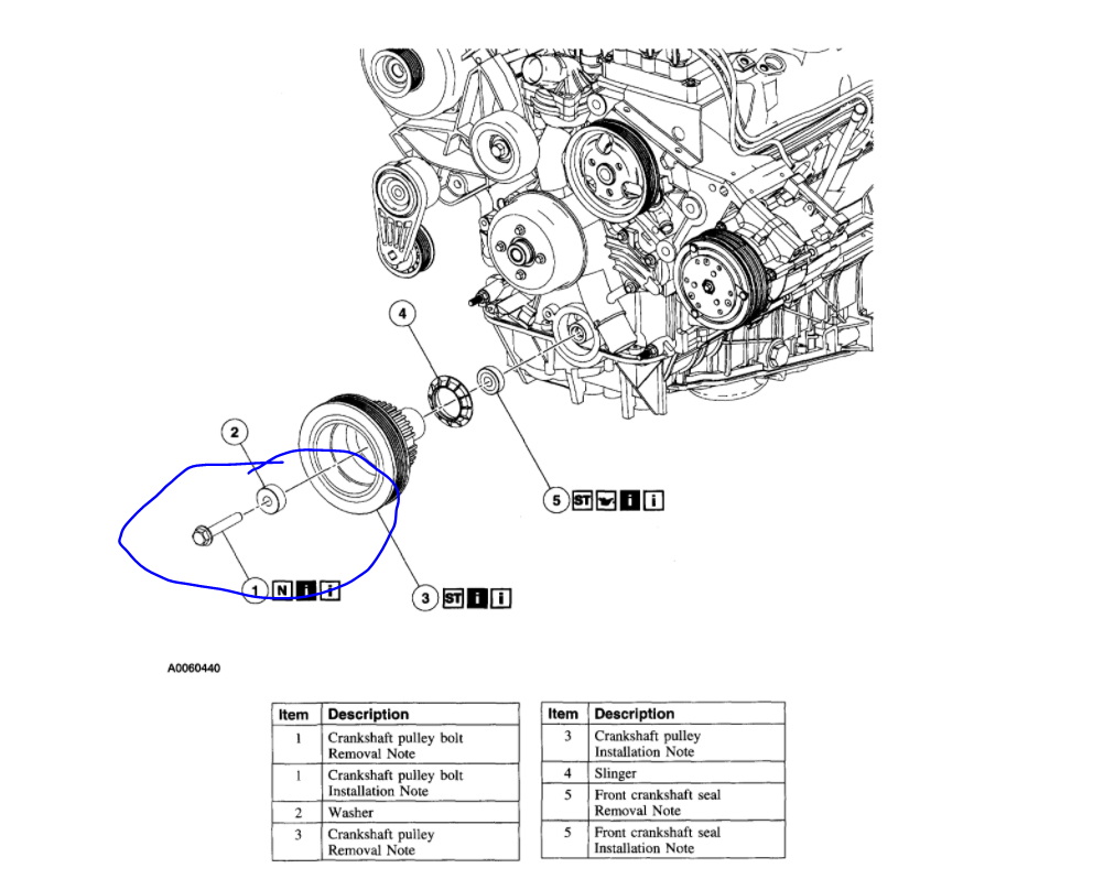

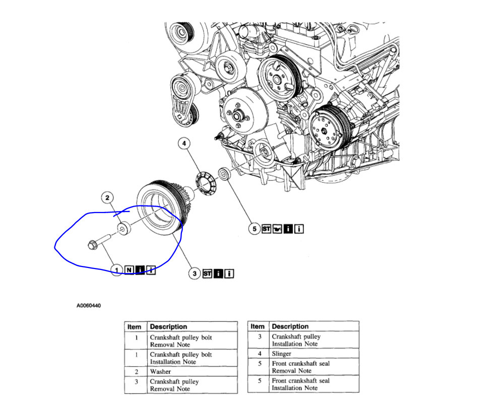

Okay I bought a stand. Everything is off except the mounts and the torque converter bolts. How do I turn the flywheel to access the bolts?
Apr 20, 2021 at 8:52 AM
You need to turn the crankshaft with the bolt on the harmonic balancer. Turn it until each nut shows and remove the nuts. There are 4 of them to release the torque converter.

My harmonic balancer is sitting on my kitchen table. I had to take it off to take my timing cover off to fix the chain guide only to find out it's the rear chain guide.
Apr 20, 2021 at 1:24 PM
You can reinstall the bolt to the crankshaft that holds the balancer on. Then turn the engine.
