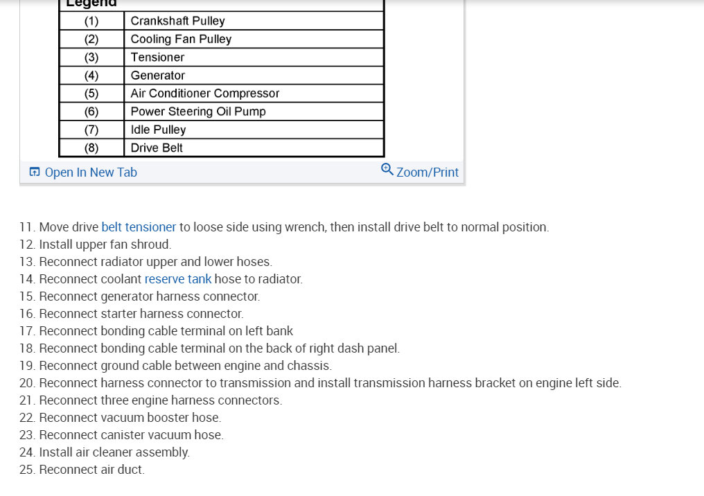

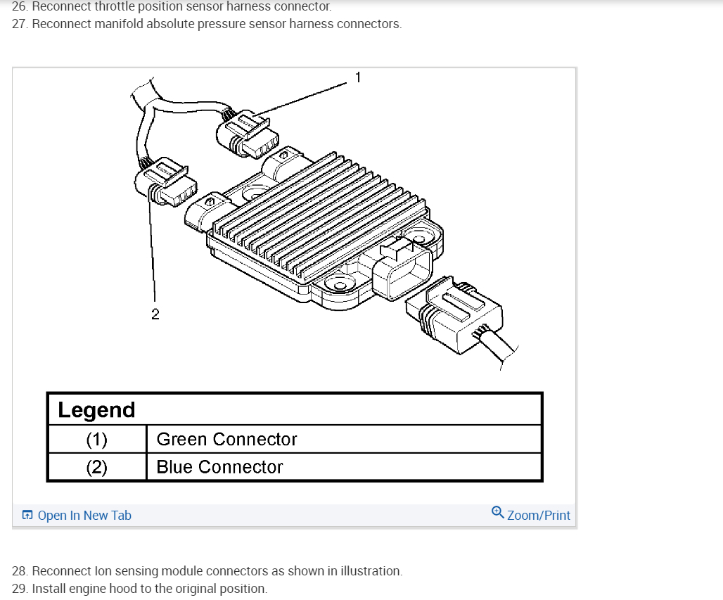

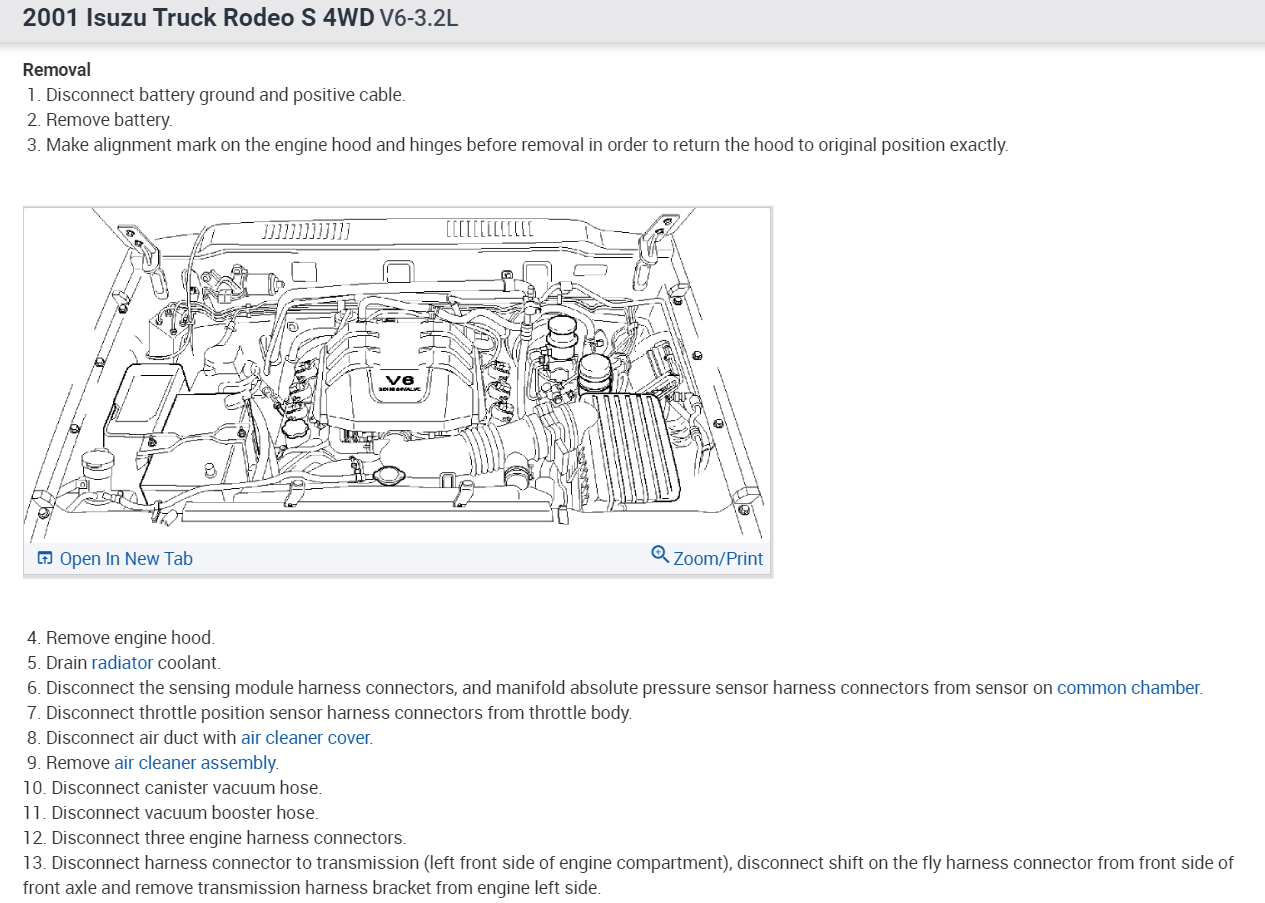

Do you need to remove the transmission to remove the engine?
2001 ISUZU RODEO
195,000 MILES • 3.2L • 6 CYL • 4WD • AUTOMATIC
CYRILLAFULLER
Apr 15, 2023 at 2:50 AM
  • 55,399 POSTS

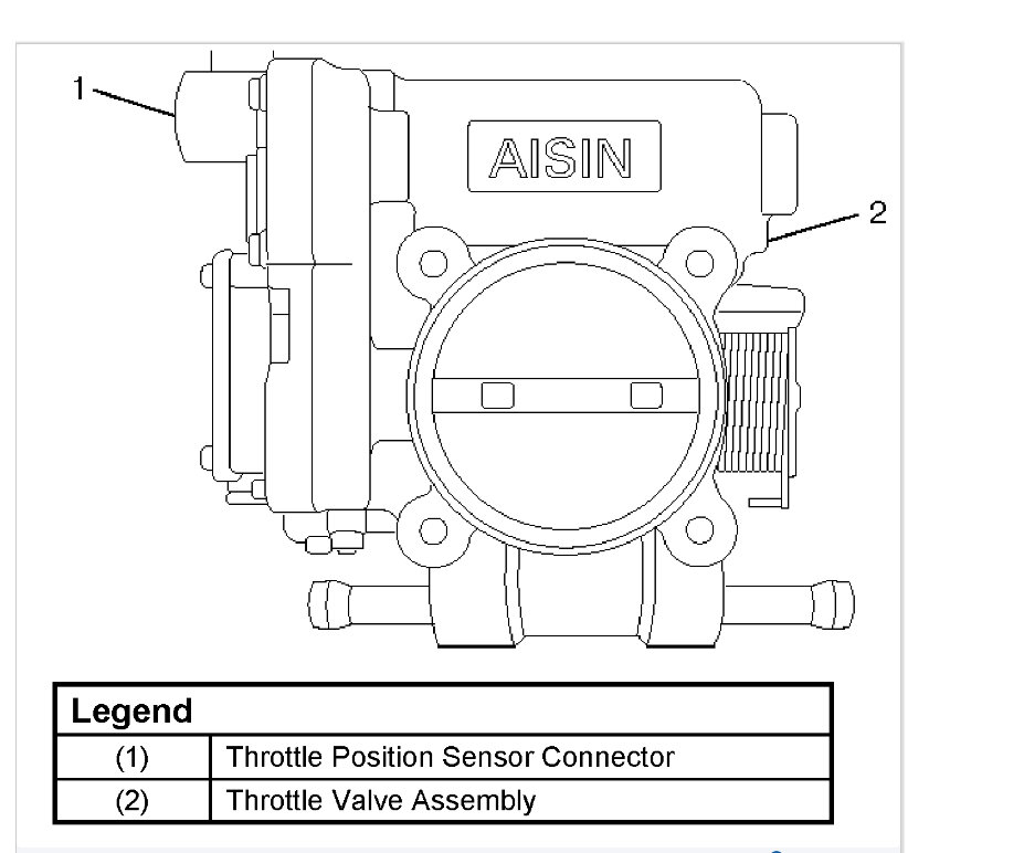

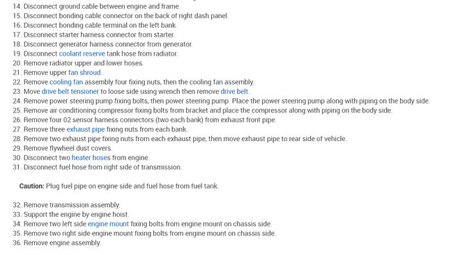

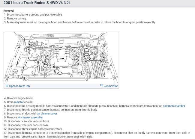

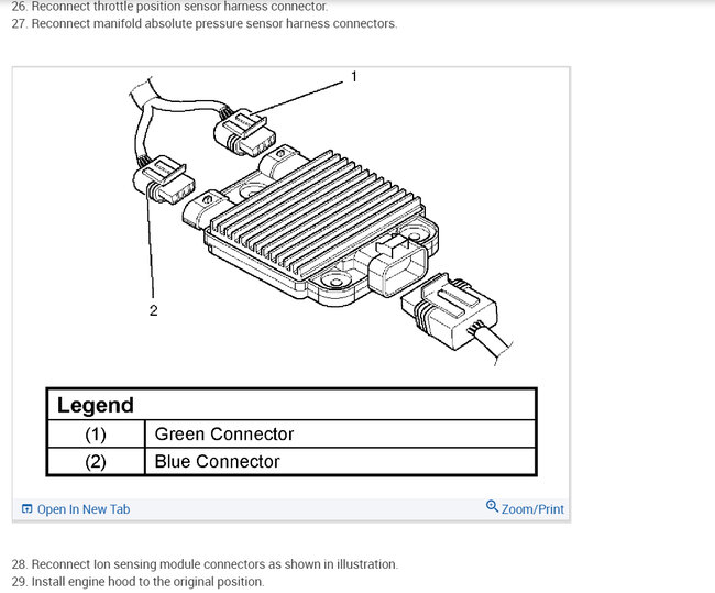

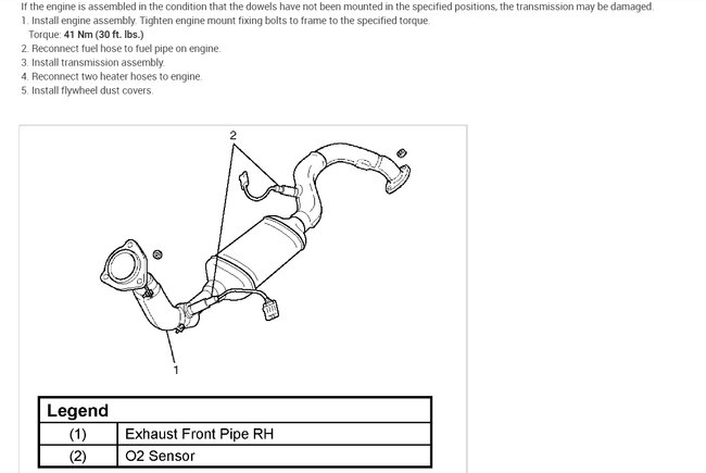

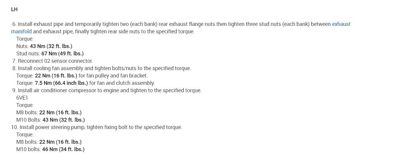

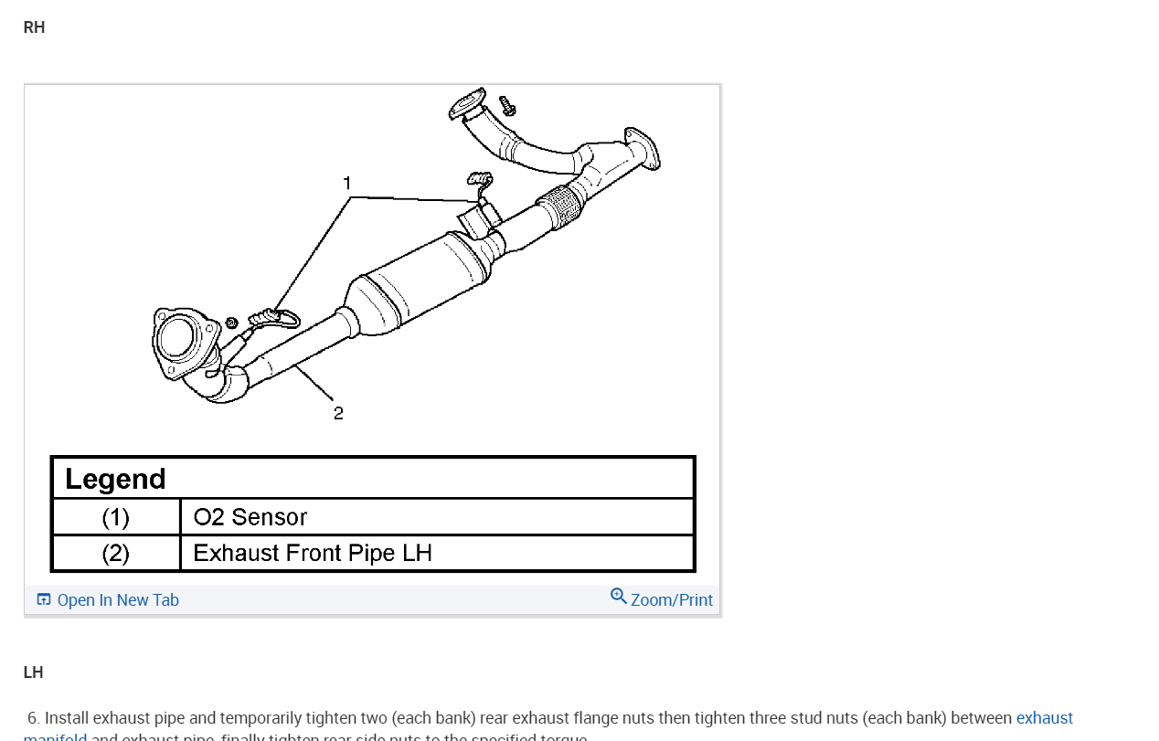

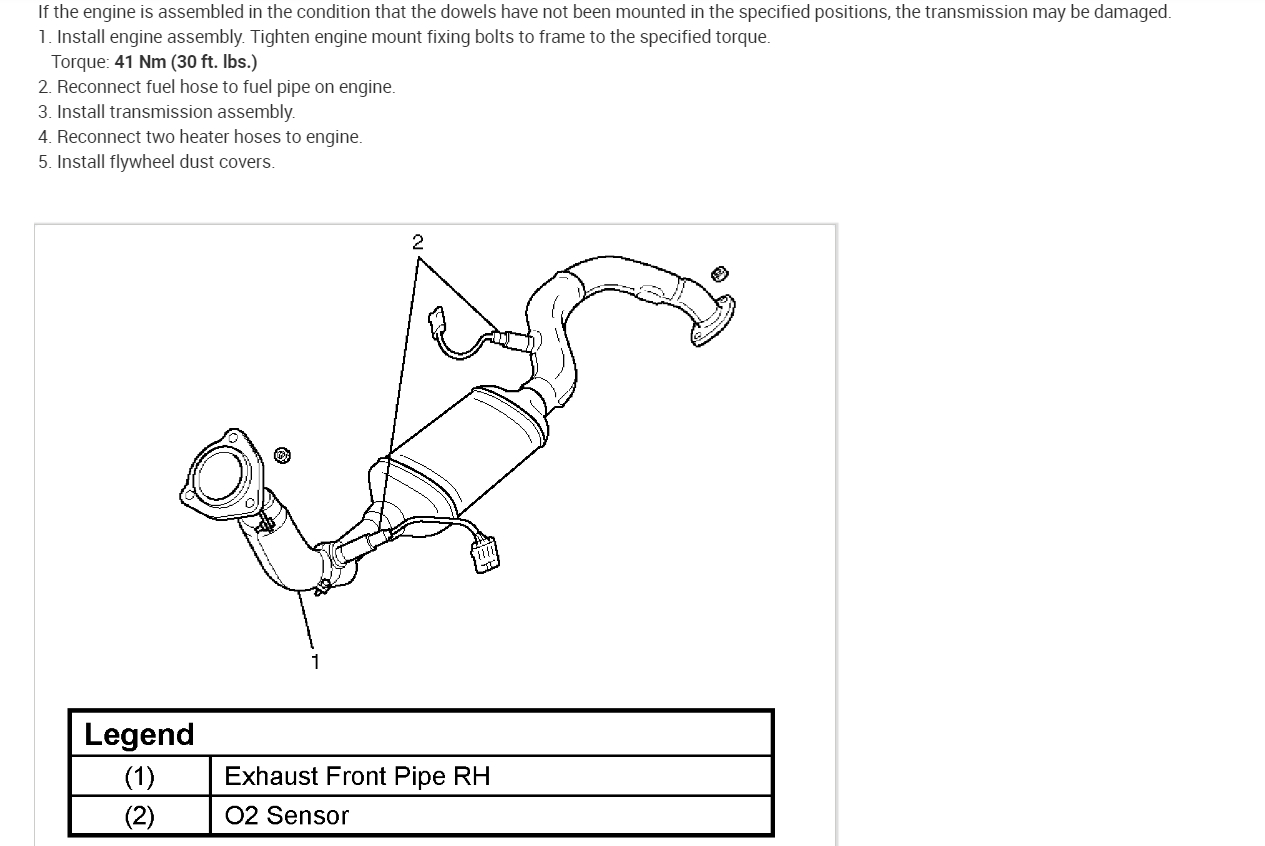

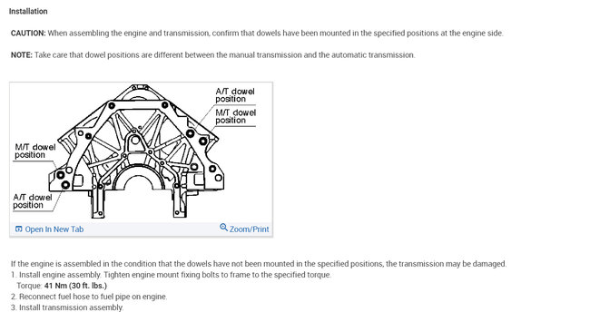

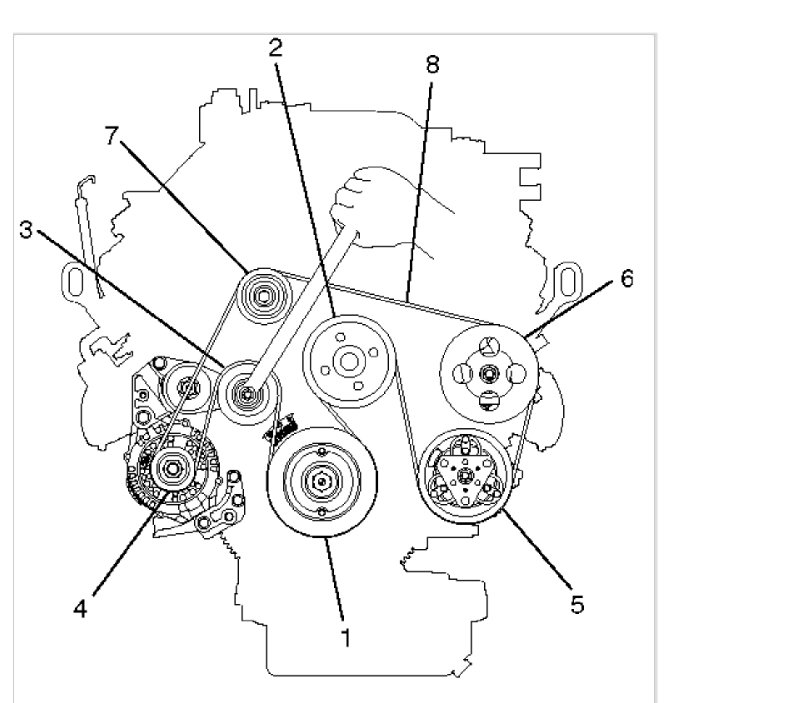

No, you do not, start by disconnecting the battery and draining the coolant. Here is a video of the job being done in a similar truck and instructions for your vehicle in the images below.
https://youtu.be/zy1CozLgWUQ
Check out the images (below). Please let us know if you need anything else to get the problem fixed.
Apr 15, 2023 at 9:47 AM
