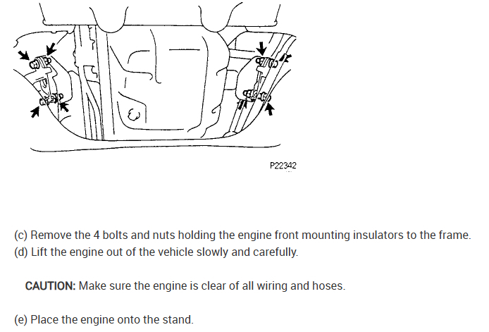

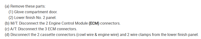

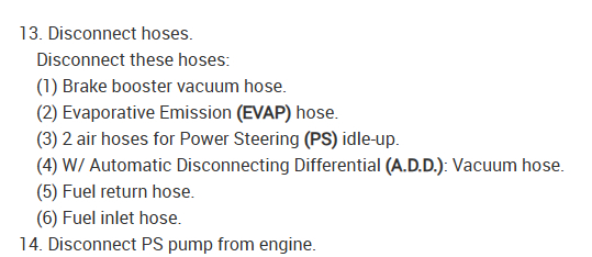

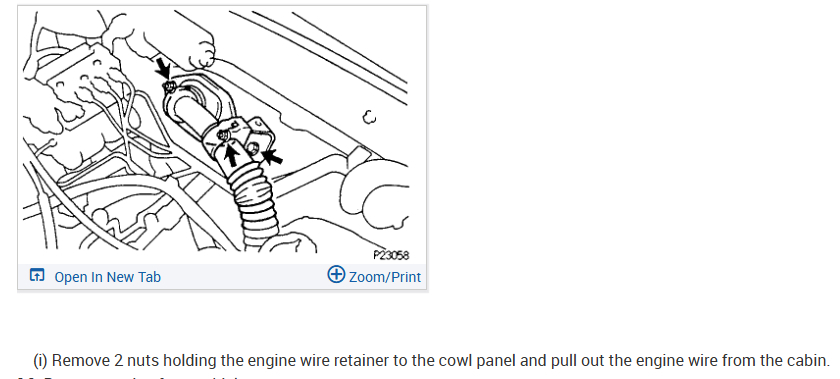

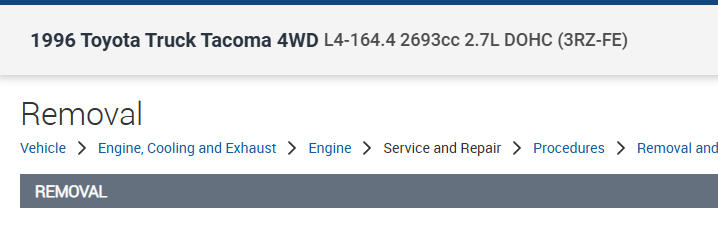

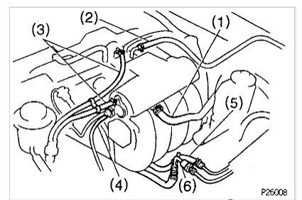

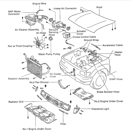

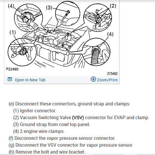

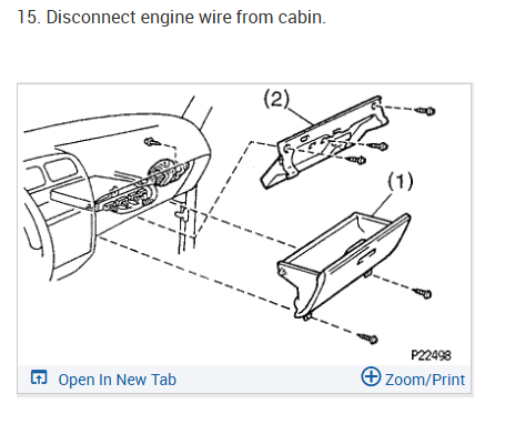

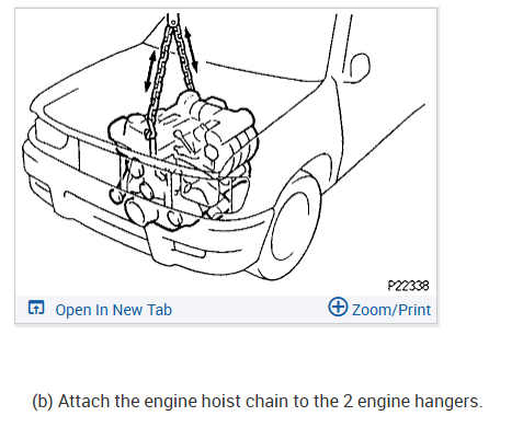

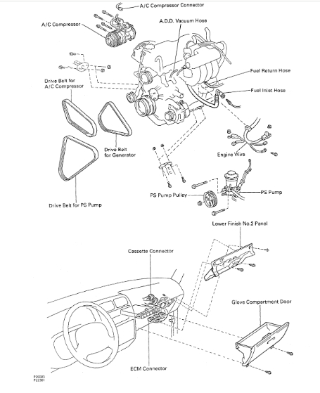

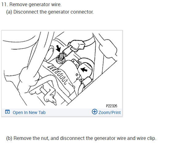

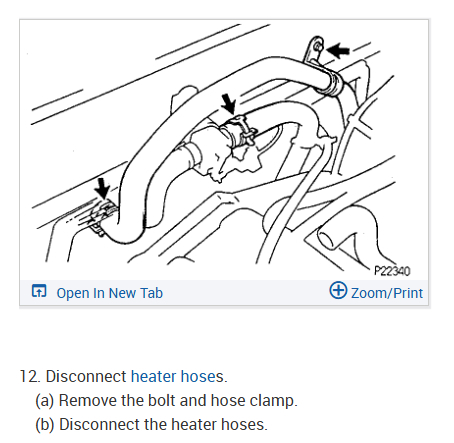

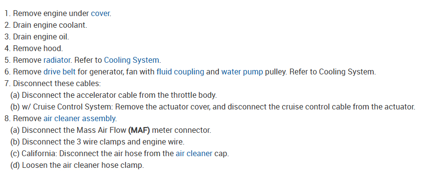

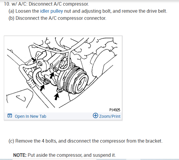

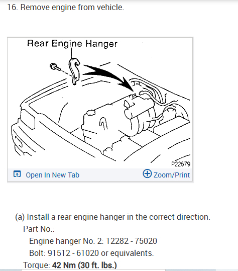

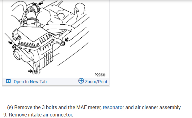

Hi:
You have a big job ahead of you. LOL. Regardless, I attached the directions for removing the engine. These are right from the manual, so I hope they are helpful.
Take a look through them and let me know if you have any questions.
See pics below
