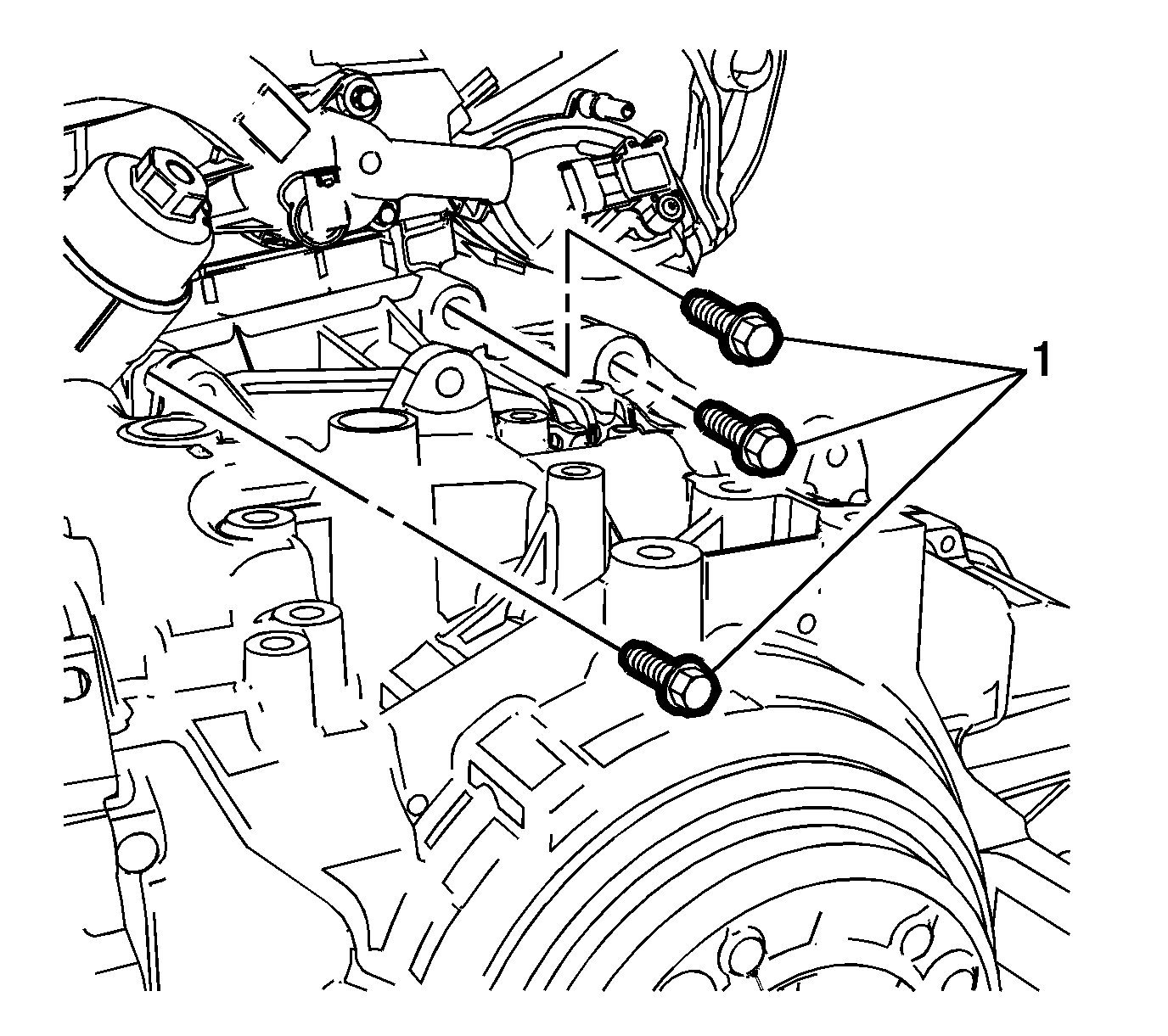

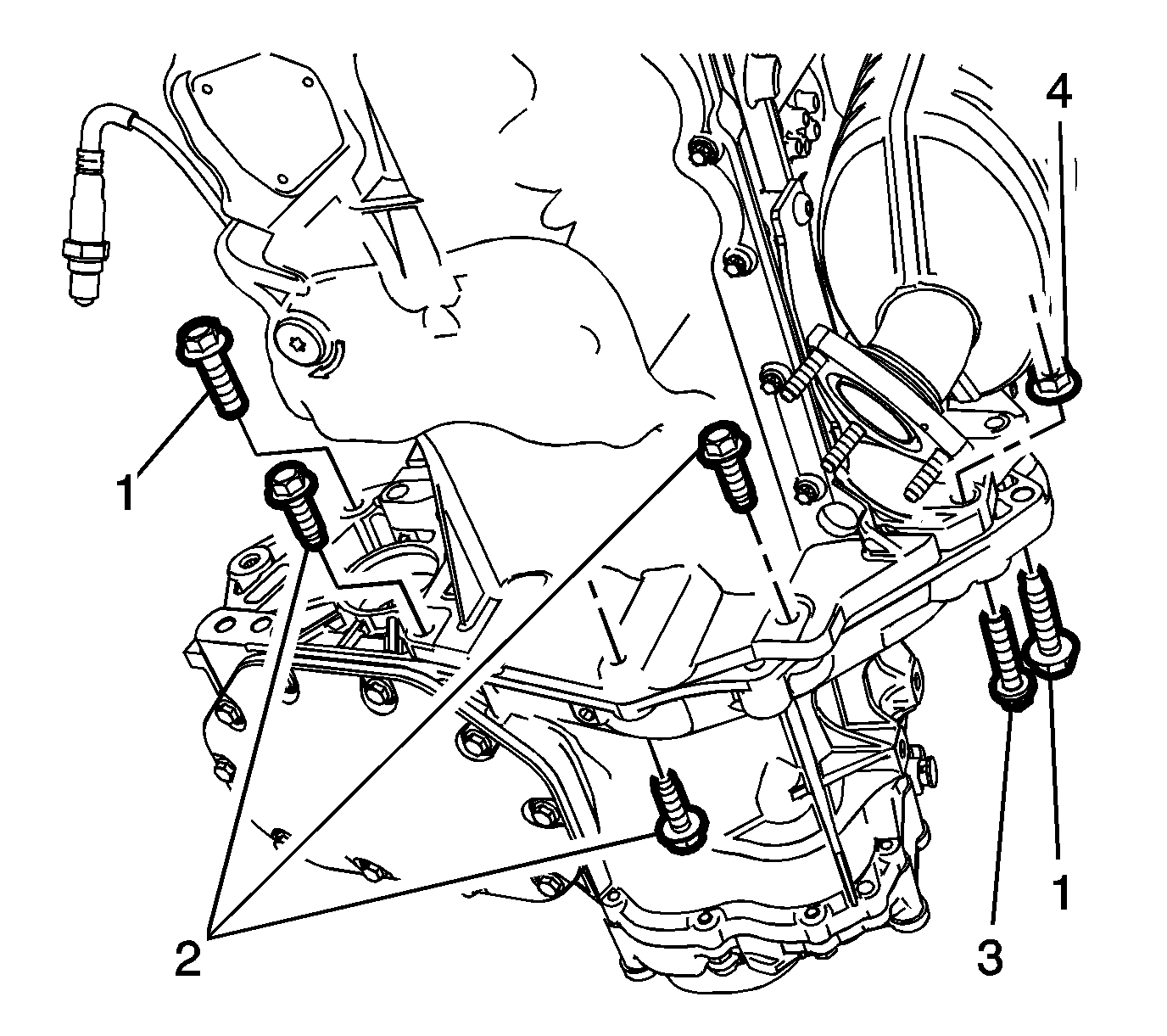

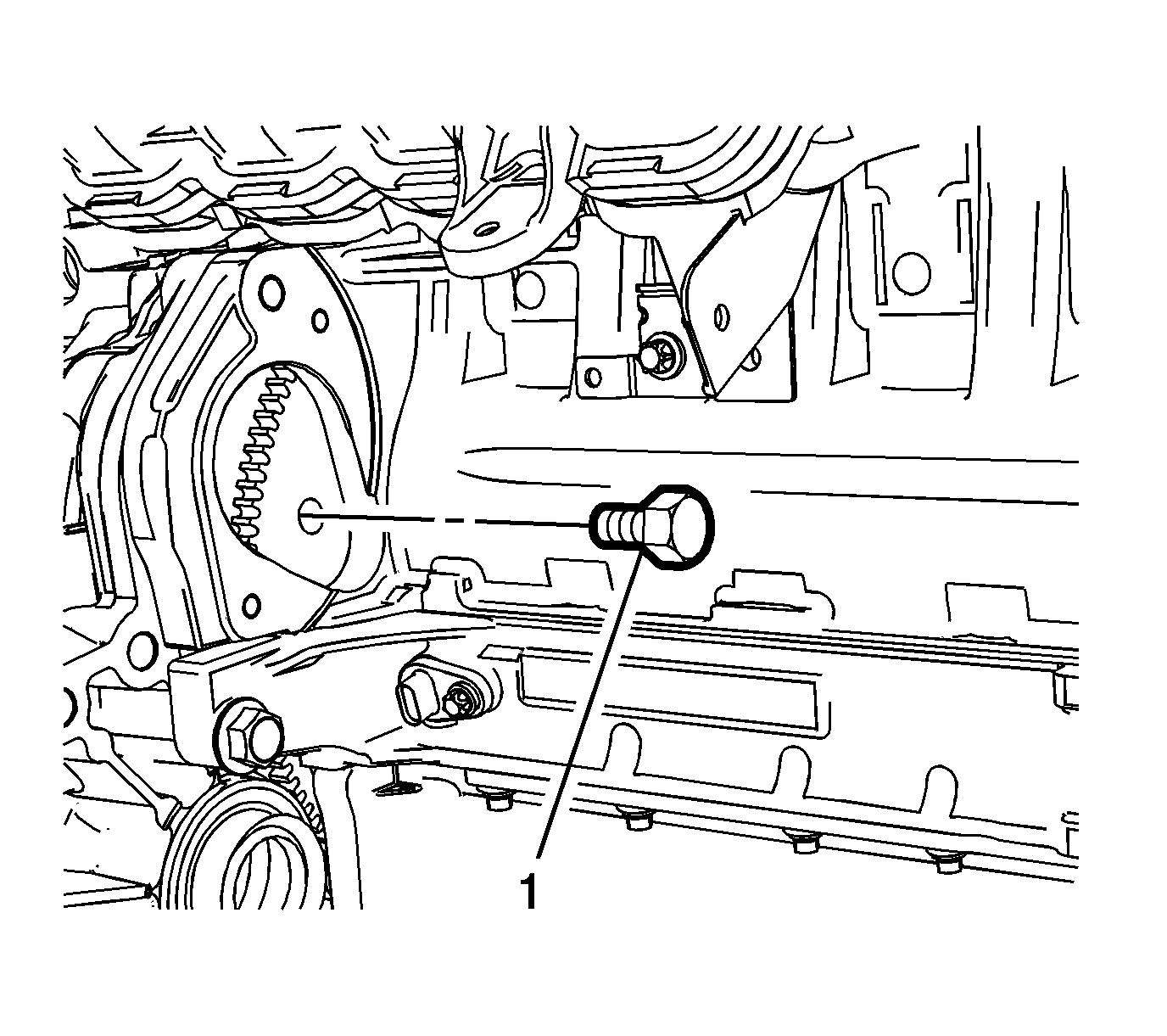

I'm about to pull this engine out, was wondering if easier from the top or bottom of vehicle? is there a printed step by step procedure to doing the engine removal?
Feb 7, 2020 at 12:27 PM
  • 110,194 POSTS
It comes out through the bottom. Here are the directions, step by step, explaining how to remove and replace the engine. The attached pics correlate with the directions.

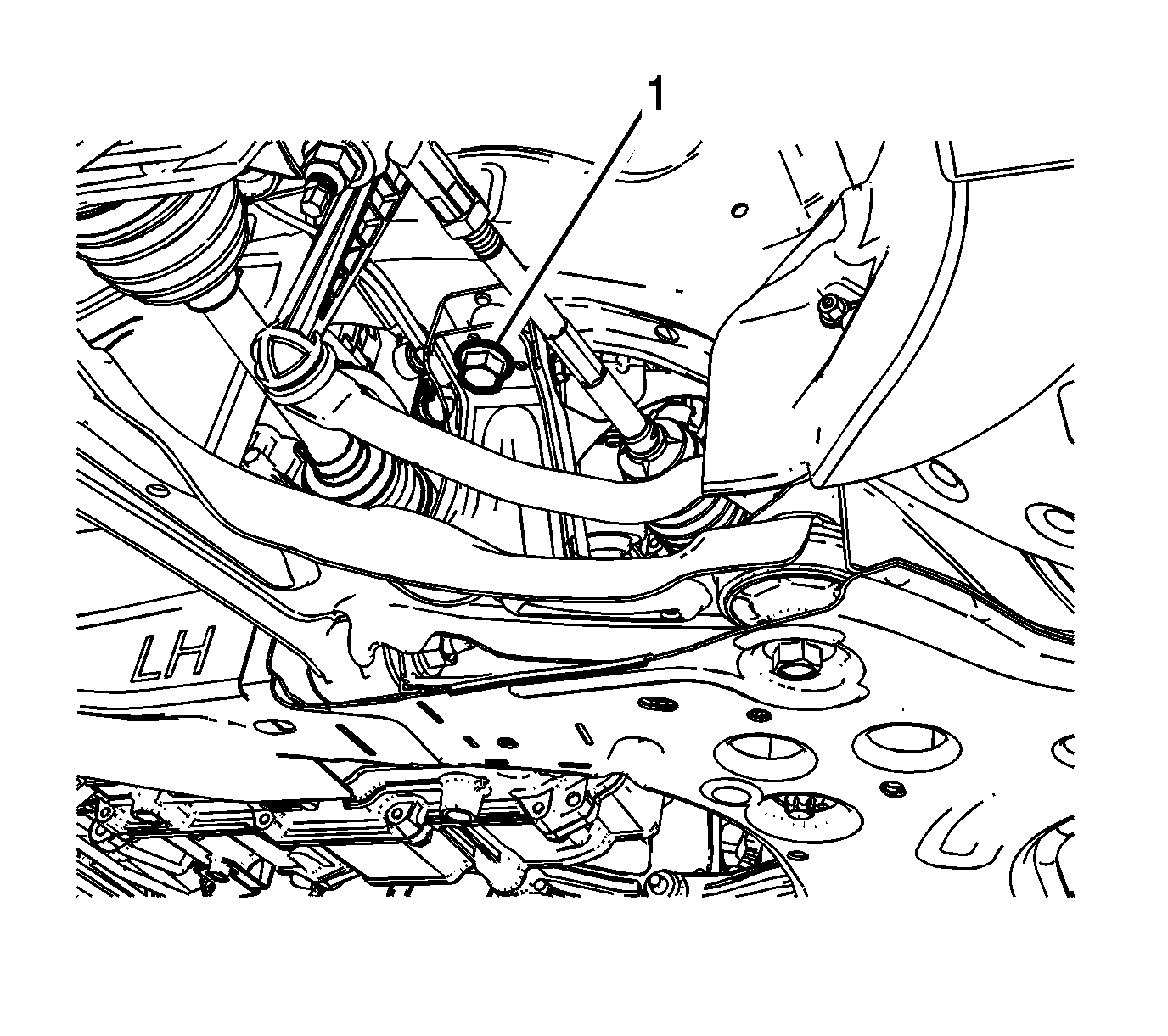

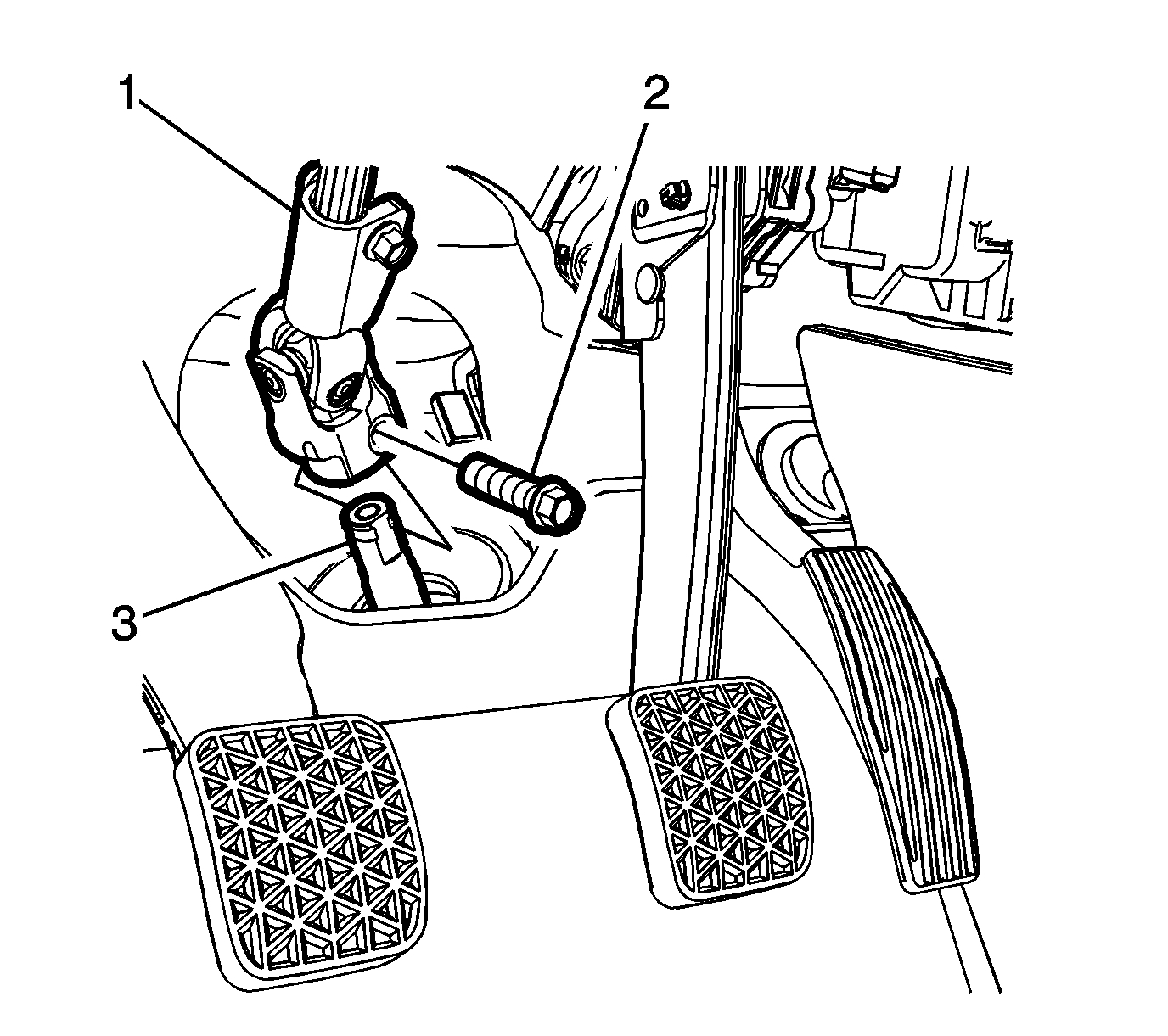

7. Remove the lower intermediate steering shaft bolt (2) and slide the shaft away from steering column. Refer to Intermediate Steering Shaft Replacement (NJ1) See: Steering Shaft > Removal and Replacement > Intermediate Steering Shaft Replacement (Non-Variable Ratio, Electric)Intermediate Steering Shaft Replacement (N40) See: Steering Shaft > Removal and Replacement > Intermediate Steering Shaft Replacement (Non-Variable Ratio).

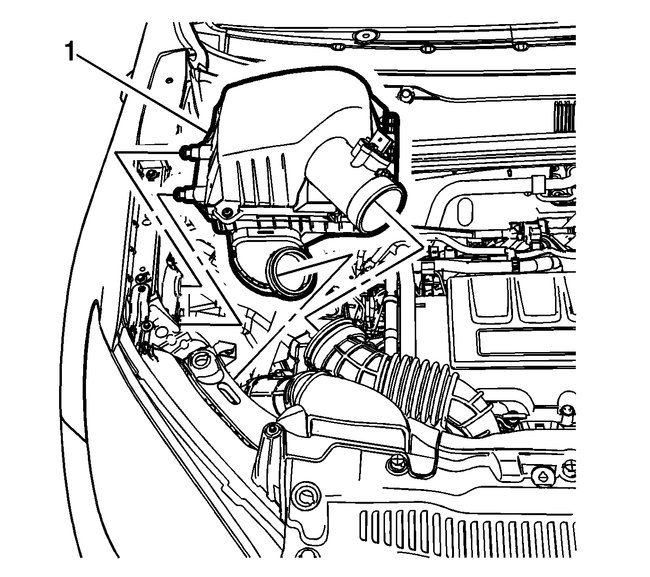

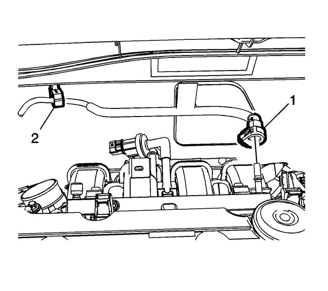

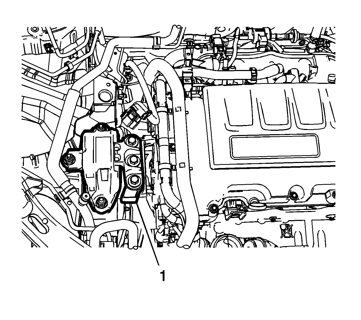

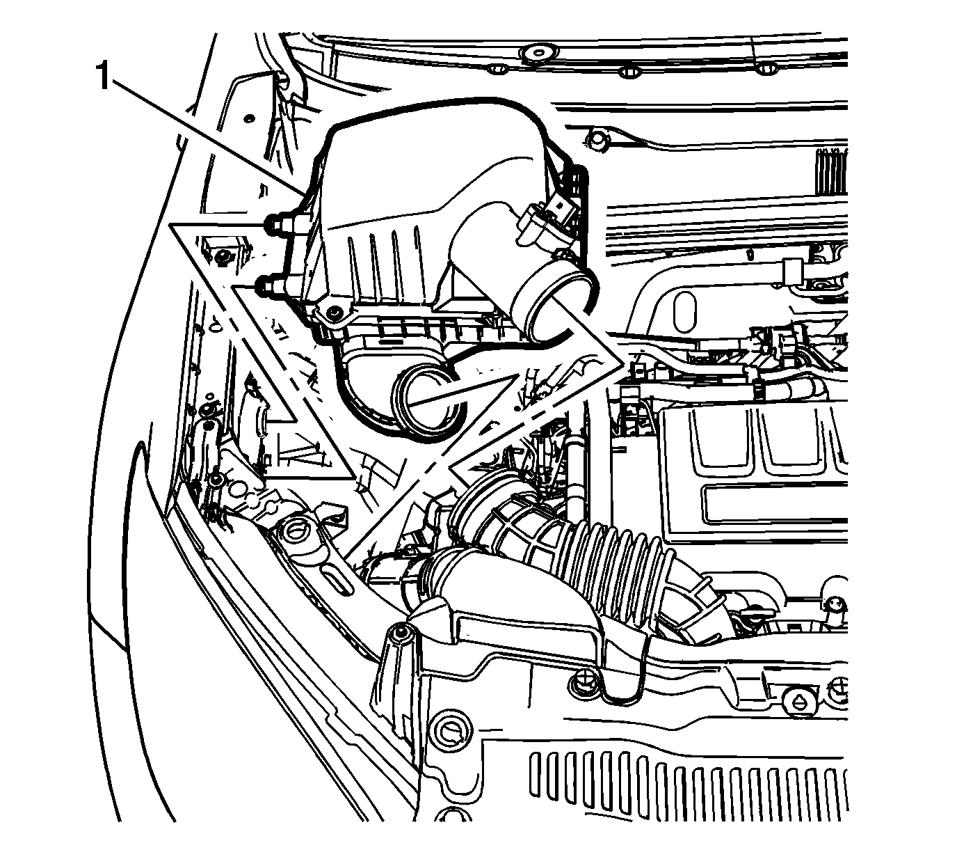

8. Remove the air cleaner assembly (1). Refer to Air Cleaner Assembly Replacement See: Air Cleaner Housing > Removal and Replacement > Air Cleaner Assembly Replacement.

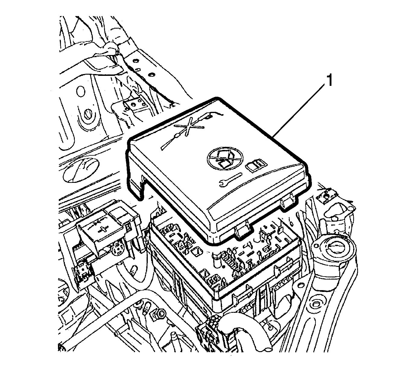

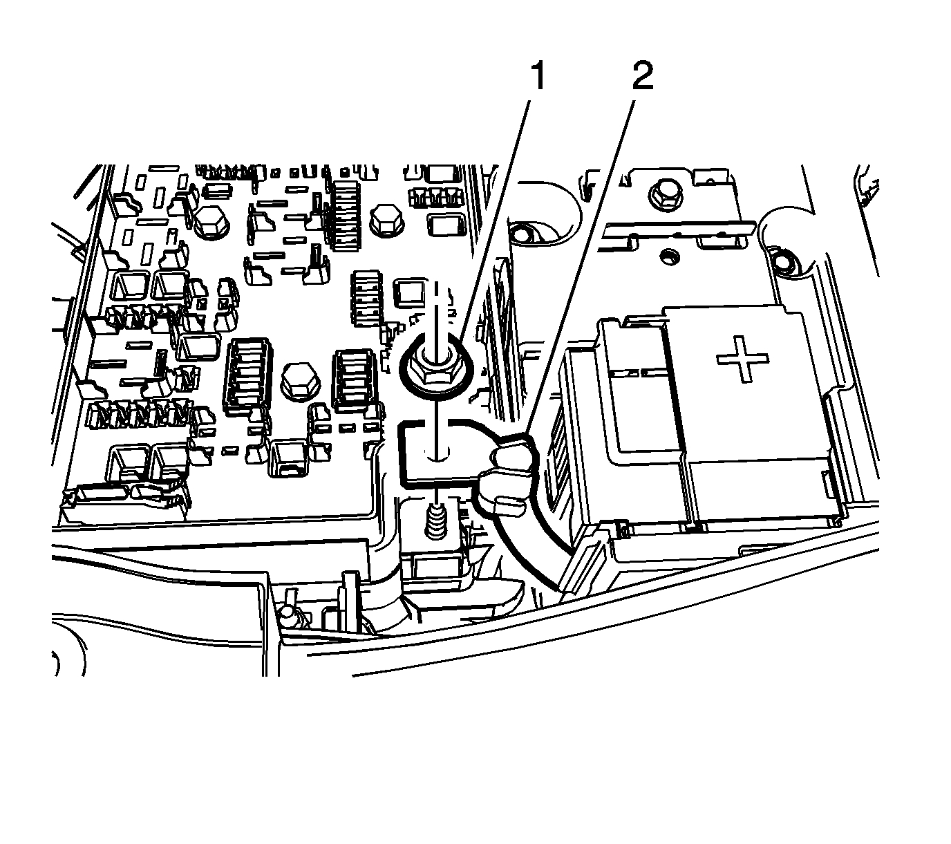

9. Remove the junction block cover (1).
pic 4

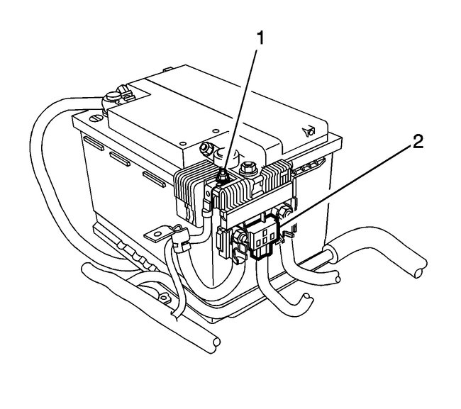

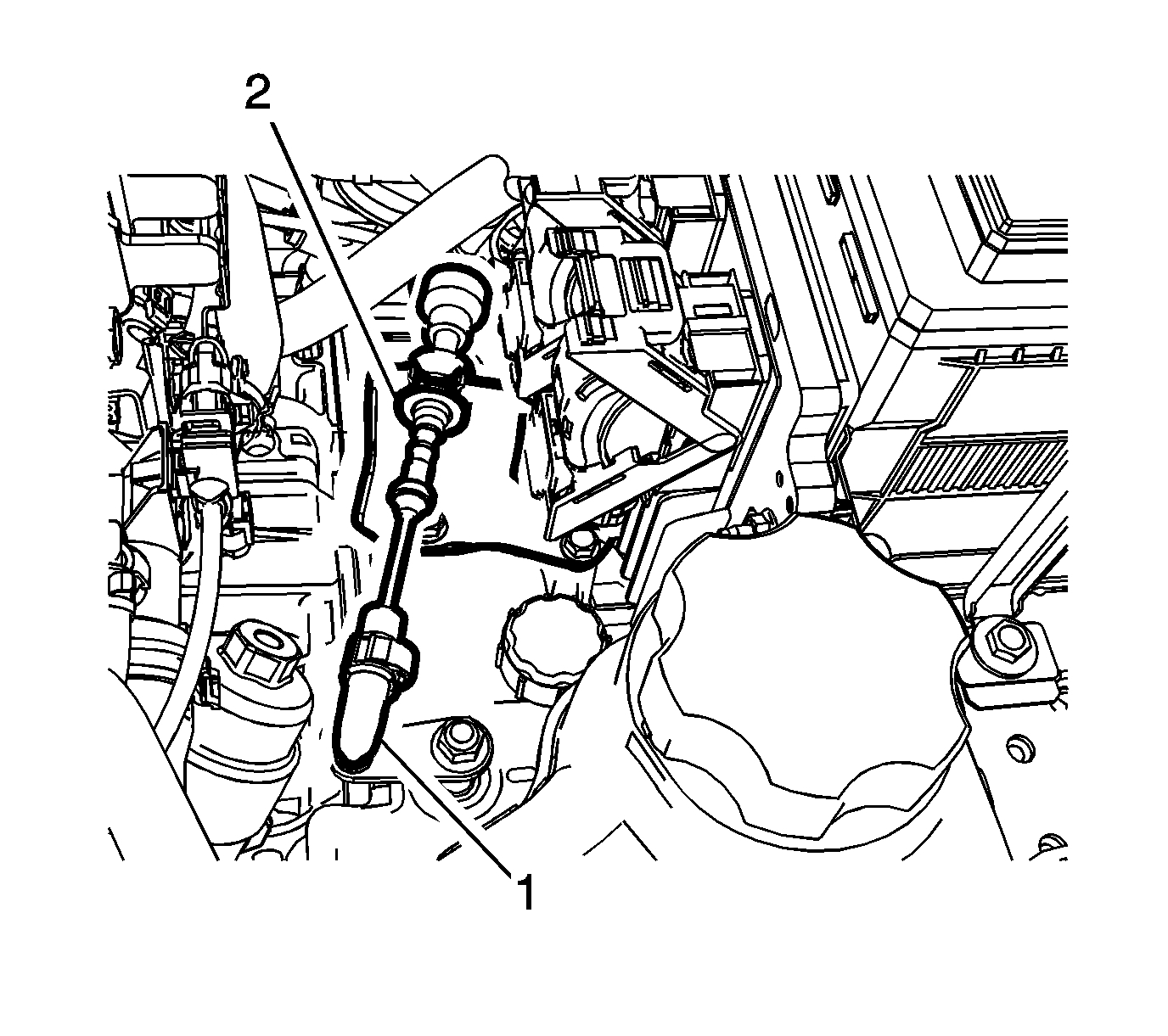

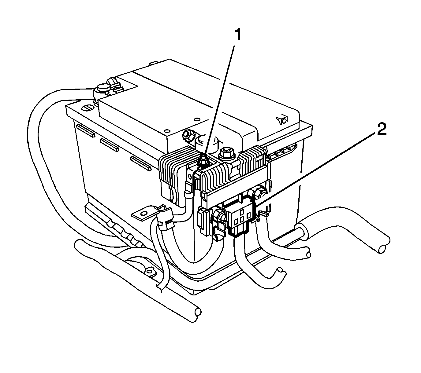

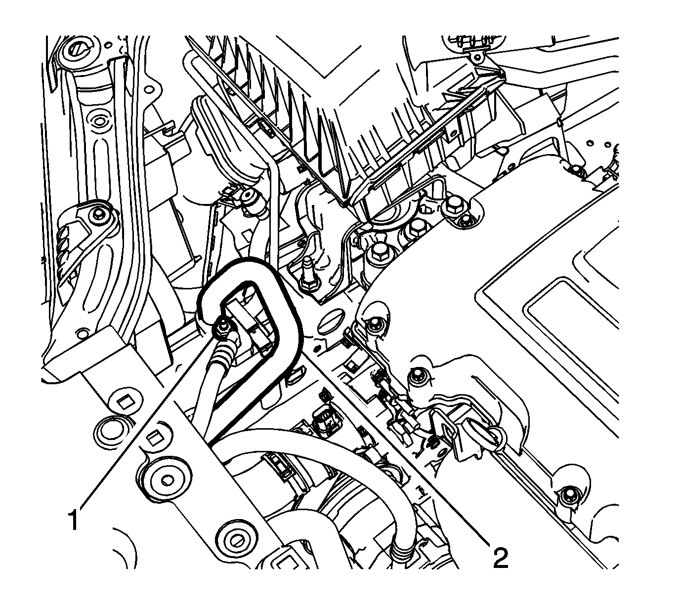

10. Remove the positive battery cable nut (1) from the junction block.
11. Remove the positive battery cable (2) from the junction block.
pic 5

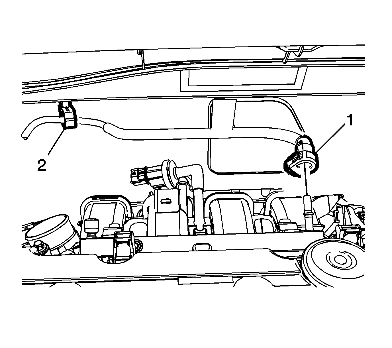

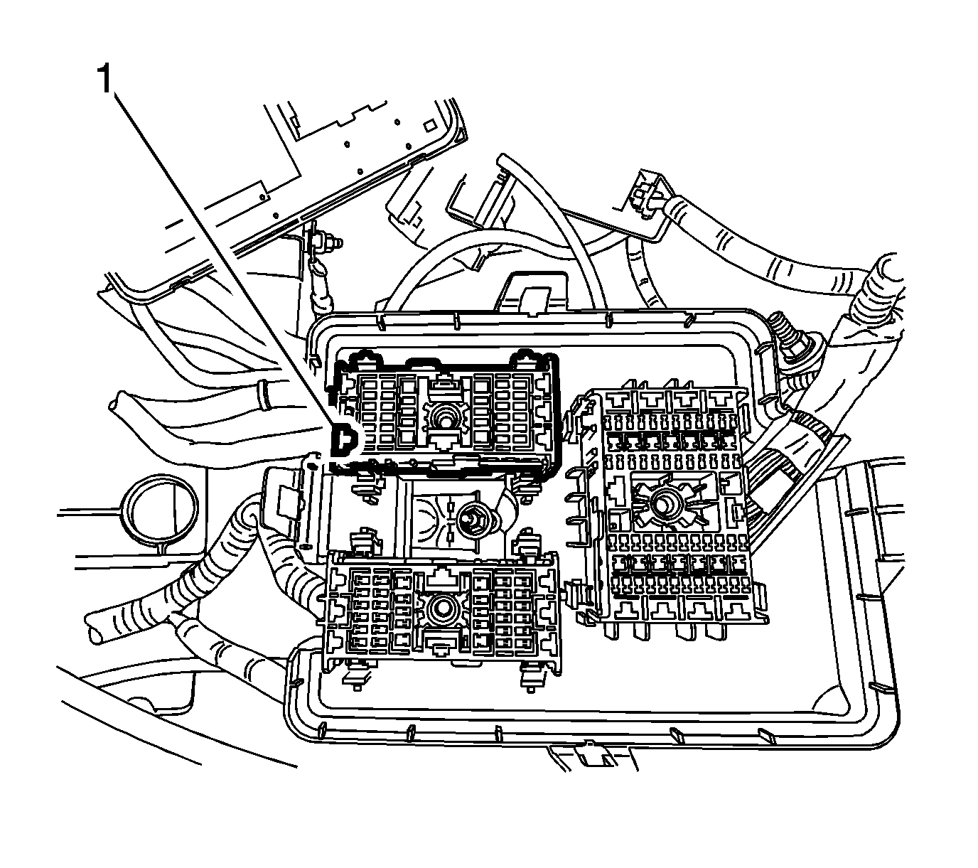

12. Remove the positive cable nut (1) and battery positive cable from the battery positive cable junction block.
13. Disconnect the body wiring master harness connector (2) from the battery positive cable junction block.
pic 6

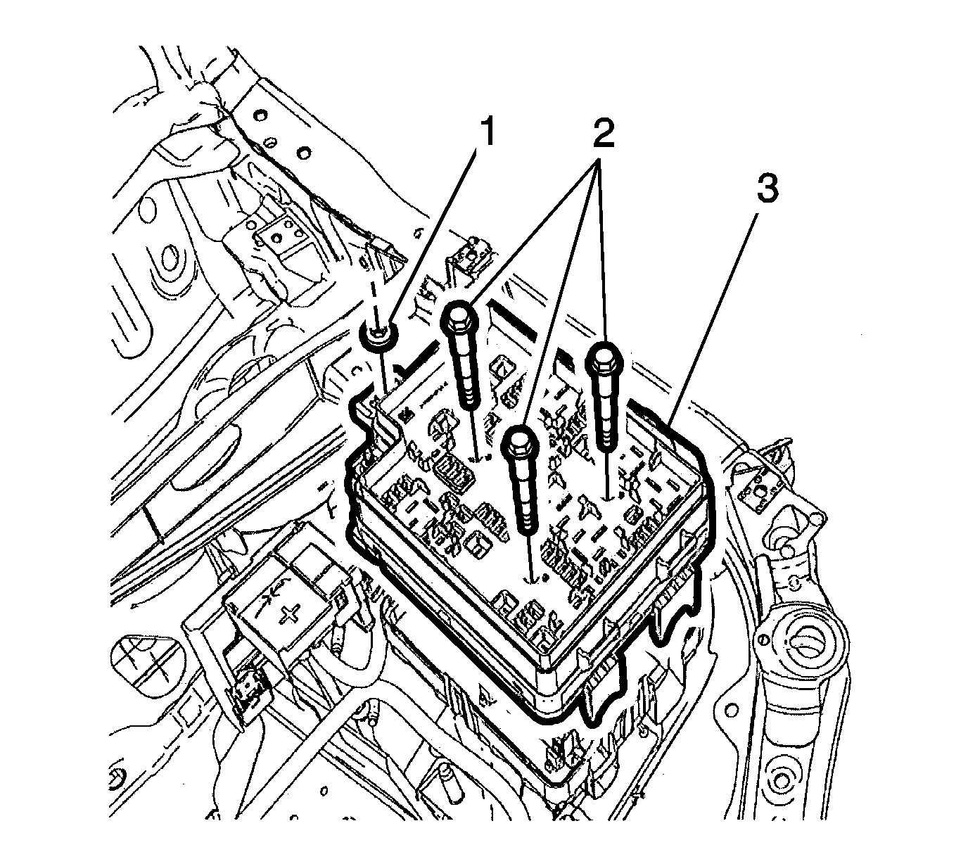

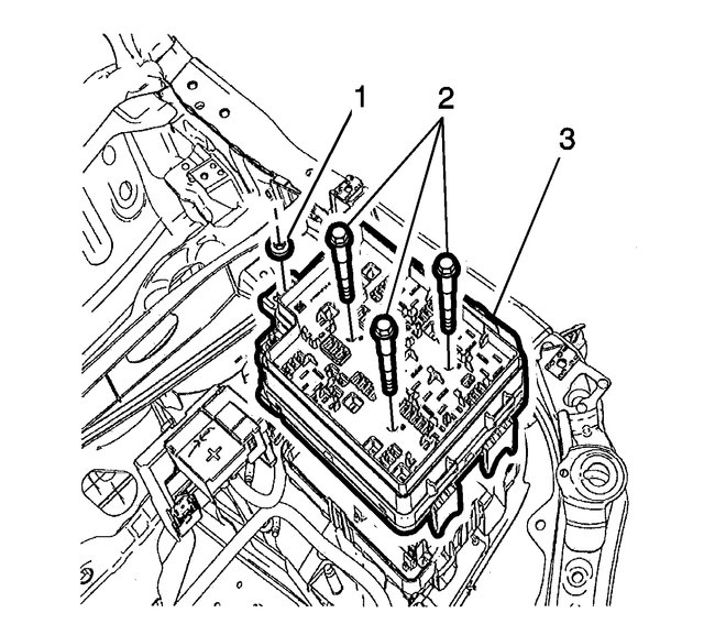

14. Remove the junction block nut (1).
15. Remove the junction block bolts (2).
16. Disconnect the wiring harness from the junction block base.
17. Remove the junction block (3) from the base.
18. Disconnect the wiring harness plug from the front compartment fuse block.

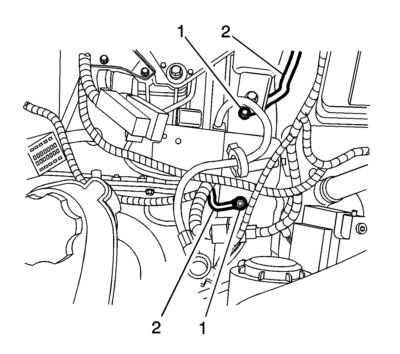

19. Reposition the wiring harness (1) on top of the engine.
pic 8
20. Remove the ground nuts (1) and reposition the wiring harness (2) aside.

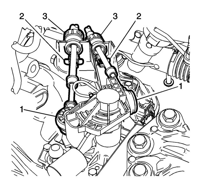

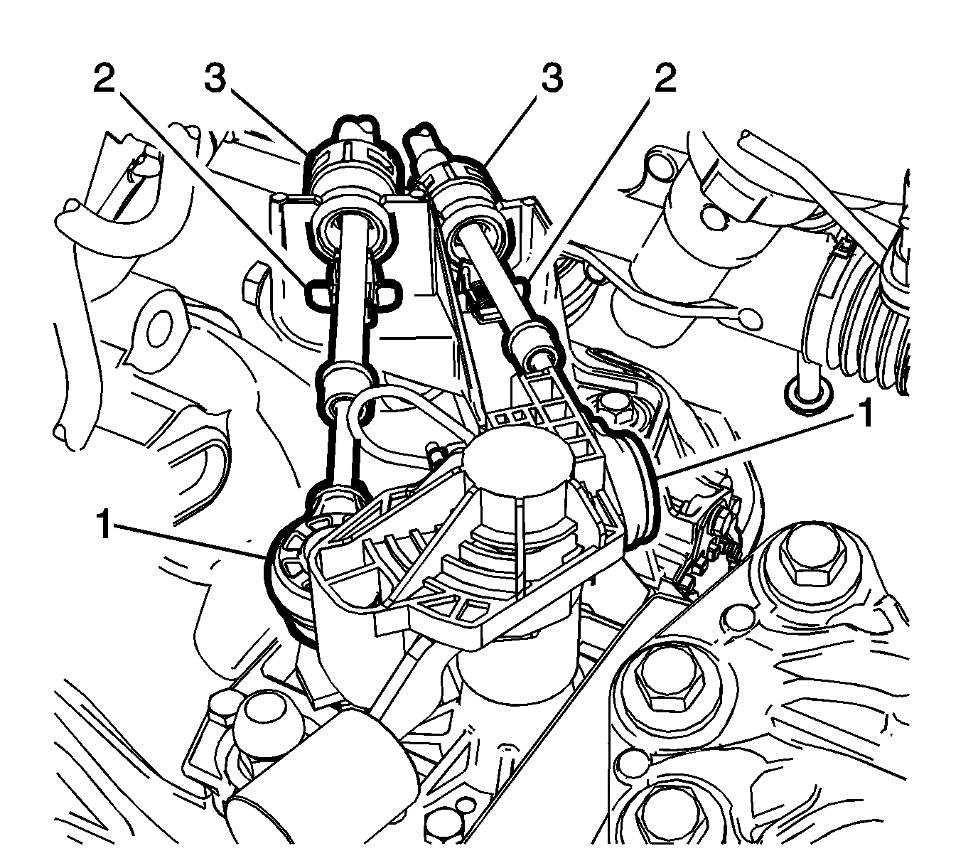

24. If equipped with an automatic transmission, disconnect the transmission range selector lever cable terminal (1) from the transmission manual shift lever pin.
25. Remove the transmission range selector lever cable (2) from the cable bracket.
pic 11
26. If equipped with manual transmission, disconnect the shift lever and selector lever cable end (1) from the transmission shift lever and selector lever.
27. Pull the cable retainers (2) to release the shift lever and selector lever cable from the shift lever and selector lever cable bracket.
28. Disconnect the shift lever and selector lever cable from the shift lever and selector lever cable bracket.
pic 12

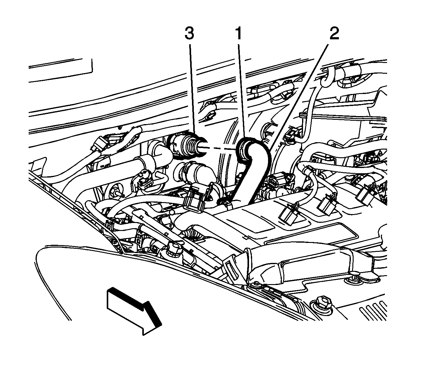

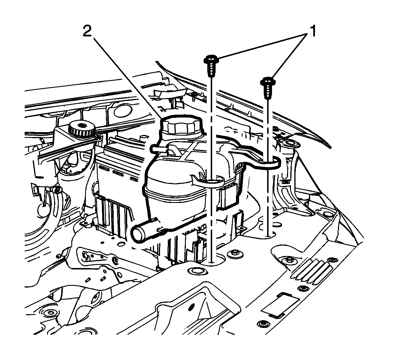

29. Remove the radiator surge tank (2) and position aside. Refer to Radiator Surge Tank Replacement (LUV, 2H0, LUJ) See: Coolant Reservoir > Removal and Replacement > Radiator Surge Tank Replacement.
30. Disconnect the fan connector.

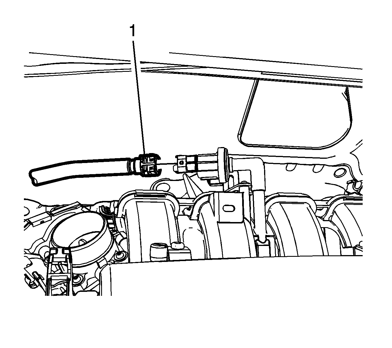

33. Disconnect the fuel feed pipe. Refer to Plastic Collar Quick Connect Fitting Service See: Coolant Line/Hose > Procedures > Plastic Collar Quick Connect Fitting Service.
pic 15
34. Disconnect the evaporative emission pipe (1). Refer to Plastic Collar Quick Connect Fitting Service See: Coolant Line/Hose > Procedures > Plastic Collar Quick Connect Fitting Service.

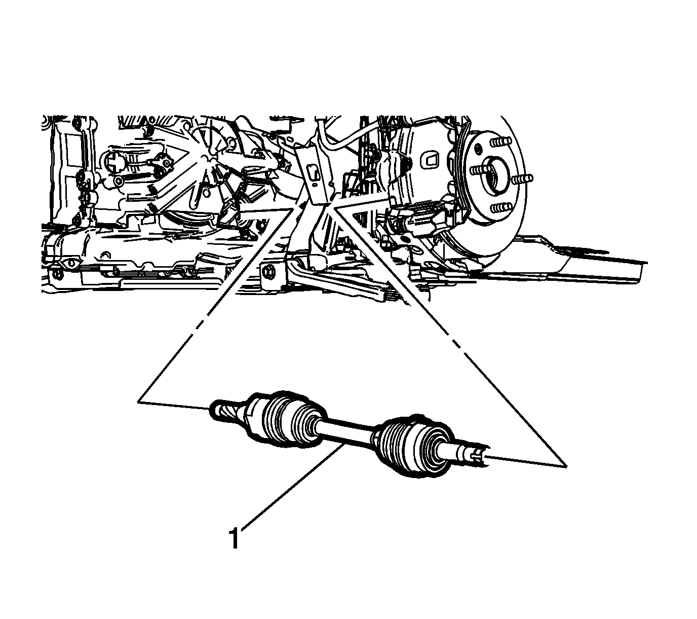

35. Remove the wheel drive shafts. Refer to Front Wheel Drive Shaft Replacement - Left Side See: Axle Shaft Assembly > Removal and Replacement > Front Wheel Drive Shaft Replacement - Left Side and Front Wheel Drive Shaft Replacement - Right Side See: Axle Shaft Assembly > Removal and Replacement > Front Wheel Drive Shaft Replacement - Right Side.

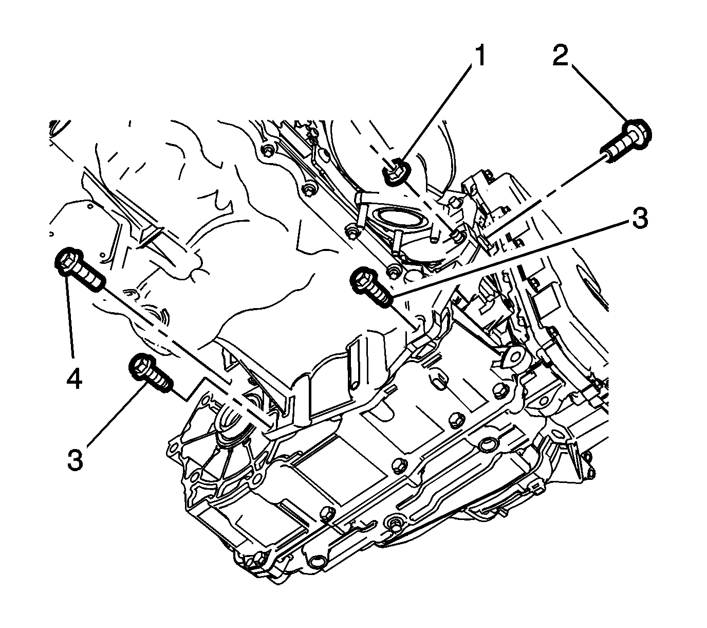

37. If equipped with an automatic transmission, remove the lower transmission nut (1) and the lower transmission bolts (2, 3, 4).
pic 18
38. If equipped with manual transmission, remove the lower transmission bolt (3) and nut (4).
39. Remove the lower transmission bolts (1, 2).

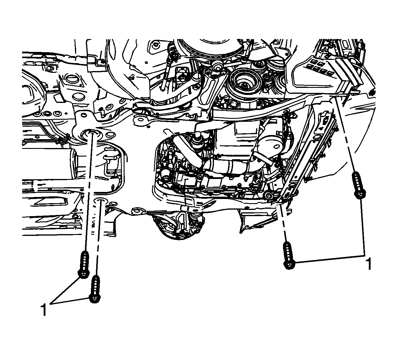

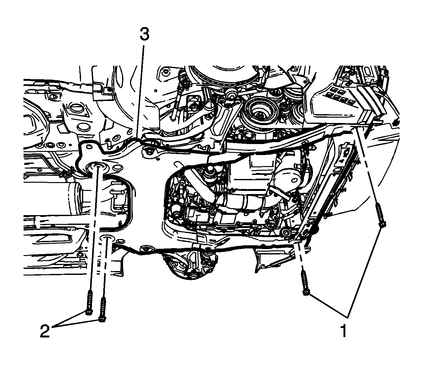

40. Remove the frame front bolts (1).
41. Position the lift table under the powertrain and support with blocks of wood.

42. Remove the upper frame suspension retaining bolts (1) on both sides.
pic 21

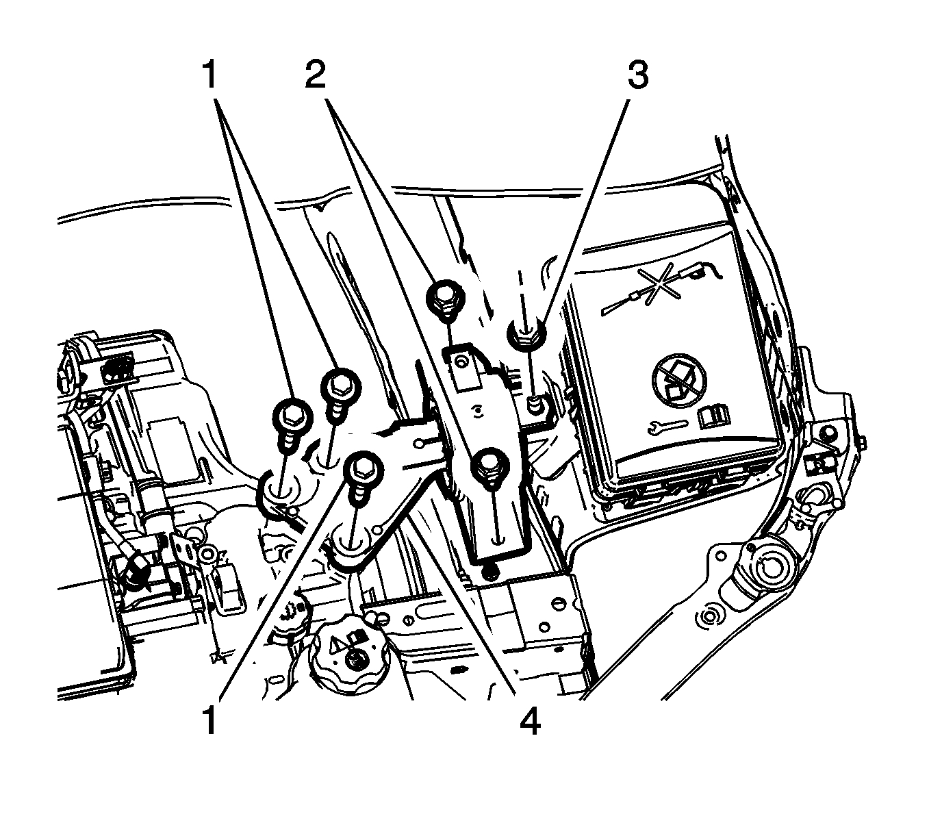

43. Remove the right side engine mount (1). Refer to Engine Mount Replacement - Right Side See: Engine Mount > Removal and Replacement > Engine Mount Replacement - Right Side.
pic 22
44. Remove and DISCARD the transmission mount bolts (1) - left side. Refer to Transmission Mount Replacement - Left Side See: Automatic Transmission/Transaxle > Removal and Replacement > Transmission Mount Replacement - Left Side.

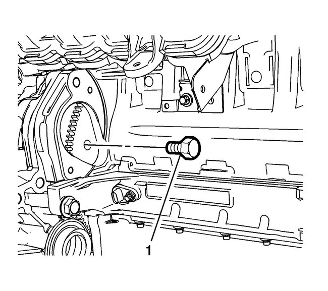

47. If equipped with an automatic transmission, remove the starter. Refer to Starter Replacement (LUV) See: Starter Motor > Removal and Replacement > Starter ReplacementStarter Replacement (2H0) See: Starter Motor > Removal and Replacement > Starter Replacement.
48. Mark the relationship of the flex plate to the torque converter for reassembly.
49. Remove and DISCARD the flex plate to torque converter bolts (1).
pic 24

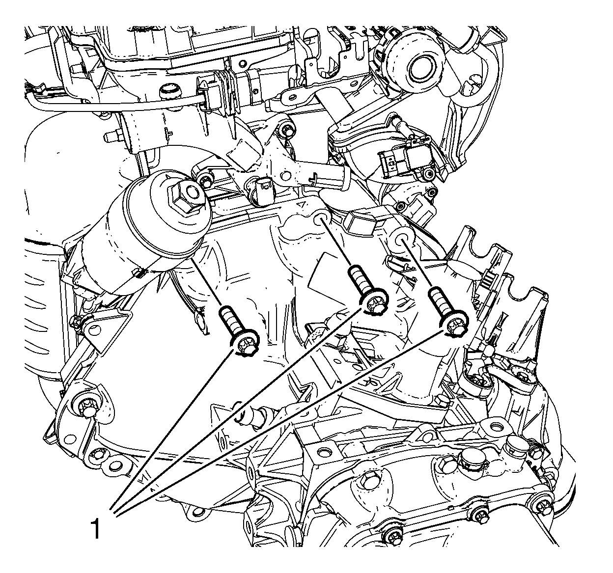

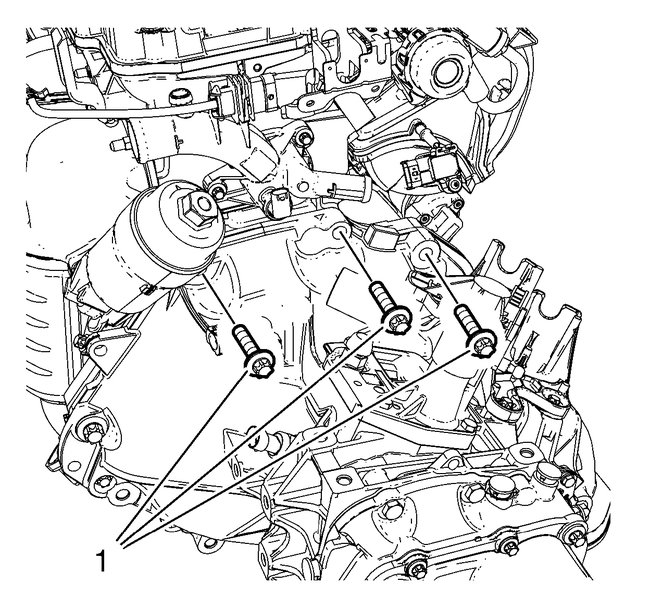

50. If equipped with an automatic transmission, remove the upper transmission to engine bolts (1) and separate the engine and transmission.
pic 25
51. If equipped with manual transmission, remove the upper transmission to engine bolts (1). And separate the engine and transmission.

10. Install the frame (3) rear bolts (2) and front bolts (1) and tighten a little bit.
11. Install the frame (3) rear bolts (2) and tighten to 135 Nm (100 lb ft).
12. Install the frame (3) front bolts (1) and tighten to 58 Nm (43 lb ft).
pic 32
13. Install the upper frame suspension retaining bolts (1) on both sides and tighten to 135 Nm (100 lb ft).
14. Remove the lift table.

15. If equipped with manual transmission, install the lower transmission bolts (1) and tighten to 60 Nm (44 lb ft).
16. Install the lower transmission bolts (2) and tighten 40 Nm (30 lb ft).
17. Install the lower transmission bolt (3) and nut (4) and tighten to 40 Nm (30 lb ft).
pic 34
18. If equipped with an automatic transmission, install the lower transmission bolts (2, 4) and tighten to 60 Nm (44 lb ft).
19. Install the lower transmission bolts (3) and the lower transmission nut (1) and tighten to 40 Nm (30 lb ft).

21. Install the wheel drive shafts. Refer to Front Wheel Drive Shaft Replacement - Left Side See: Axle Shaft Assembly > Removal and Replacement > Front Wheel Drive Shaft Replacement - Left Side and Front Wheel Drive Shaft Replacement - Right Side See: Axle Shaft Assembly > Removal and Replacement > Front Wheel Drive Shaft Replacement - Right Side.

Let me know if this helps.
Feb 7, 2020 at 1:35 PM
GILLYMAN3000
  • 19 POSTS
Wow! Thank you so much!!!
Feb 7, 2020 at 1:42 PM
  • 110,194 POSTS
You are very welcome. I hope it helps. If you run into trouble, let me know.
Feb 7, 2020 at 3:00 PM
GILLYMAN3000
  • 19 POSTS
Again thank you, it has been going well with the engine removal. i have run into trouble trying to remove the rear drive shaft, it doesn't seem to want to separate from the transmission.. any suggestions?
Feb 8, 2020 at 2:28 PM
GILLYMAN3000
  • 19 POSTS
got it! just had to be a little more aggressive.
