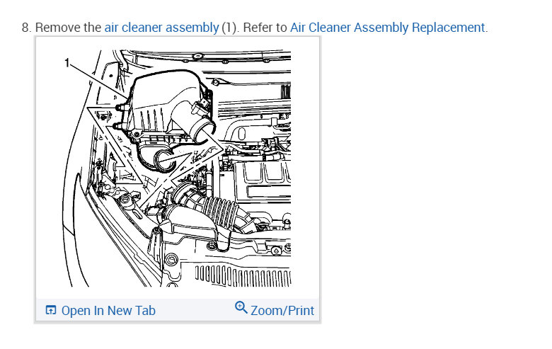

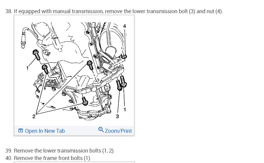

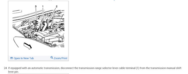

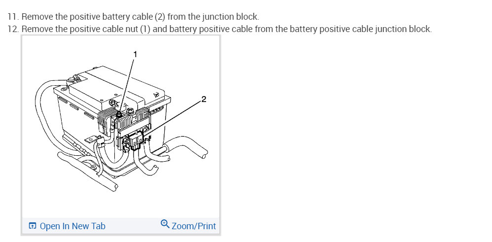

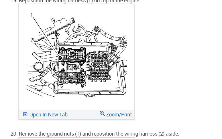

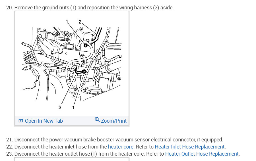

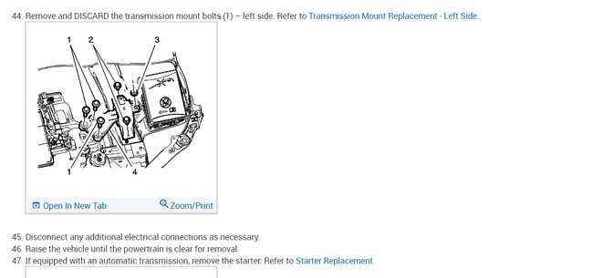

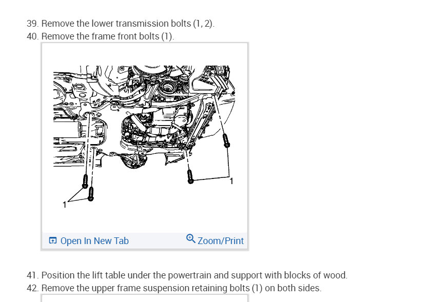

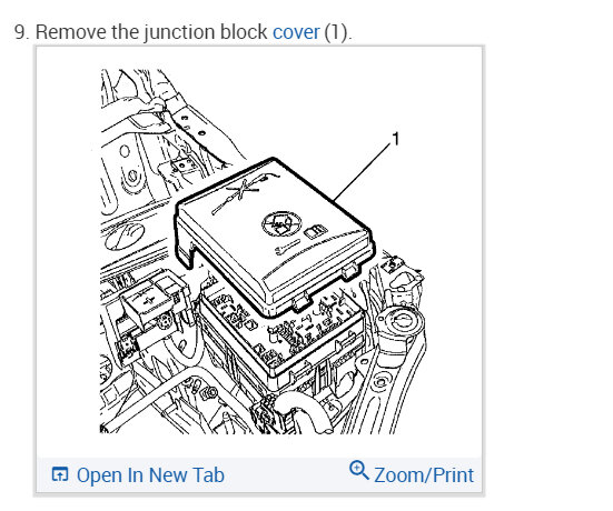

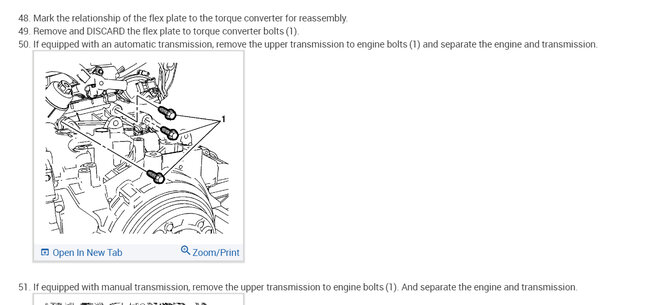

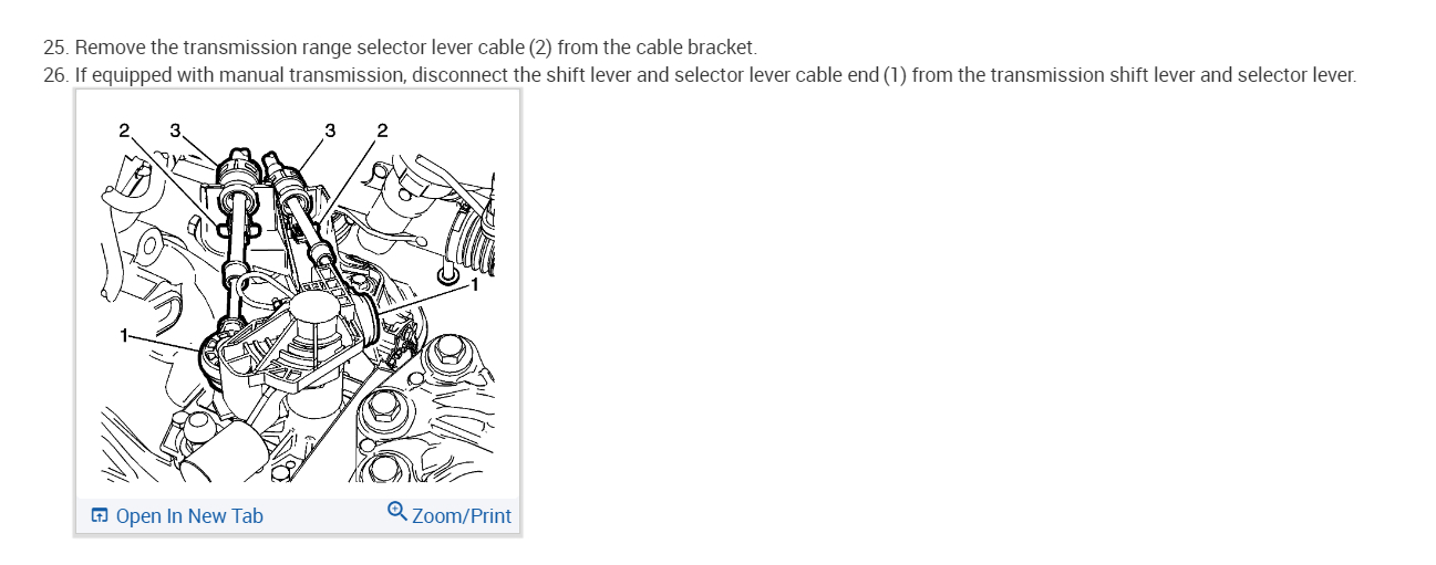

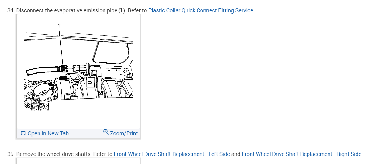

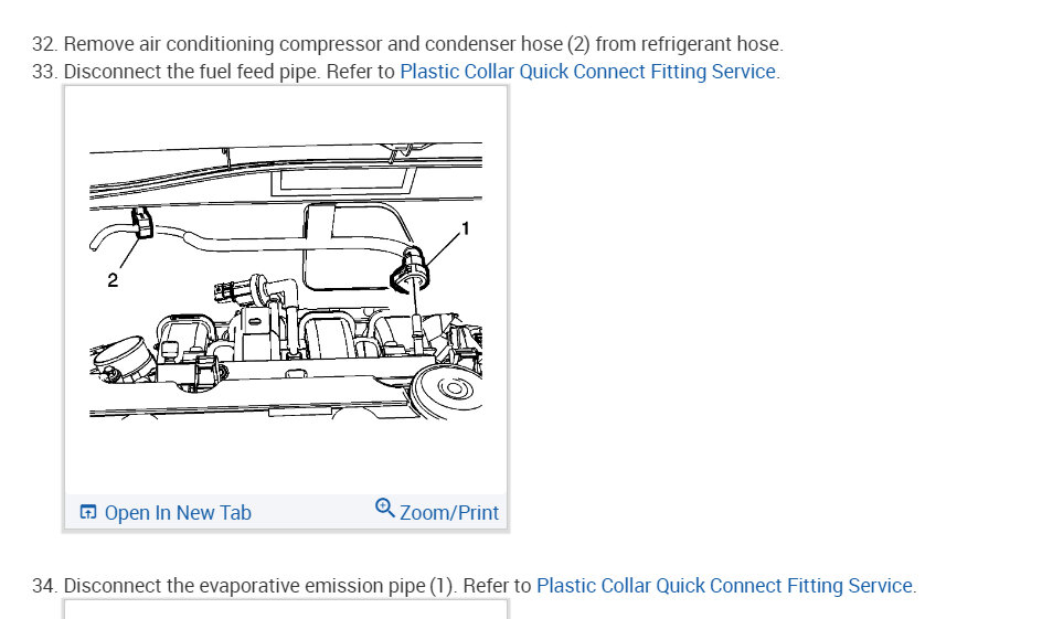

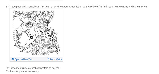

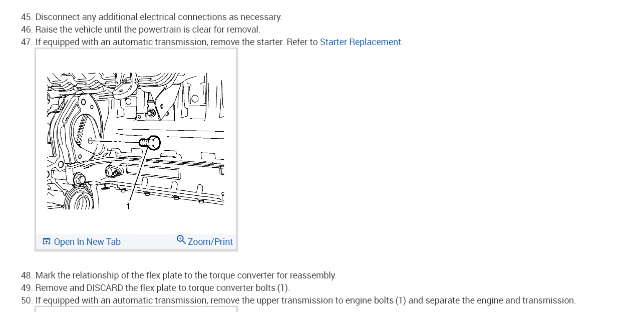

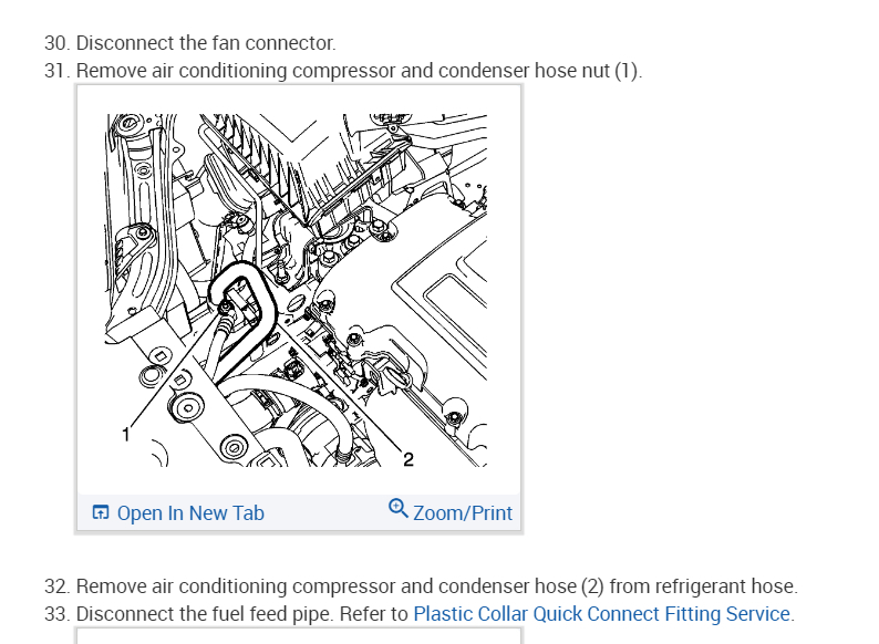

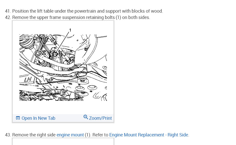

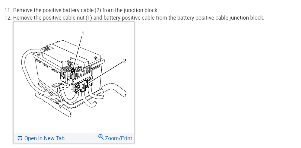

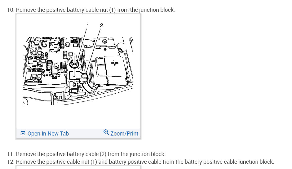

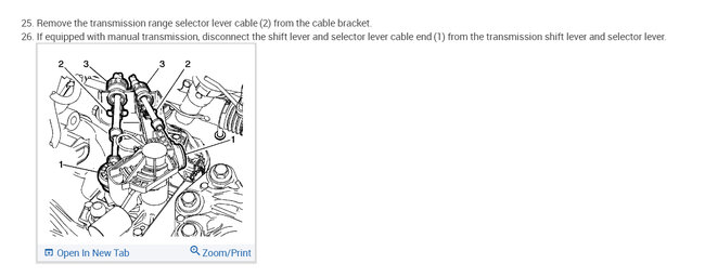

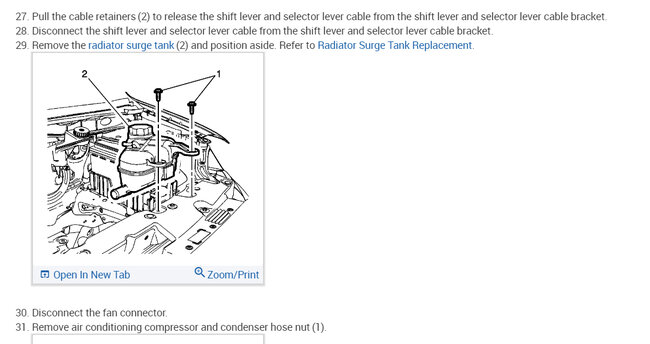

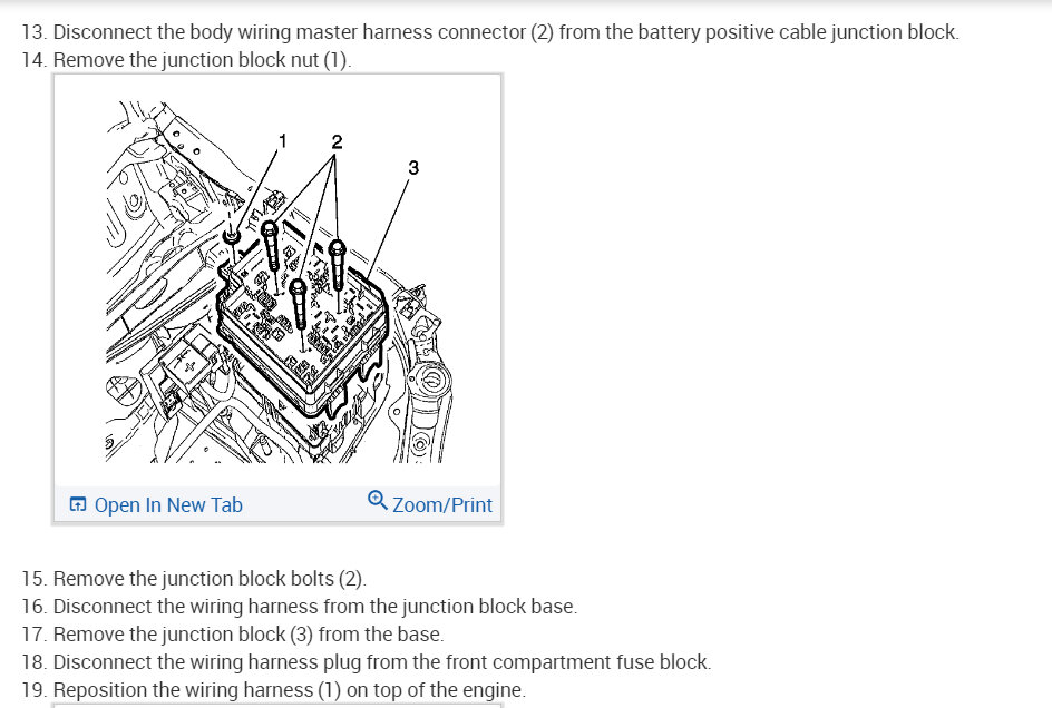

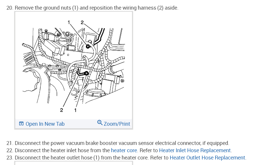

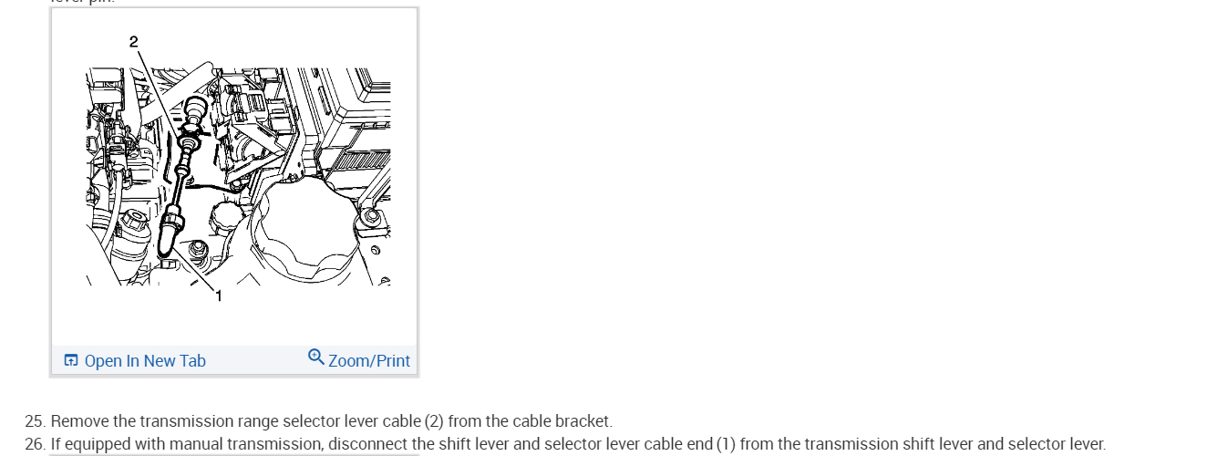

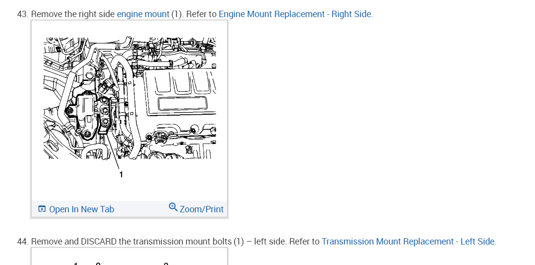

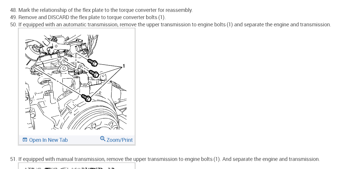

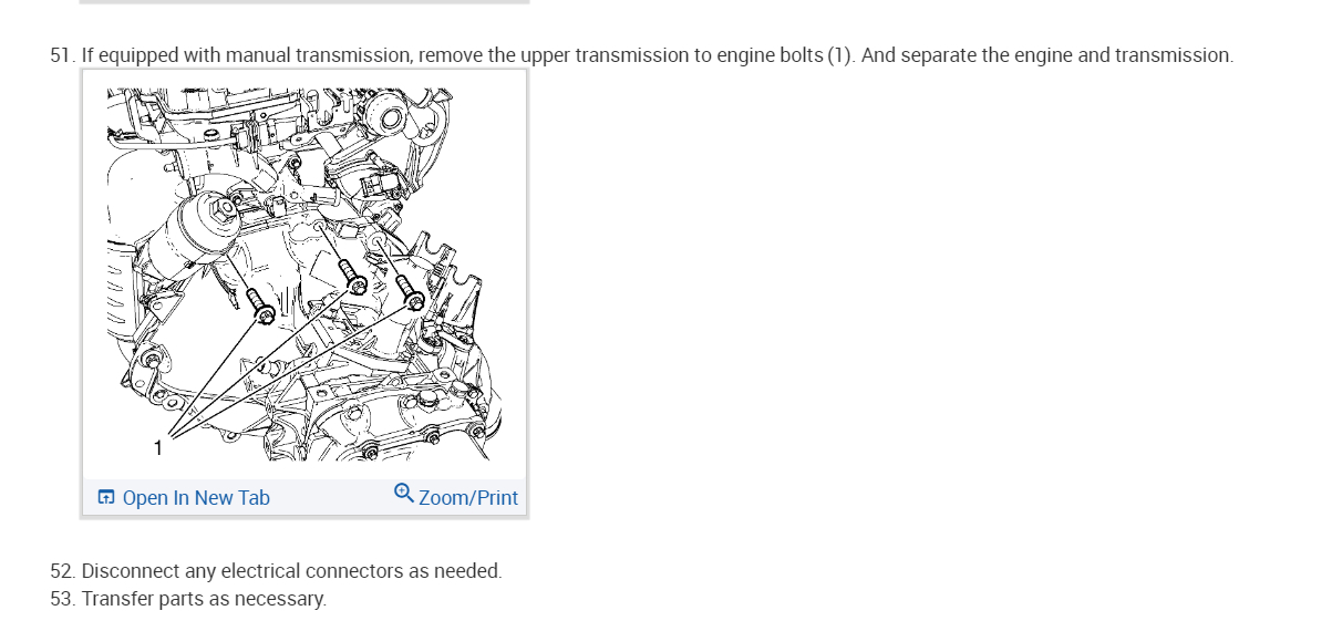

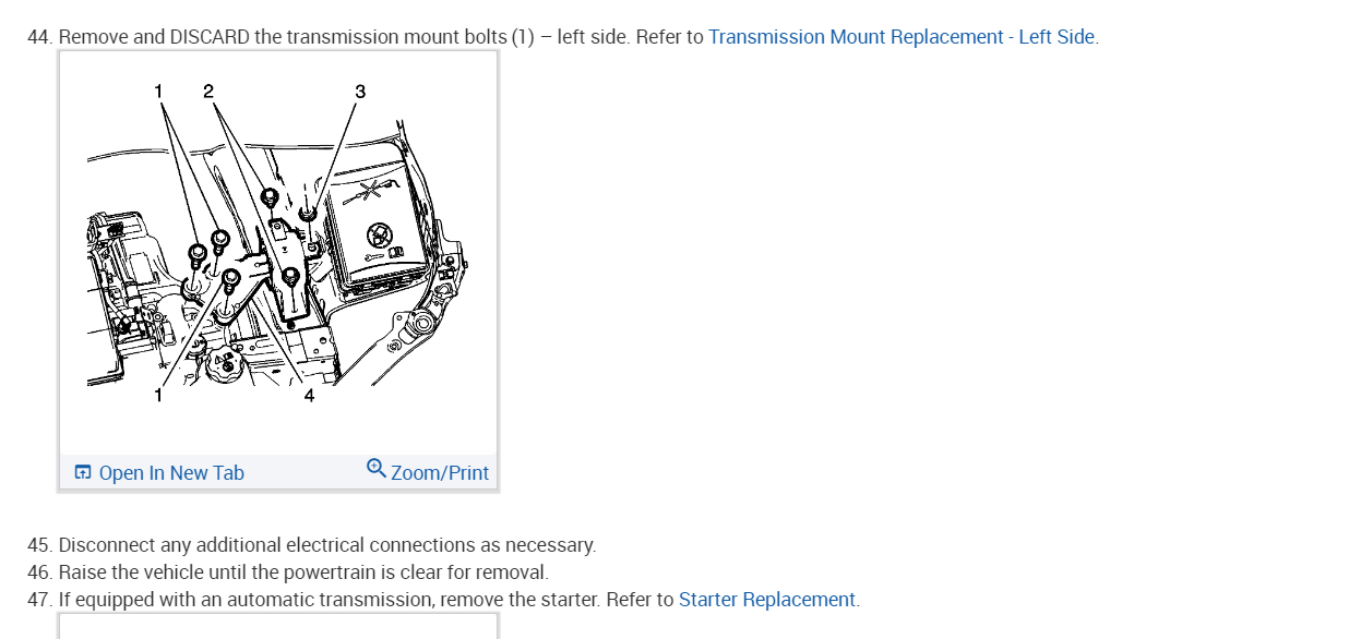

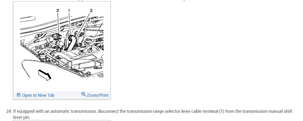

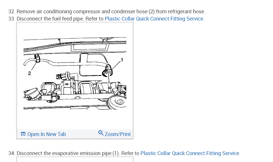

How high do I need to lift the car to get my engine out, can you give me instructions?
Jul 21, 2023 at 3:19 AM
  • 55,710 POSTS

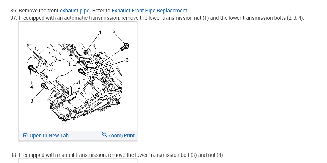

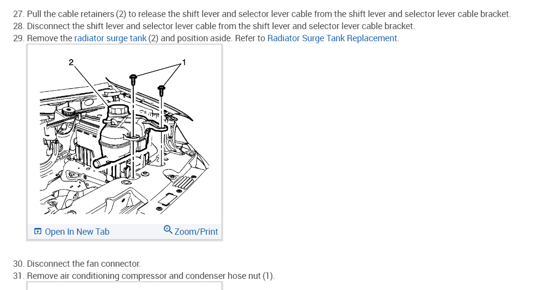

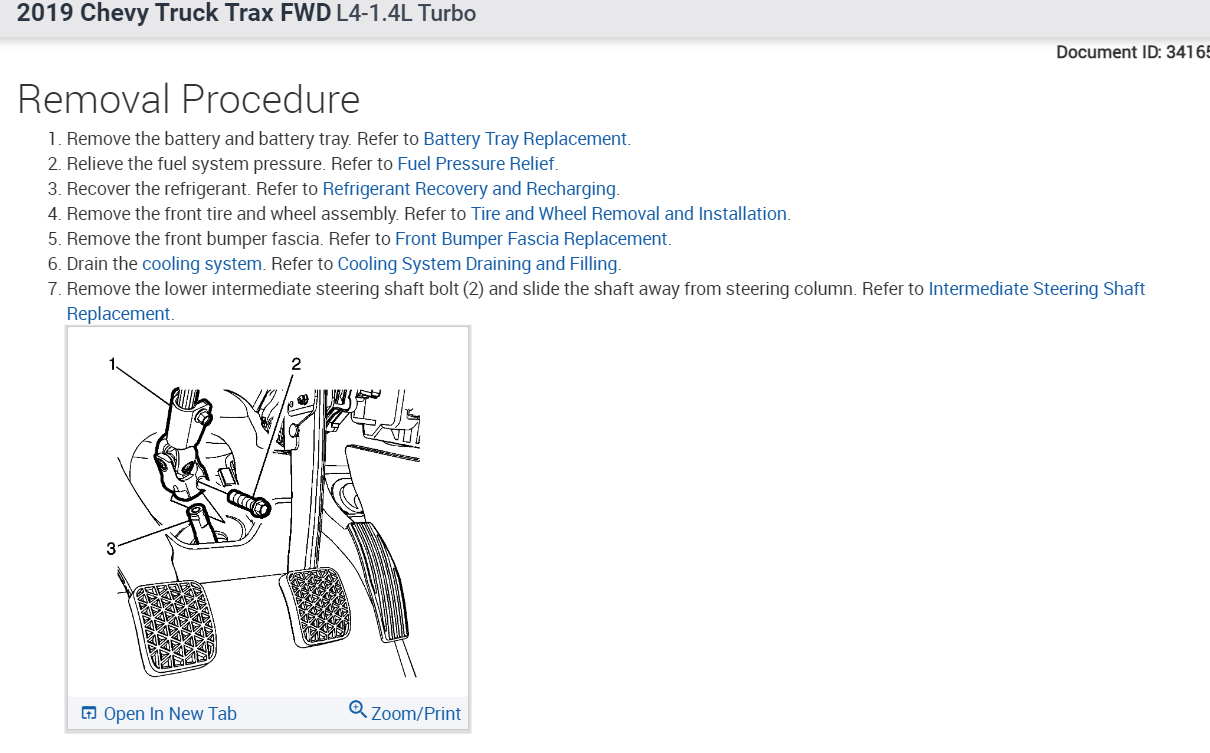

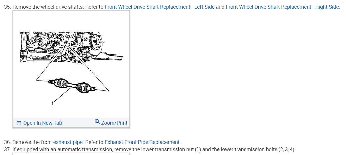

You will need an engine hoist which you can rent, here are the engine removal instructions so you can get the job done. Start by draining the coolant and engine oil, disconnect the battery. Check out the images (below). Please let us know if you need anything else to get the problem fixed.
