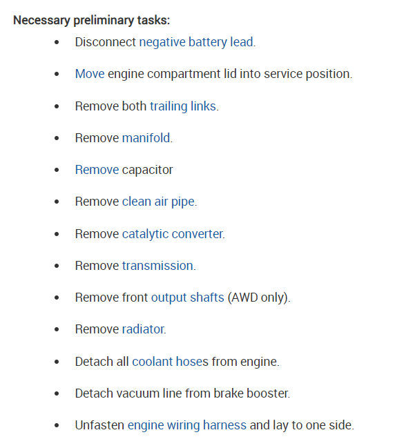

Can I get instructions on how to remove the engine?
2014 BMW X5
157,000 MILES • 6 CYL • TURBO • 2WD • AUTOMATIC
BHAMDOC1973
  • 2,007 POSTS

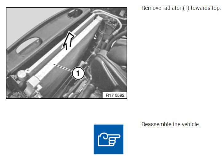

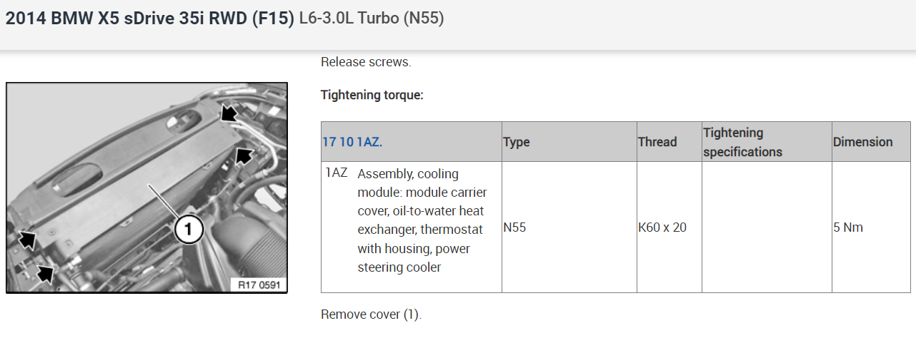

Would you be able to find instructions on removing this engine? I already gotten a bunch of stuff out but needing information on how to remove the fan and radiator than anything else, and if the radiator is needed to be removed
inline 6 cyl turbo engine, RWD.
Oct 4, 2024 at 4:31 AM
  • 55,433 POSTS

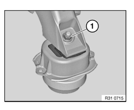

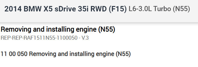

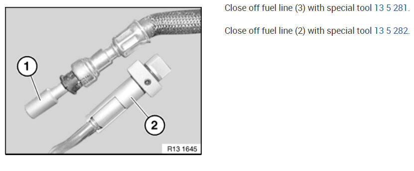

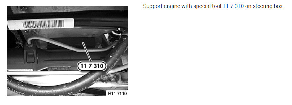

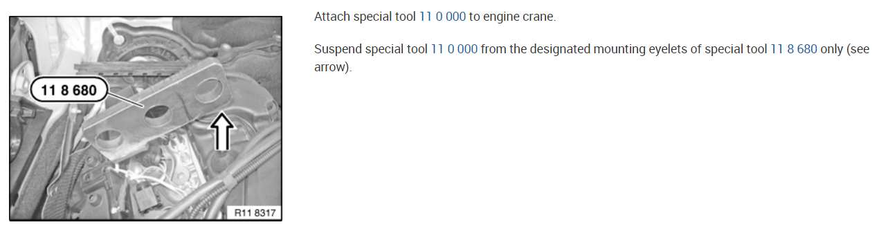

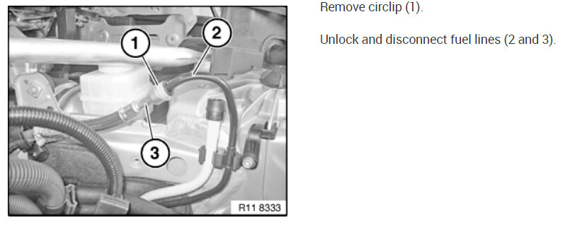

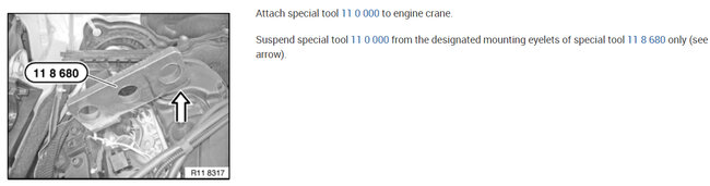

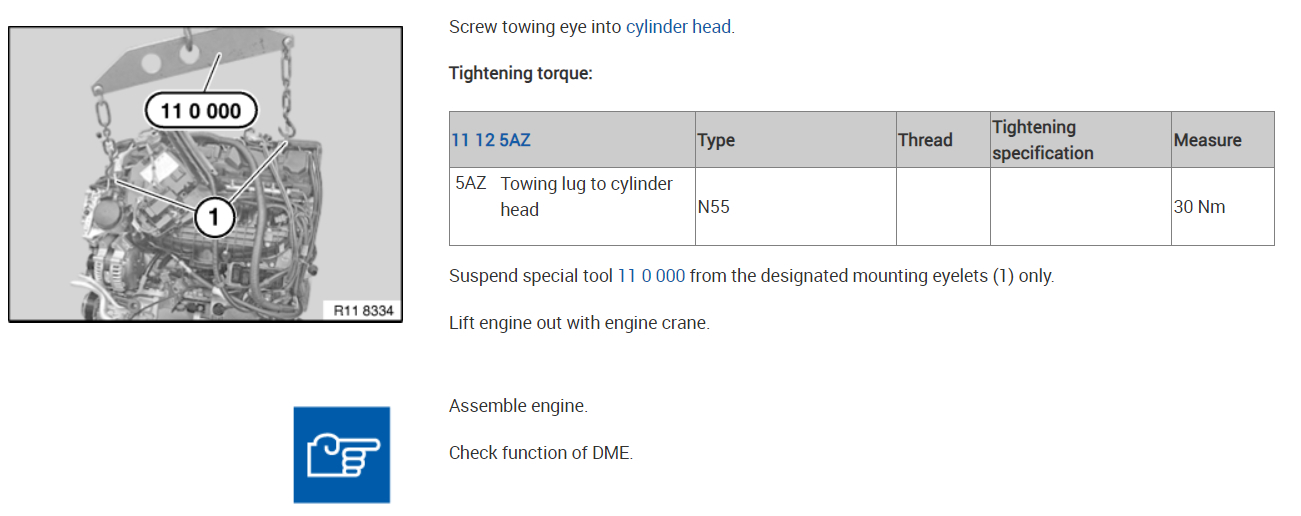

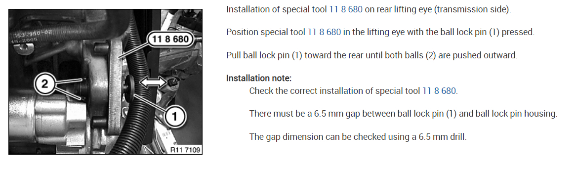

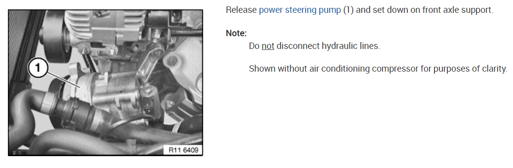

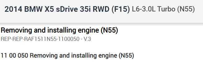

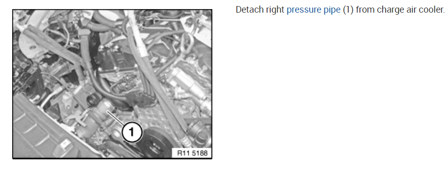

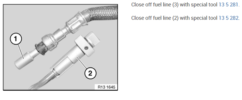

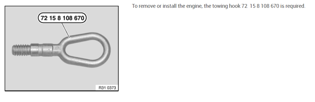

Yep, you will need to remove the hood, radiator and the transmission, here are the instructions to remove the engine and everything else that needs to be done to get the engine out of the car. Disconnect the battery before Check out the images (below). Let us know if you need anything else.

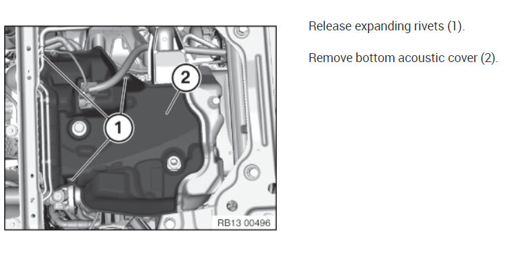

I removed torque converter bolts and all the above, can't find the starter, is it under the intake like most of these BMWs?

I am trying to remove the intake manifold but the computer underneath has many connectors. Can you see if there are instructions on how to remove it? Can't seem to find a way. I removed couple of the big connectors, but the smaller ones are hard to remove.

It looks like the starter motor is under a cover, check out the images (below). Please let us know what happens.

I found it under the intake. No, the one with the cover is for the n57 which is a diesel motor.
