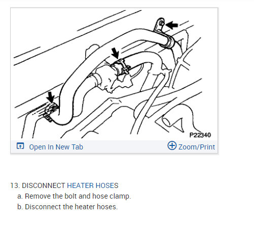

Anyway, you need a lot of tools. LOL You will need an engine hoist for sure because this one comes out from the top. Other than that, standard tools will do the job. However, before I jump in, I need to know if it is a 4wd or not. That will make a few differences.

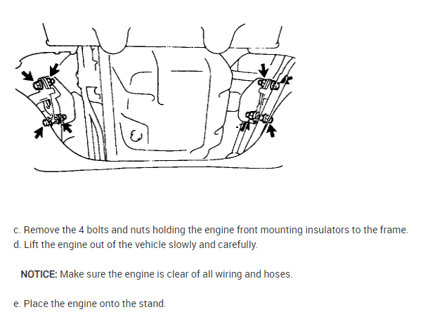

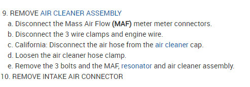

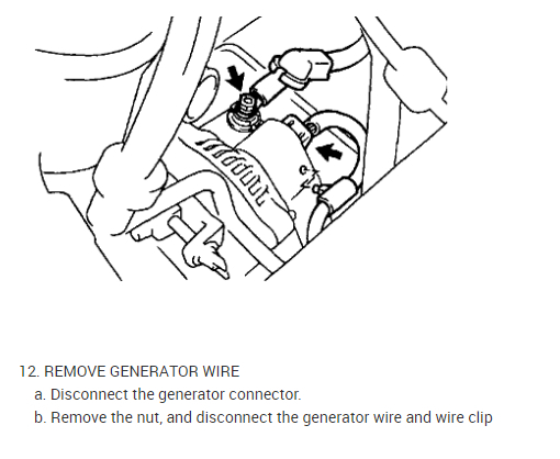

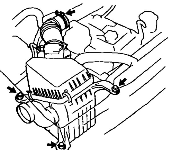

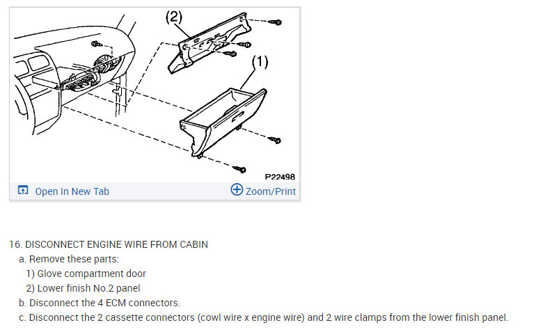

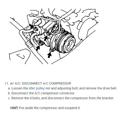

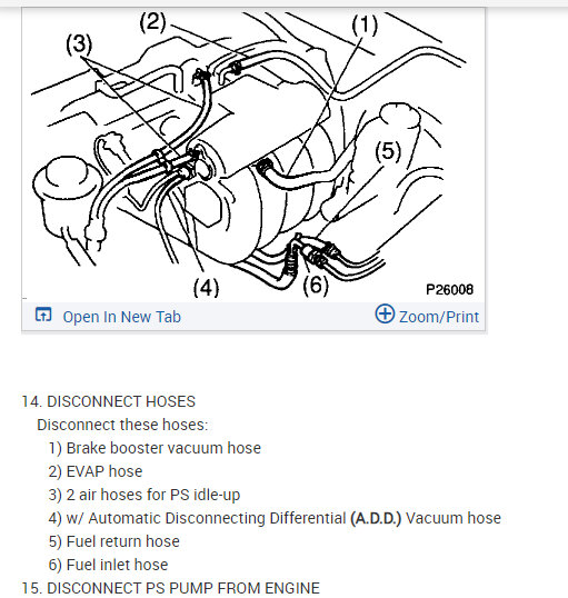

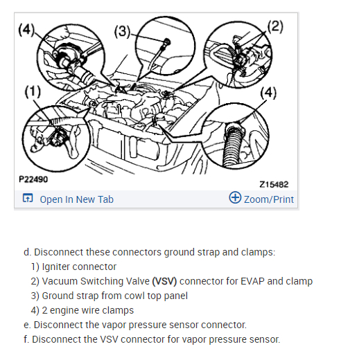

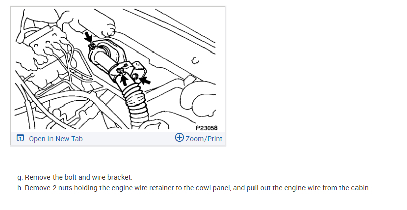

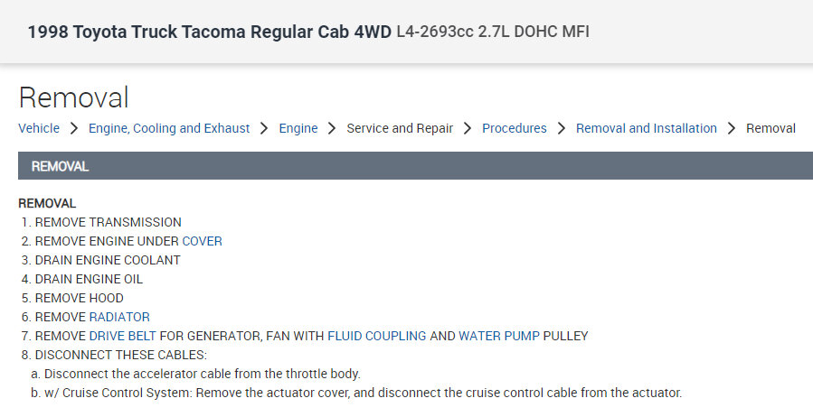

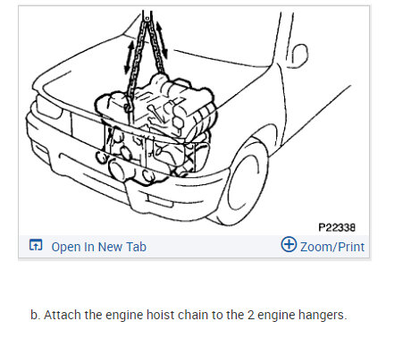

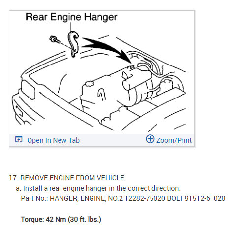

  • 110,248 POSTS
Okay, I have the directions below for removing the engine. It looks like a straightforward job. Just take your time. I don't want you getting crushed by the engine. LOL
Take a look through the directions and let me know if they help or i you have questions.
Take care and Welcome Back!!!
Aug 12, 2024 at 12:38 PM

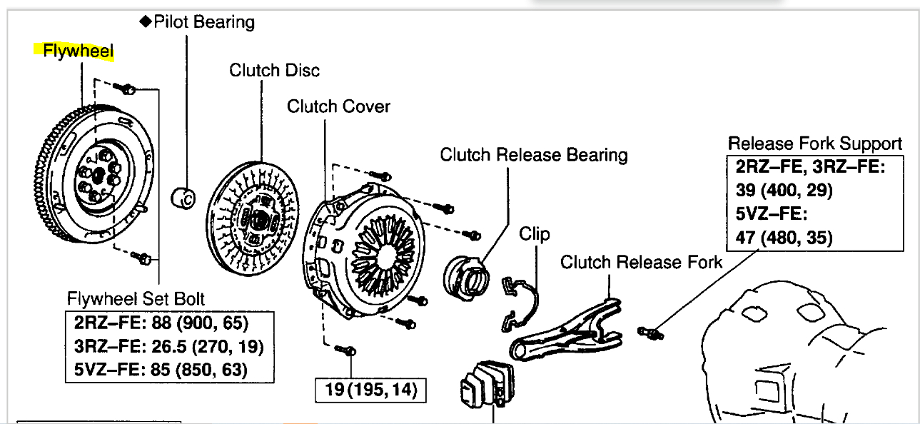

Everything is done except I am turning and turning the flexplate but don’t see any torque converter bolts. Am I missing something?
Aug 16, 2024 at 6:01 AM
  • 110,248 POSTS
If this is a manual transmission, it won't have a torque converter. The transmission will come out. Once it is out, then you unbolt the clutch cover/pressure plate from the flywheel.
I attached an exploded view below. Let me know if this helps.

Lol yeah I figured it out. Never really worked on a manual transmission before. Thanks for your help!
Aug 17, 2024 at 1:54 AM
  • 110,248 POSTS
You are very welcome. When you reinstall it, you will need a tool to align the splines of the clutch disc.
