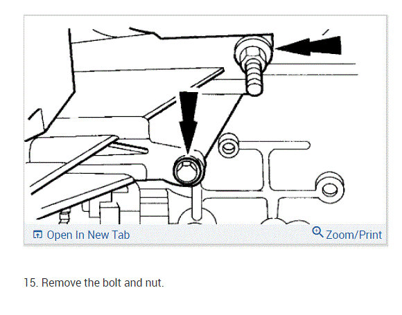

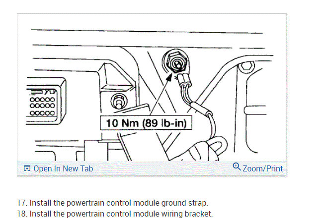

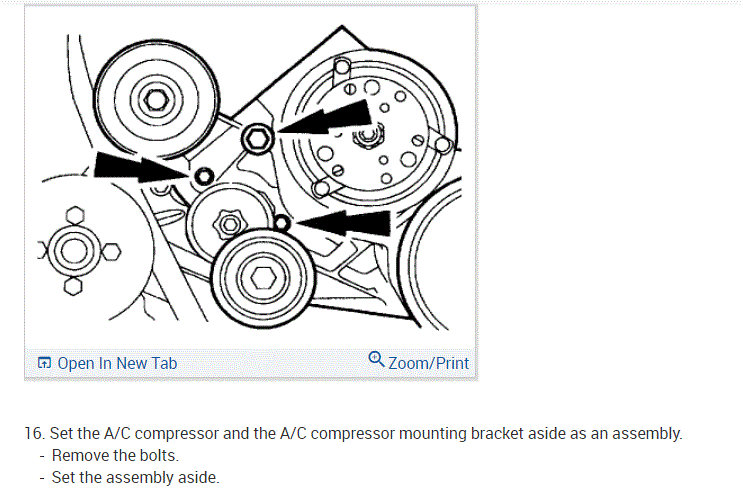

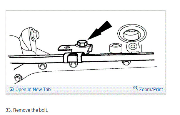

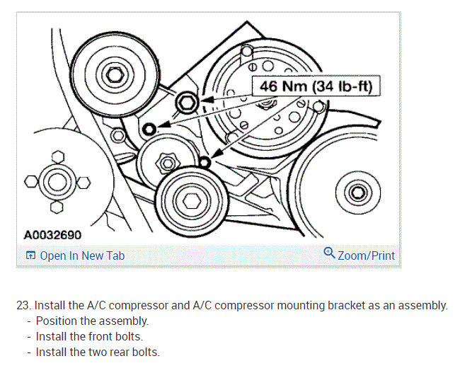

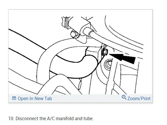

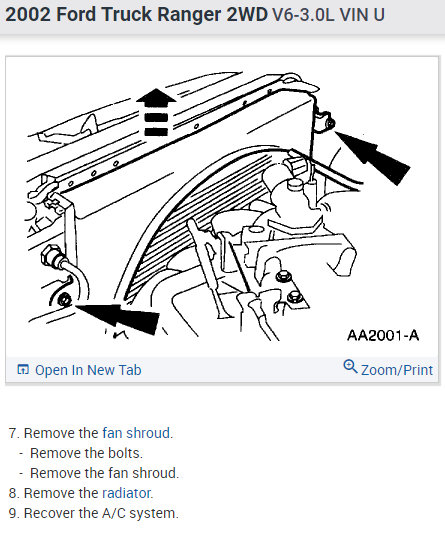

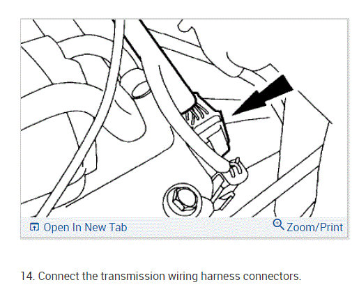

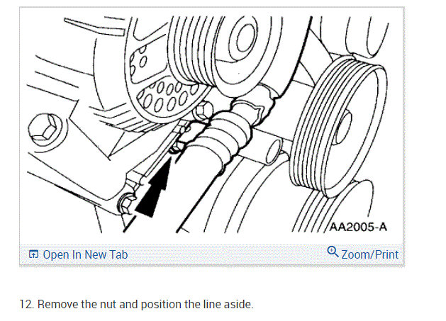

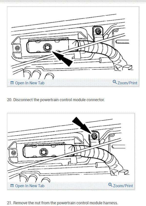

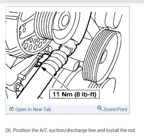

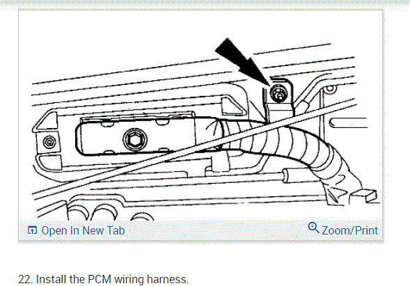

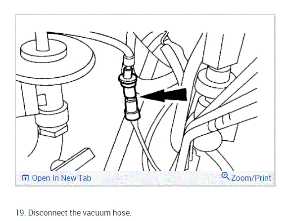

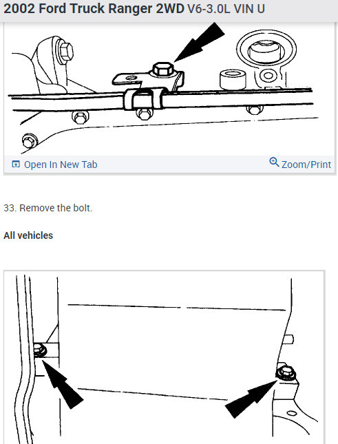

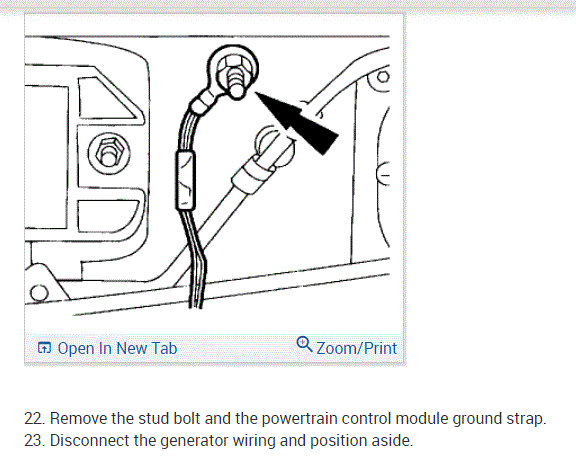

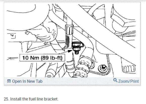

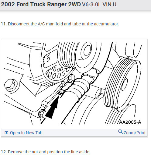

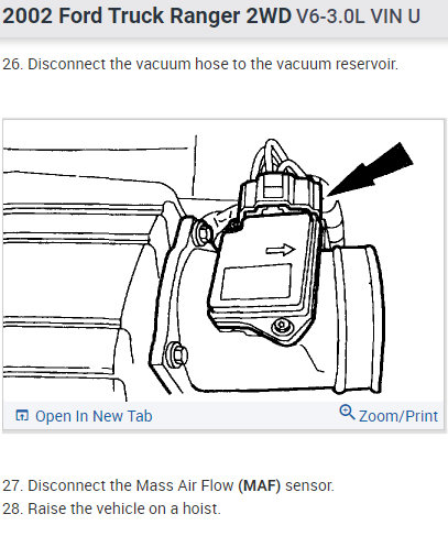

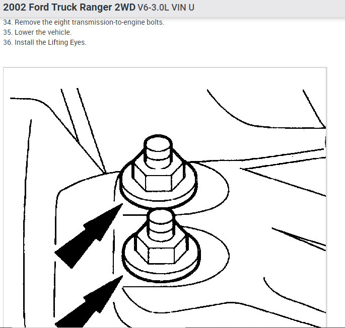

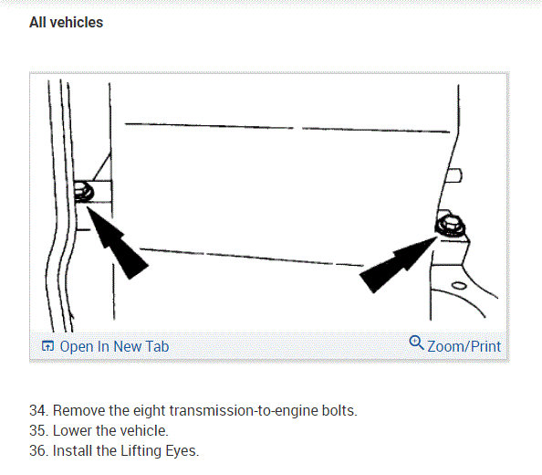

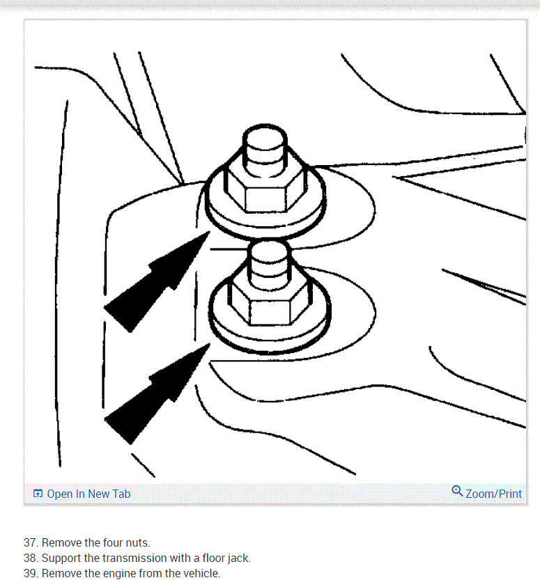

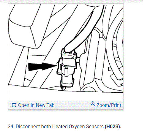

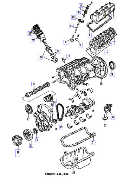

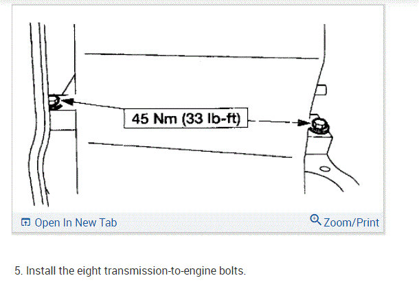

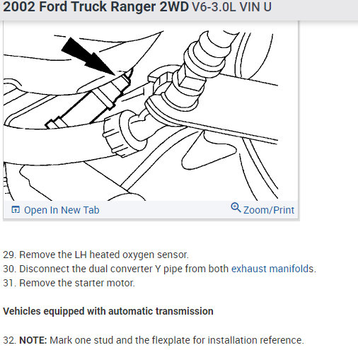

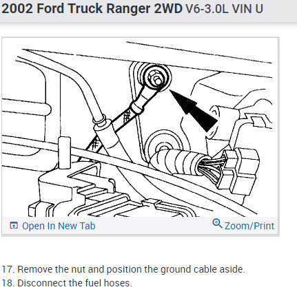

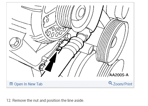

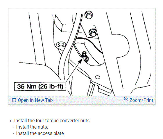

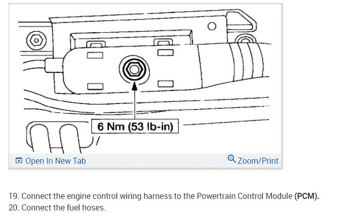

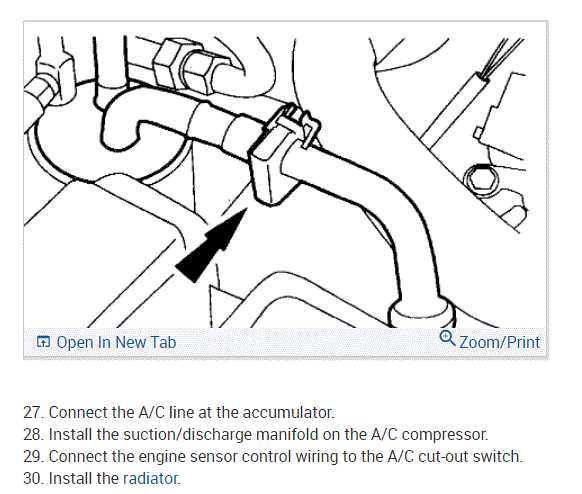

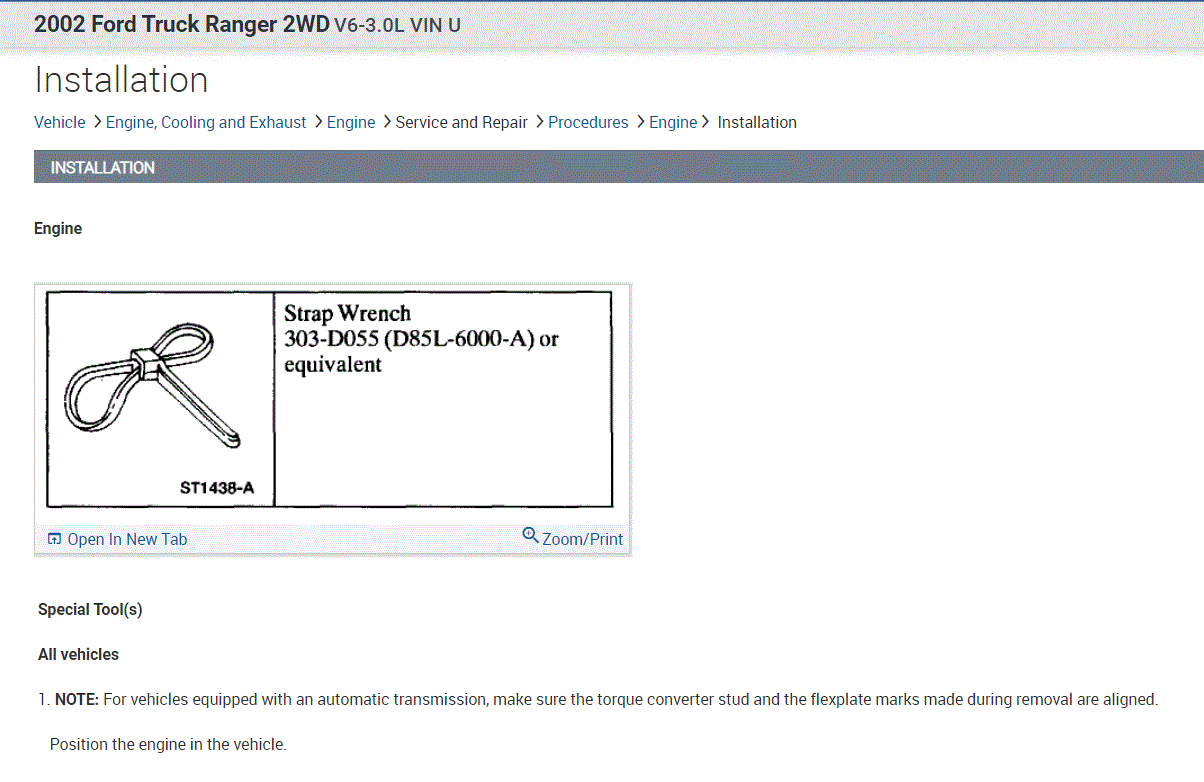

Do you have a step by step video of how to take the engine out to replace it?
Jul 17, 2021 at 9:25 PM
SQM
  • 6,383 POSTS
I have attached setup by step procedure of engine replacement for your ranger.
Here are few videos for your reference:
https://youtu.be/zy1CozLgWUQ
https://youtu.be/xAEA4y8bnIA
https://youtu.be/VyiF97vwvOA
Let me know if you have any questions.
Jul 17, 2021 at 10:23 PM
  • 110,194 POSTS

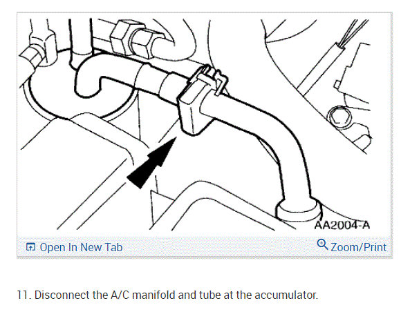

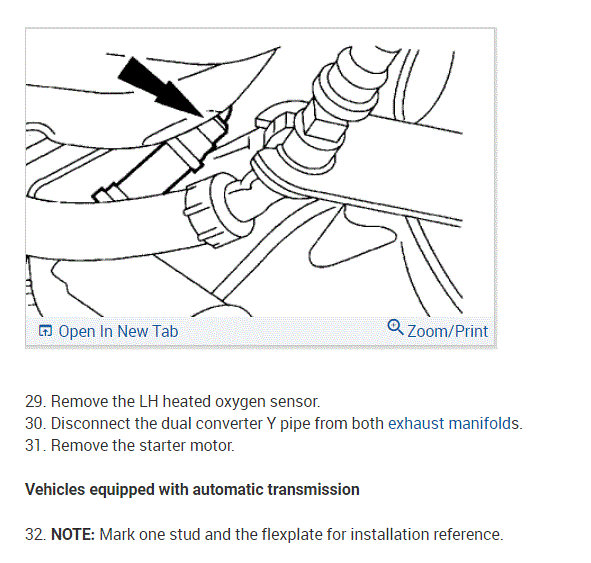

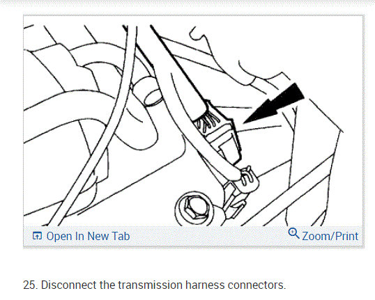

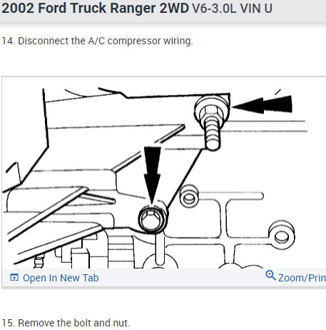

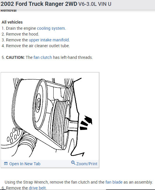

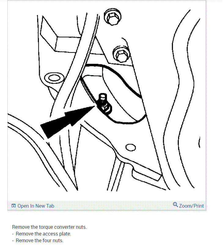

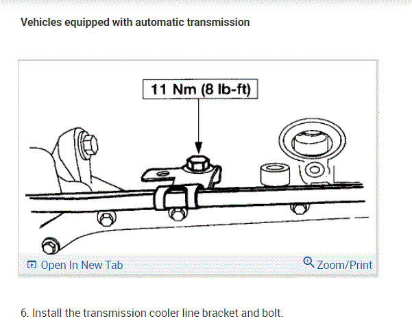

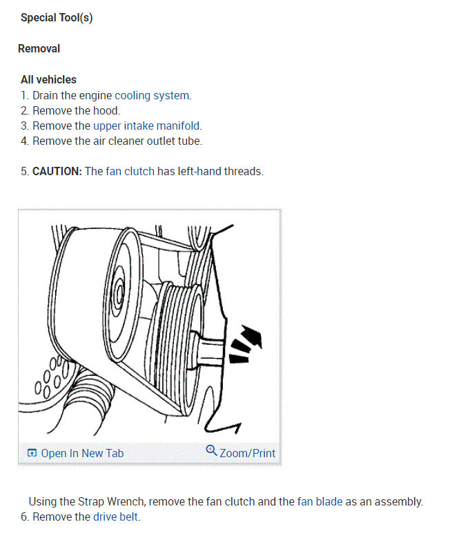

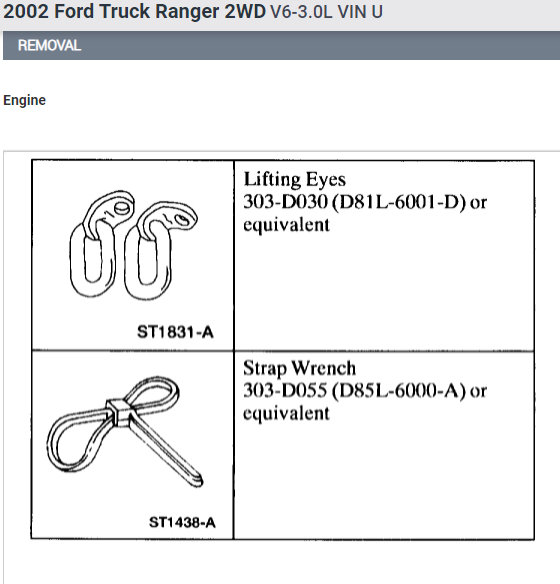

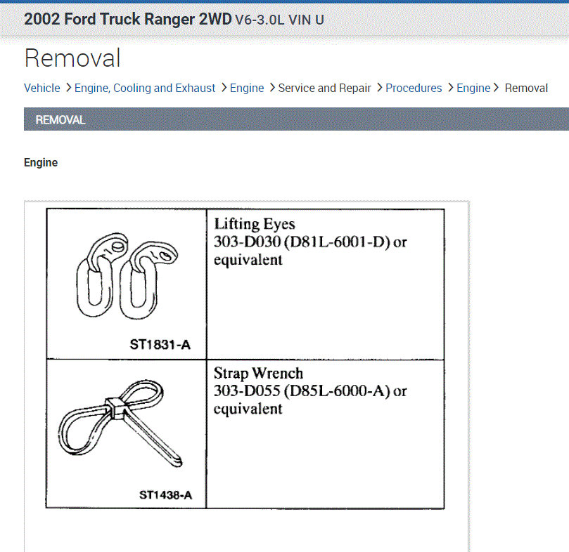

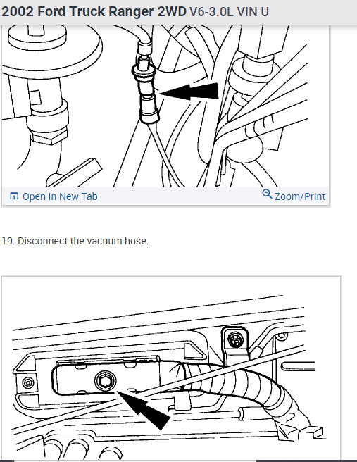

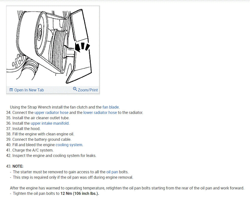

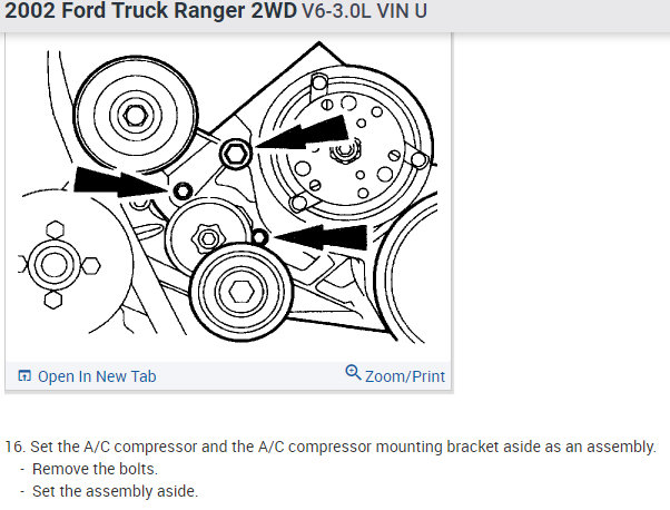

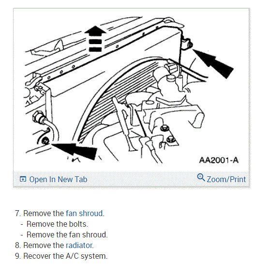

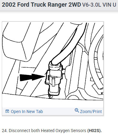

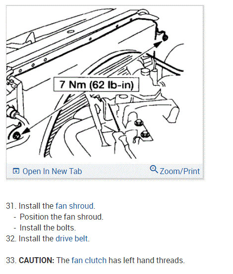

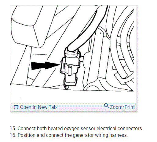

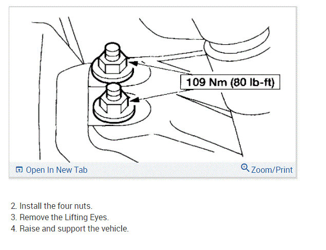

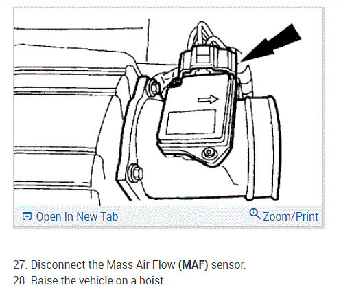

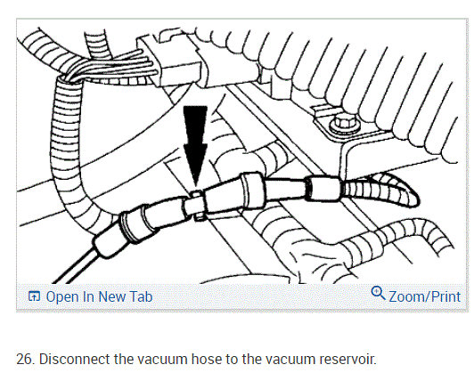

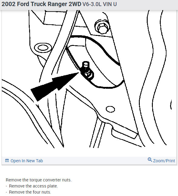

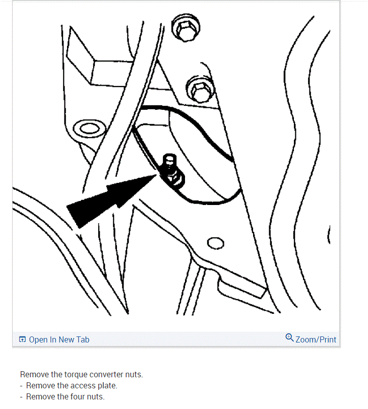

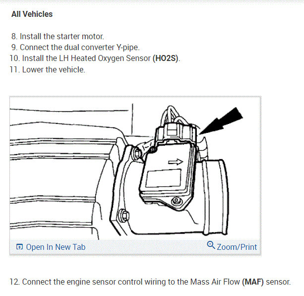

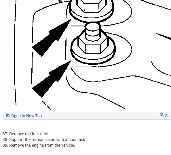

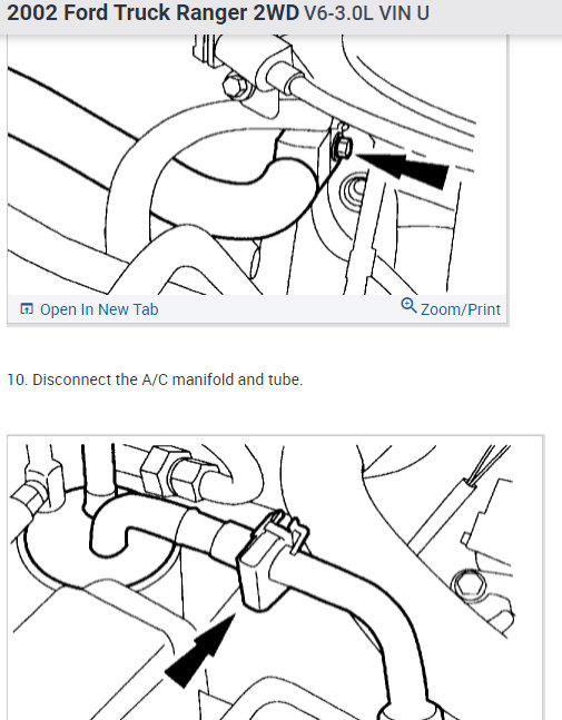

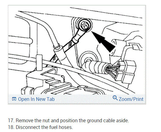

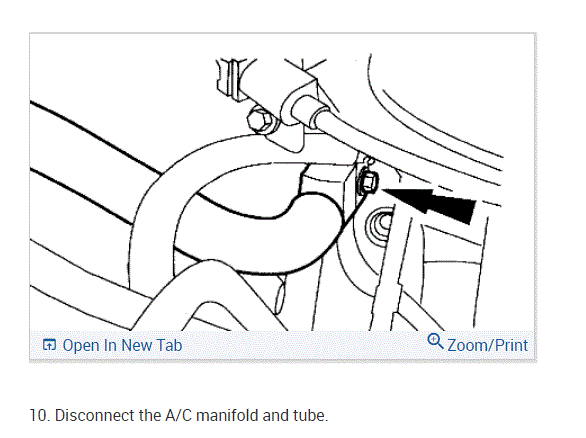

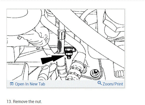

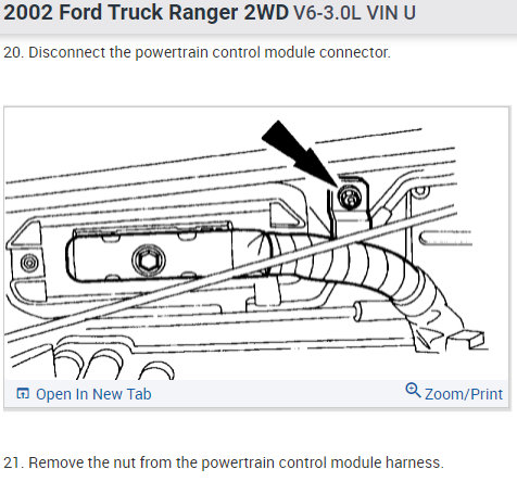

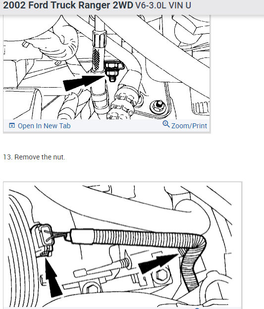

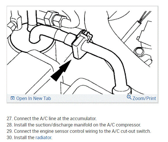

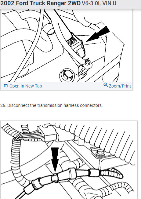

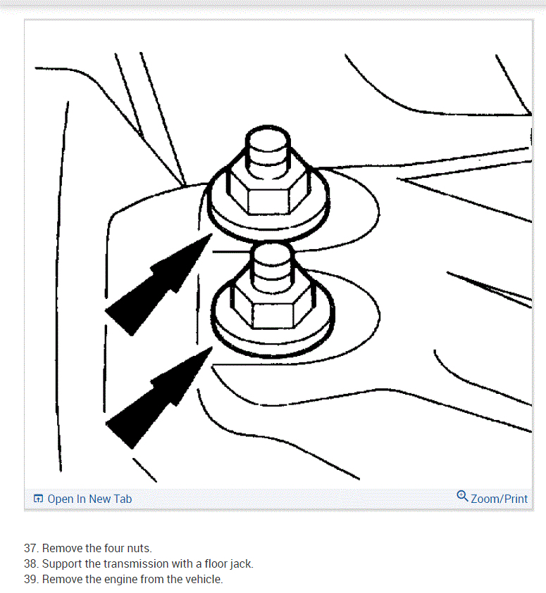

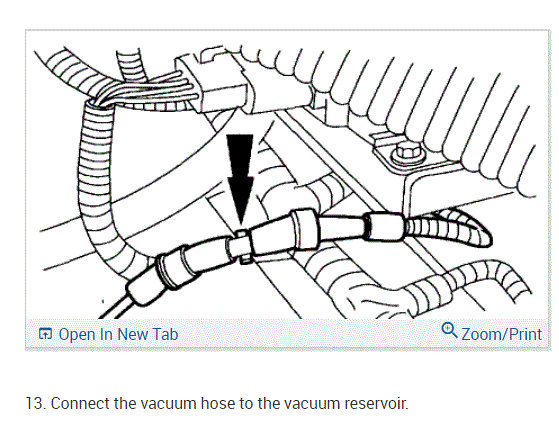

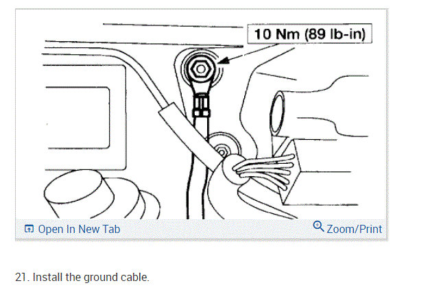

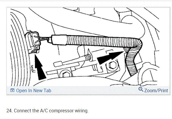

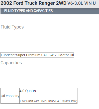

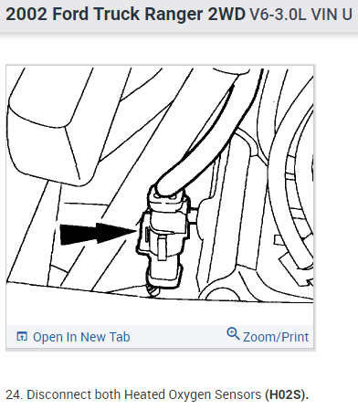

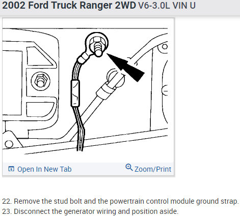

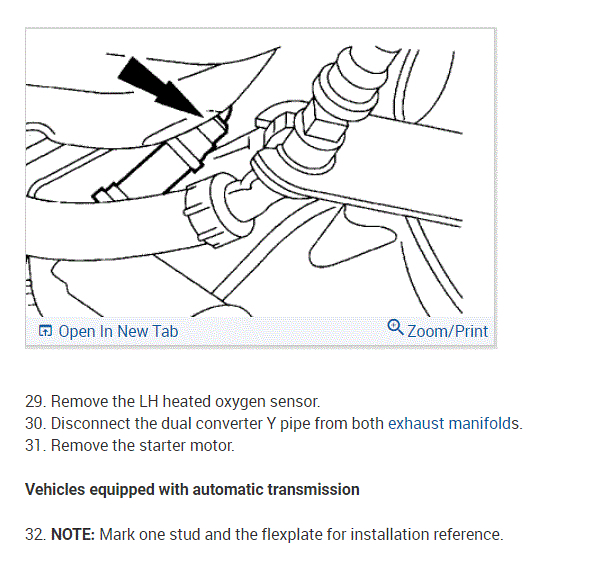

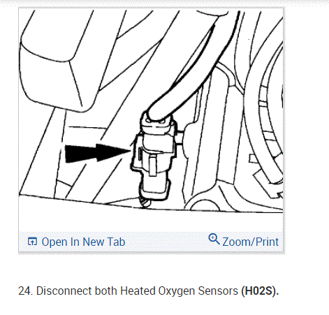

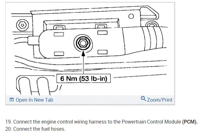

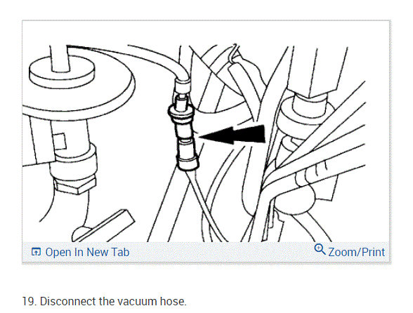

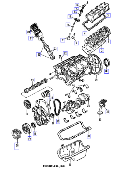

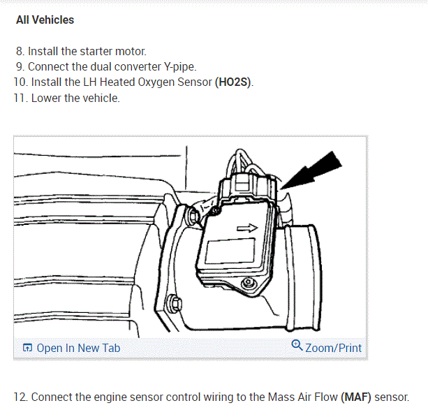

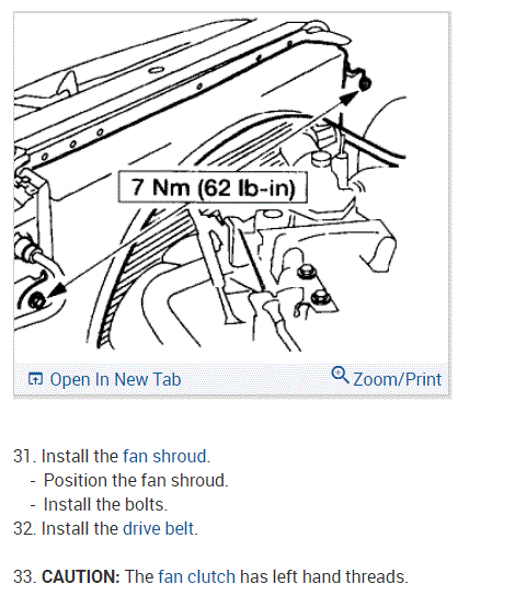

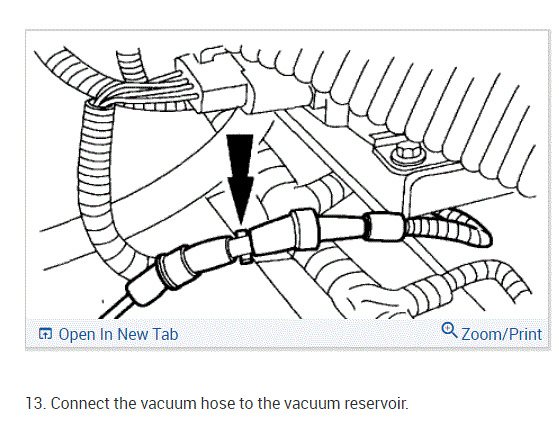

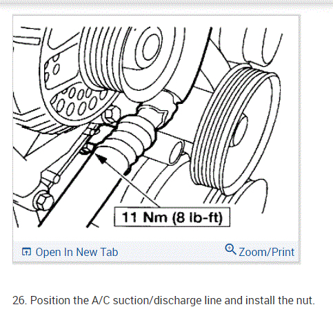

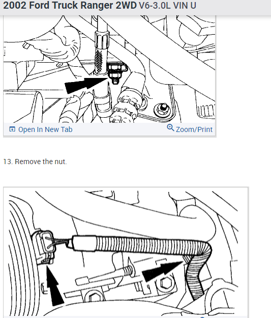

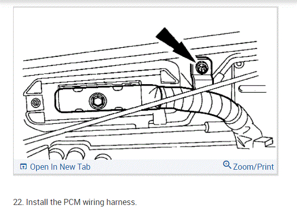

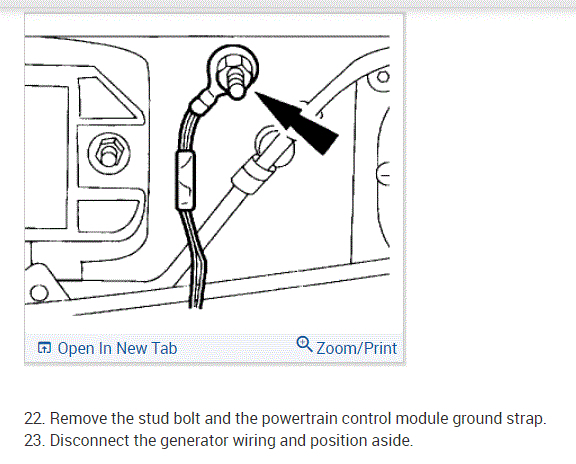

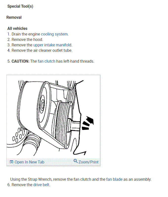

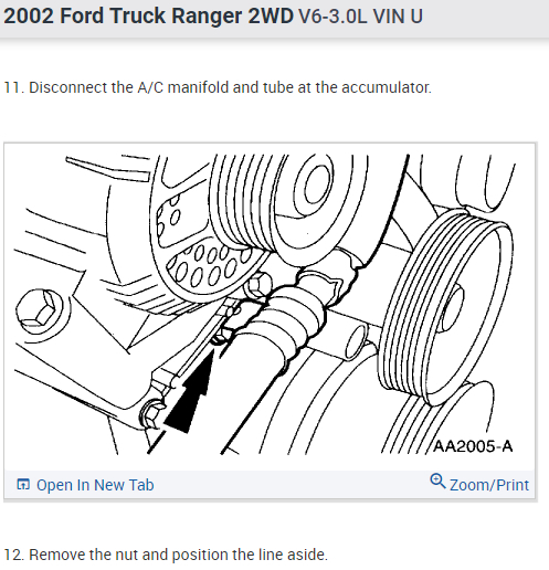

I don't have a video specific to this vehicle, but I do have step-by-step instructions. Also, here is a video showing how an engine is removed. It is on a different type of vehicle, but the procedure is very similar and below I have the directions for your vehicle.
If you look at the attachments below, it explains how to remove and replace the engine. If you run into trouble, let me know and I'll try my best to help or answer questions.
