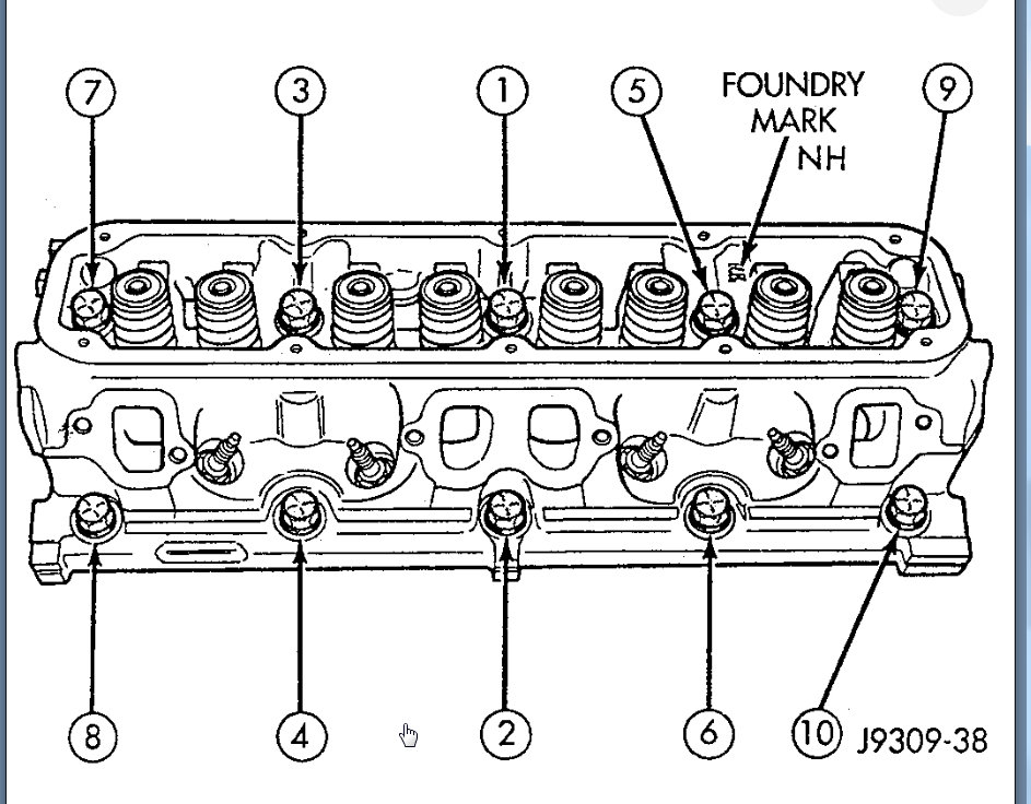

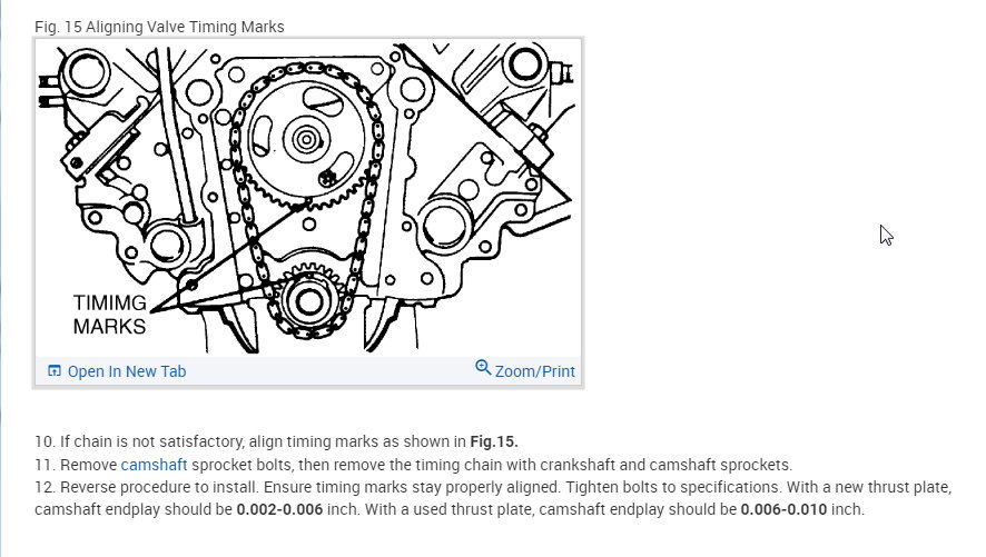

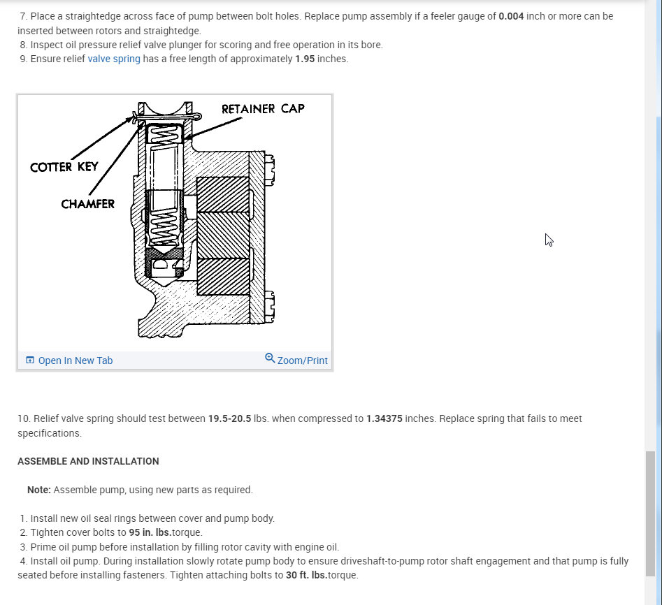

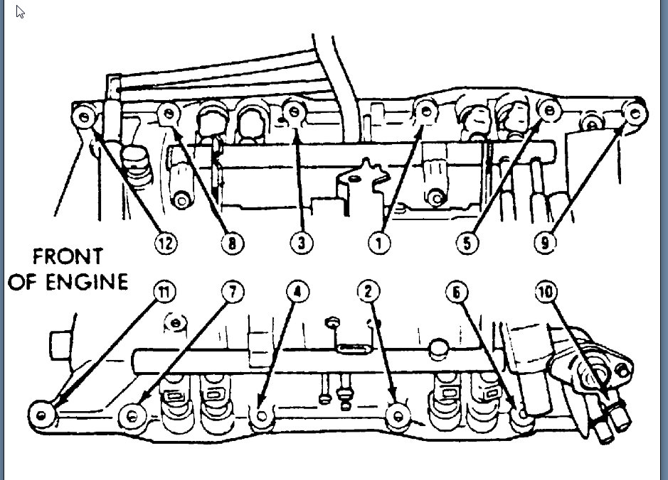

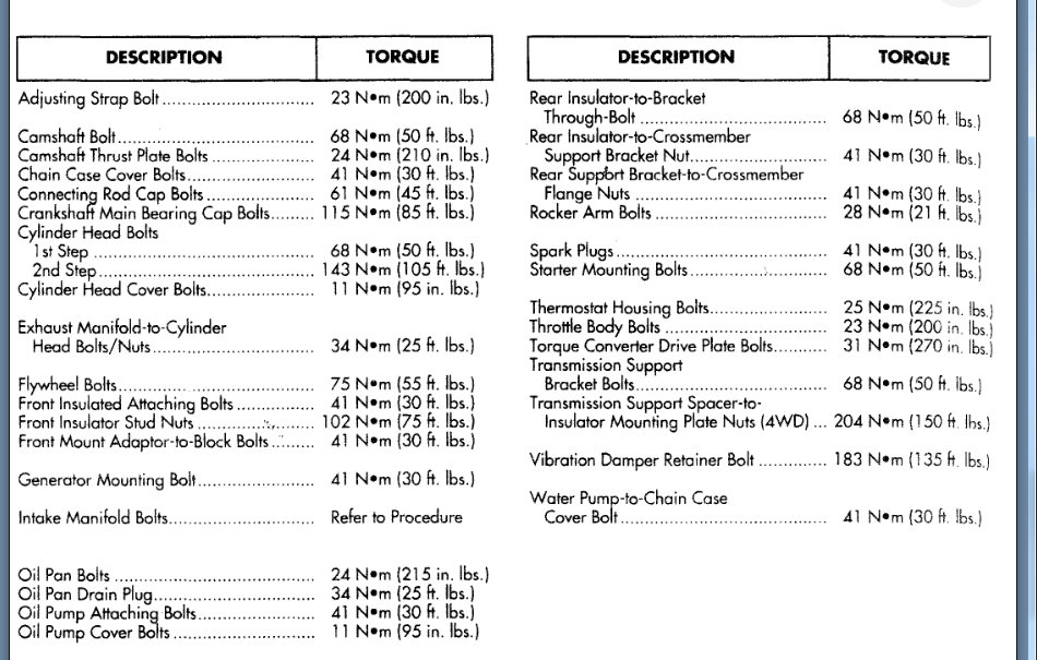

All I'm looking for now is good rebuild advice, I have new pistons, rings, engine bearings but if the engine internals are in good condition I'd like to go about doing the gaskets, oil pump, timing chain, water pumps, etc and a good painting. I have a few books describing the magnum rebuild and even performance stuff my biggest worry is making sure things go back together right such as torquing, making sure the engine is timed right, and which bolts to use thread locker on, what I should or shouldn't lubricate, etc.
Mainly I'd just like a professional opinion on how I should go about my build don't want to throw an engine in and have it explode or bend something due to my mistake.

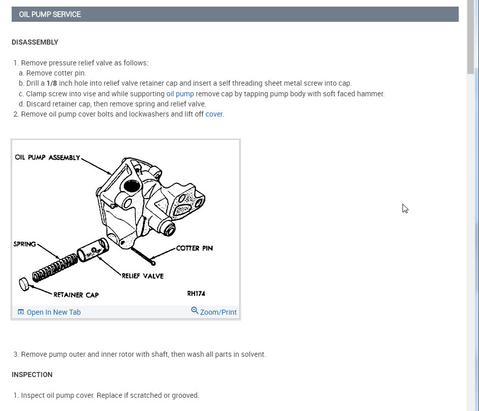

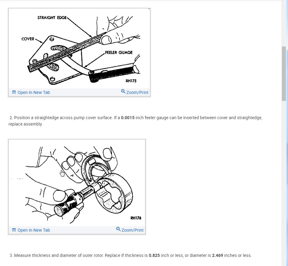

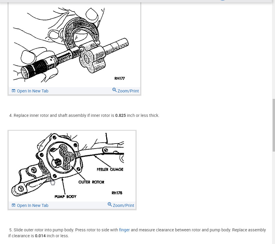

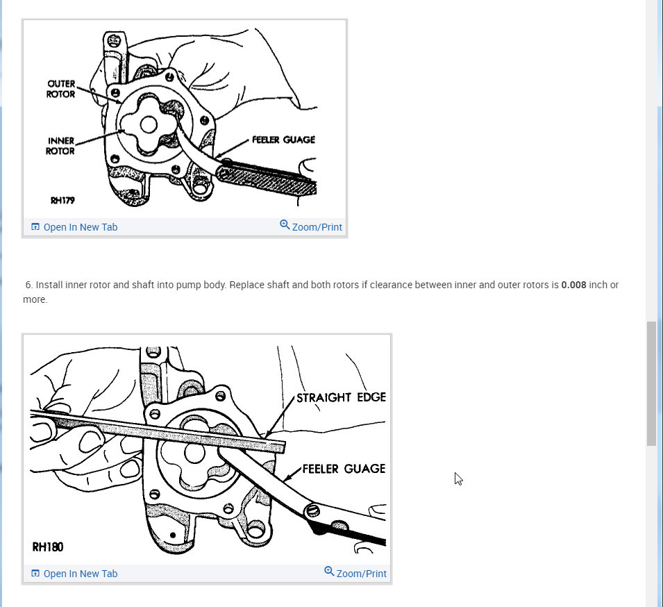

Another thing you need to check is the oil pump. I included the process on how to check it. Pay particular attention on the priming of the oil pump when putting it on the new engine.

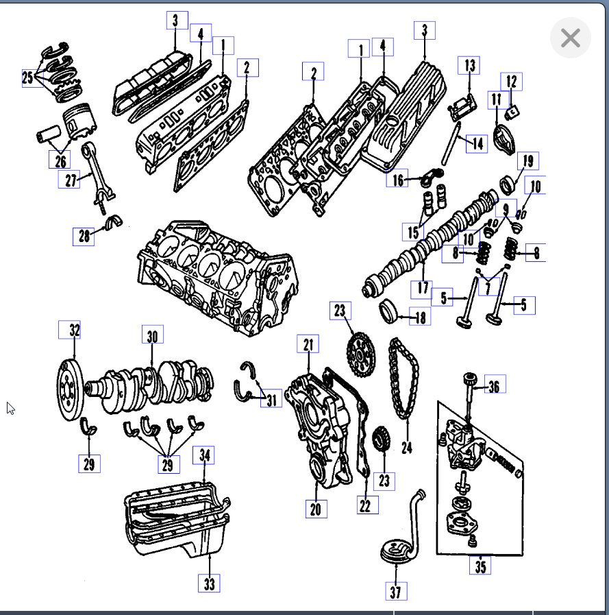

Look through the attachments and let me know if you think you need something else. I included all the torque specs on an engine rebuild and the timing marks. Again, let me know if you need anything thanks.
