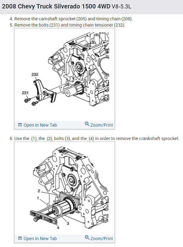

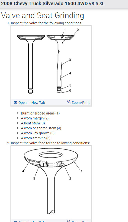

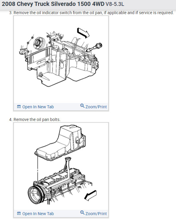

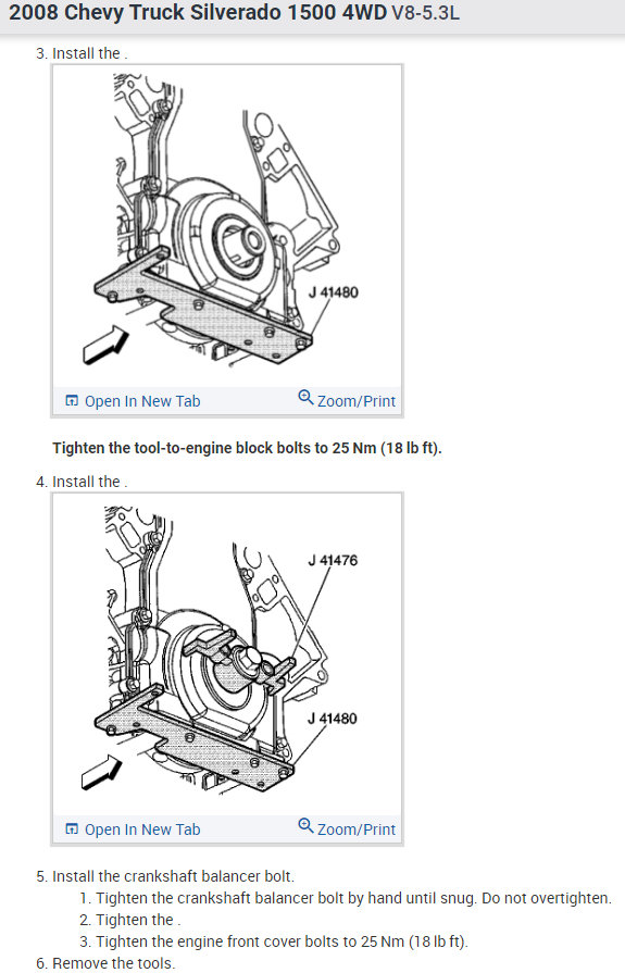

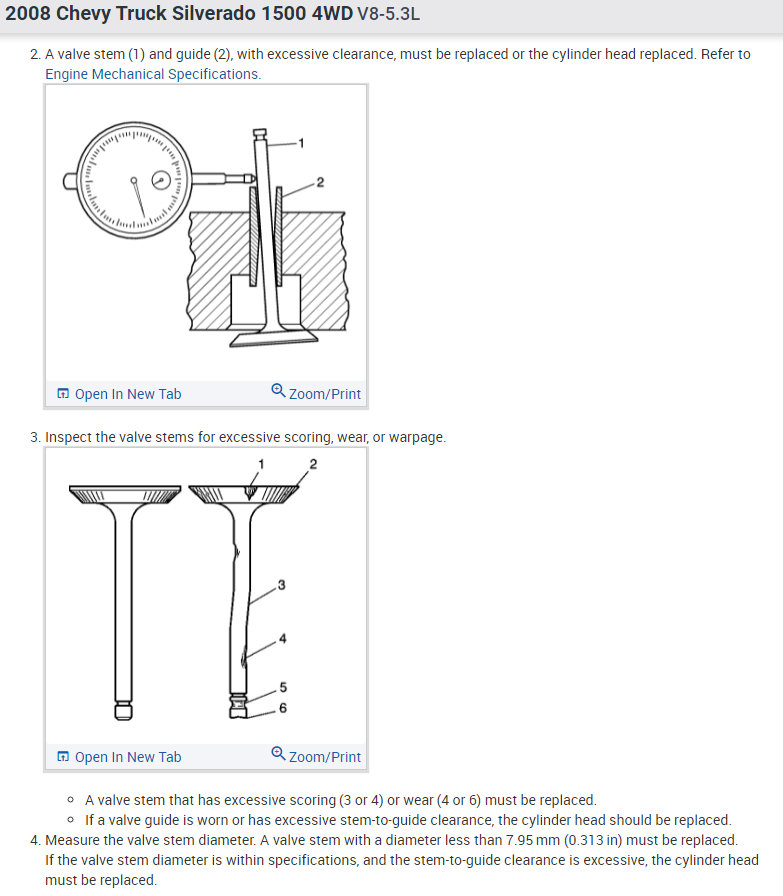

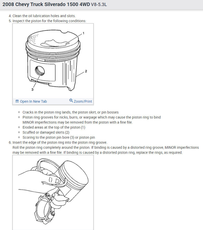

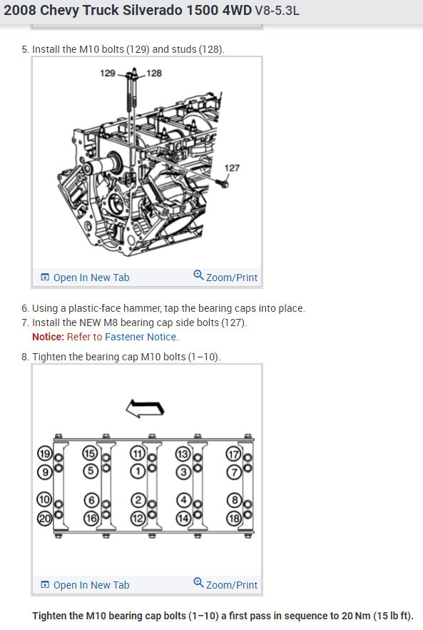

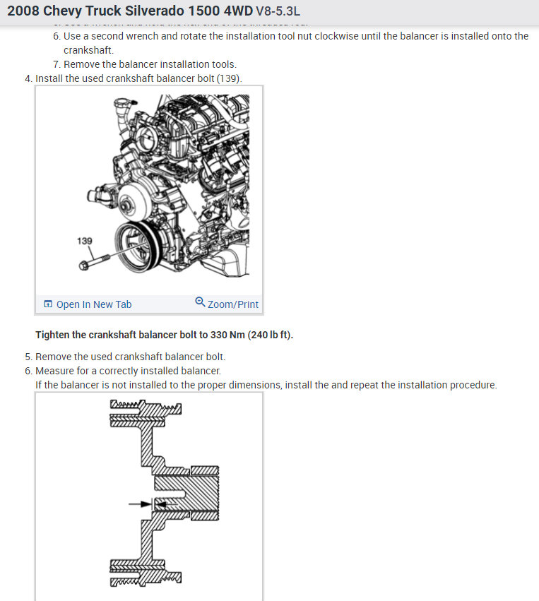

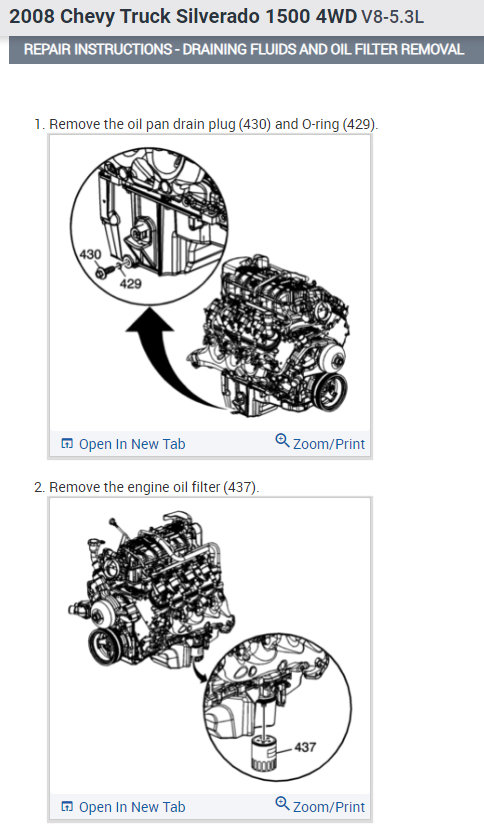

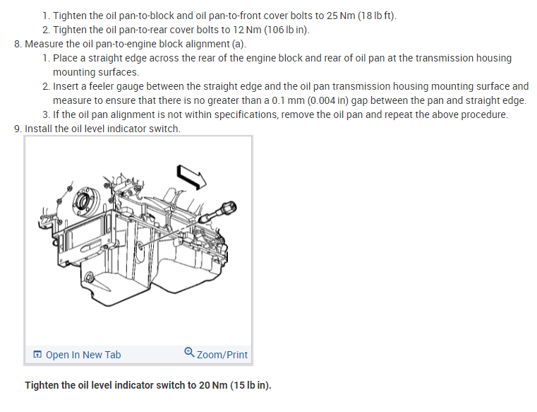

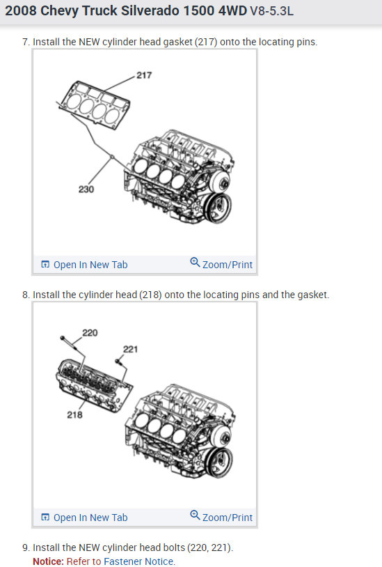

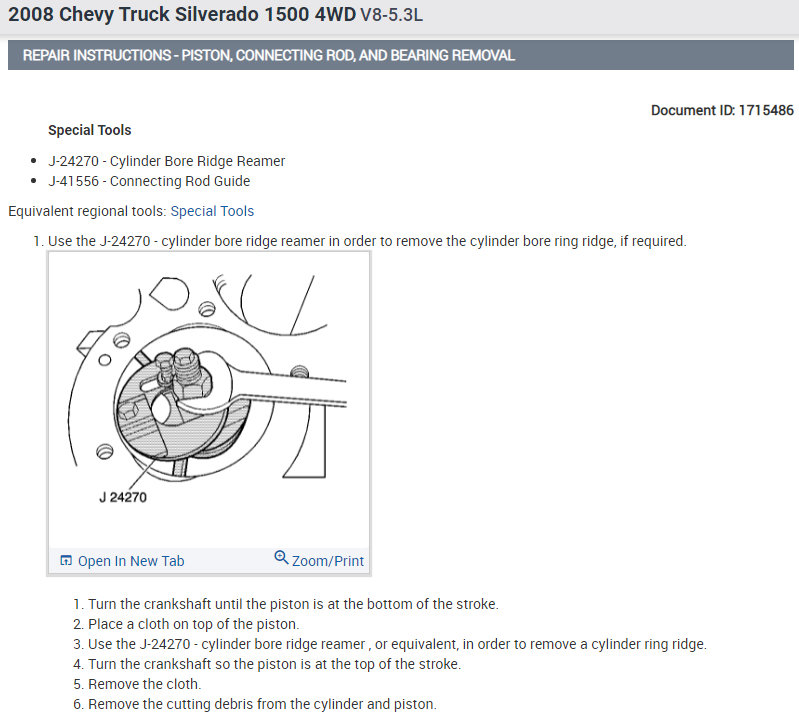

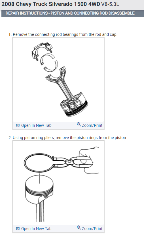

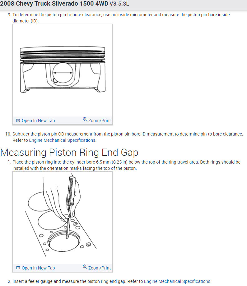

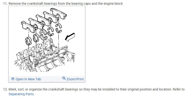

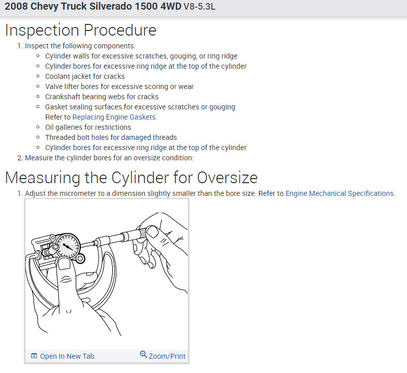

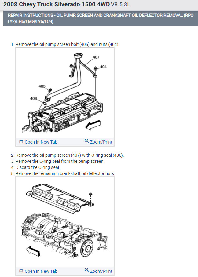

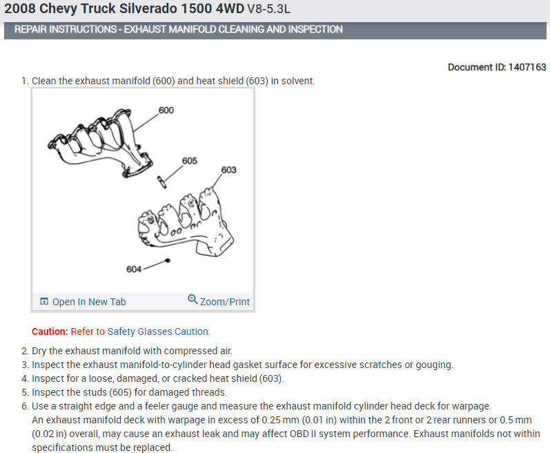

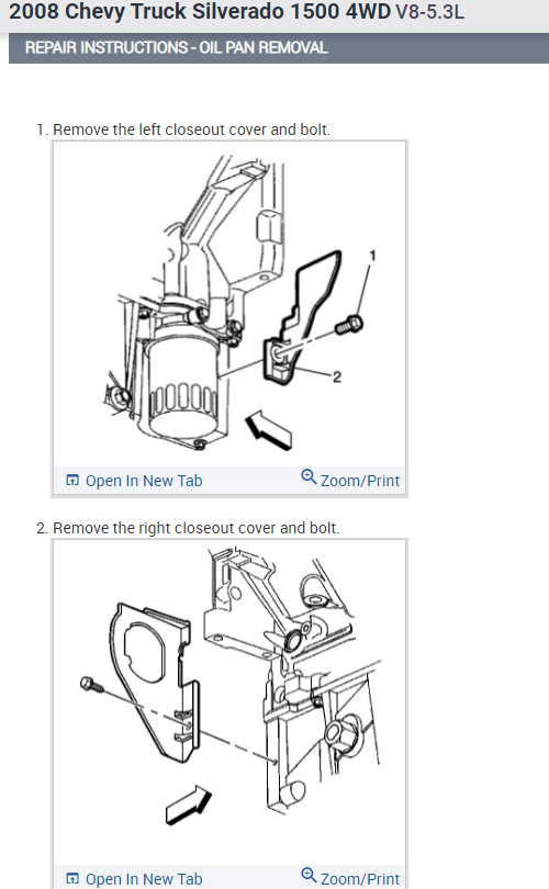

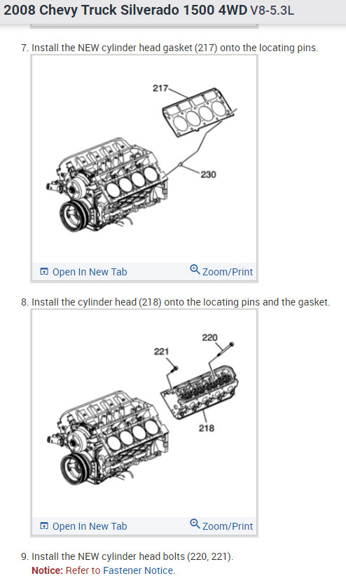

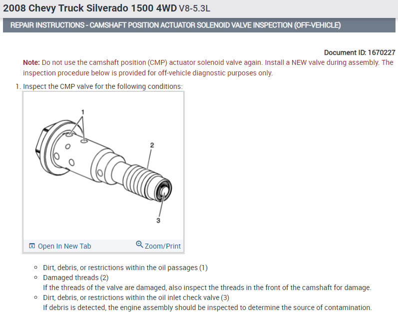

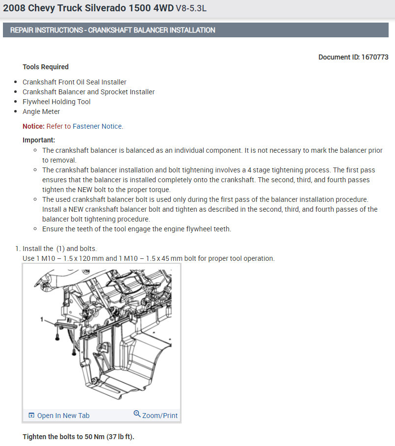

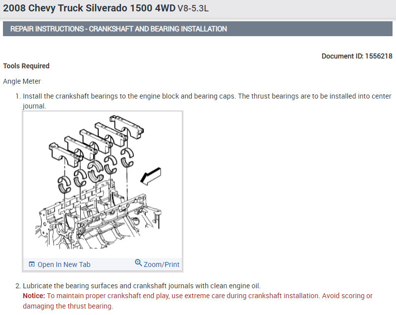

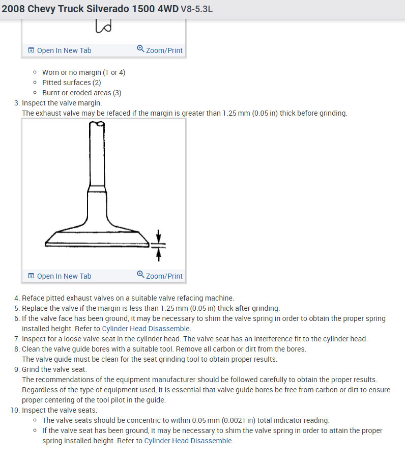

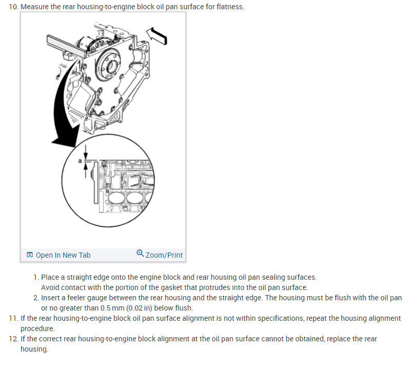

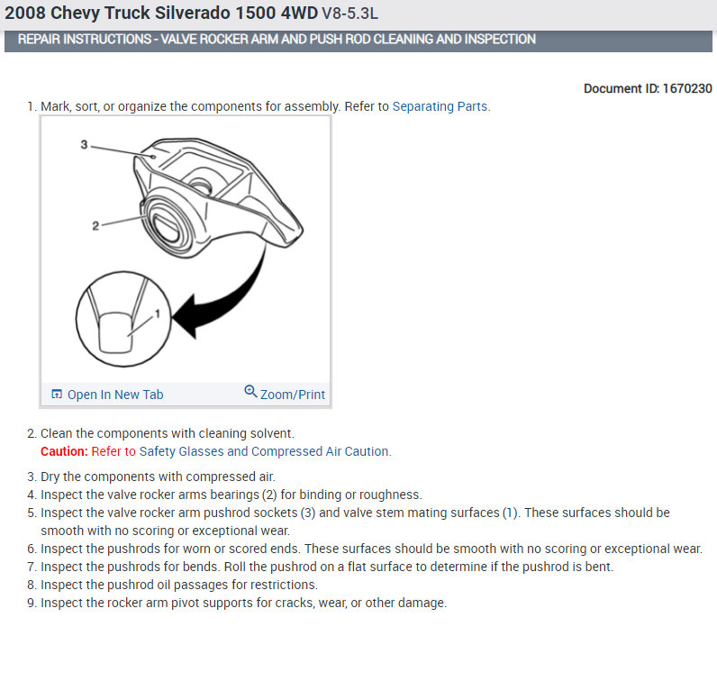

What is the procedure for tear down and rebuild procedure for installing a rering kit?

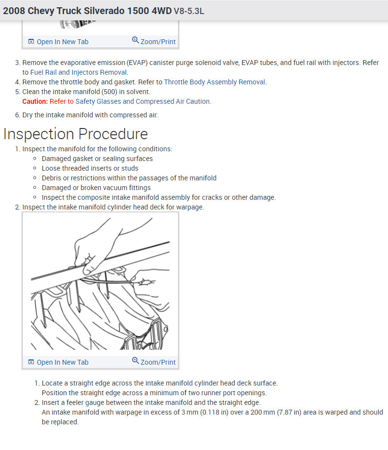

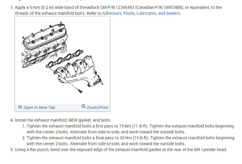

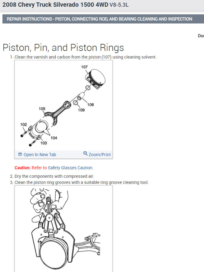

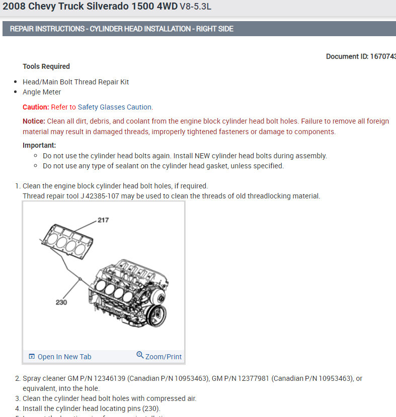

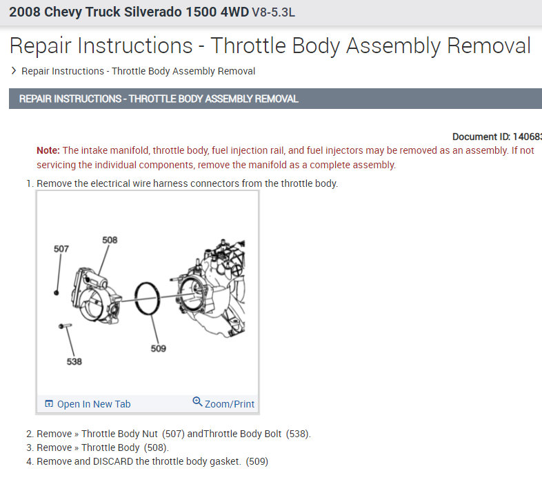

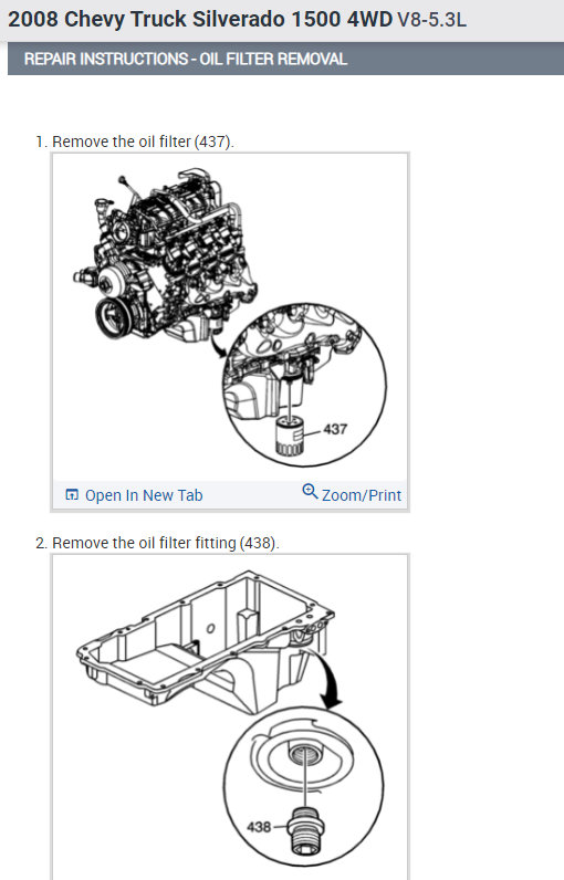

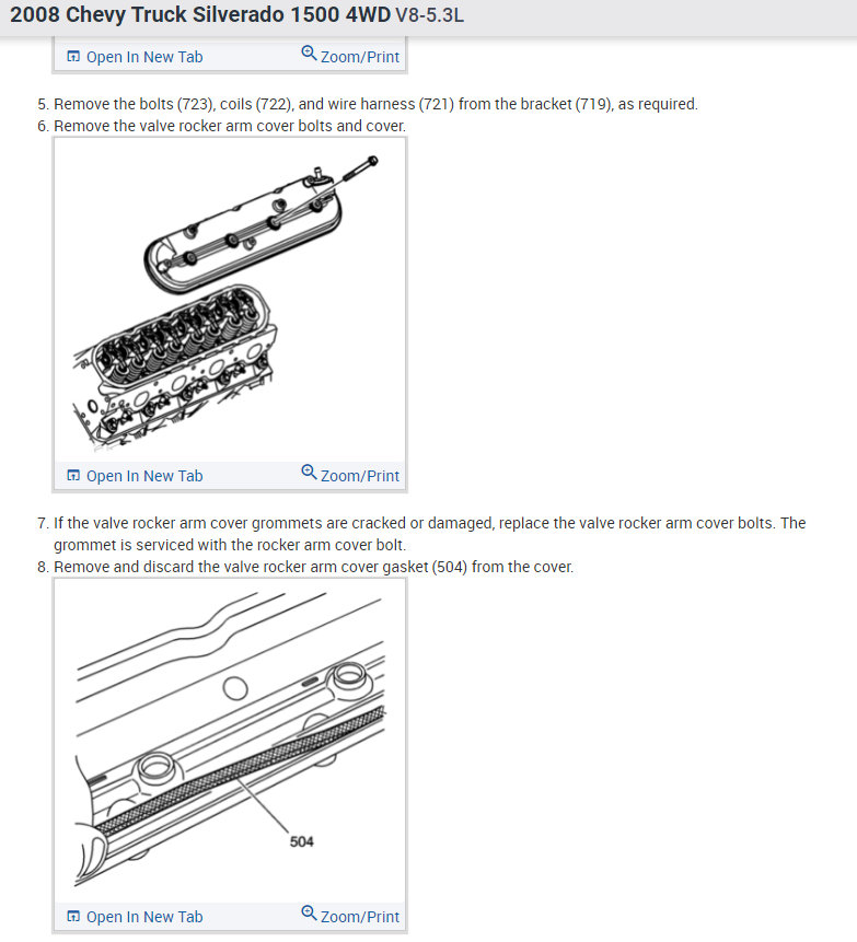

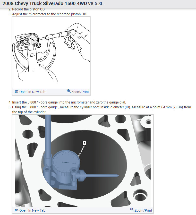

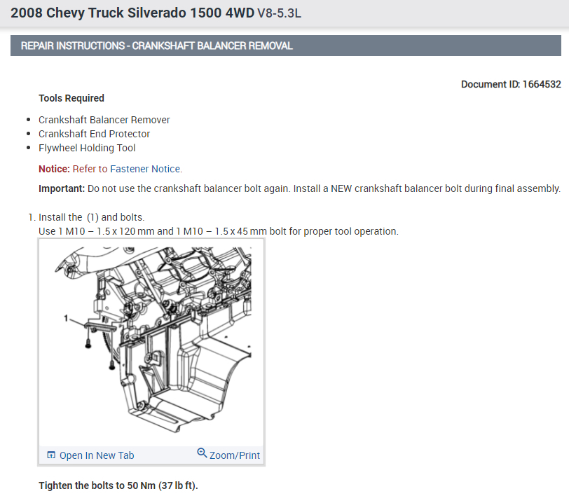

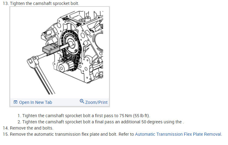

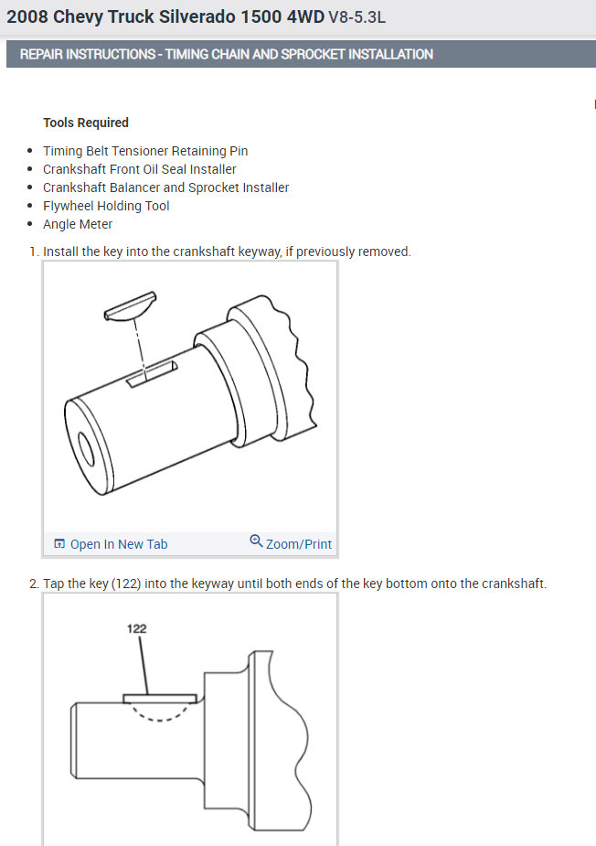

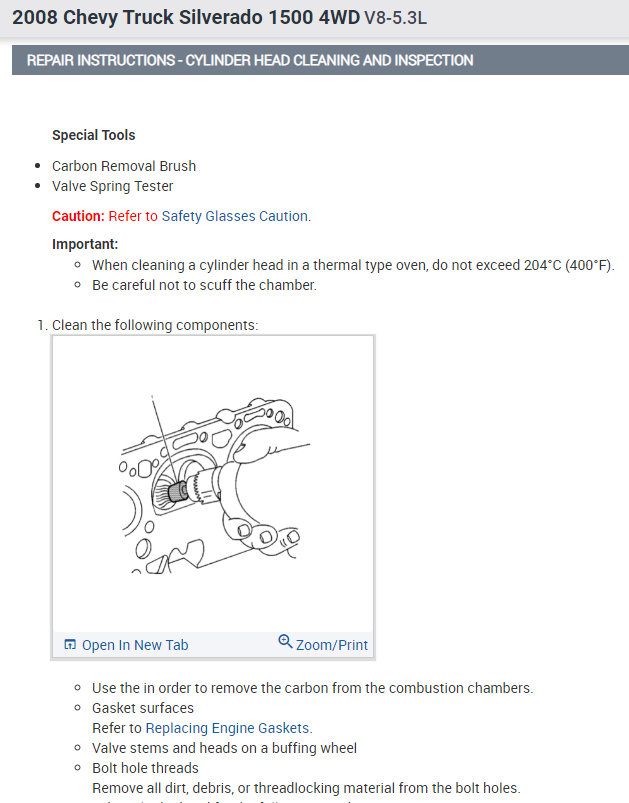

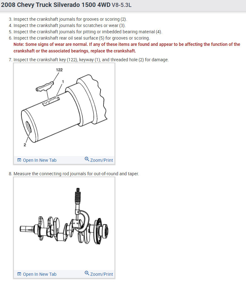

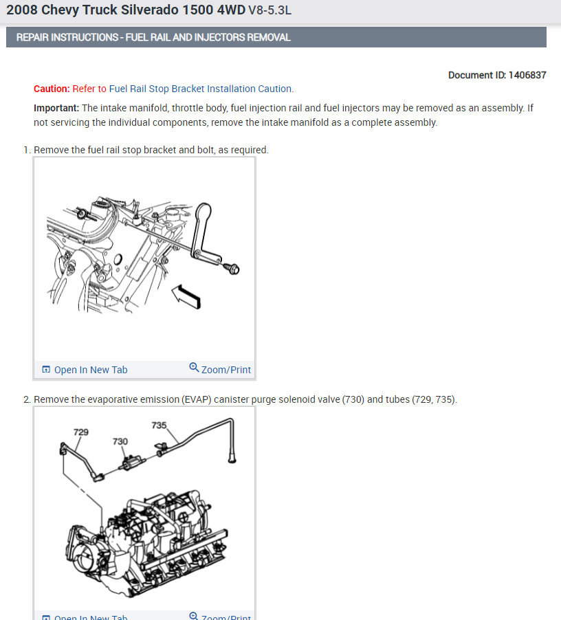

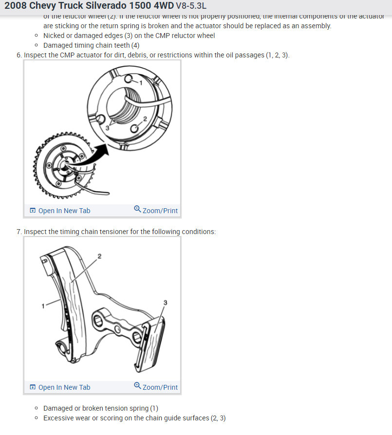

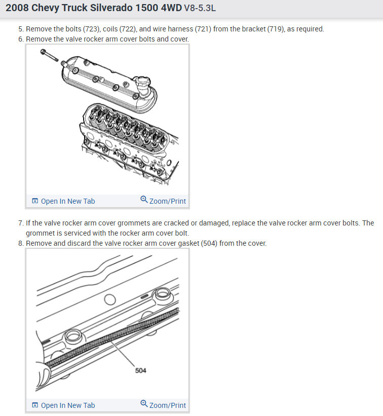

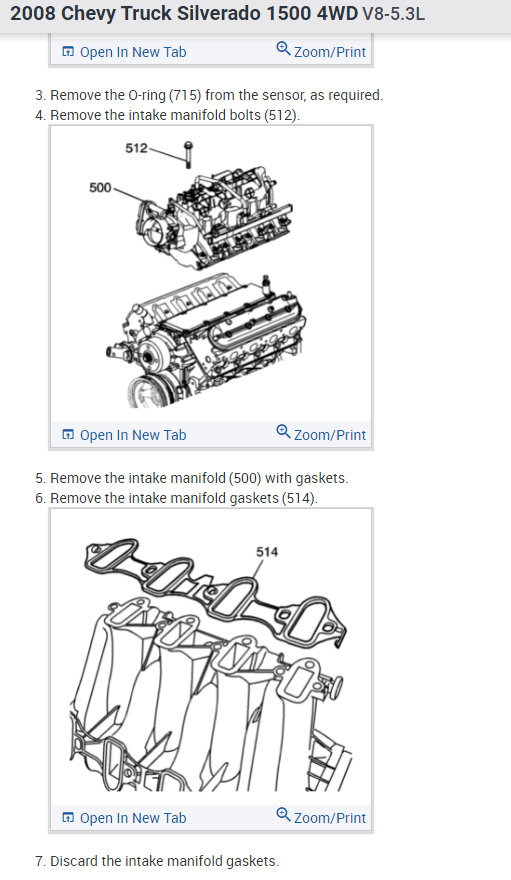

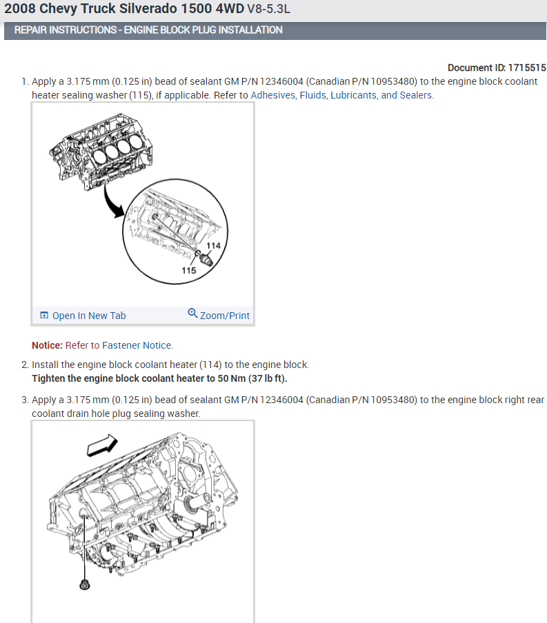

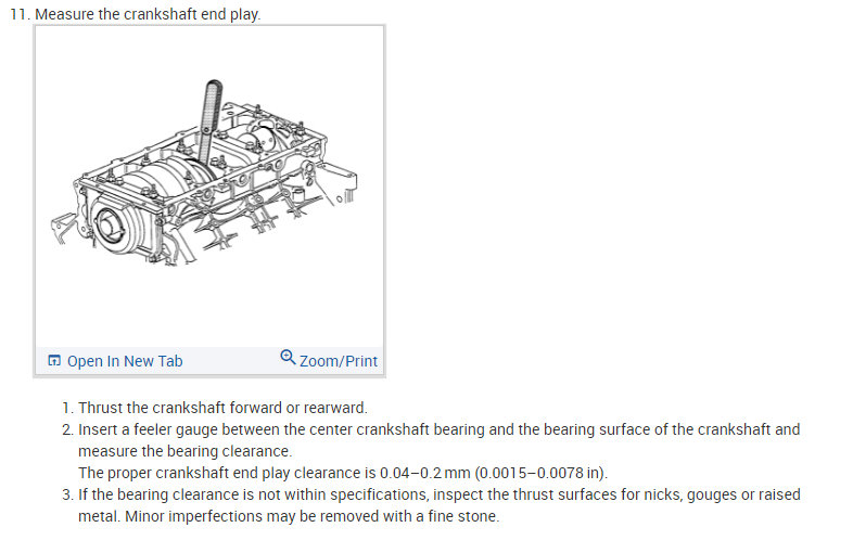

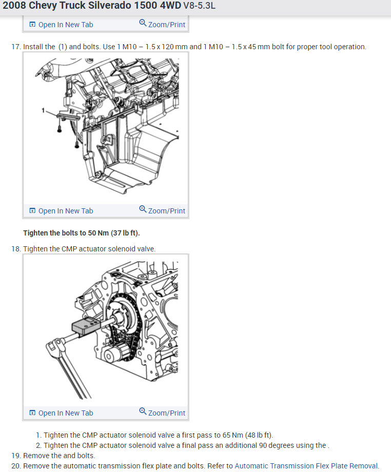

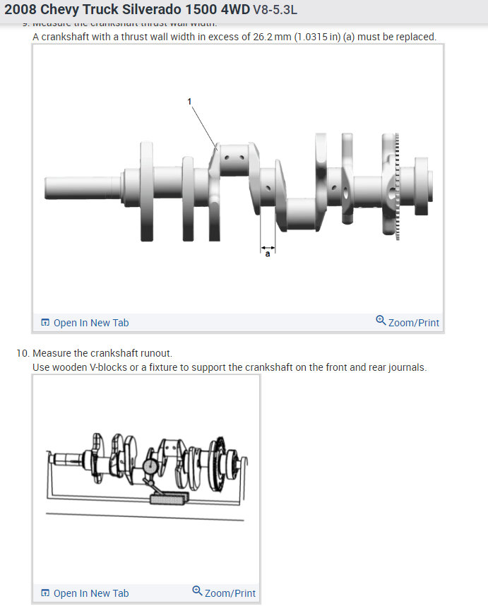

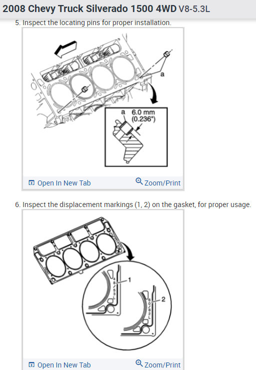

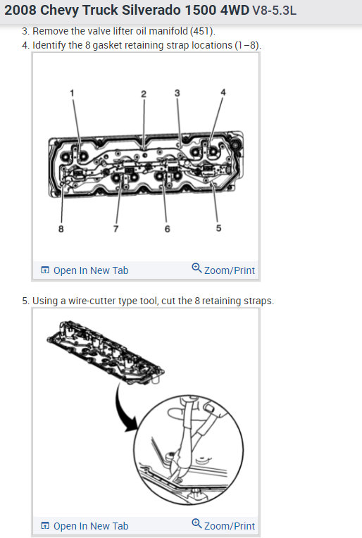

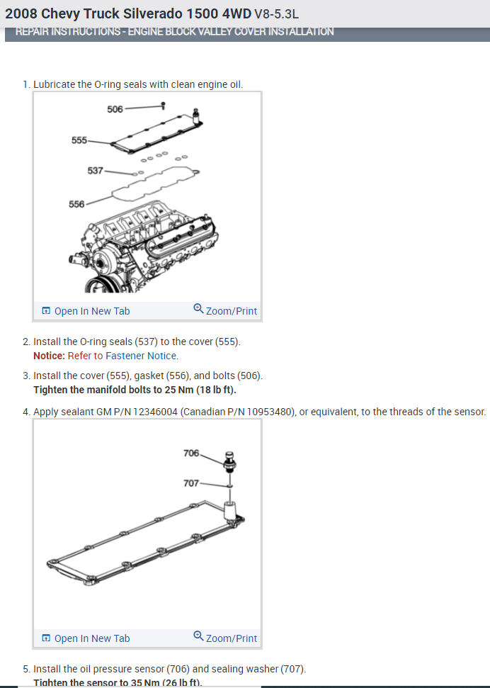

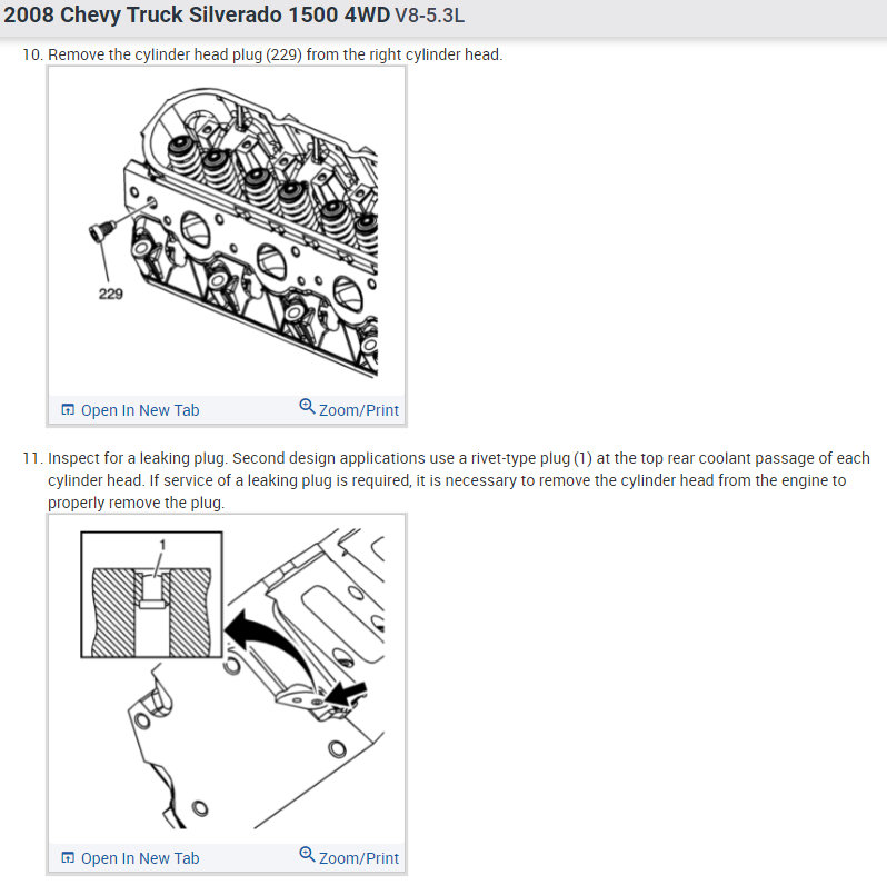

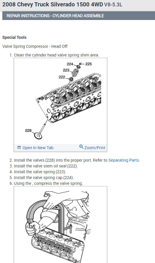

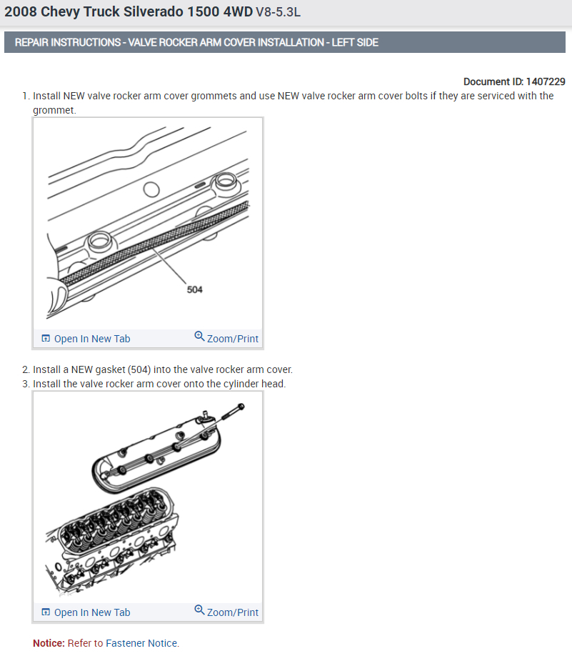

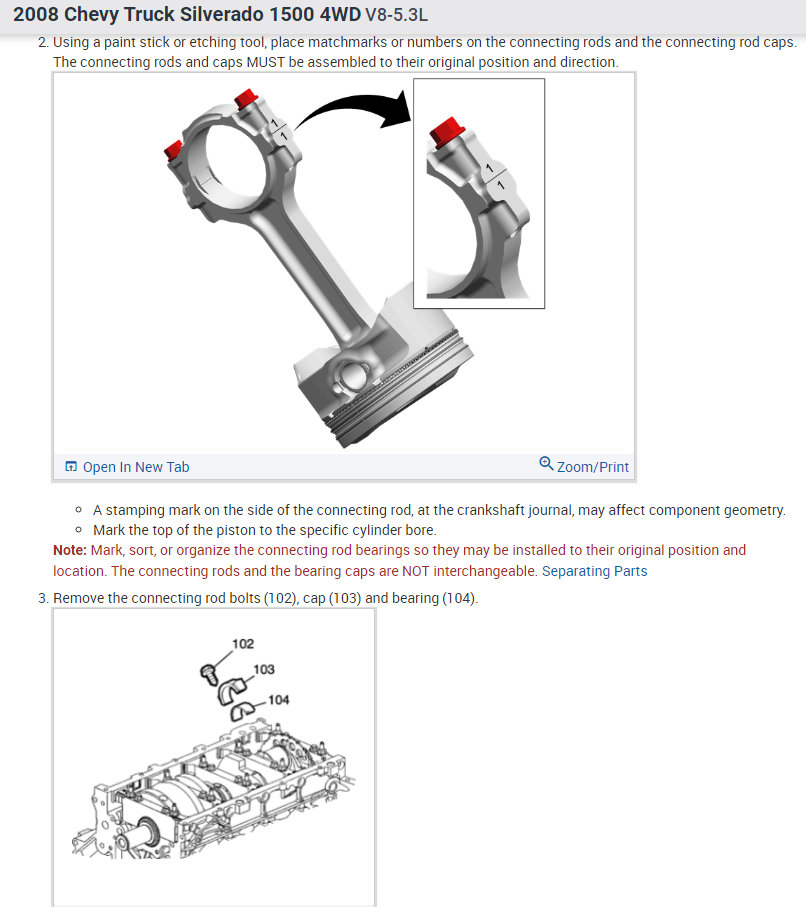

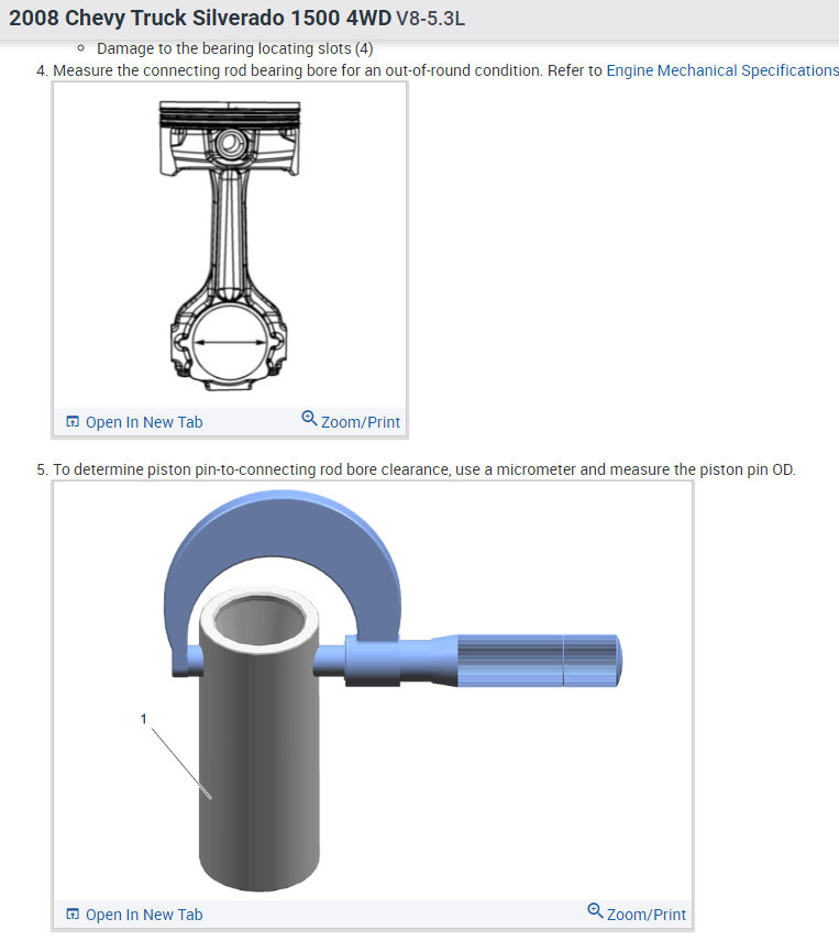

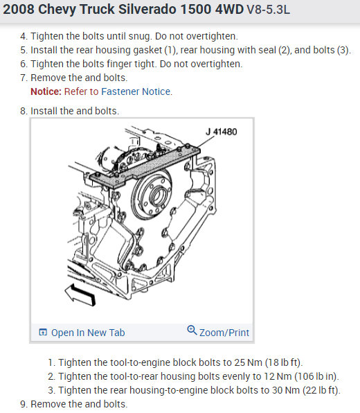

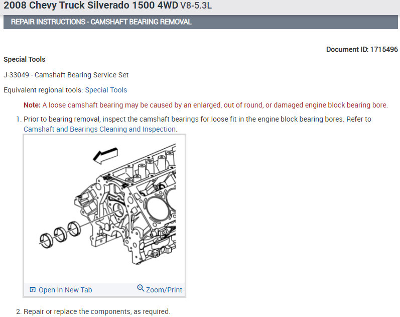

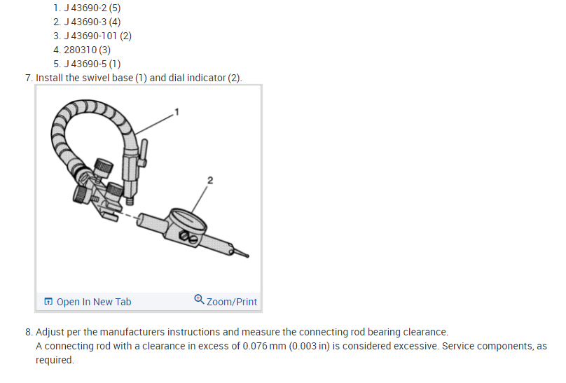

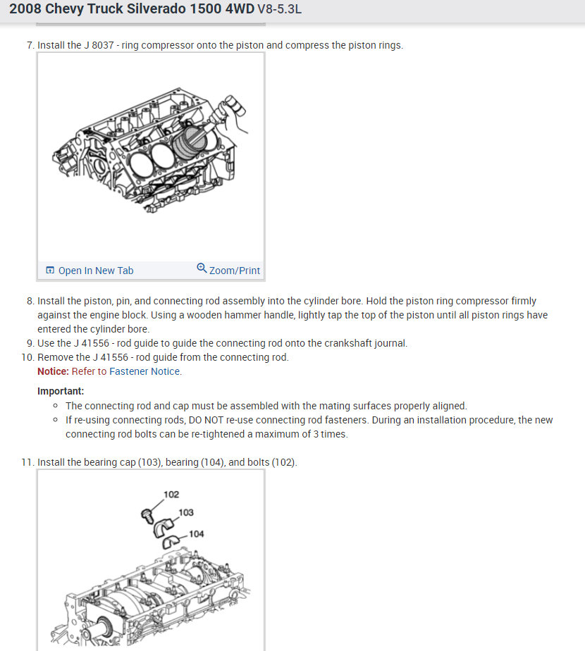

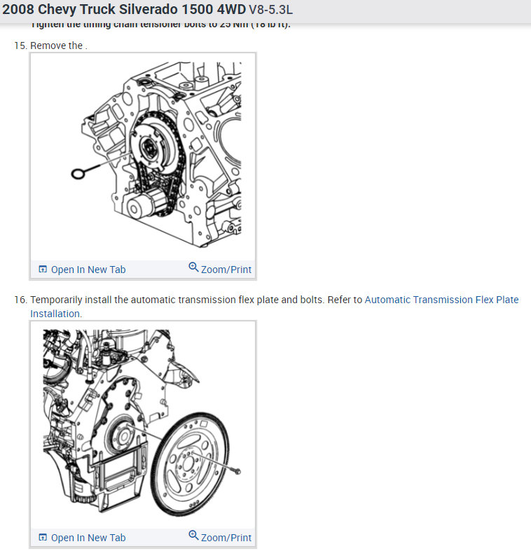

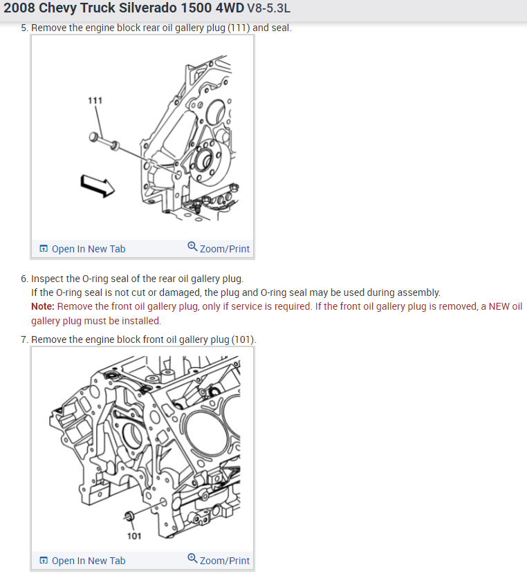

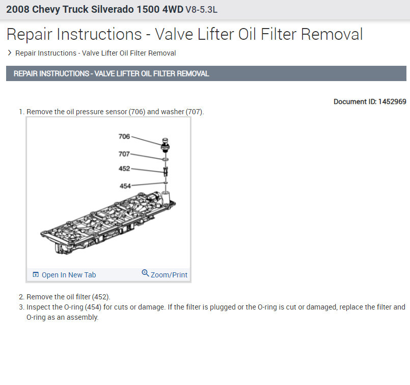

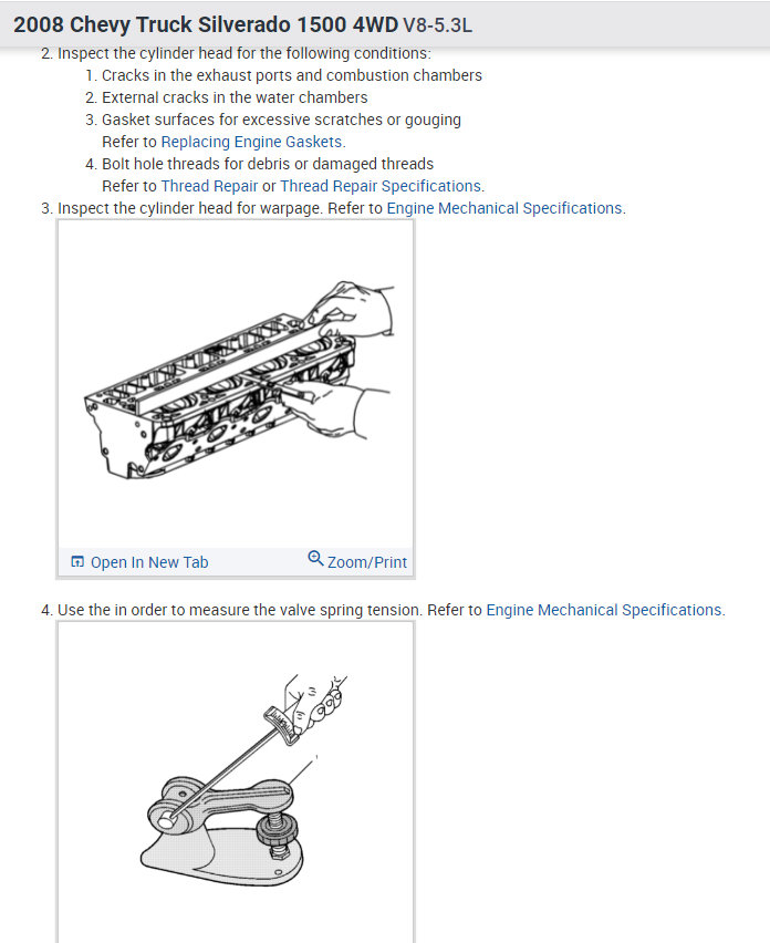

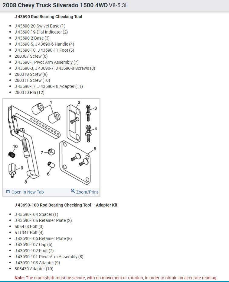

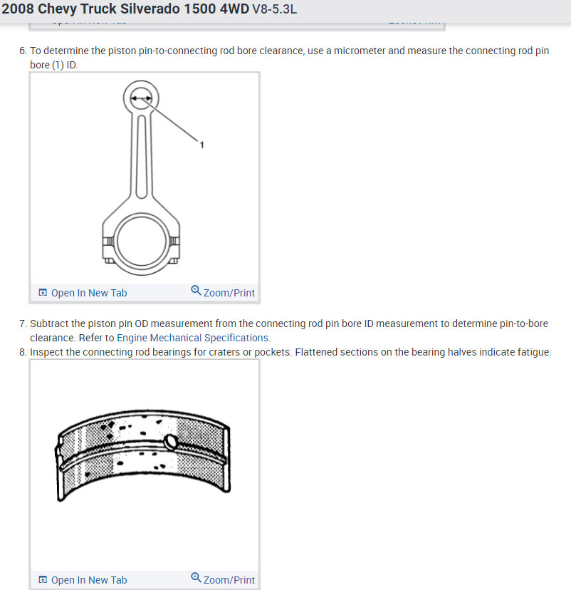

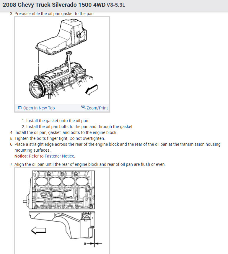

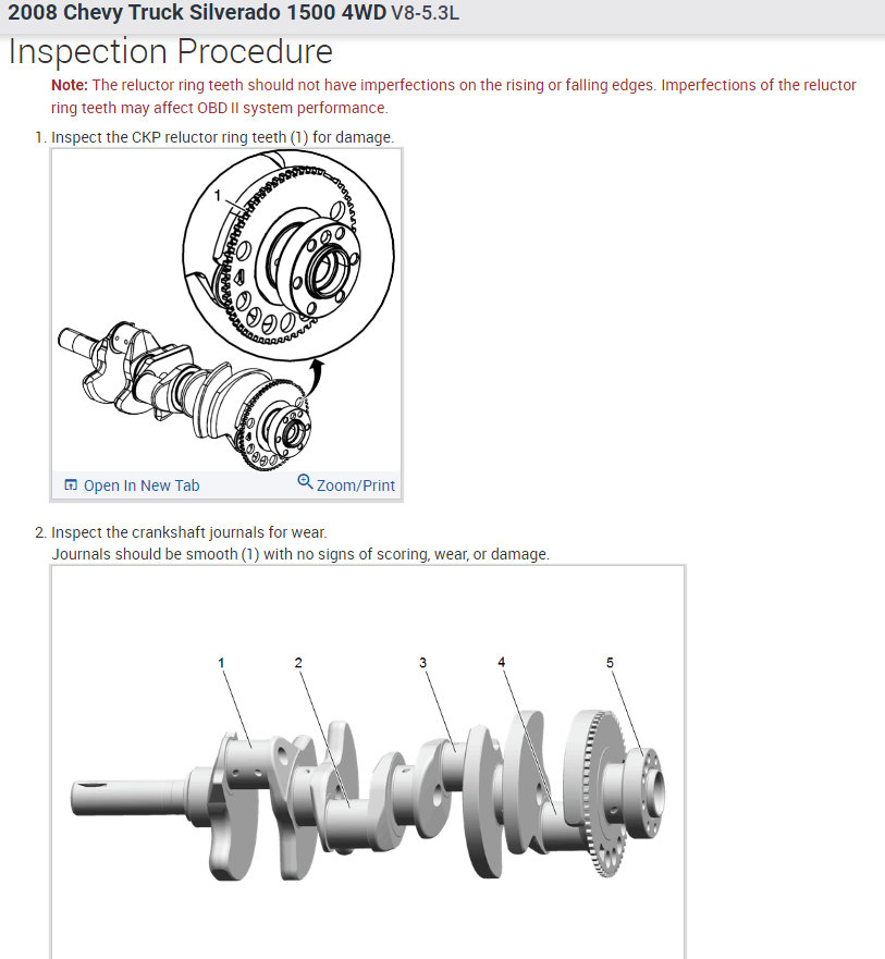

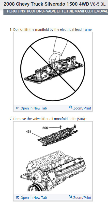

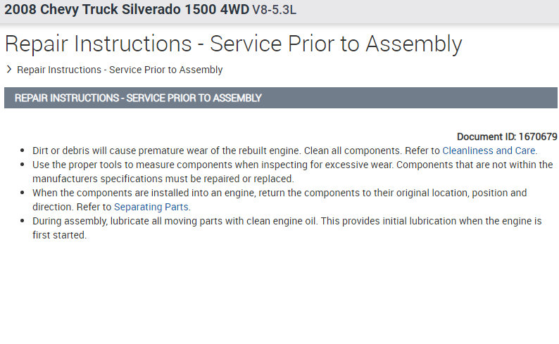

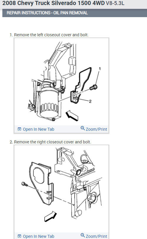

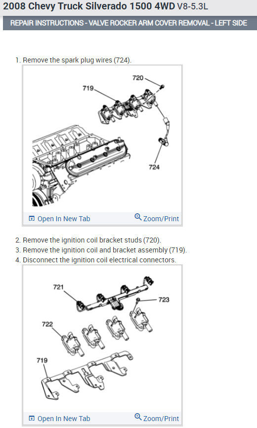

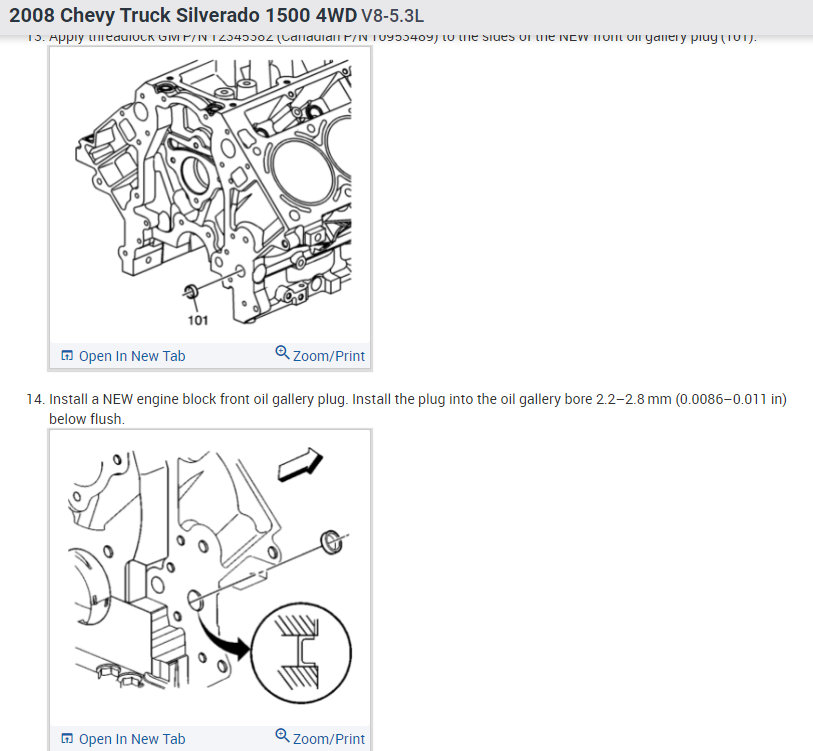

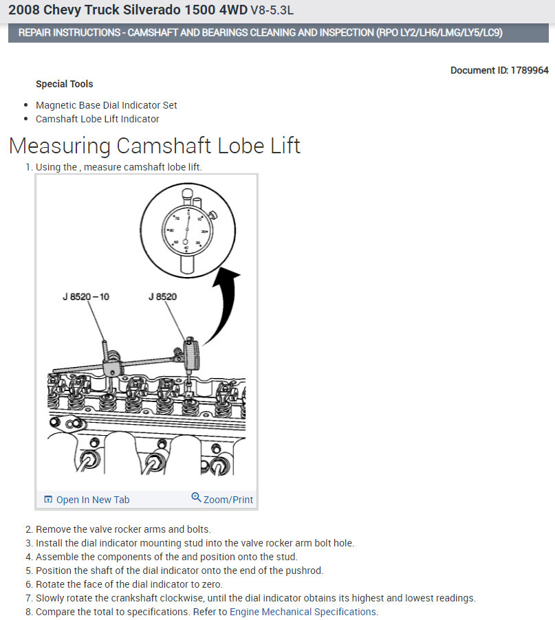

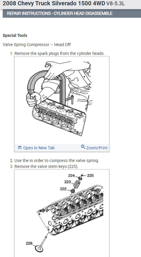

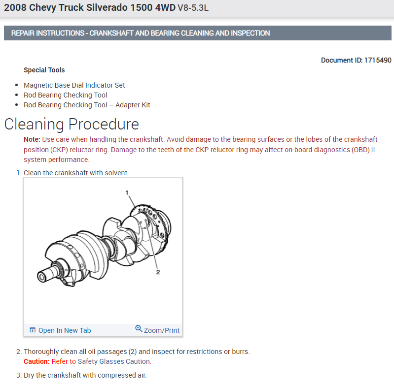

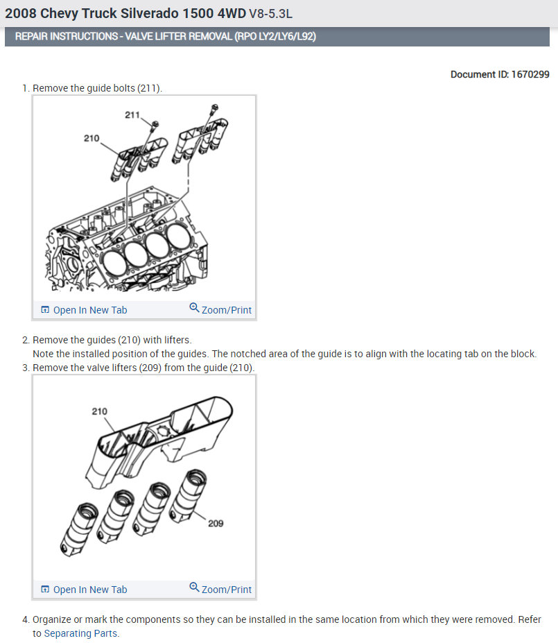

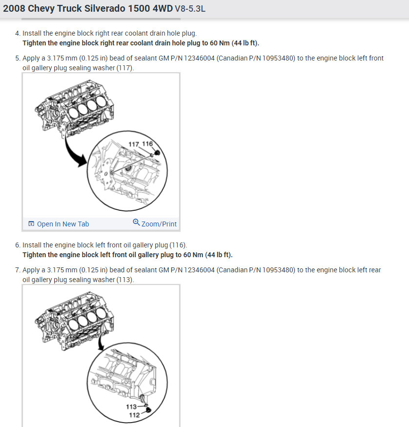

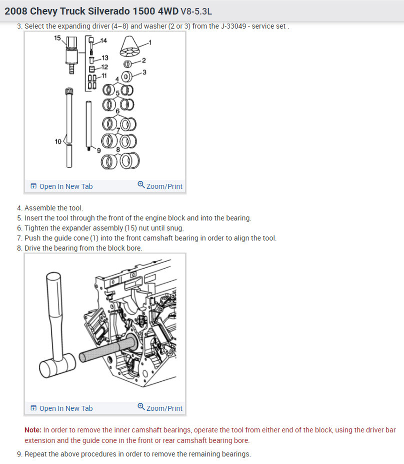

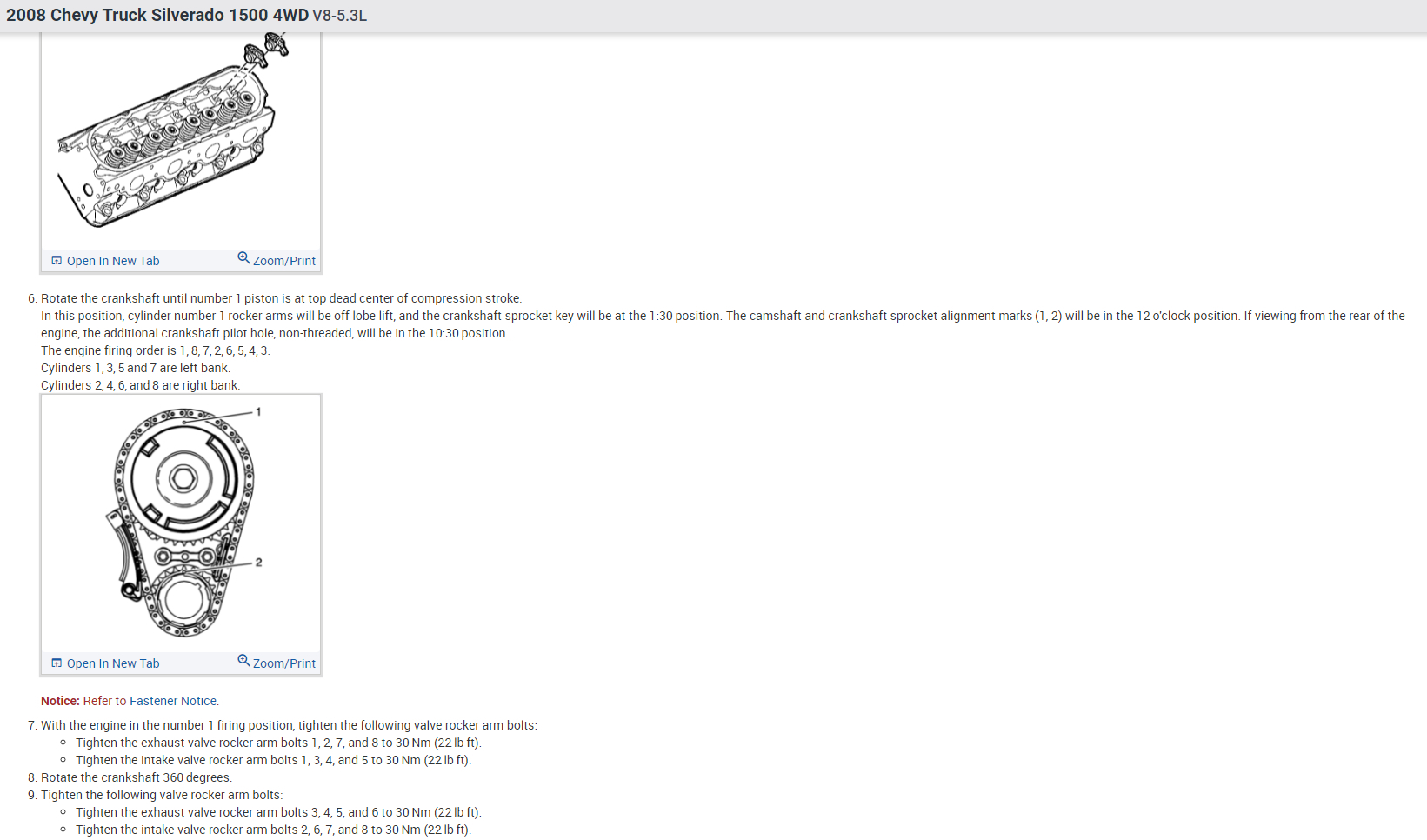

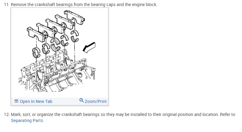

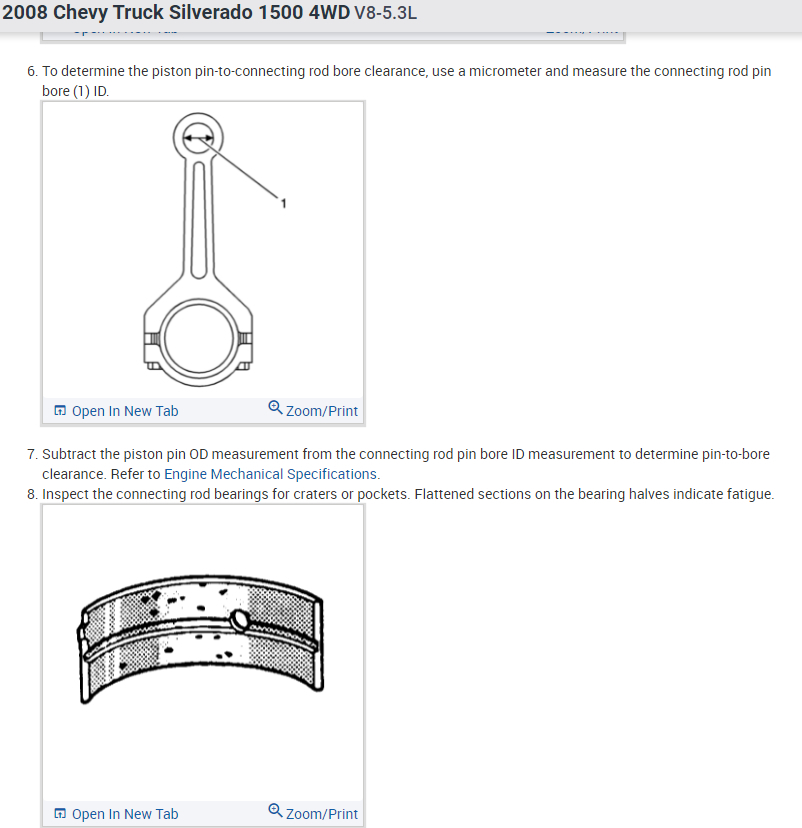

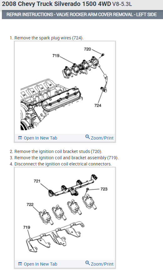

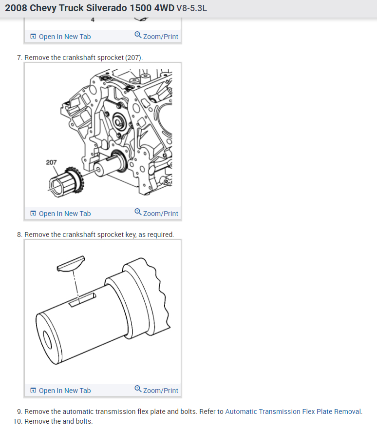

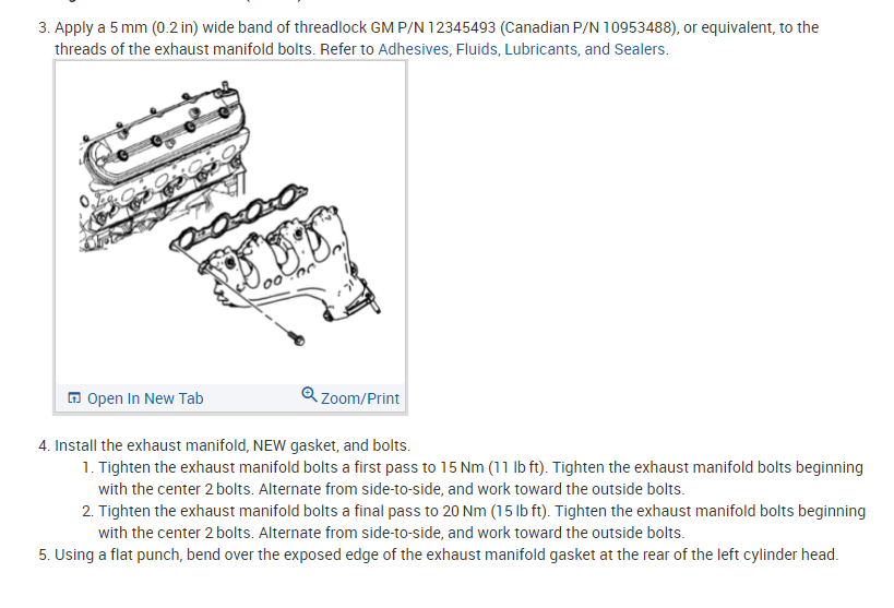

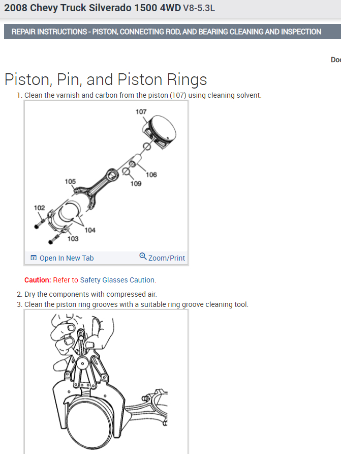

I'm looking for the rebuild procedure rather than installing only the ring. Thank you for your help!
Aug 31, 2021 at 11:57 AM

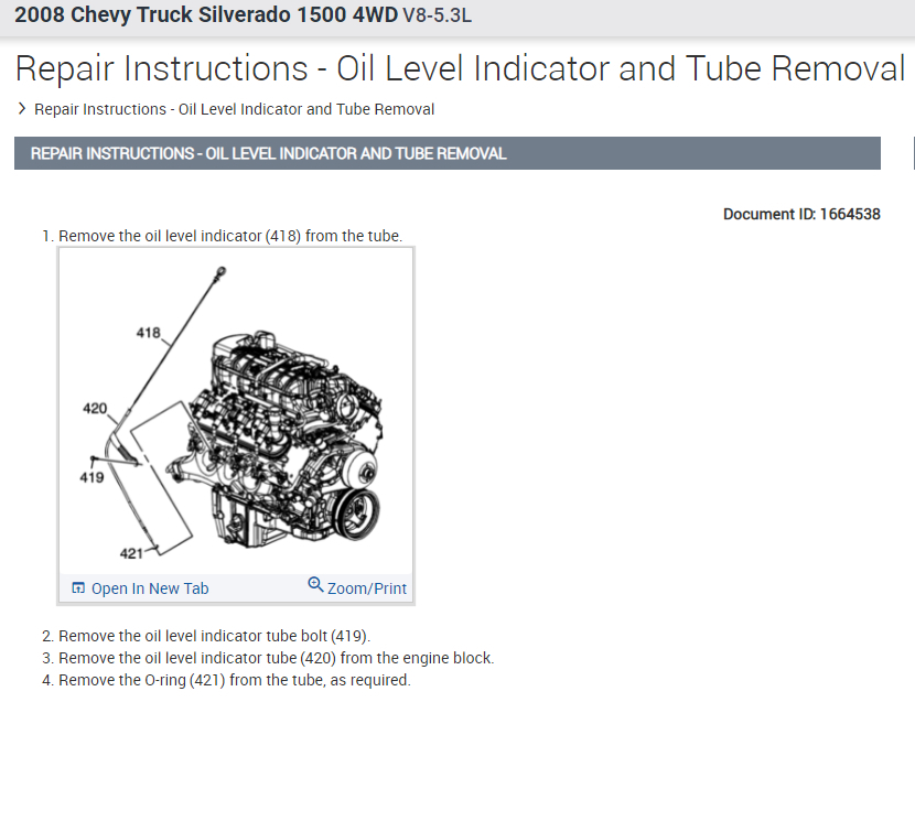

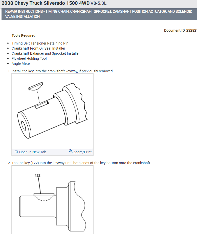

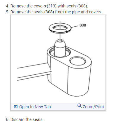

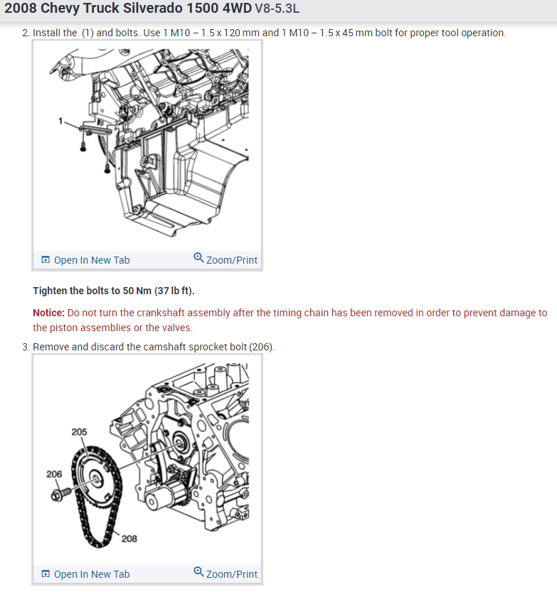

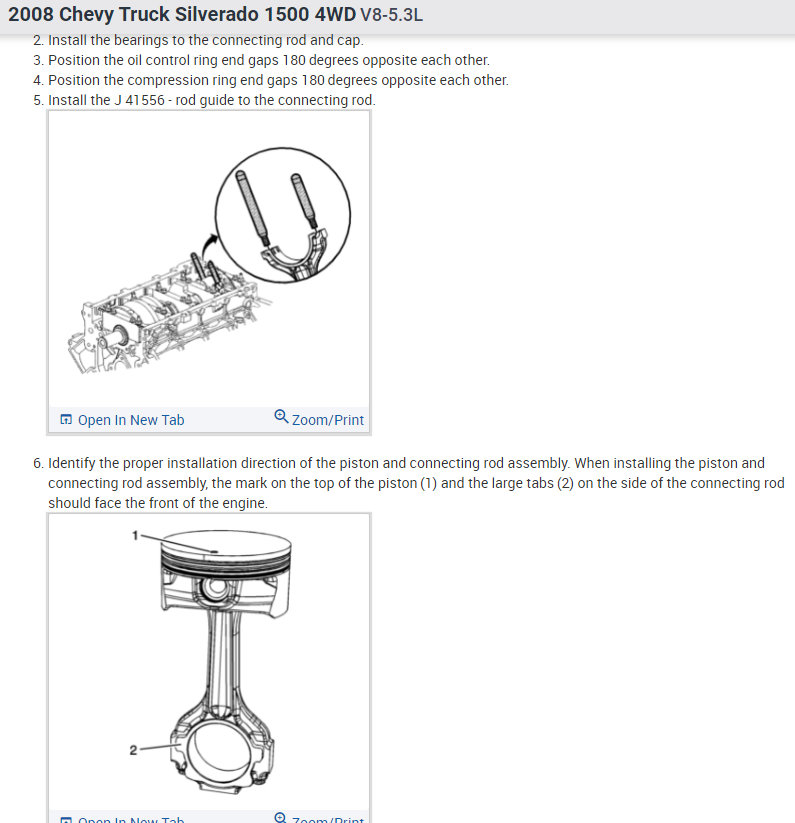

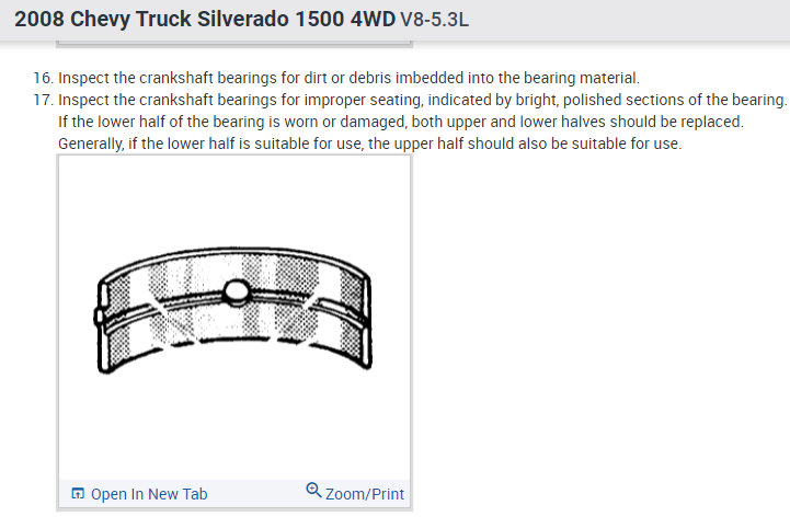

SQM
  • 6,383 POSTS

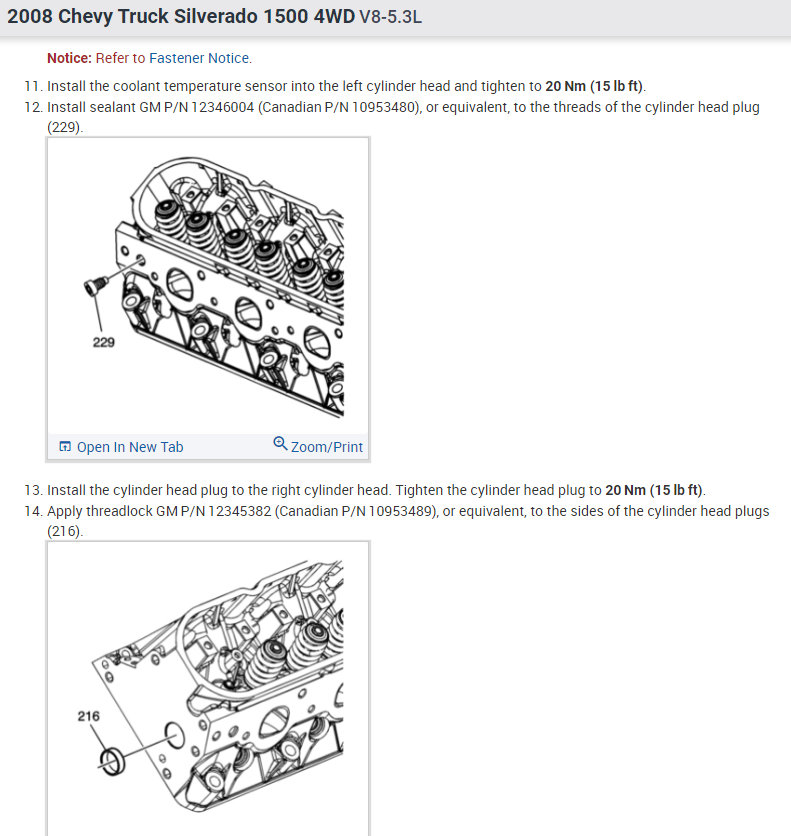

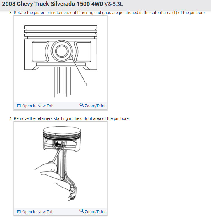

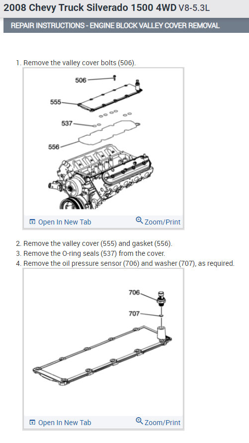

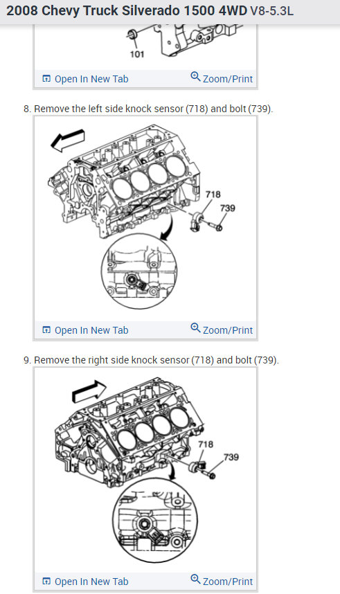

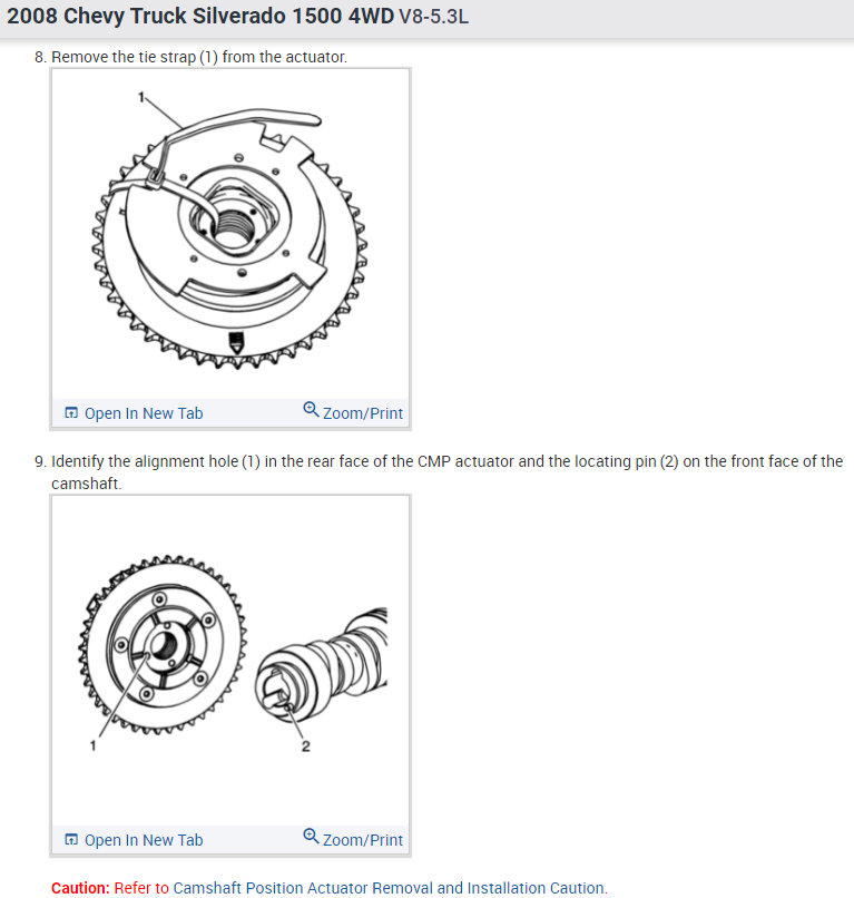

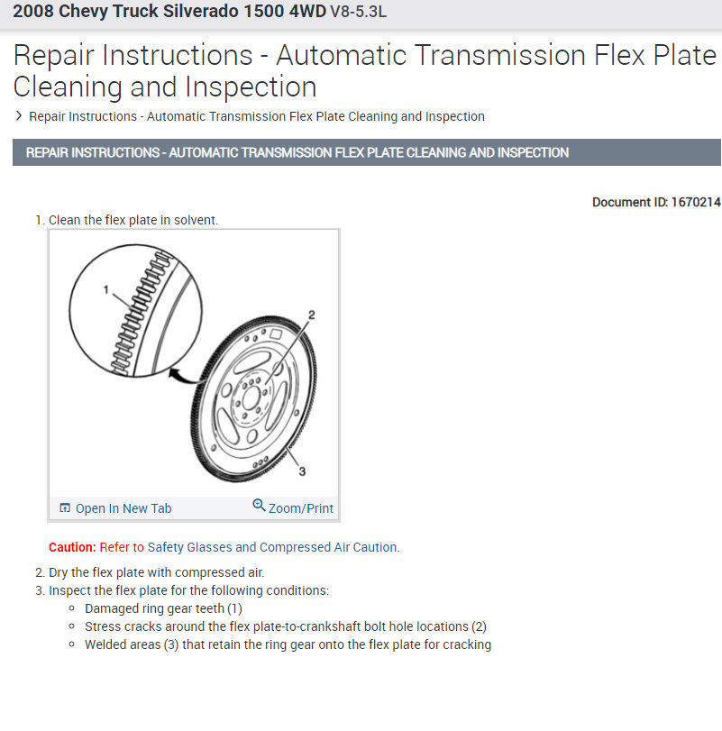

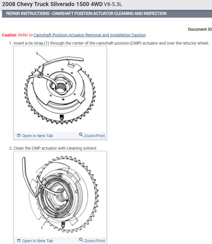

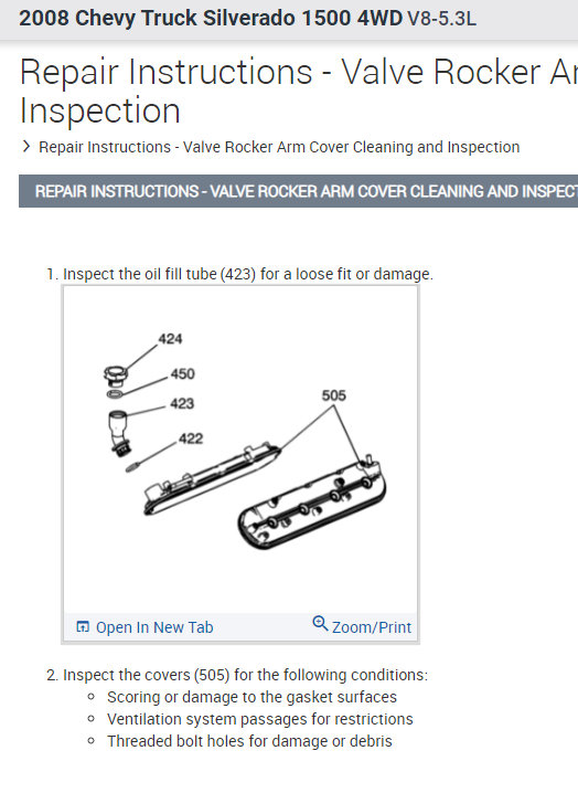

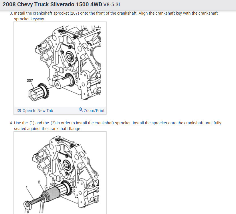

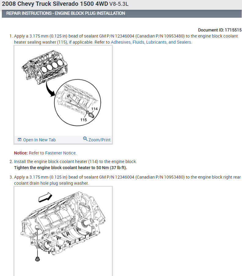

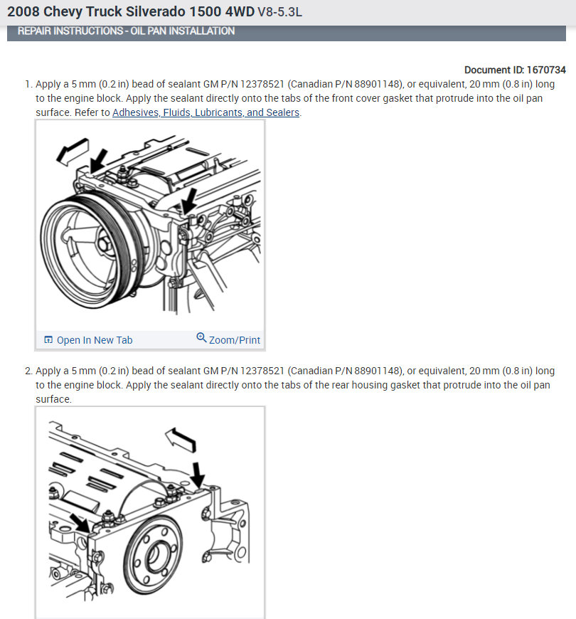

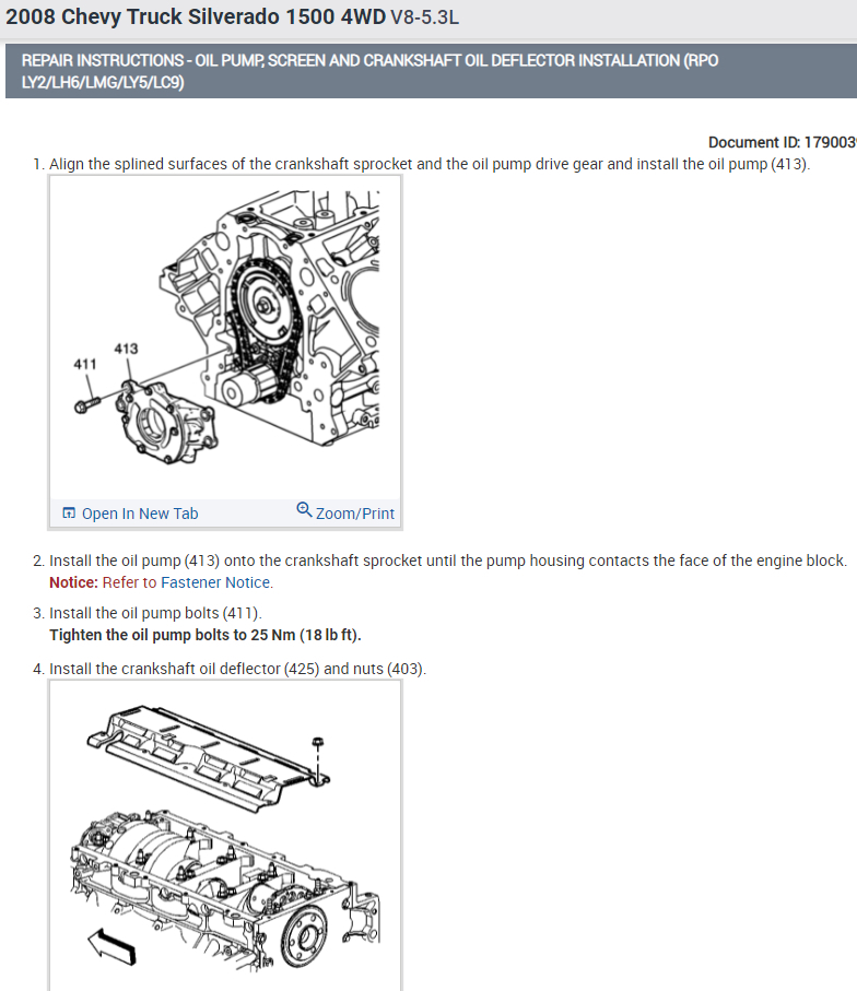

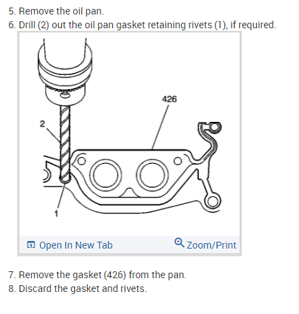

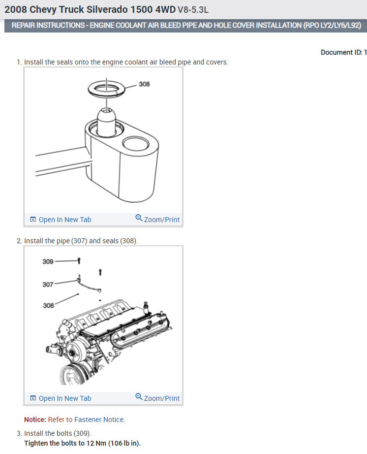

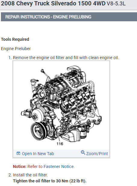

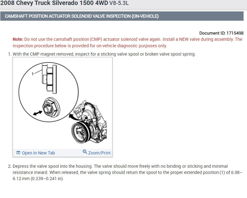

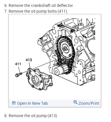

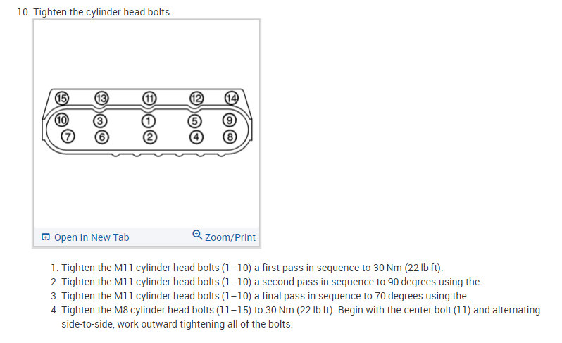

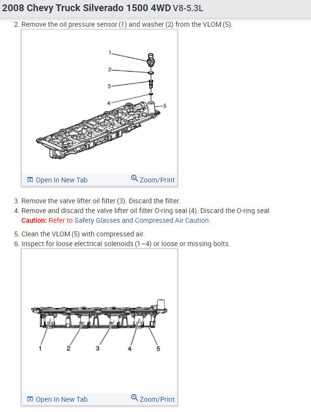

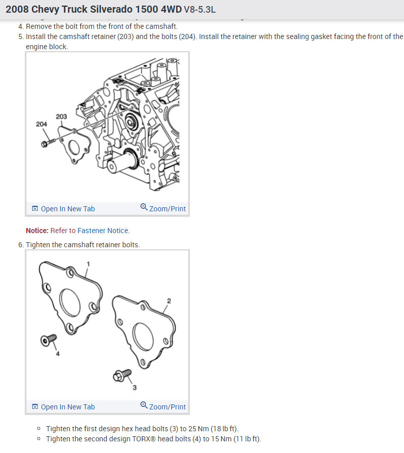

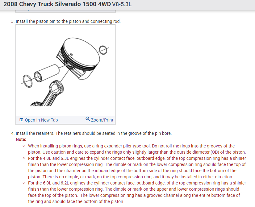

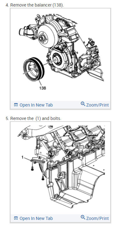

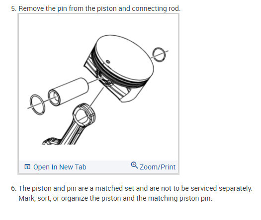

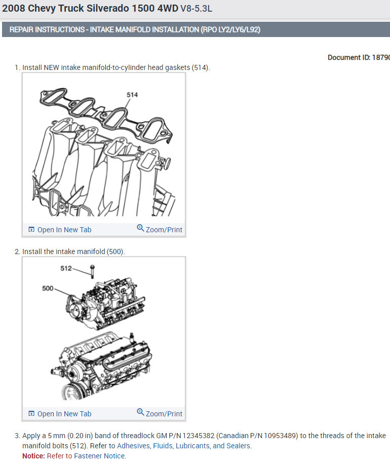

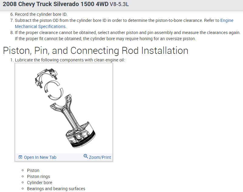

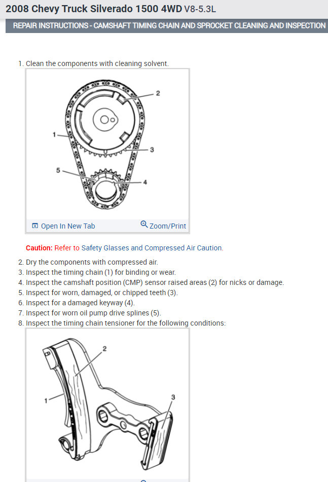

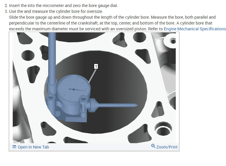

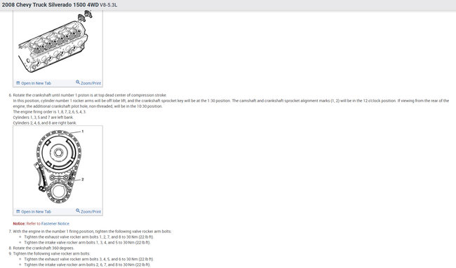

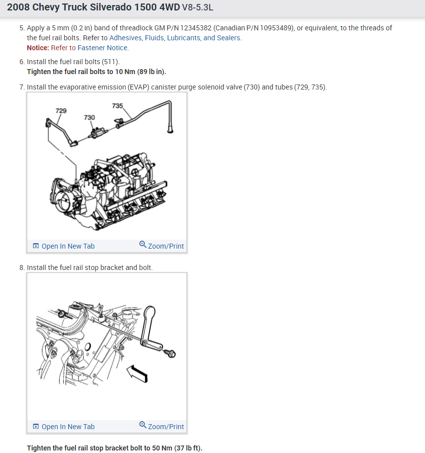

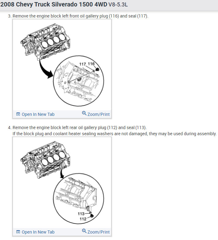

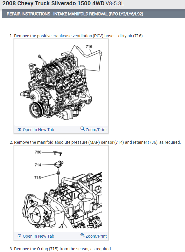

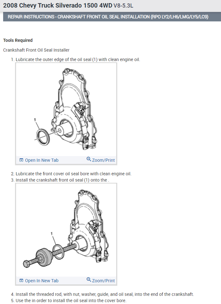

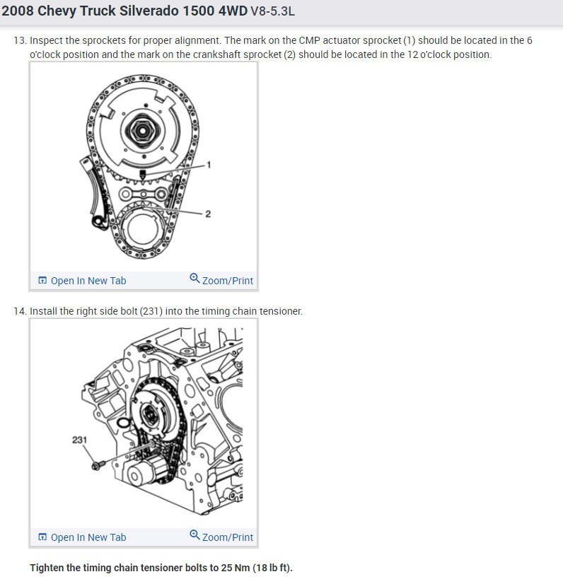

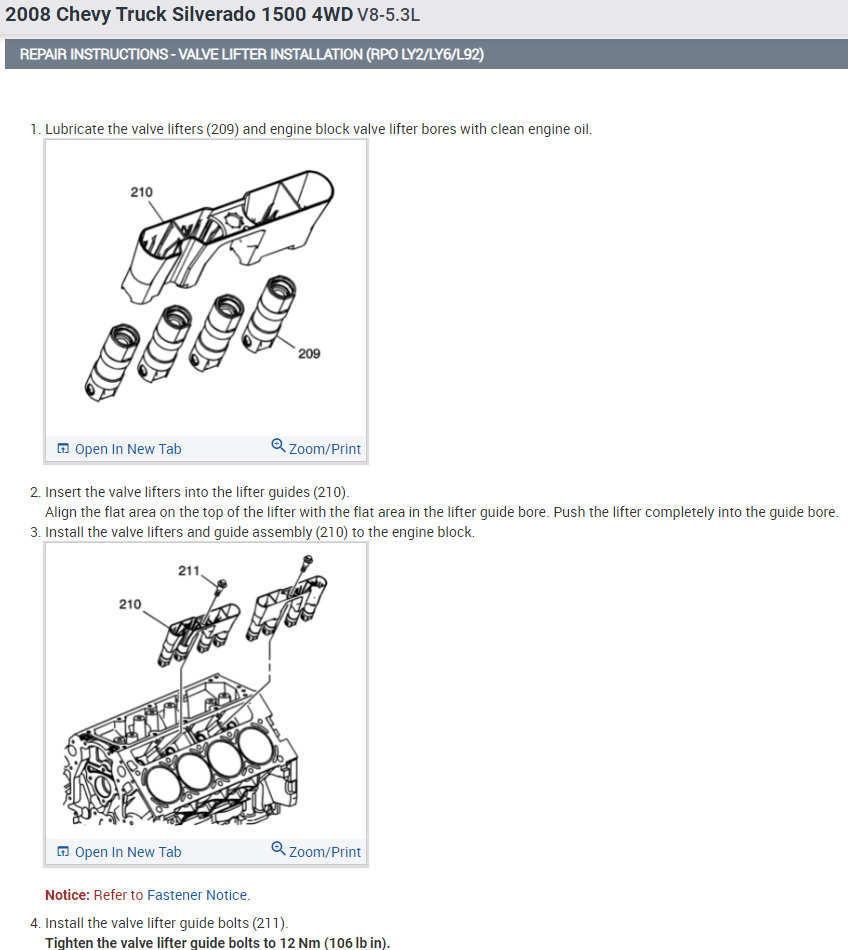

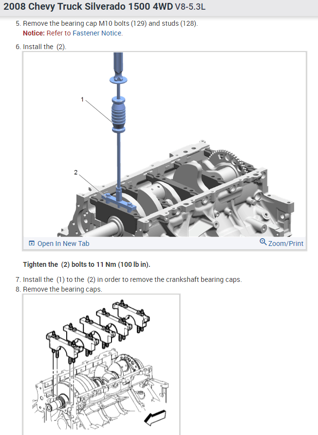

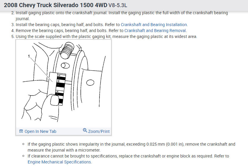

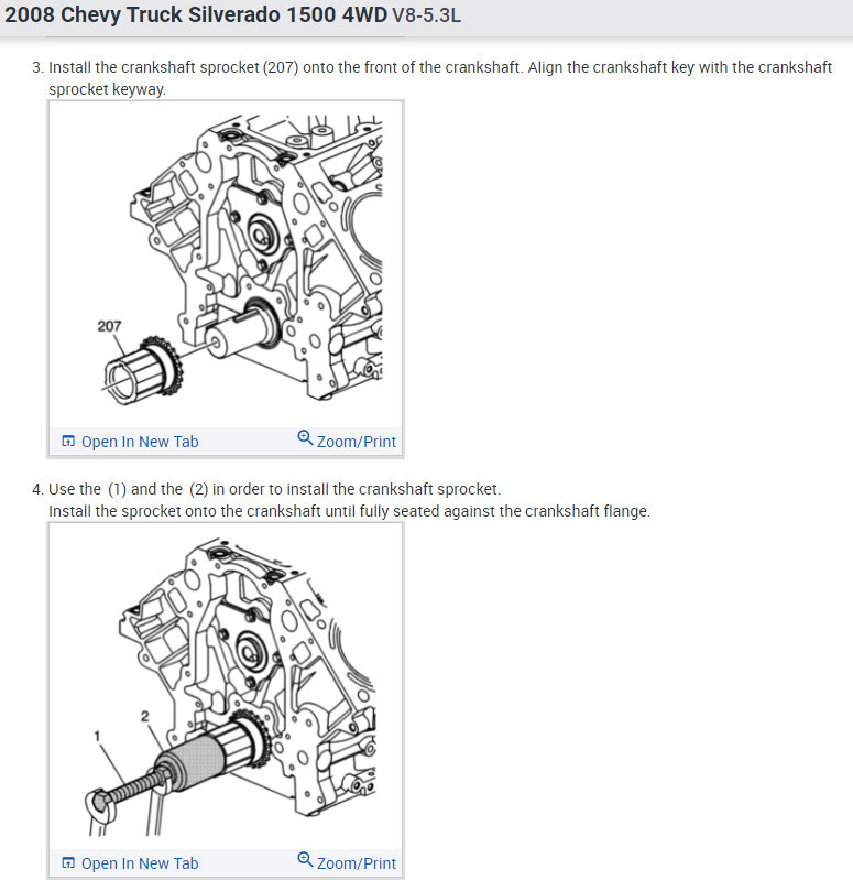

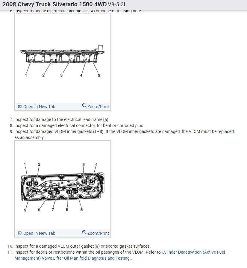

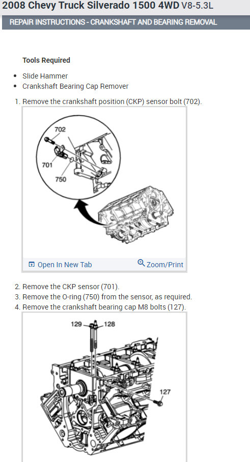

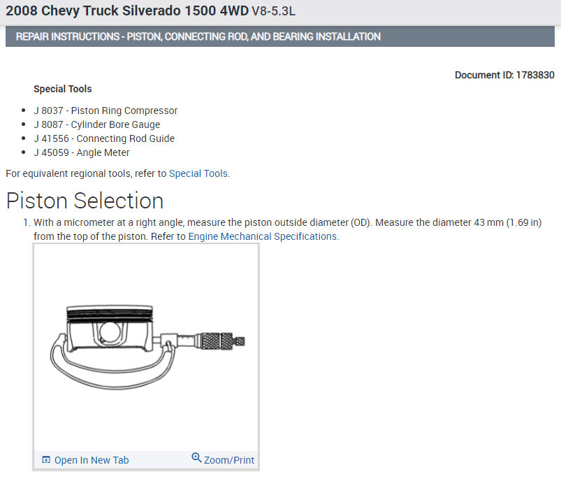

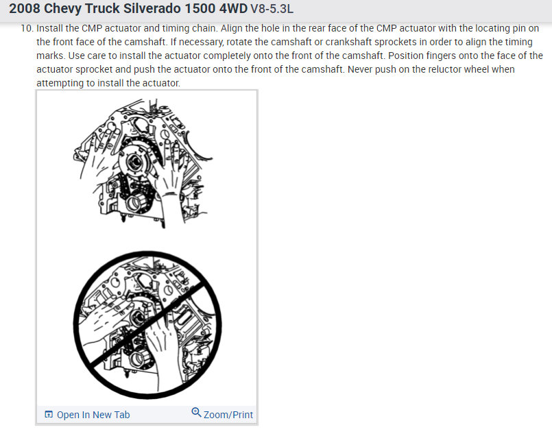

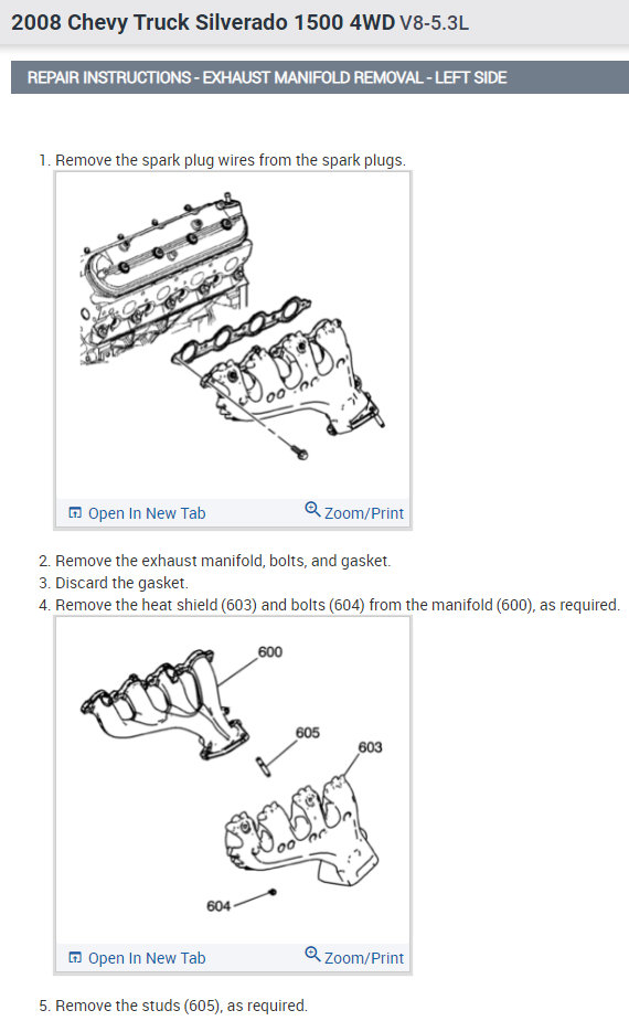

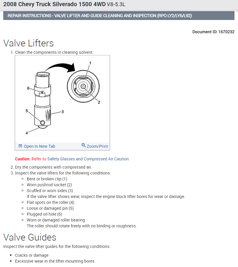

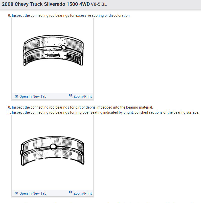

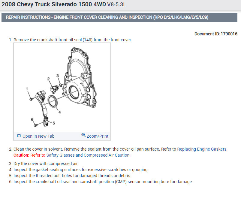

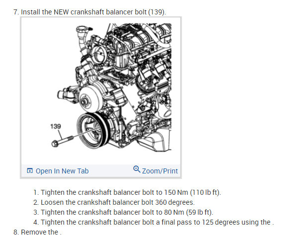

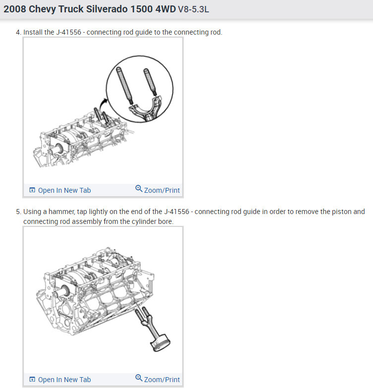

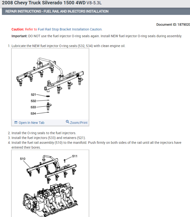

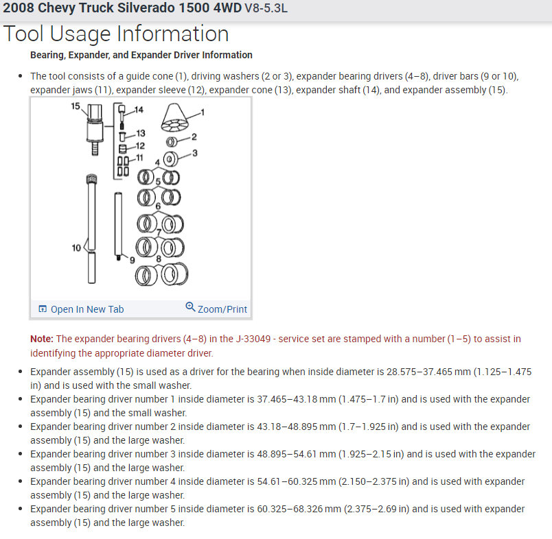

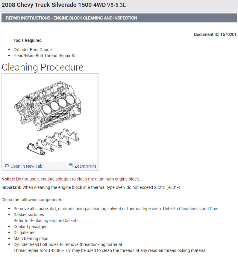

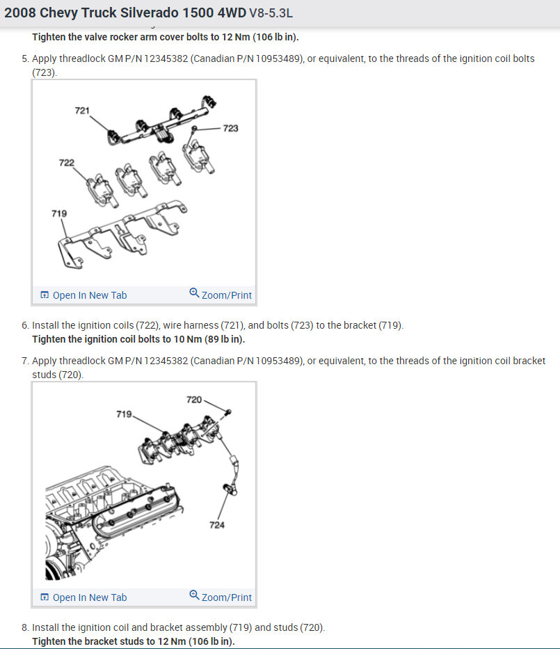

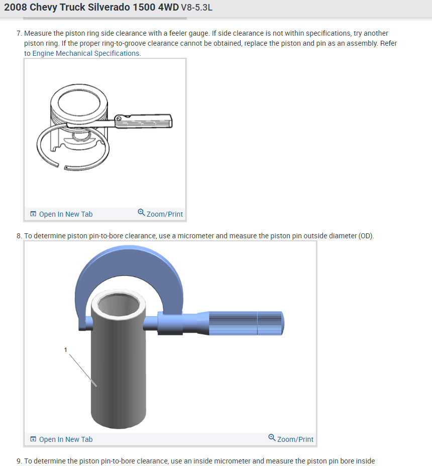

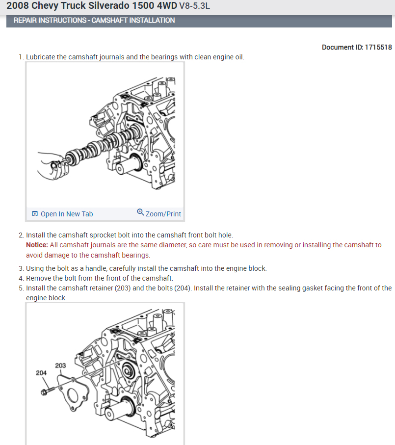

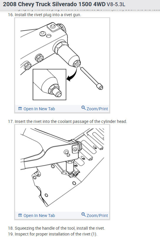

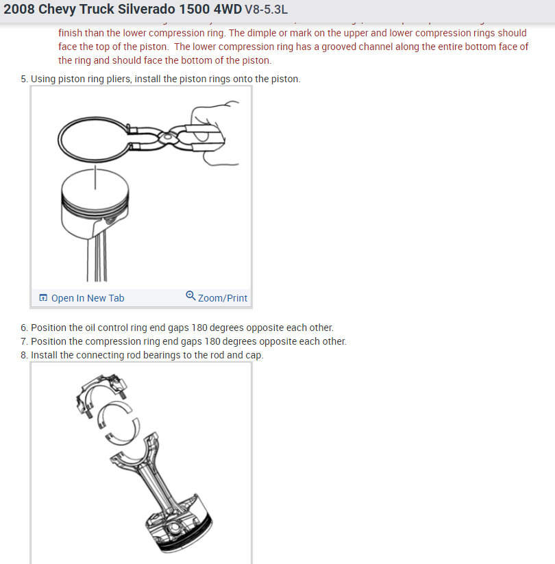

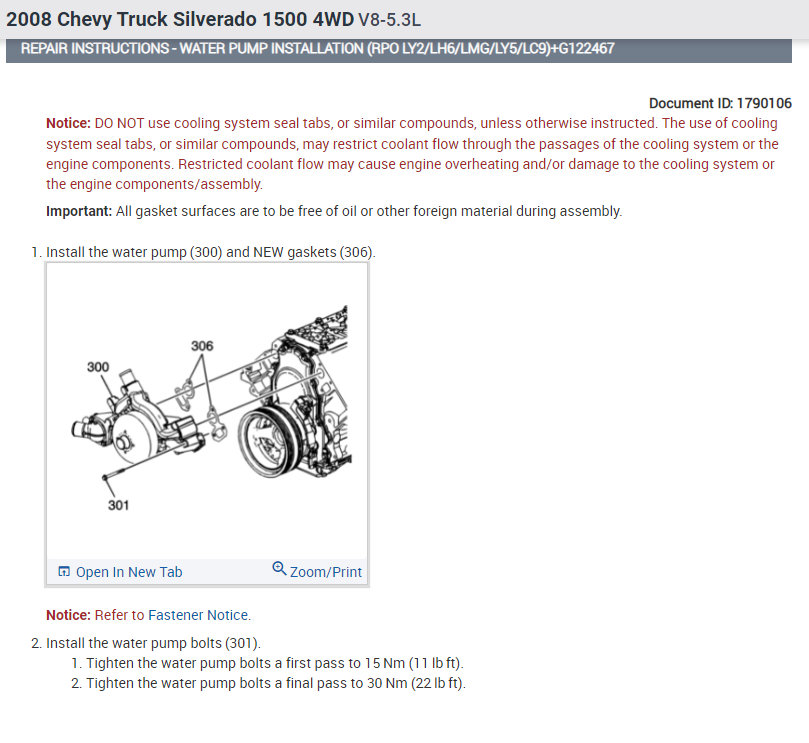

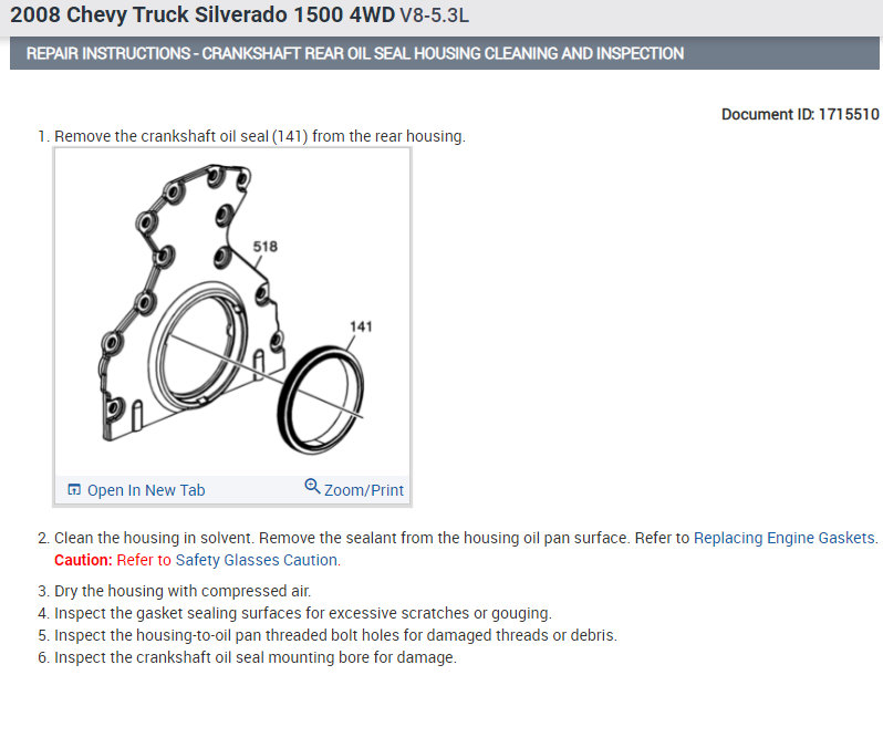

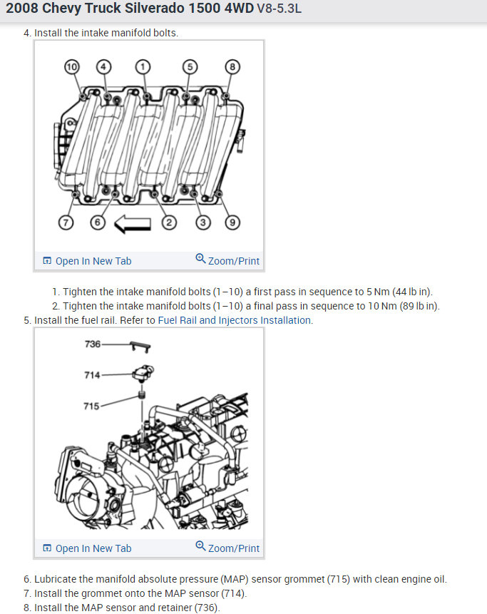

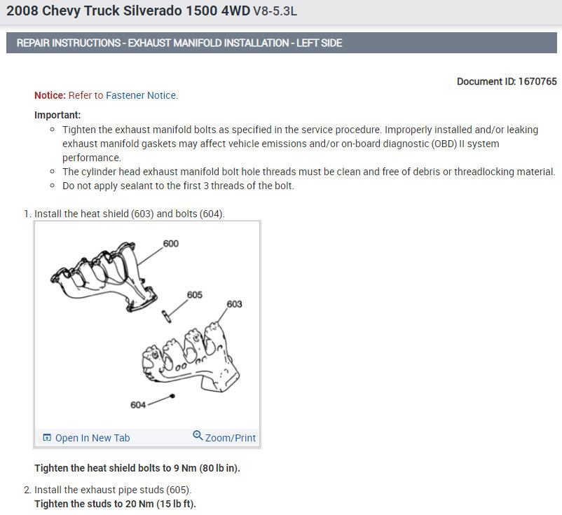

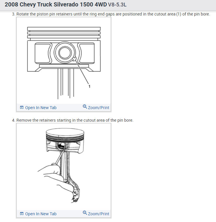

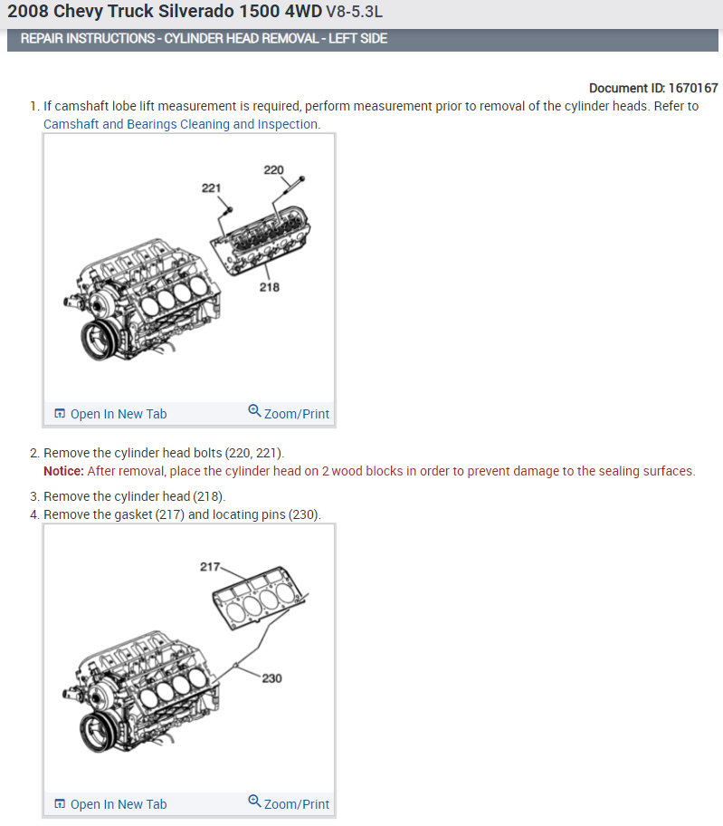

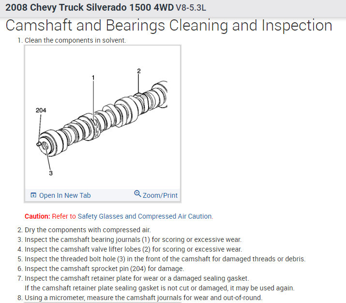

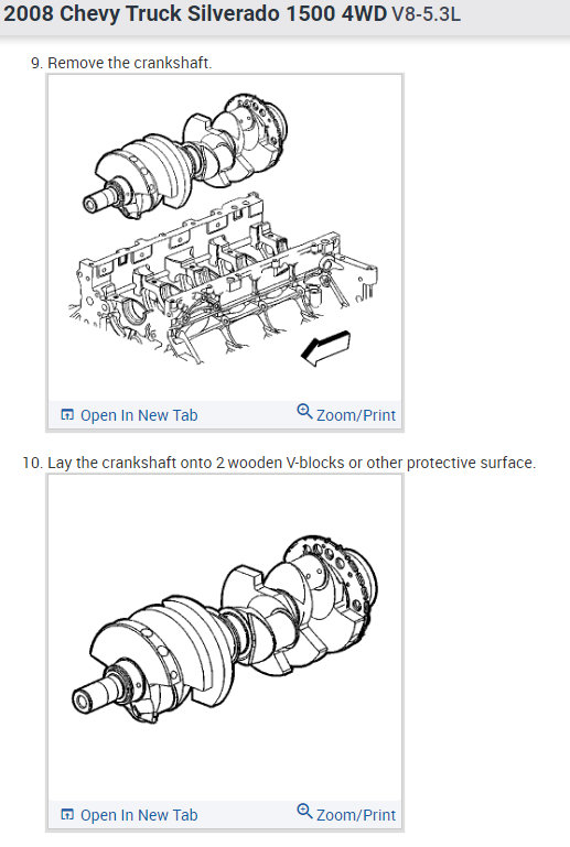

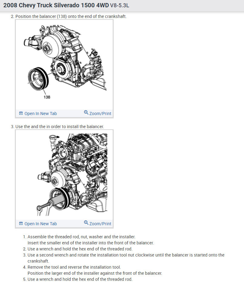

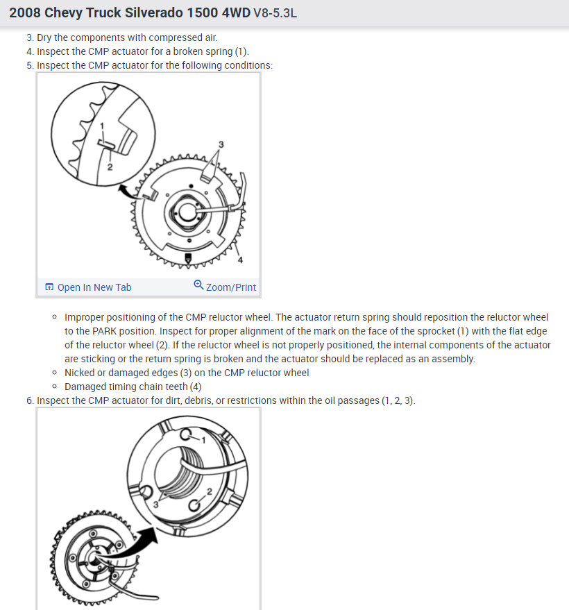

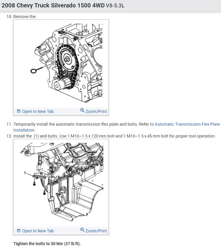

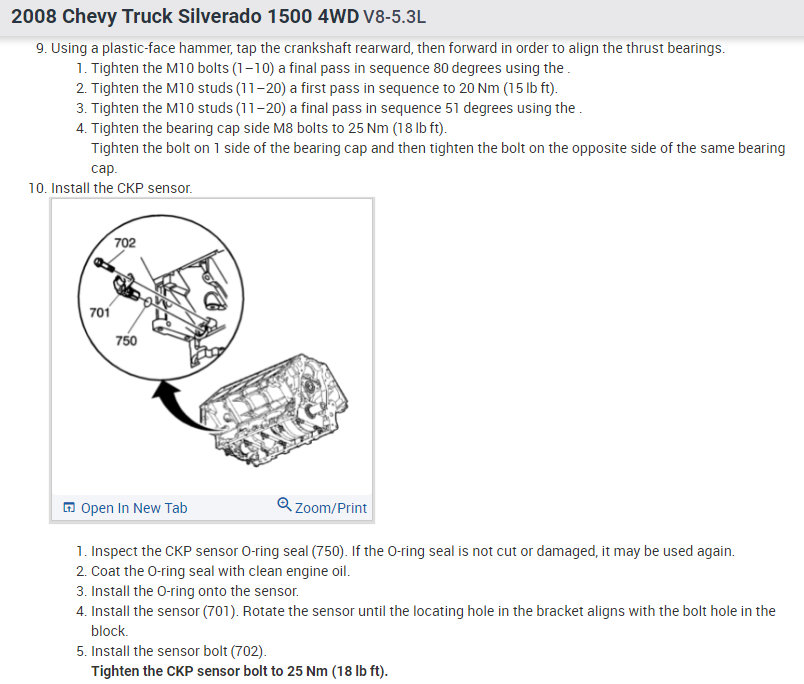

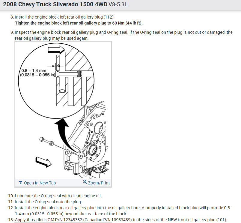

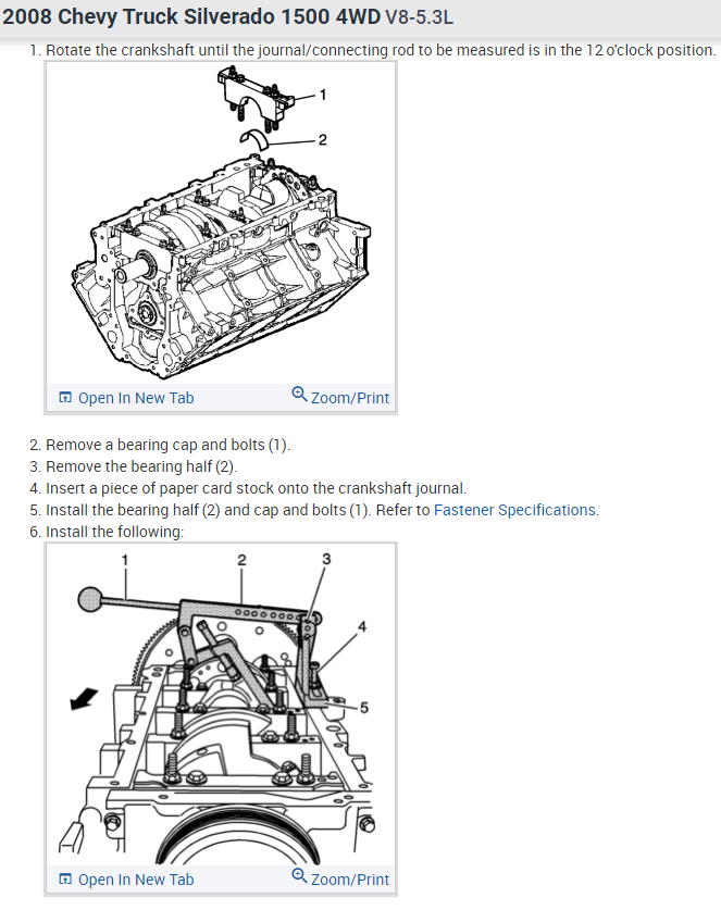

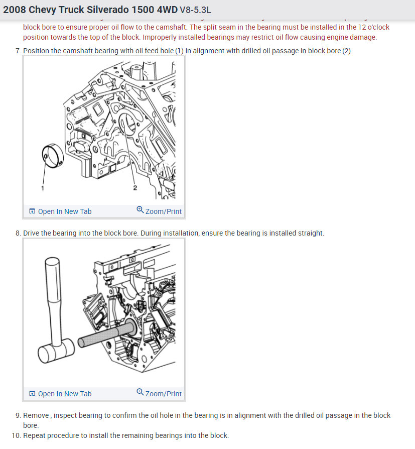

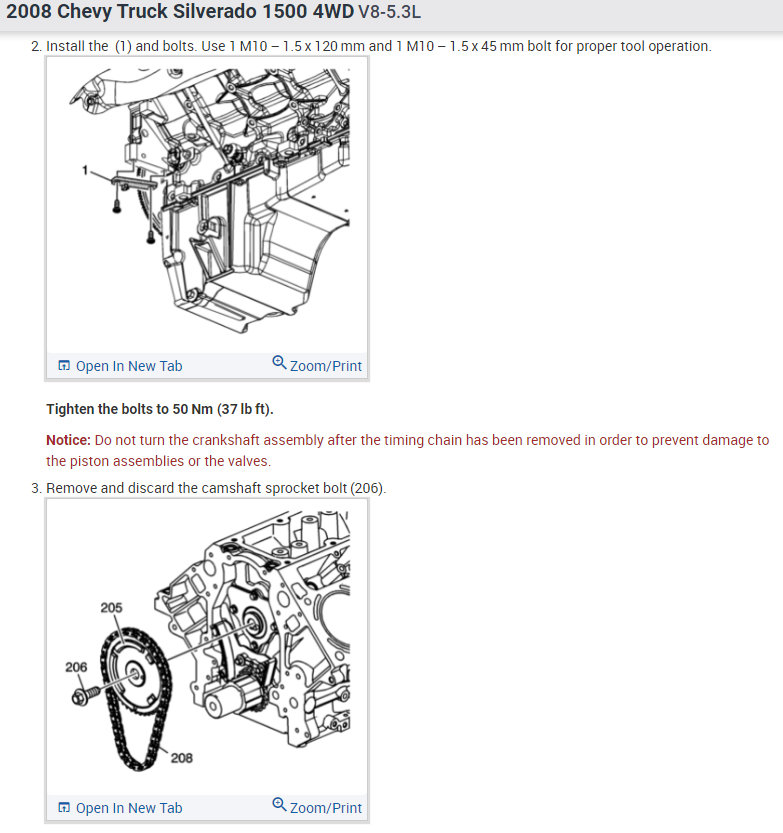

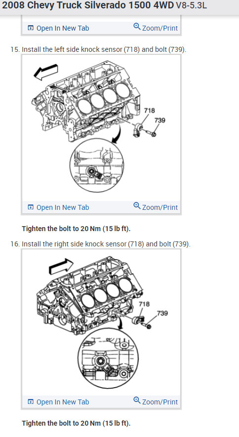

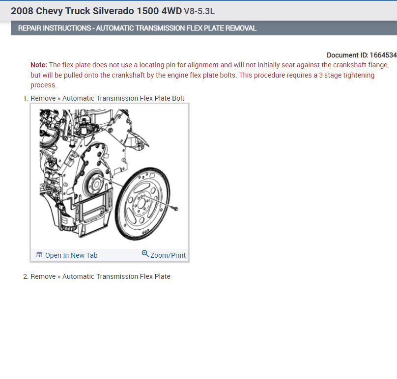

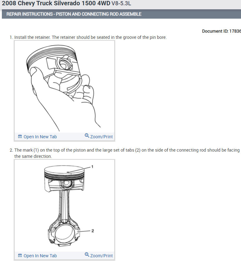

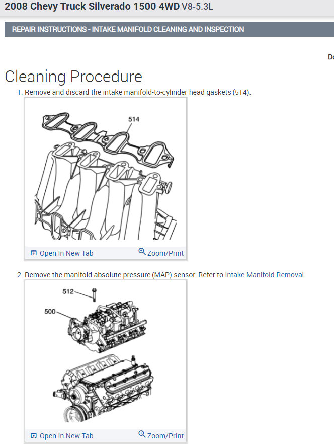

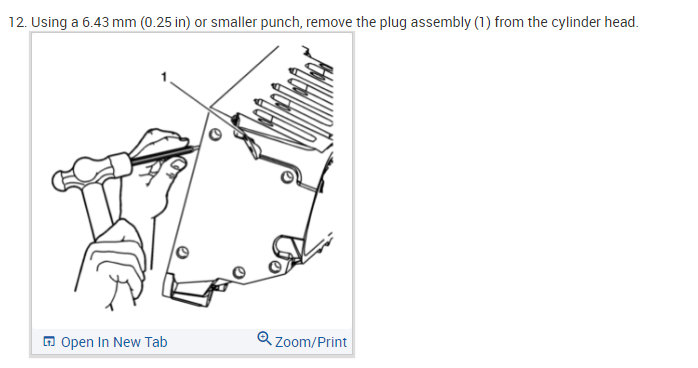

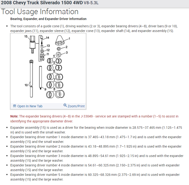

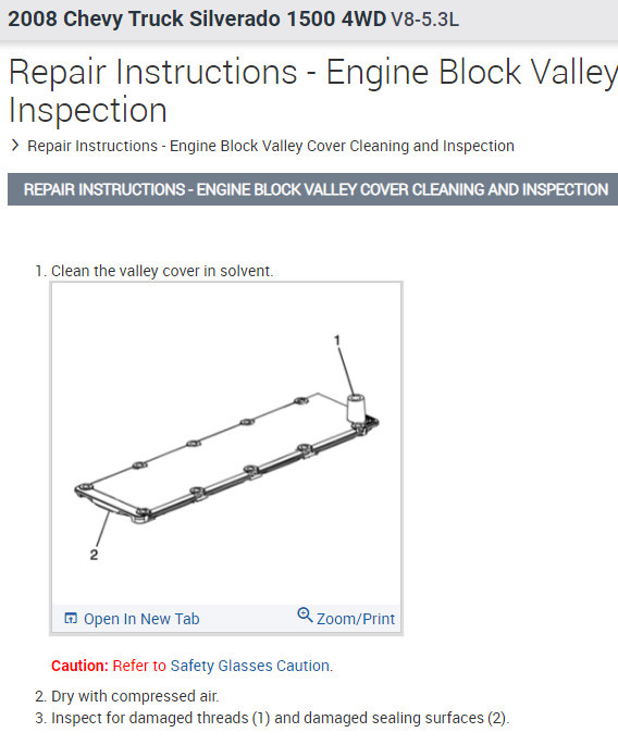

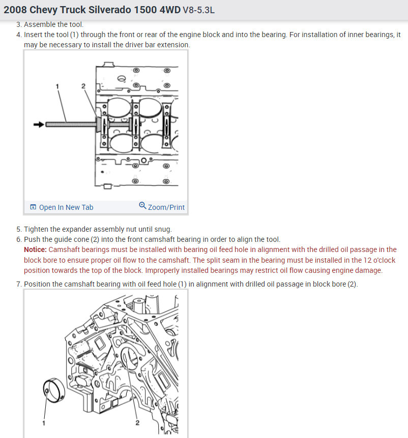

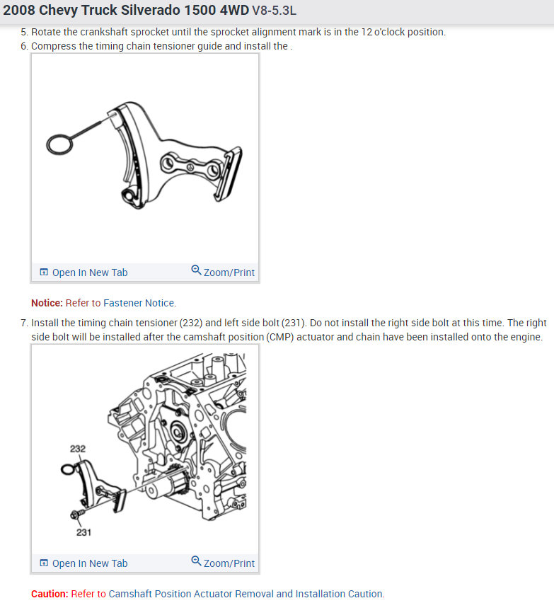

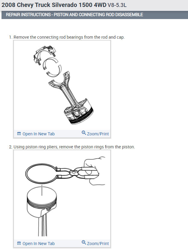

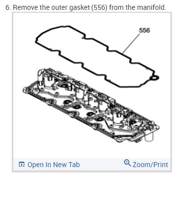

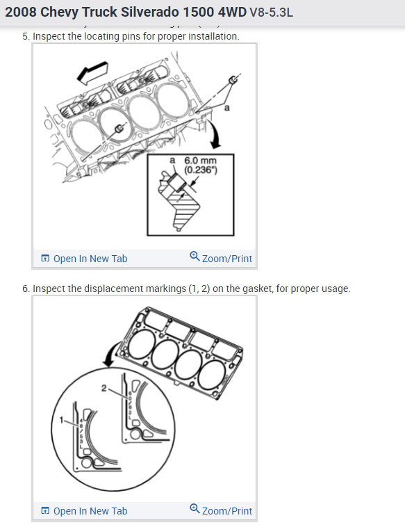

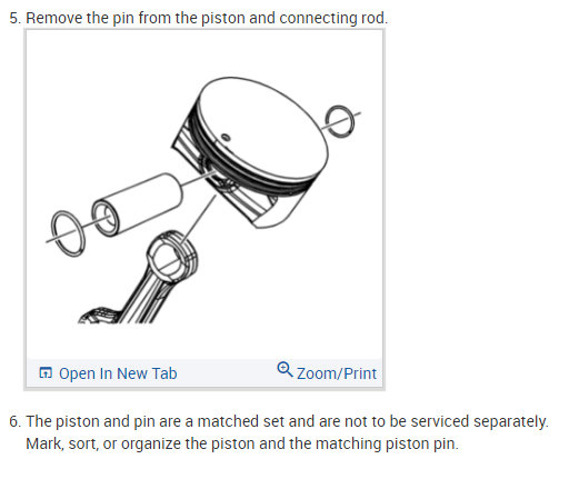

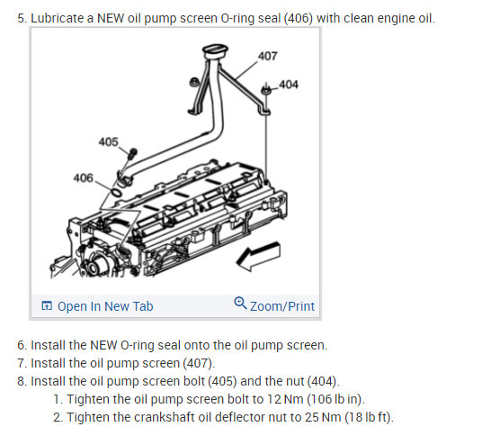

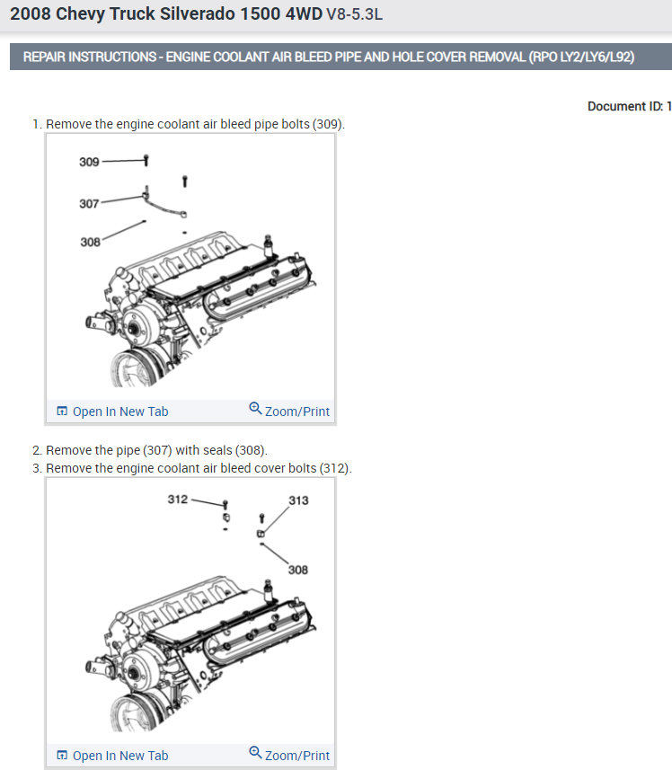

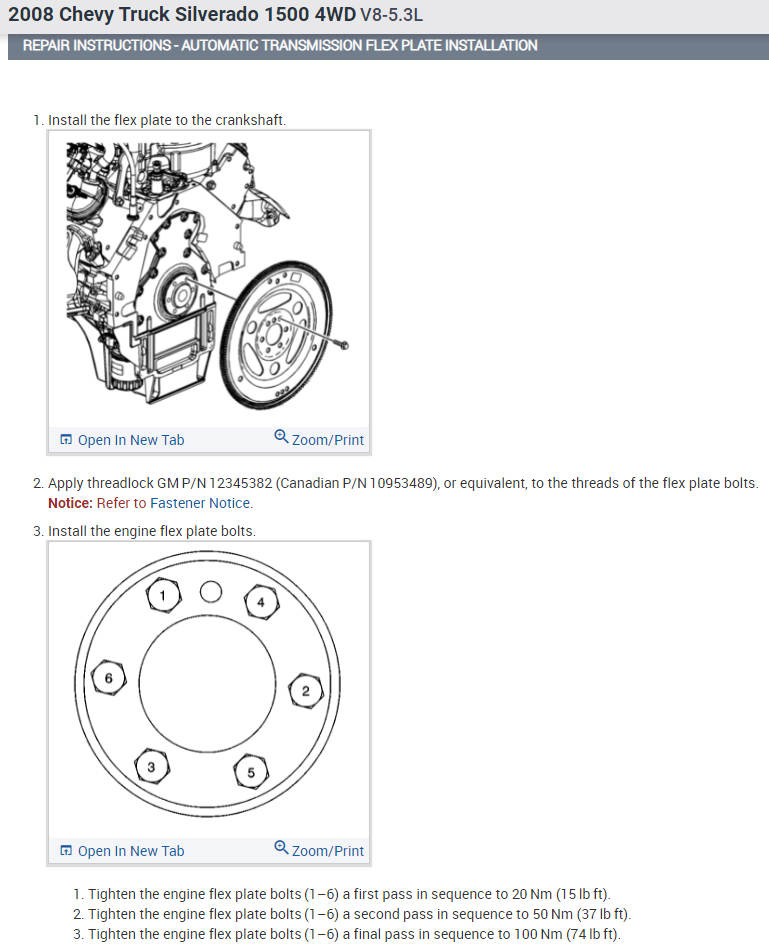

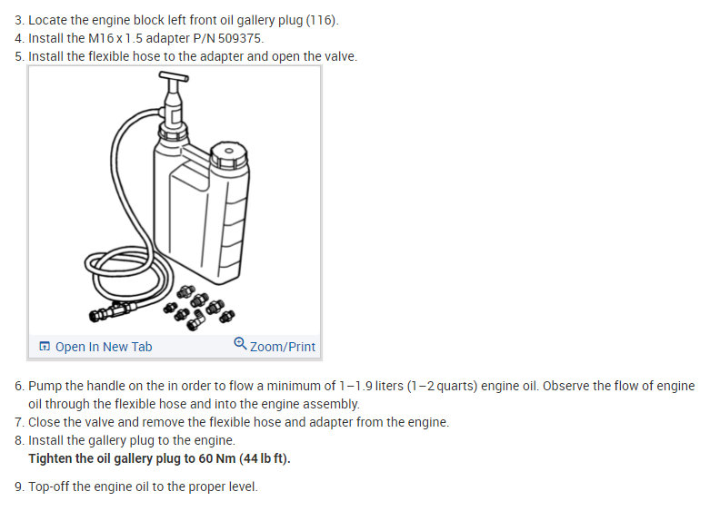

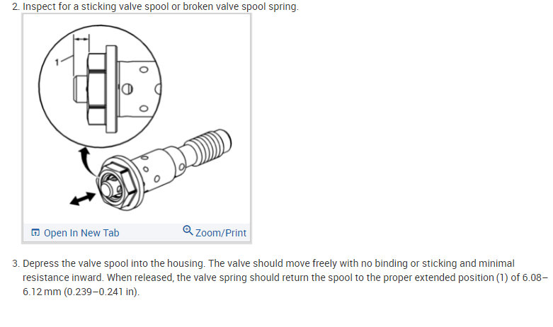

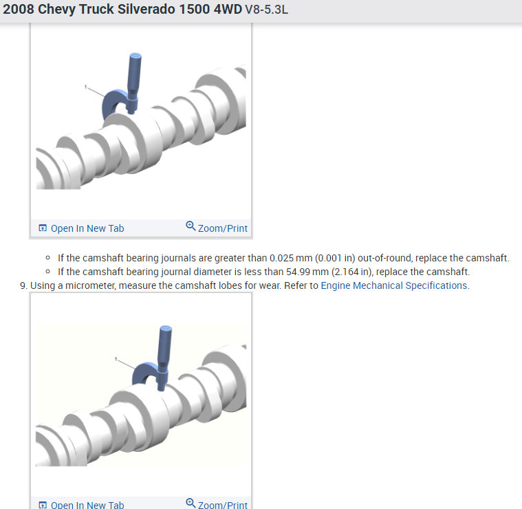

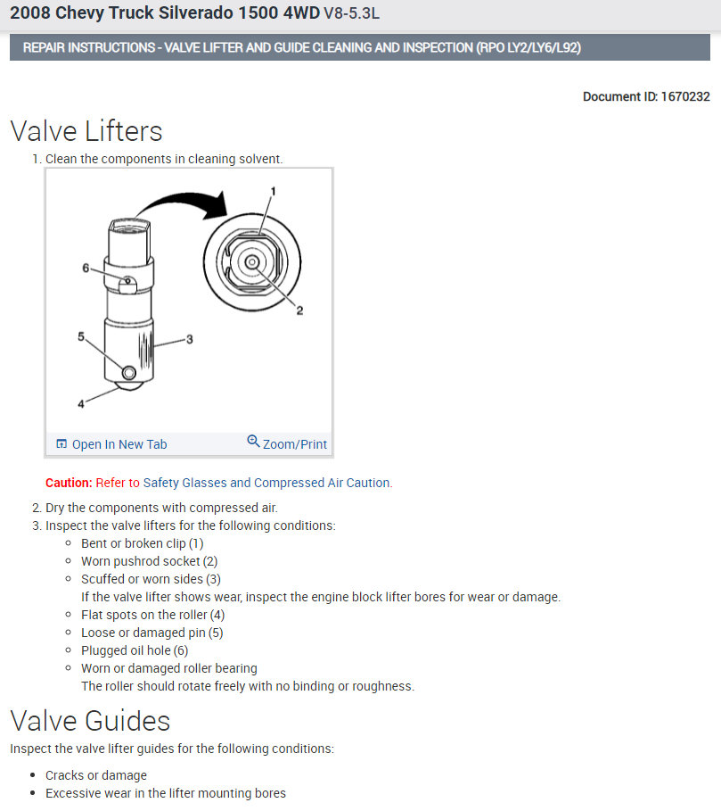

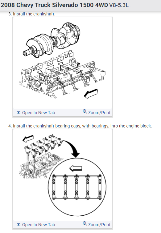

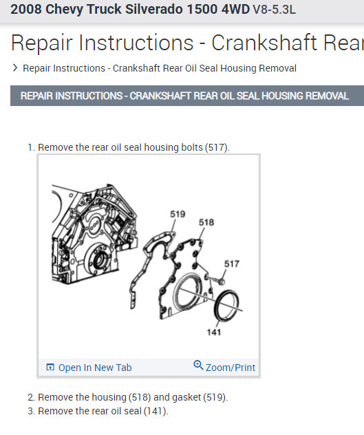

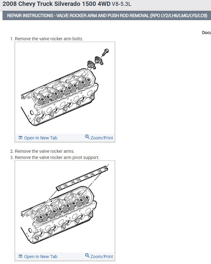

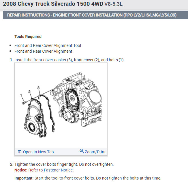

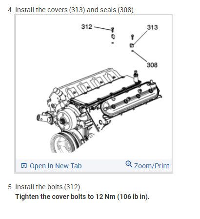

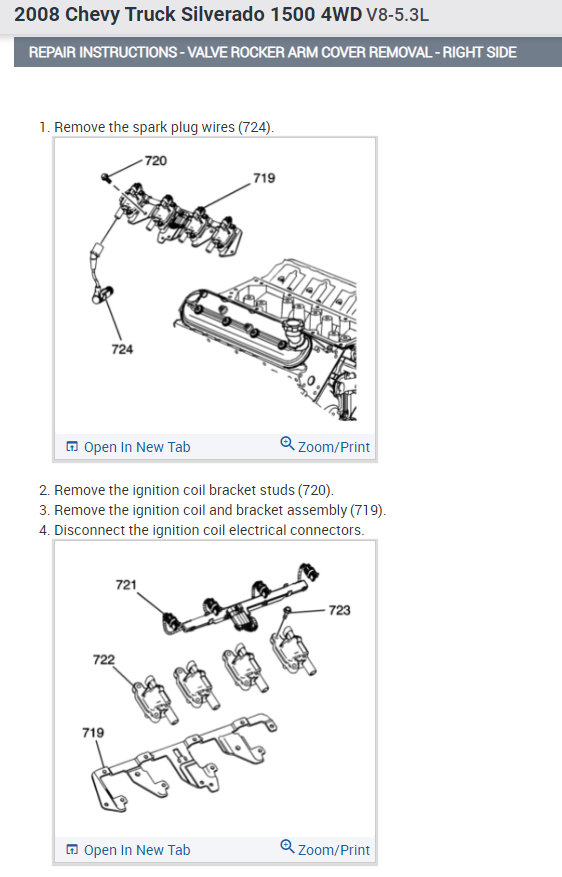

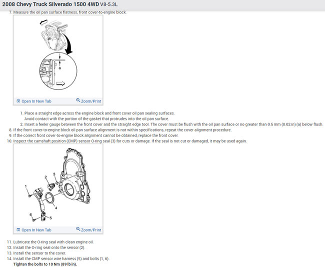

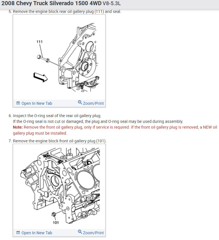

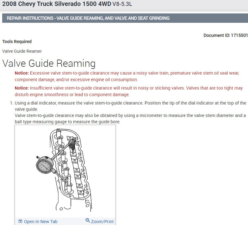

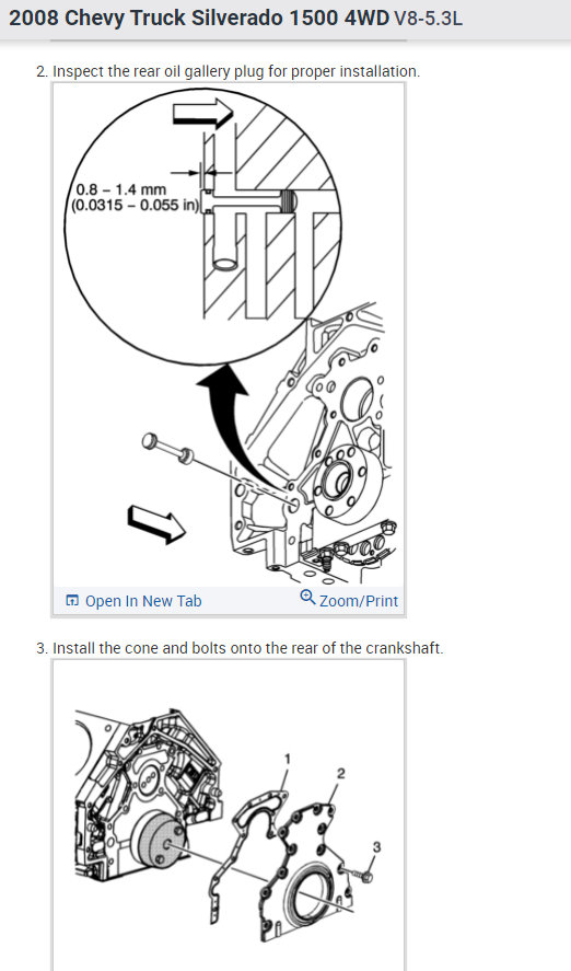

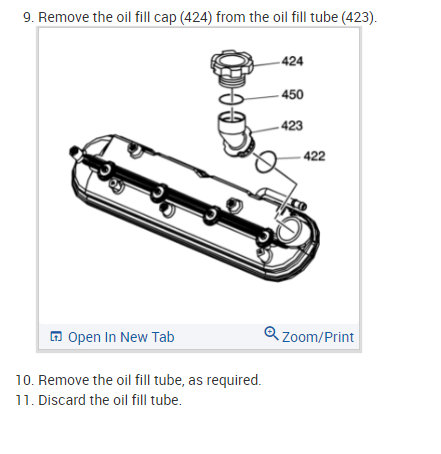

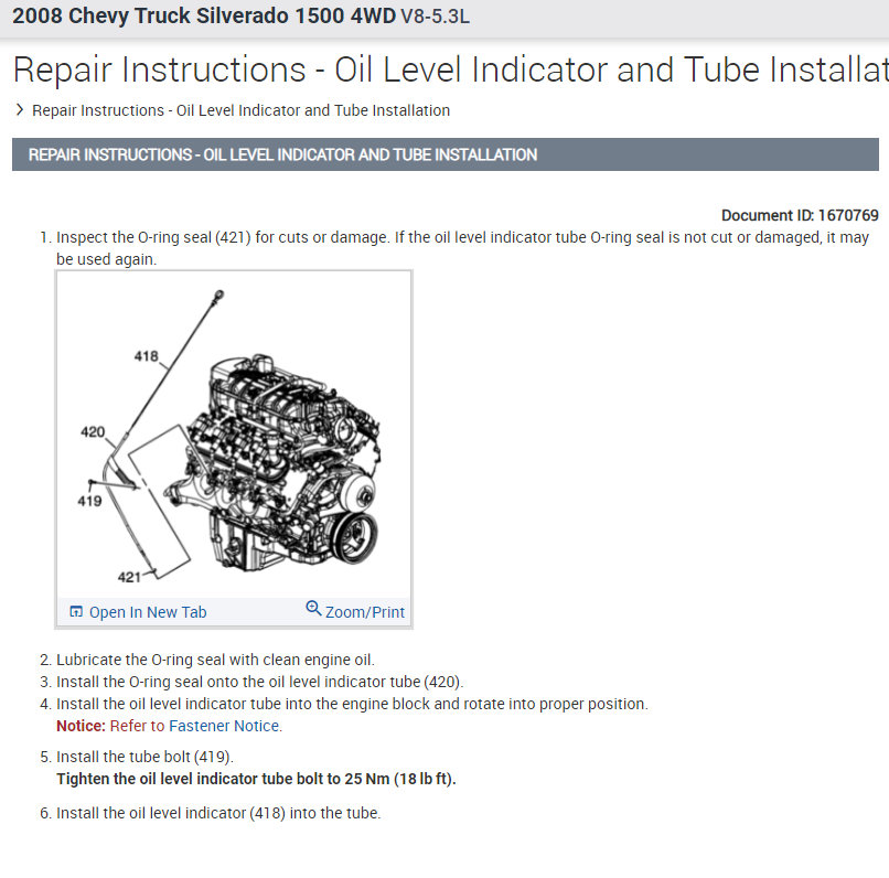

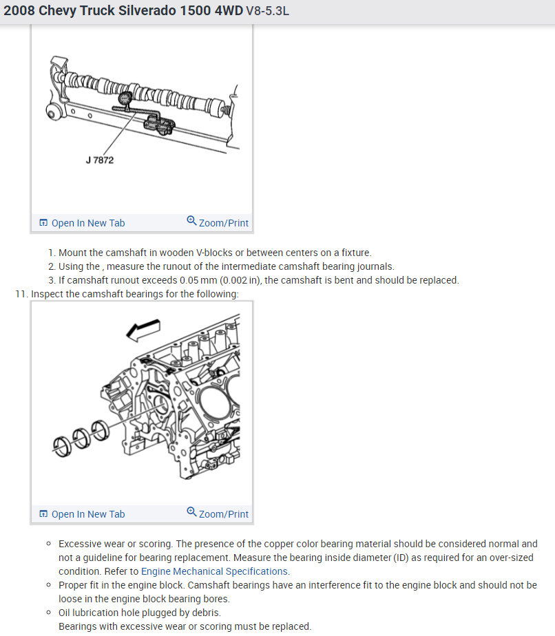

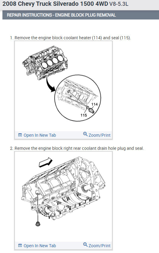

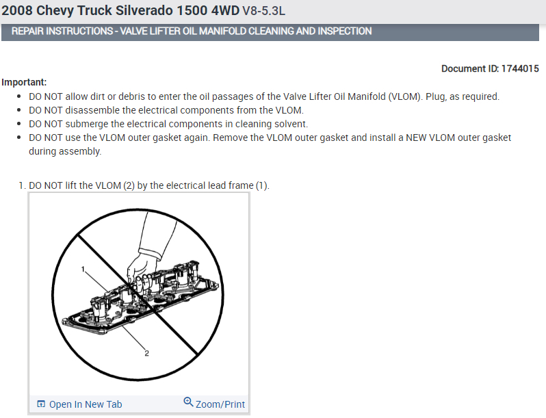

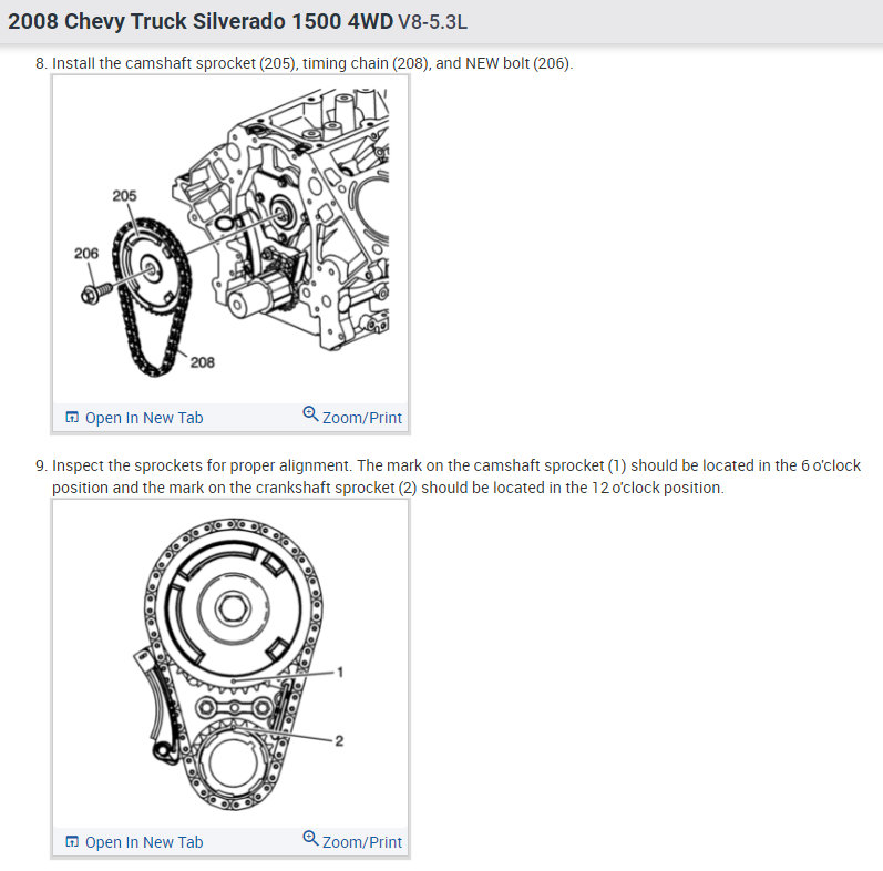

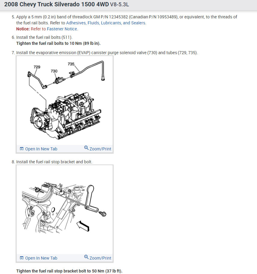

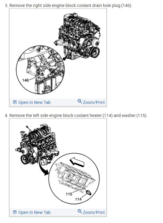

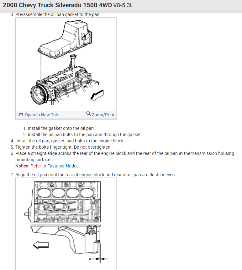

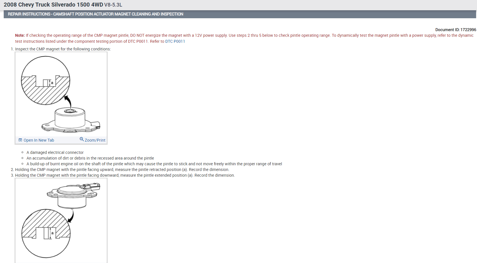

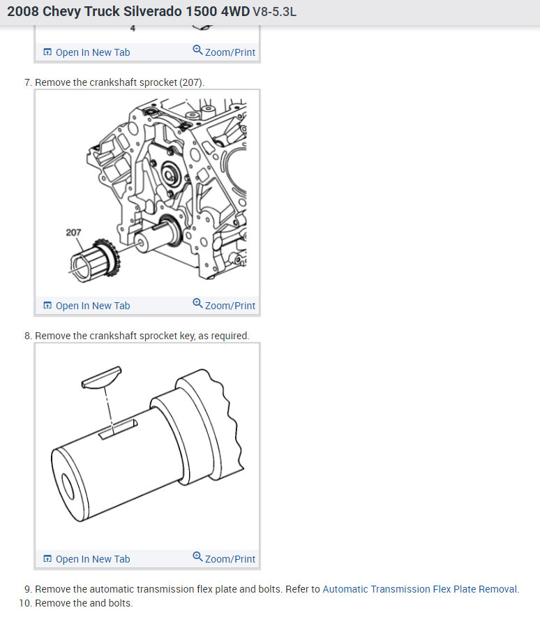

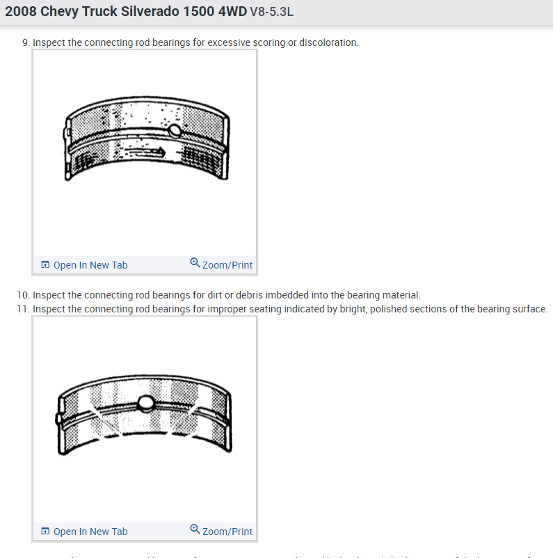

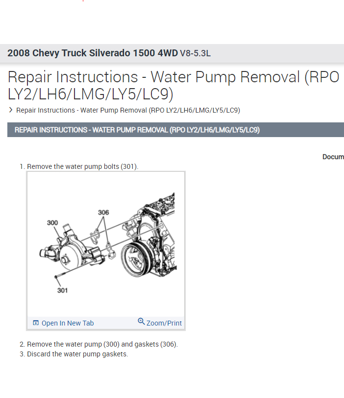

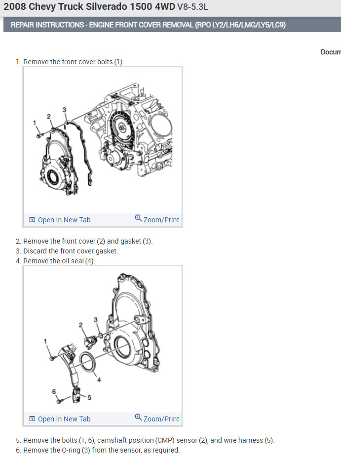

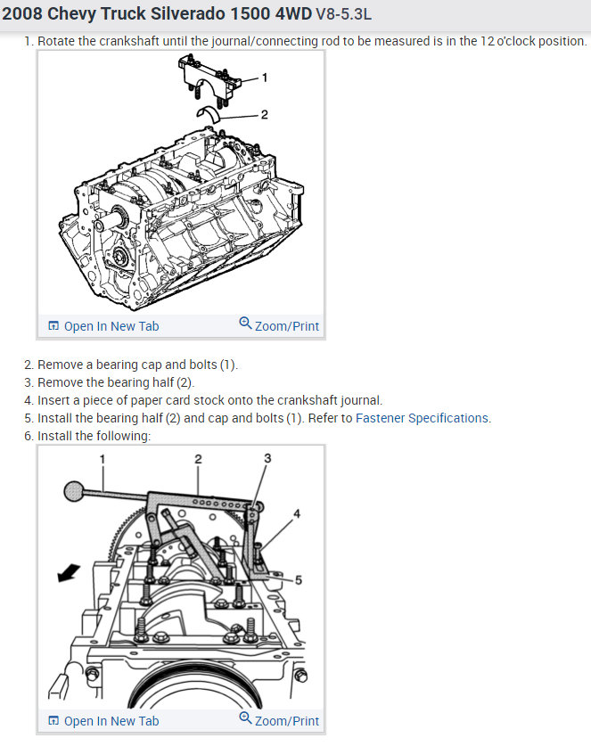

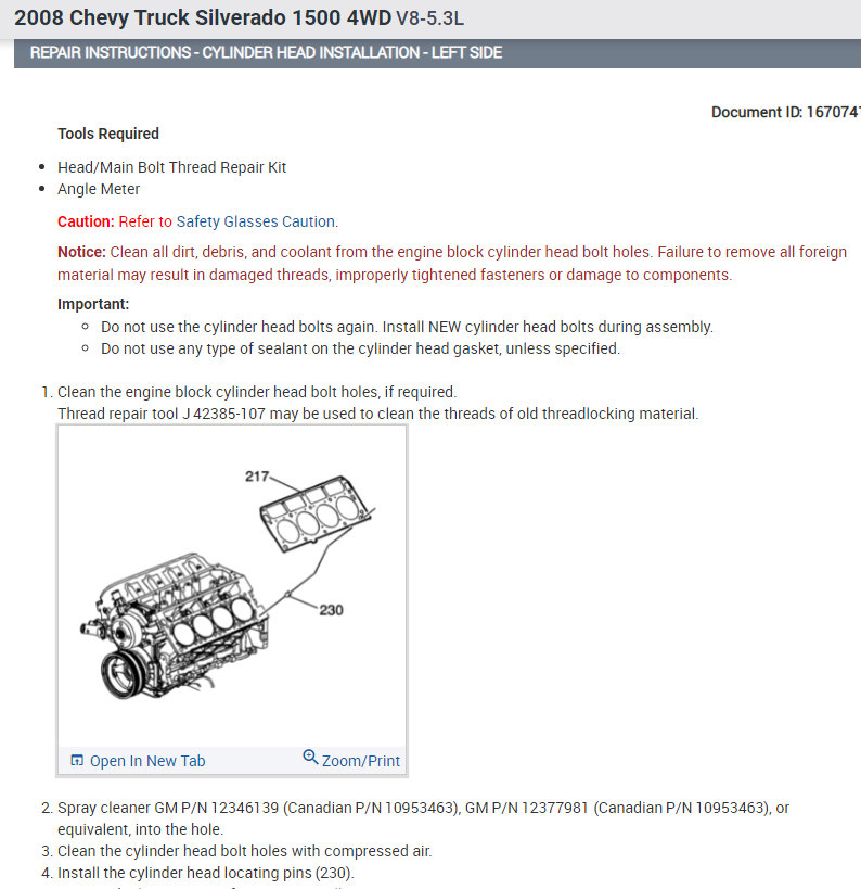

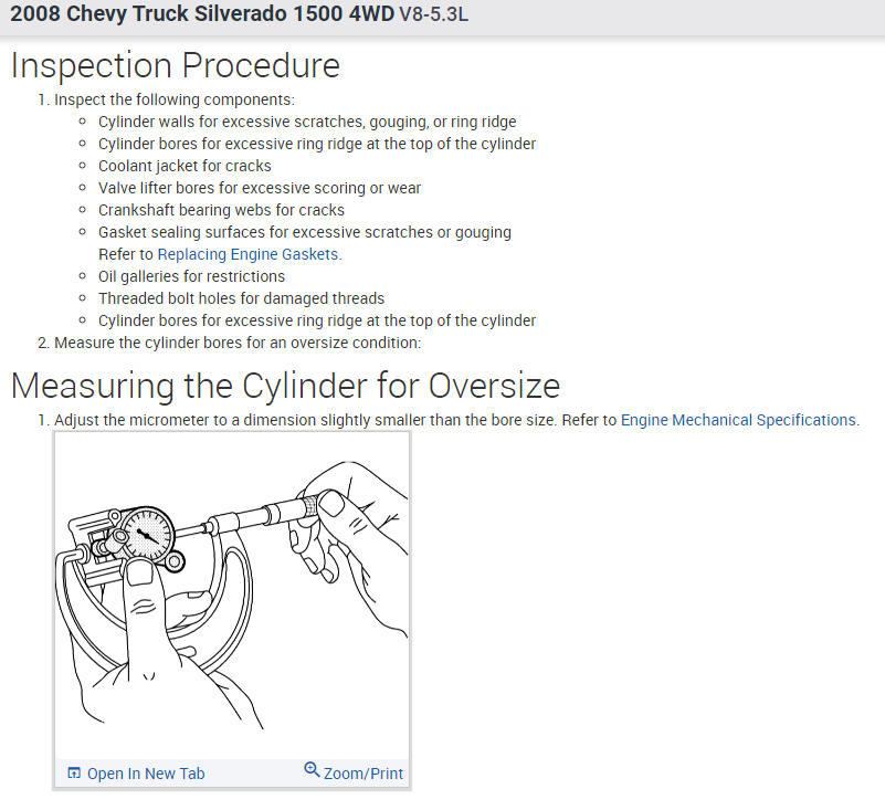

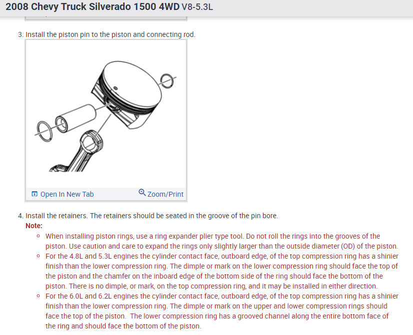

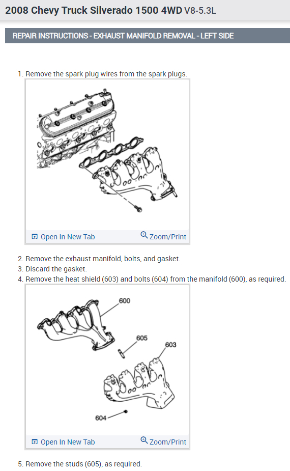

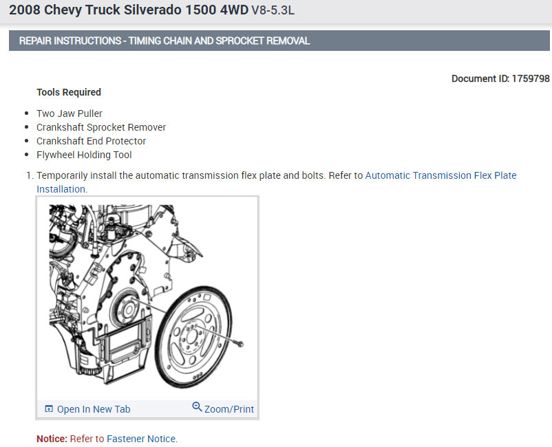

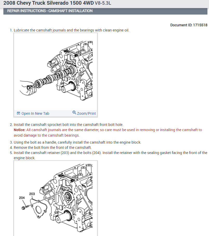

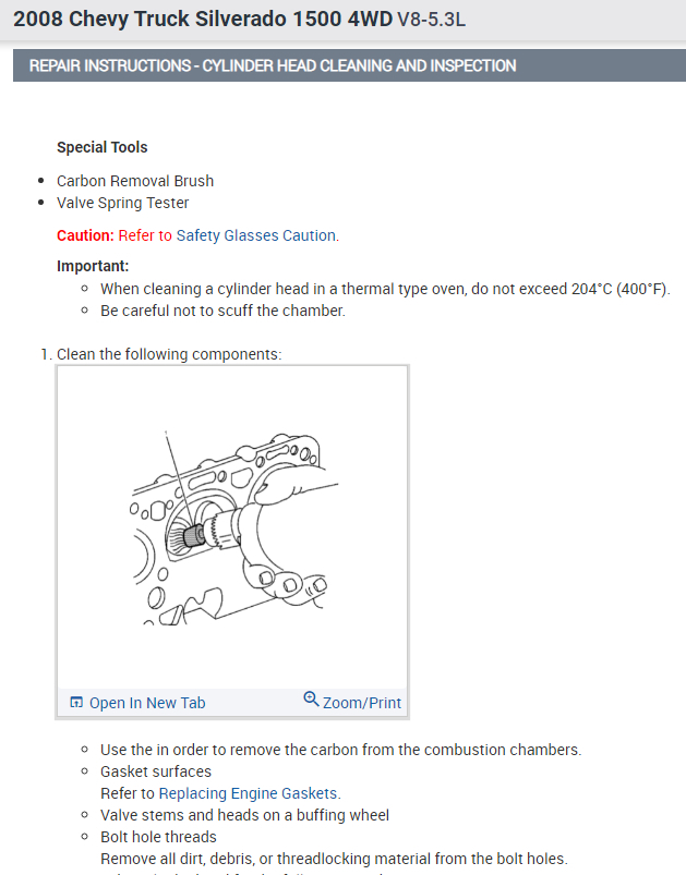

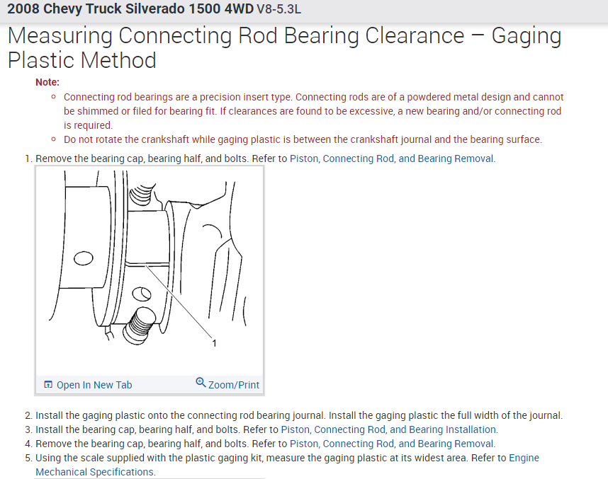

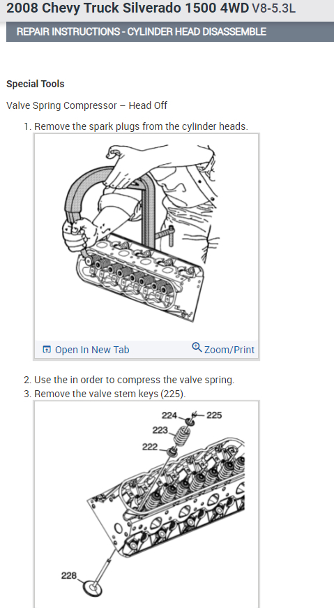

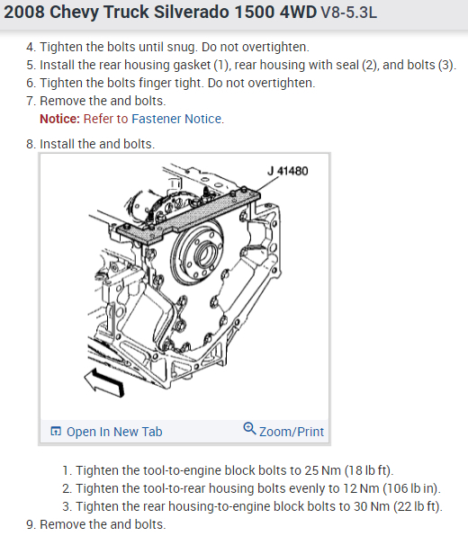

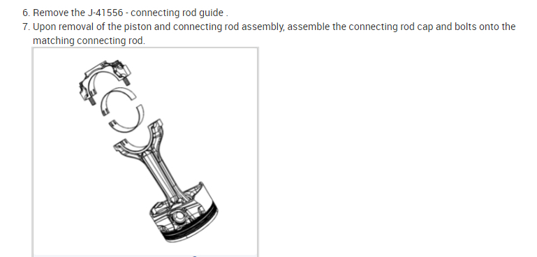

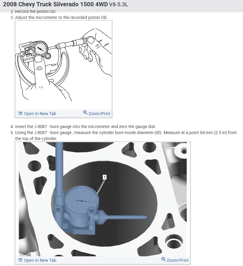

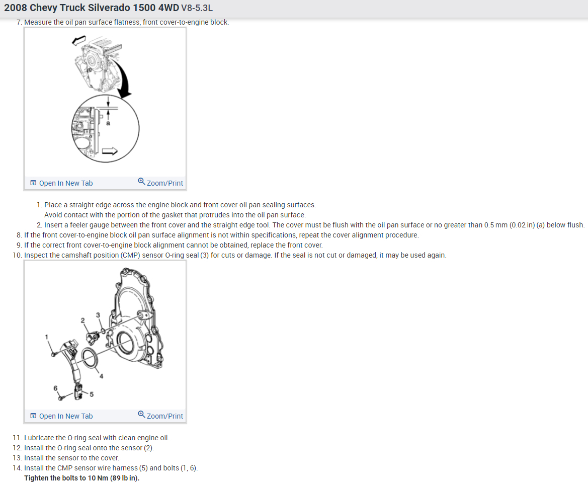

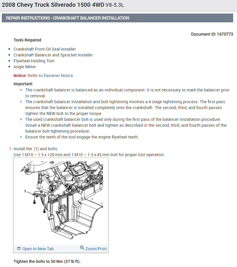

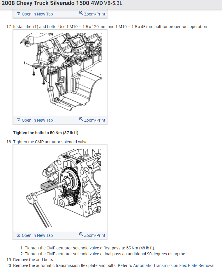

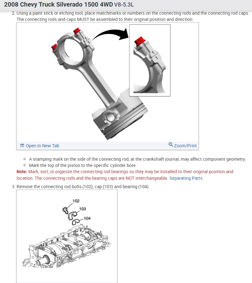

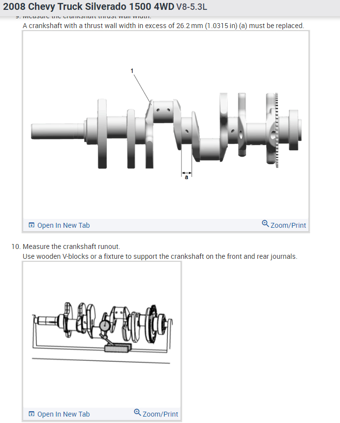

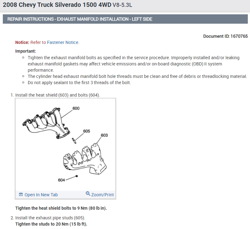

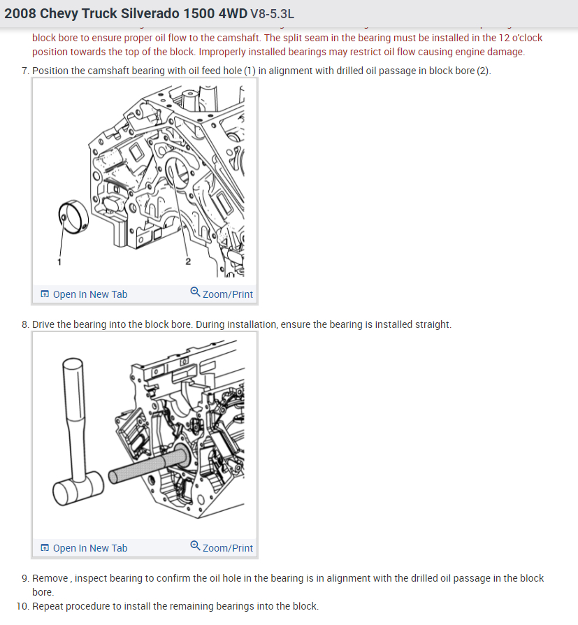

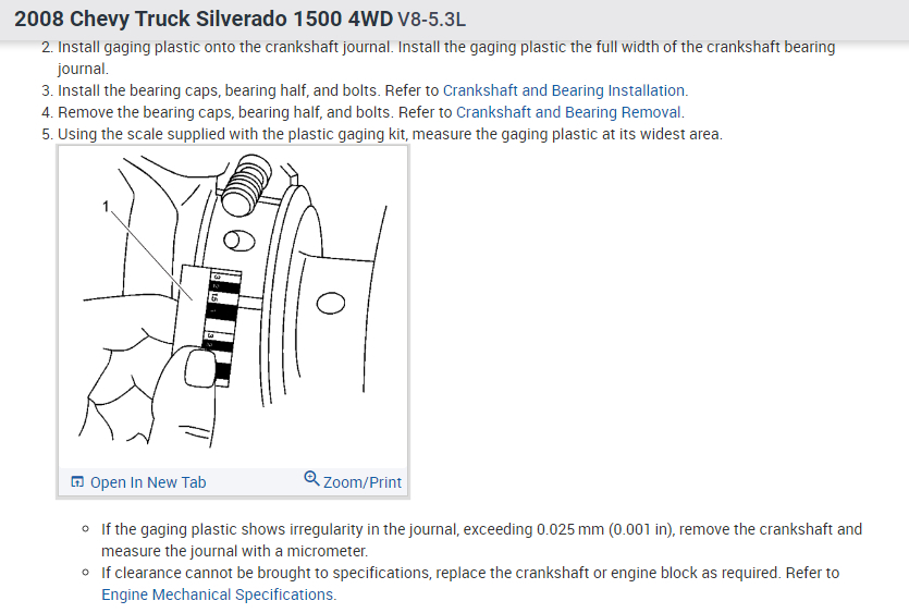

I have attached the complete engine disassembly, cleaning and inspections and assembly procedure. It also contains any torque specifications and sequences.
It is quite a lot of information. Should all be in order.
Let me know if you have any questions.
