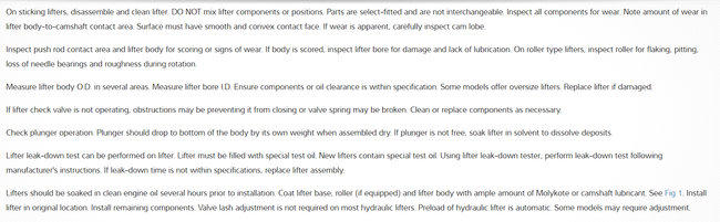

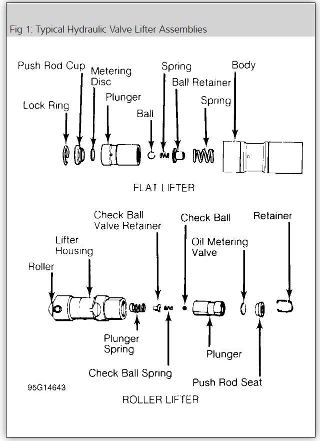

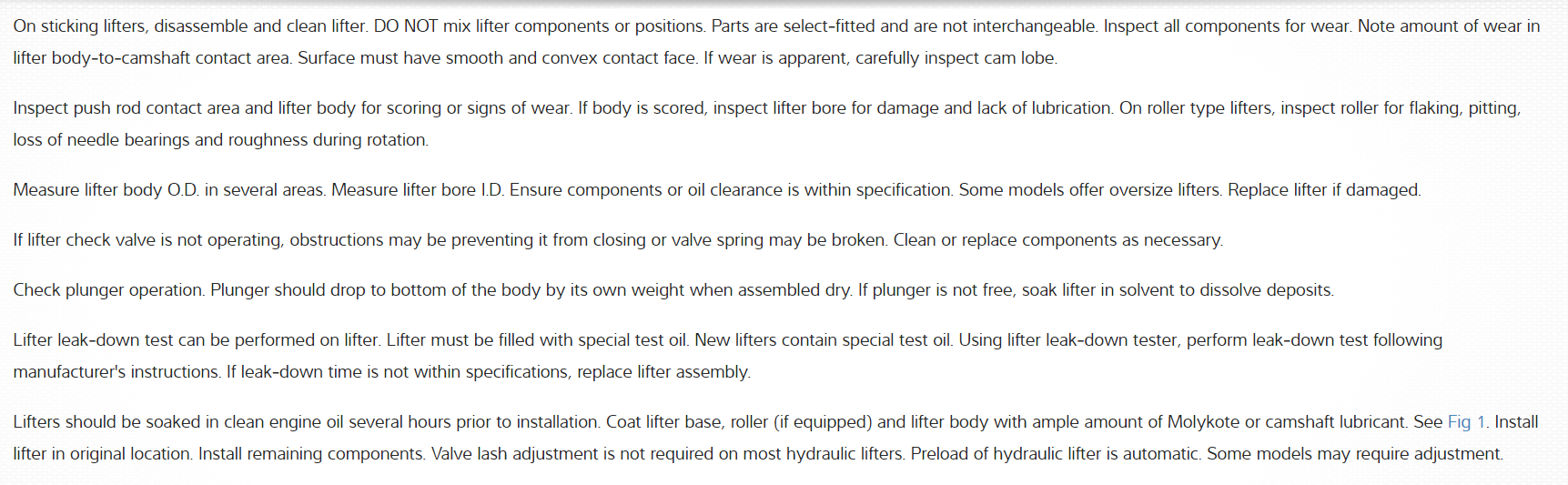

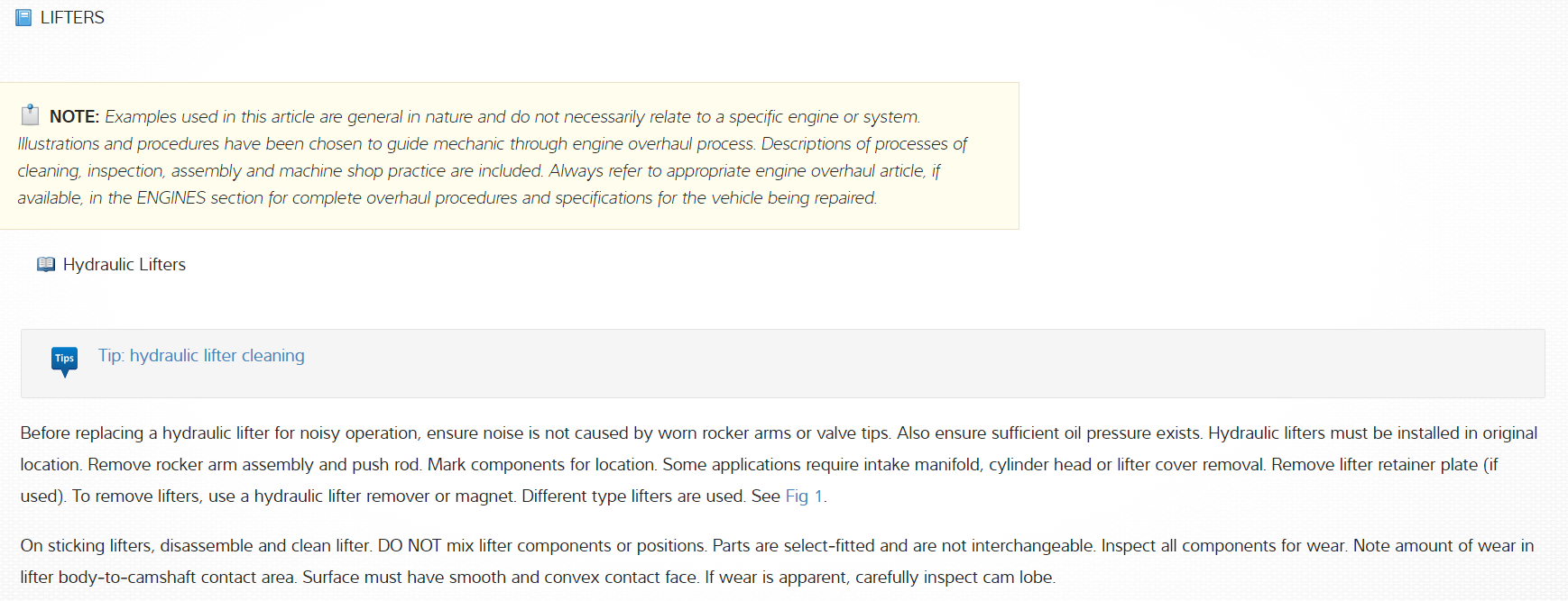

This could be a problem with your lifters. I have included some information for you in the diagrams below. Go through it and let us know what you find out.

I agree with Ken on the oil level. The oil control valve for the variable valve timing will rattle when low on oil. These vehicles do not have lifters. They have little buckets called tappets which run in different sizes. Check your oil level first and maybe do an oil change. You maybe consuming oil already.
