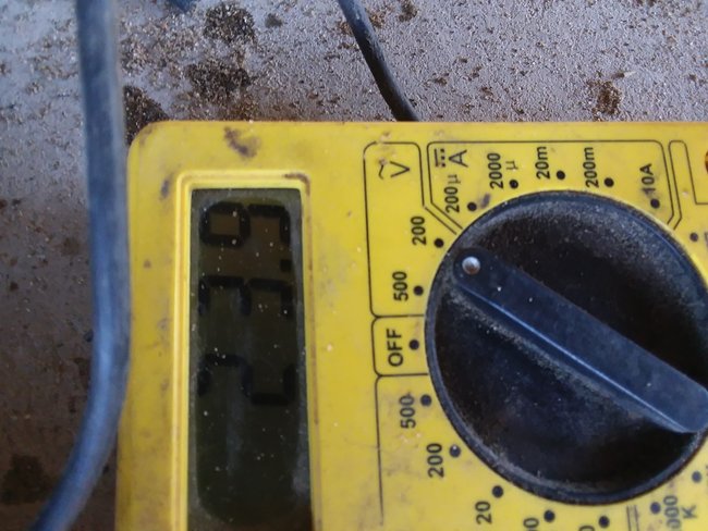

So if the voltage meter is actually working right that I have, there are 27 volts on the hot where the starter connects.
Oct 5, 2018 at 3:06 AM
MLONG98
  • 79 POSTS
Another thing that is making this more difficult, I cannot have the car's computer read because my grandfather hardwired the inside fuse boxes years ago, and he has passed away so I cannot get help from him to undo it all, but it ran for years without making the service engine light come on.
Oct 5, 2018 at 3:12 AM
You cannot have more than 12 volts in the system unless the alternator is working.
Oct 5, 2018 at 3:16 AM
MLONG98
  • 79 POSTS
23.9 with the second rig off but still connected to the car.
Oct 5, 2018 at 3:21 AM
MLONG98
  • 79 POSTS
The car's battery straight off of each post reads 11.9, yet everything on the car is about dead.
Oct 5, 2018 at 3:24 AM
You are on AC scale. Switch it to DC.
MLONG98
  • 79 POSTS
I have confirmed my voltage meter does not work.
Oct 5, 2018 at 3:26 AM
Okay, see if you can get one that works.
