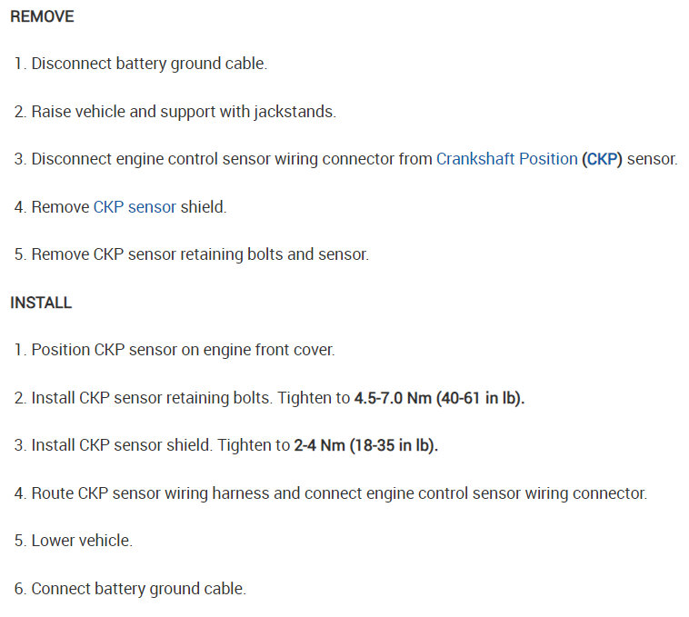

This could be fuel or spark but since the fuel pump was replaced, I am leaning towards the ignition system. To see which one is which when the engine doesn't start lift the hood and spray some starting fluid inside the air filter to see if it will run for a second or two, if not then this video will show you how to check for spark:
https://youtu.be/baq_aEWNQ0Y?si=OTX7Xg1zgsiG4jbn
If no spark is confirmed let's run the codes which can be done by following this guide:
https://www.2carpros.com/articles/ford-lincoln-mercury-obd1-1995-and-earlier-diagnostic-trouble-code-definition-and-retrieval

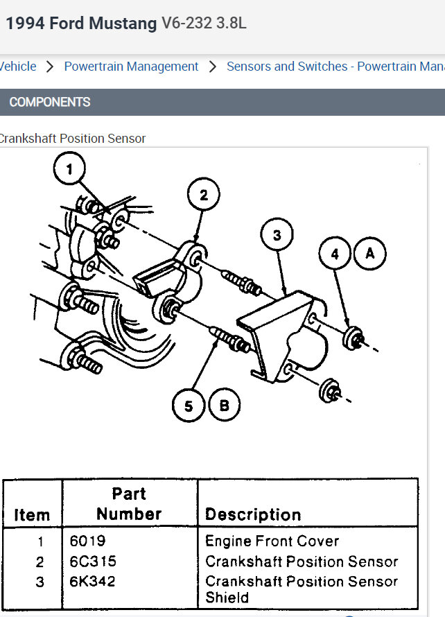

If no codes are present, I would replace the crankshaft angle sensor which will not leave a trouble code when bad. Here is the location of the sensor so you can swap it out.

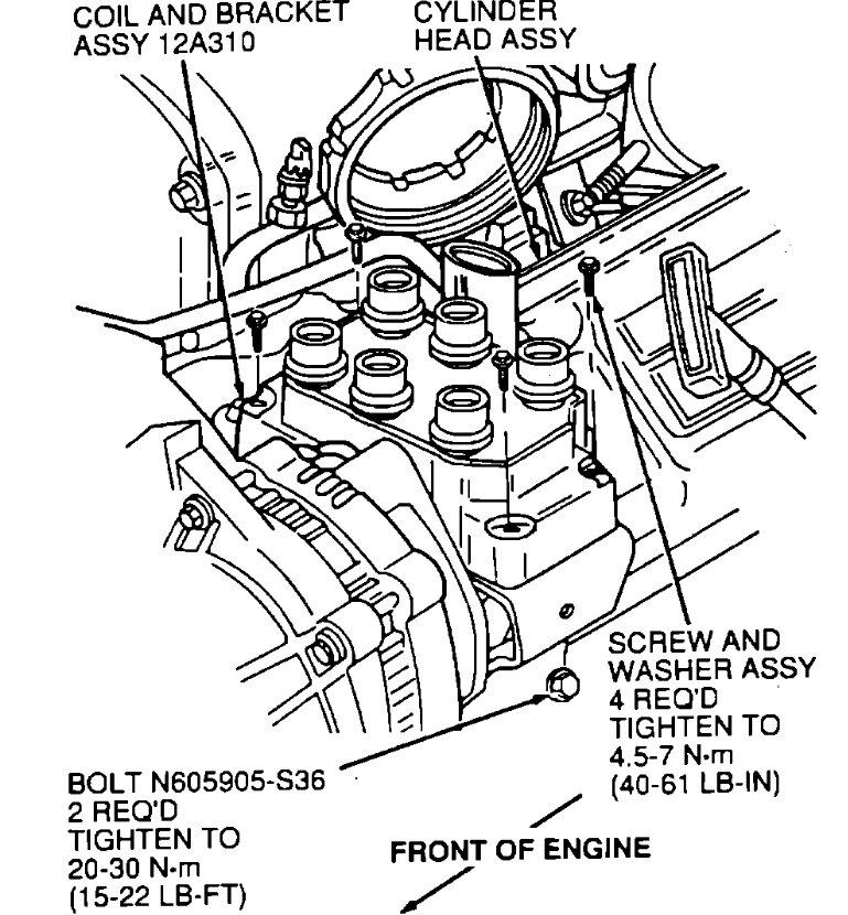

can a bad coil fluctuate?
Jul 19, 2024 at 11:47 AM
  • 55,402 POSTS
Yep, it sure can. These coils have a tendency to go out as well. Check out the images (below). Please let us know what happens.

took the car to the mechanic and he informed me that because my 3.8 ford engine had a distributor that it would not have a camshaft position sensor. He replaced the coil and then same issue. He then replaced the distributor and still the same issue.
Is there a different solution? thank you

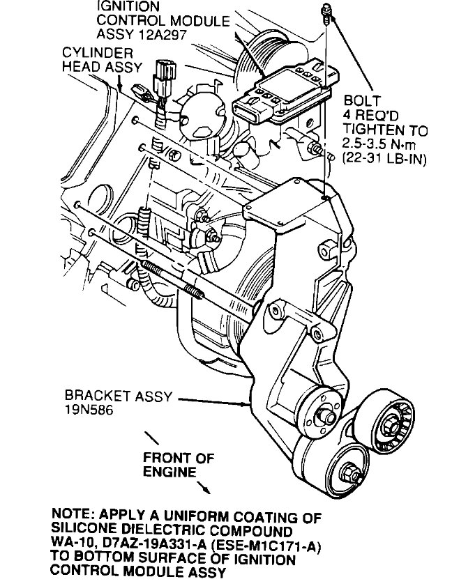

This must be a mid-year split, which can happen. the ignition module can go out and cause this problem, as well, did you run the codes? Here is the location of the ignition module, I would use starting fluid when the engine stalls to see if it starts up again. This will help us see if the problem is fuel or spark.

You said you used a scanner? You will need an OBD-I compatible scanner designed for Ford vehicles. Is this what you used? Also, did you swap out the ignition module? They had problems with these.
