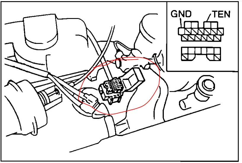

That is an odd one. So, the engine stalls but then continues running likely because it is in gear and moving.
Do me a favor. Let's see if there are any diagnostic trouble codes stored. That may point us in the right direction. You don't need a scan tool to retrieve codes. All you need is a short jumper wire or even a paper clip. Follow the directions in this link and let me know the results:
https://www.2carpros.com/articles/diagnostic-trouble-codes-for-1995-and-earlier-mazda-cars-obd1
The data link connector is located under the hood of this vehicle. It should be in front of the driver's side front strut tower. I attached the only pic I was able to find.
Let me know what you find.
See pic below.

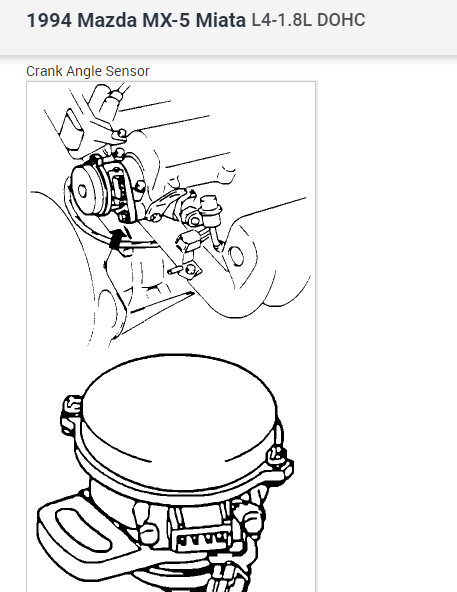

What's your thoughts on a Crankshaft position sensor?
Jan 23, 2024 at 6:07 AM

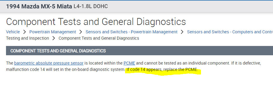

  • 110,241 POSTS
A crankshaft position sensor will cause ignition problems if it is failing. Do me a favor. Take a look through this link and let me know if you feel anything mirrors what you are experiencing:
Also, yes, the sensor or a connection at the crankshaft sensor can cause this. However, the one code that has my attention is related to the MAP sensor, code 14. On this vehicle, the barometric pressure sensor is integral to the PCME. When code 14 is set, the PCME itself is usually the problem and needs to be replaced. See pic below.
The PCME (powertrain control module) is located behind the passenger seat. I have a feeling this is where the problem is coming from. Interestingly, it can't be tested independently. That is where the manual says to replace the PCEM if code 14 is set.
Let me know your thoughts.

Hi Joe. Well, I changed the Computer, And the MAS, TPS, but still have the same problem. Only after the engine warms up. Driving down the freeway at 70+ it runs perfectly but under 70 it's just like you turn the key off and on. Not constant but all the time. Just don't know what else to look for. Any suggestions? OH, and still no codes.

Hi. The only thing that has made a difference was unplugging the fuel positioning sensor. That made the engine run smooth and idle normally, but still cut out while driving. Unplugging the MAS didn't do anything. I just changed the main computer with NO change, still cuts out. Yesterday I ordered a Crankshaft position senser but after ordering it I saw a post that said that 1994 doesn't have one. The Cam position sensor and the Crankshaft sensor are one and the same, All one unit. Is this correct? One site says yes, another site says no. The Cam sensor is expensive [around $ 200 +] so would like to hear your thoughts on this before ordering a new one. Thank you so much for your help with this problem. You're providing a really wonderful service to people who really need help.
Feb 1, 2024 at 12:13 AM
  • 110,241 POSTS
The only thing my manual shows is a crankshaft position sensor. I attached a pic below. Note that it is located at the rear of the cylinder head near the coil.
Additionally, if I am reading the directions correctly, it is used to adjust ignition timing.
Take a look and let me know if you find this in your vehicle. And it does look like an expensive part on this engine.
See pic below.
