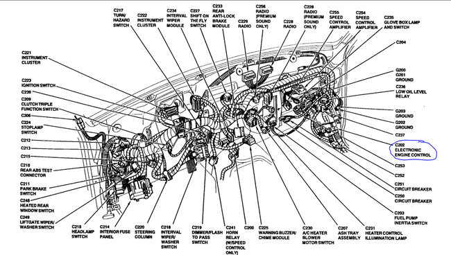

fuel pump stays on when ignition partially turned. after a while pump quiets and will start. this a relay ECM or pump?

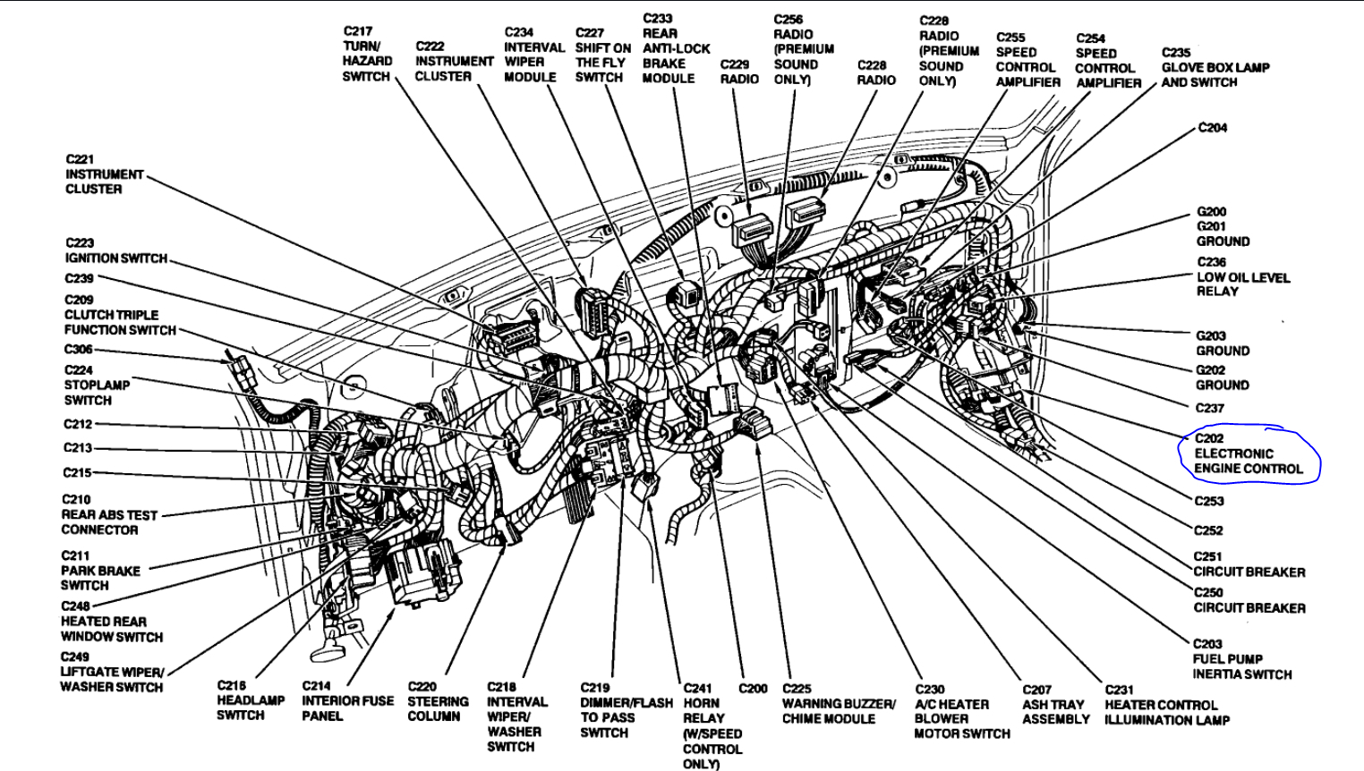

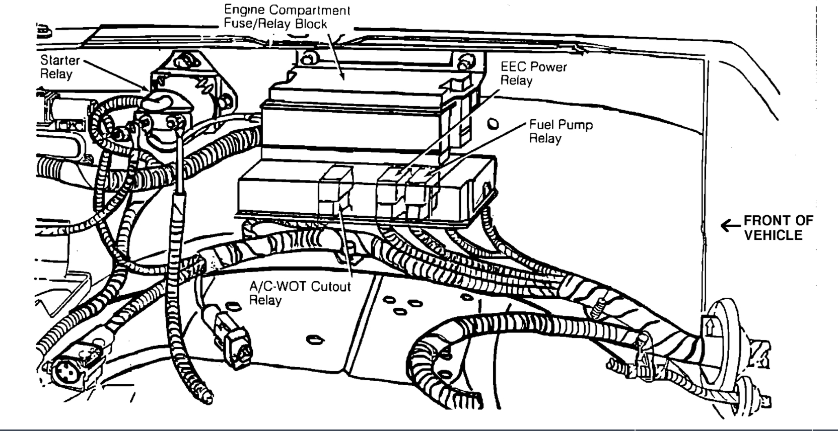

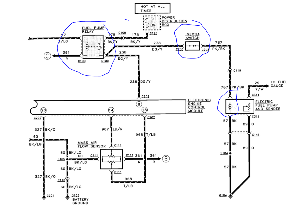

Good morning,
The pump should only run for 2 seconds with the key on. Then it should shut off until you crank the engine. Then it will run 100% of the time.
By staying running all the time, you need either a relay, which may be stuck or the ECM
itself.
The ECM is behind the right side kick panel by the right front door.
