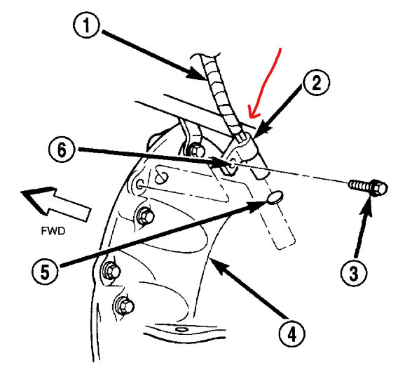

Be running great then goes to crap. Suddenly when u accel, she'll break down bucking, loss of power, motor be misfiring, and will vibrate. Next day she good for awhile then goes back to crapping out. Then later all good again. Have new fuel injectors, spark plugs and rail, replaced throttle position sensor, maps heat sensor, have checked several times for vaccun leaks, replaced trans mount, u joints, replaced main cat, when run codes, one time nothing, then next day misfire on 3, next day it'll show throttle position sensor which a new one had been put earlier that which at that time ran great for 50 miles then crapped. This has cost me money, time, not having transportation, stress and down right ugly. This jeep has ran great and does not even burn any oil. I need help finding problem

I have seen big problems with the crankshaft angle sensor going bad which will cause these problems will no codes, there is a slight chance the fuel pump is going out as well but the crankshaft sensor is easier and cheaper. Also, make sure the battery ground-to-chassis cable (smaller) is good and connected. Here is the location of the sensor which is i on the transmission bellhousing on the driver side, I would swap it out first. Check out the images (below). Please upload an image or a short video in your response, so I can see what's going on. Ken

Replaced crankshaft position sensor, nope that didn't help. It is a hard place to get to and switch out. I since ordered a camshaft position sensor and will get it Tuesday. There aren't any more parts for me to replace after I put in camsensor. Will let u know.
