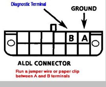

If you've inspected the distributor cap for carbon tracking the next thing to check would be fuel pressure.
To do this you need to remove the flexible fuel line in the engine compartment and install the pressure gauge inline where the line was. Most pressure kits will have the adapter. You should have 9-13psi at idle.
You might also want to see if you have any diagnostic codes stored. You can check these easily on the truck buy jumping to pins on the data link connector under the drivers side of the dash, cutting the key on an d counting the check engine light flashes. It will first flash one long and two shorts three times indicating it's in self test mode. It will then flash your codes and then flash code twelve once all the codes have been read indicating it's done. I'll post a list of the codes and a picture of what to jump below.
