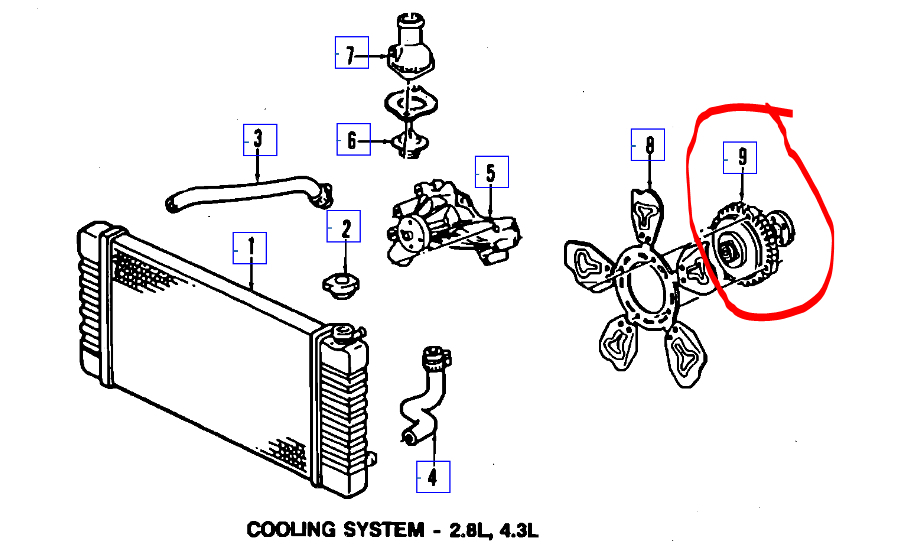

What I think I'm hearing is the cooling fan under the hood. This vehicle has a clutch fan that is designed to engage based on under-hood temperatures.
Before you start it, open the hood and try to spin the cooling fan. There should only be a slight resistance if the engine is cold. If it is hard to turn, have a helper start the engine while you take note if that is where the sound is coming from.
I attached a pic of the fan clutch below so that you know what I'm referring to. Note the fan blade bolts to the clutch. The clutch is attached to the water pump pulley.
Let me know what you find.
See pic below.
